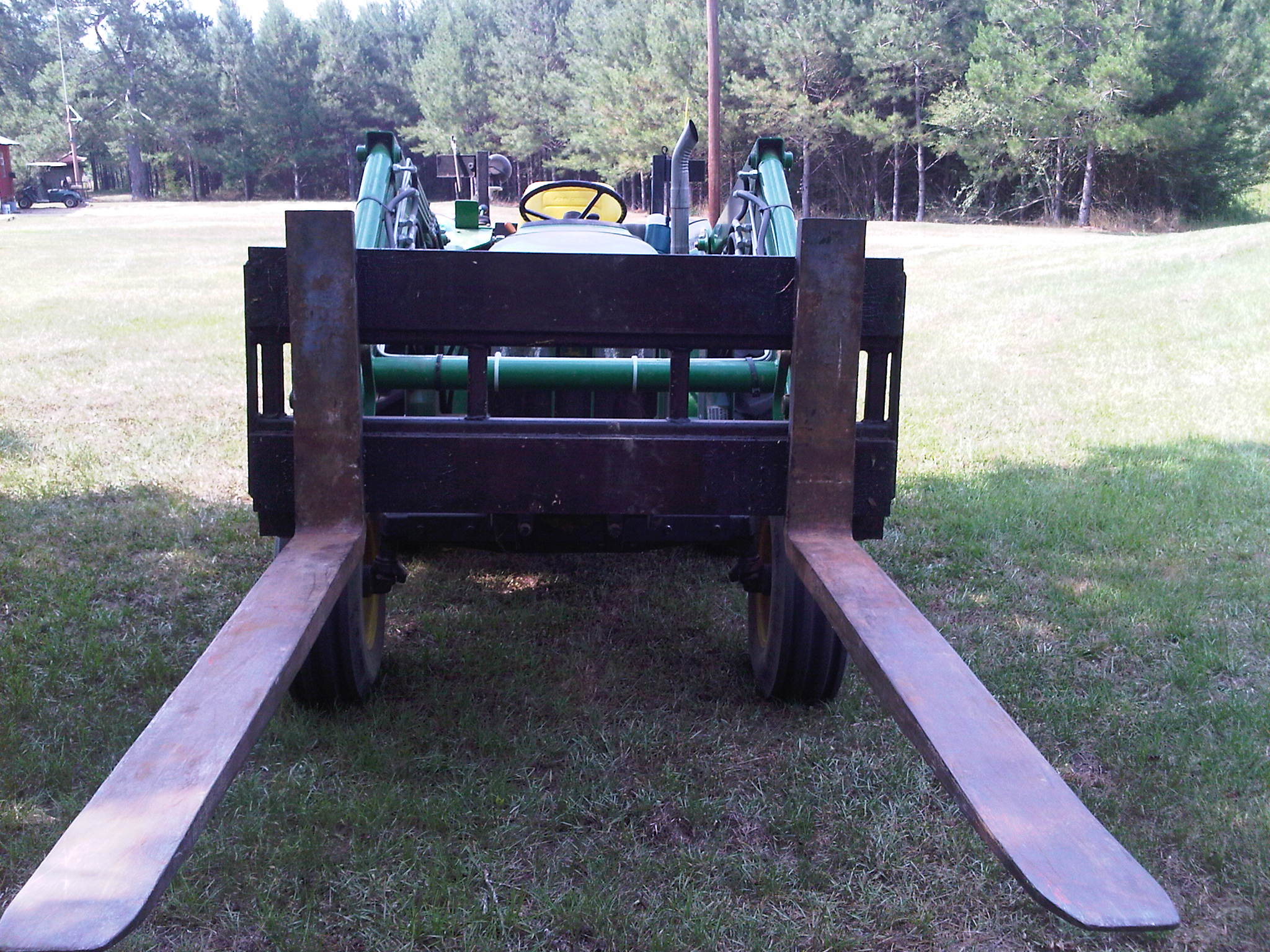

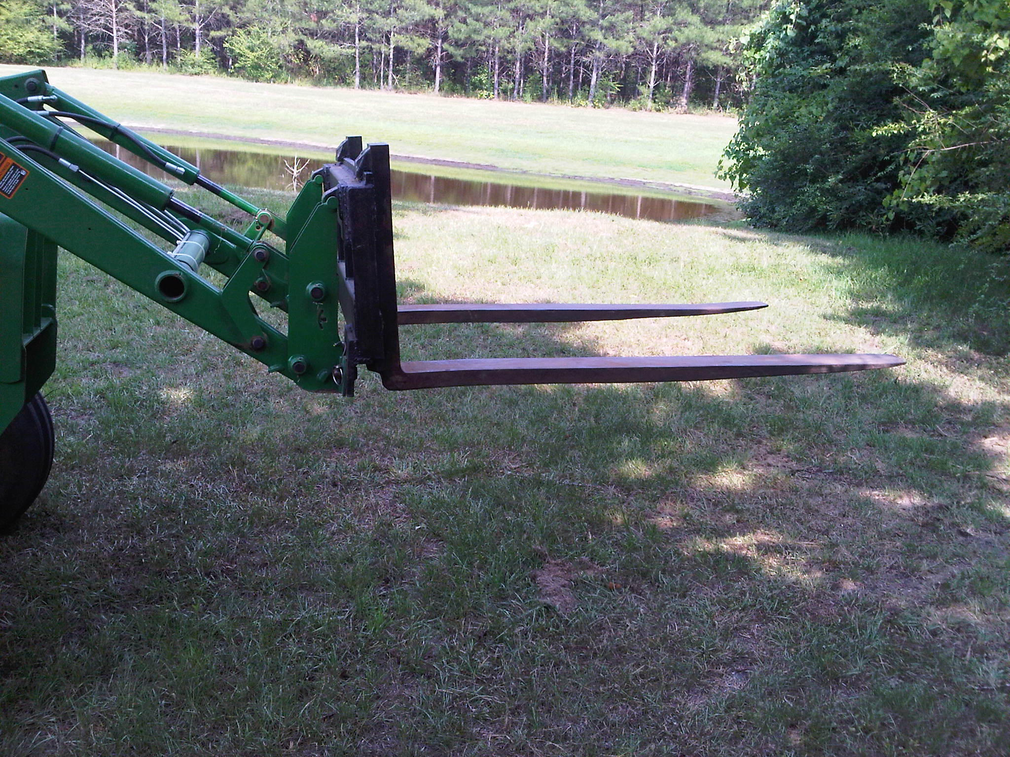

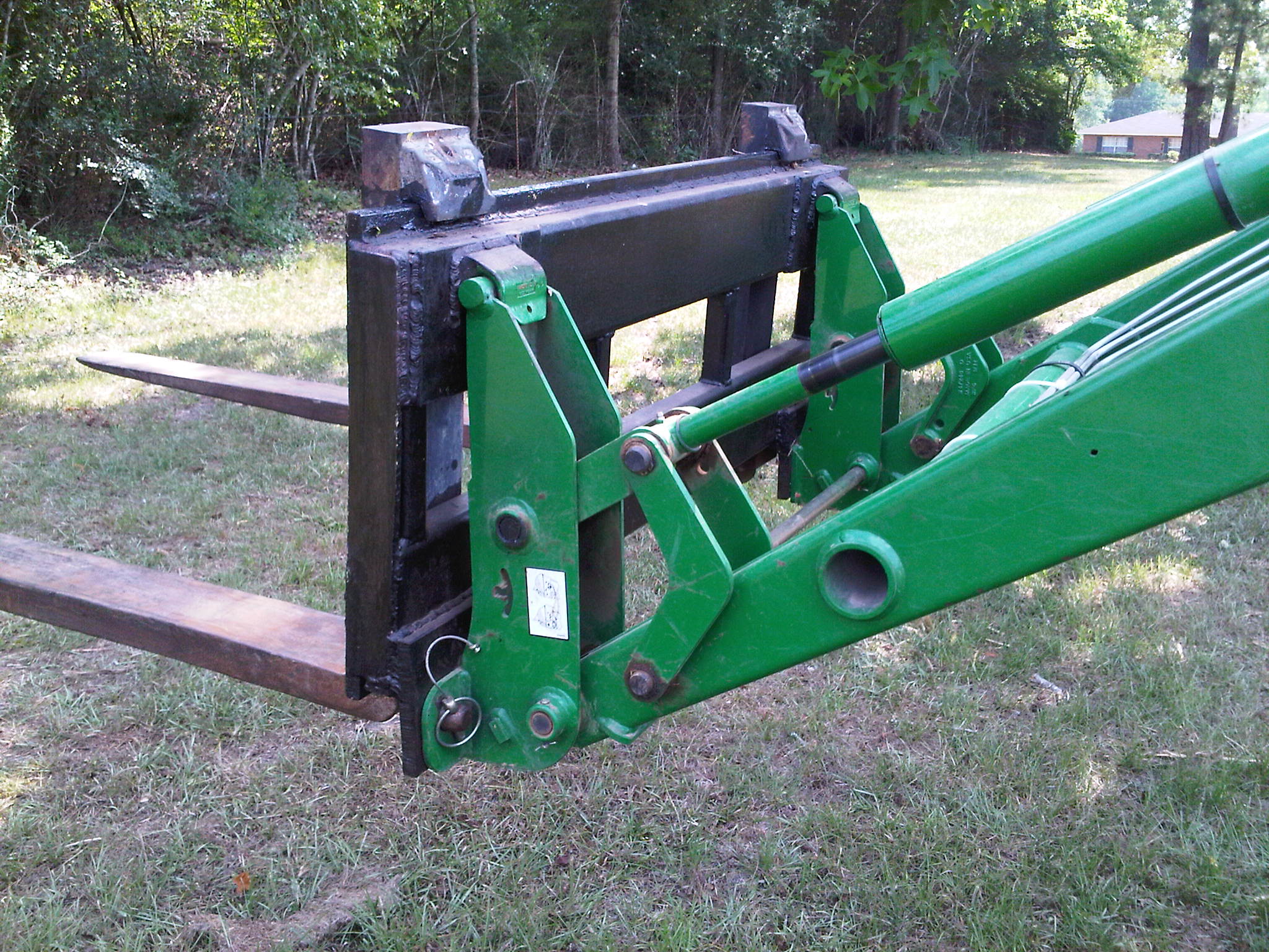

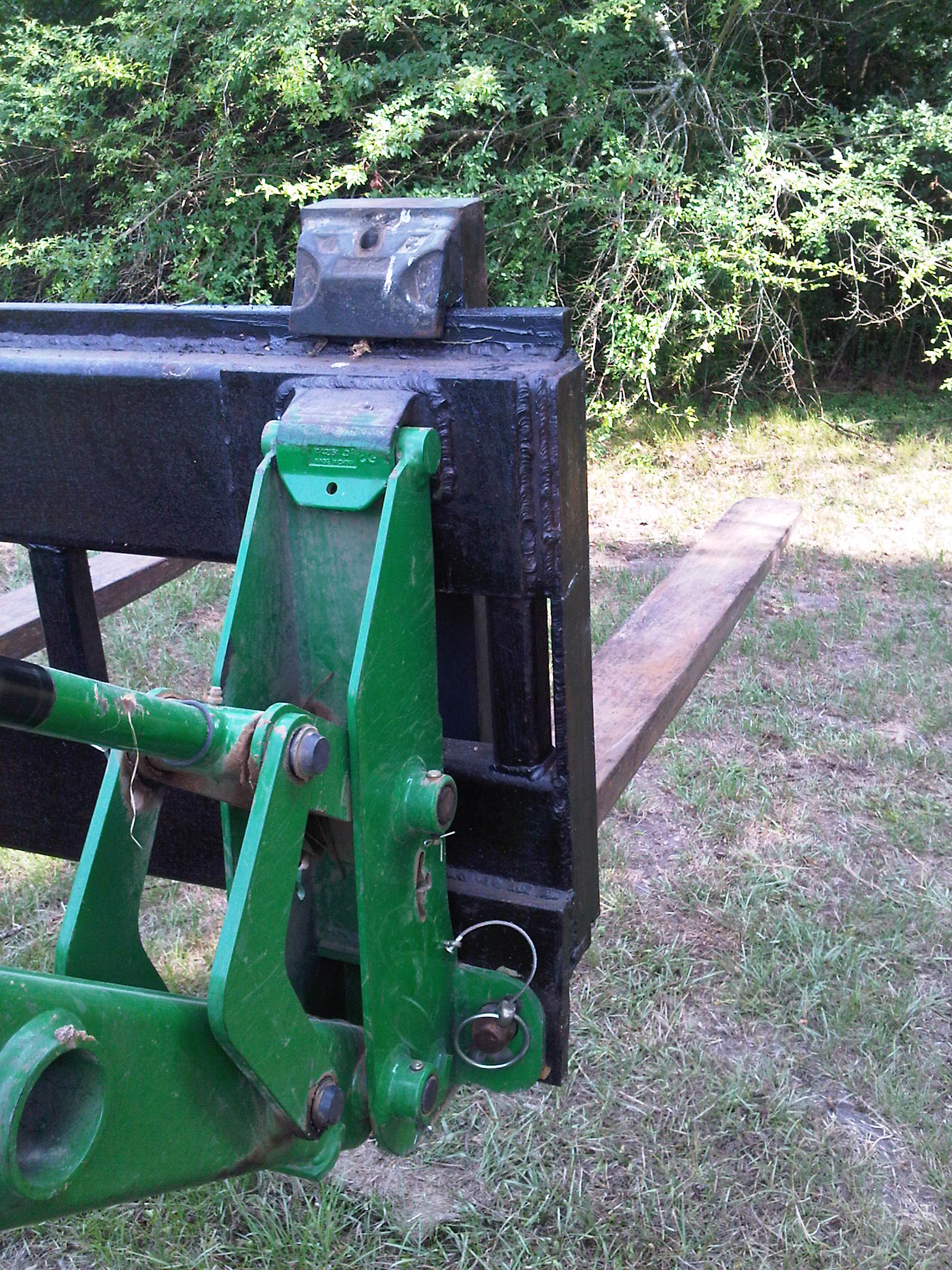

I acquired some forks from and old fork lift and decided to attempt to build a bracket to hold them. I am very happy with the outcome.

Boy those look heck for stout, How much can your FEL lift? They would be too heavy for my little Bota, but might be just right for your JD. looks like you did a great job.:thumbsup:
James K0UA
/ Finished my forks
The heaviest load I have picked up with it weighed 1100#. According to the spec sheet the loader is rated for 2400# at the pivot.

How did you build the quick hitch between the loader frame and fork attachment? Looks good.

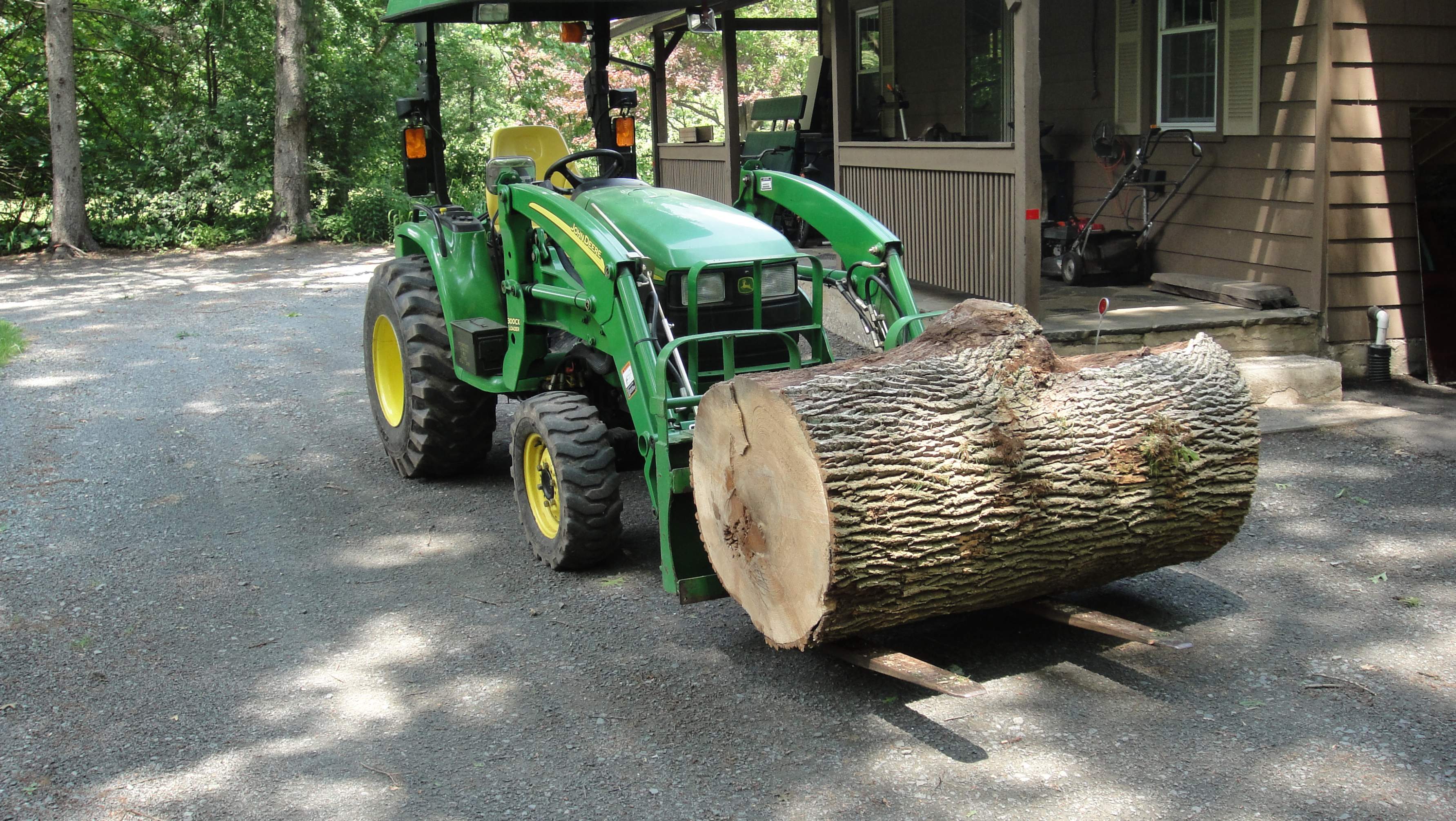

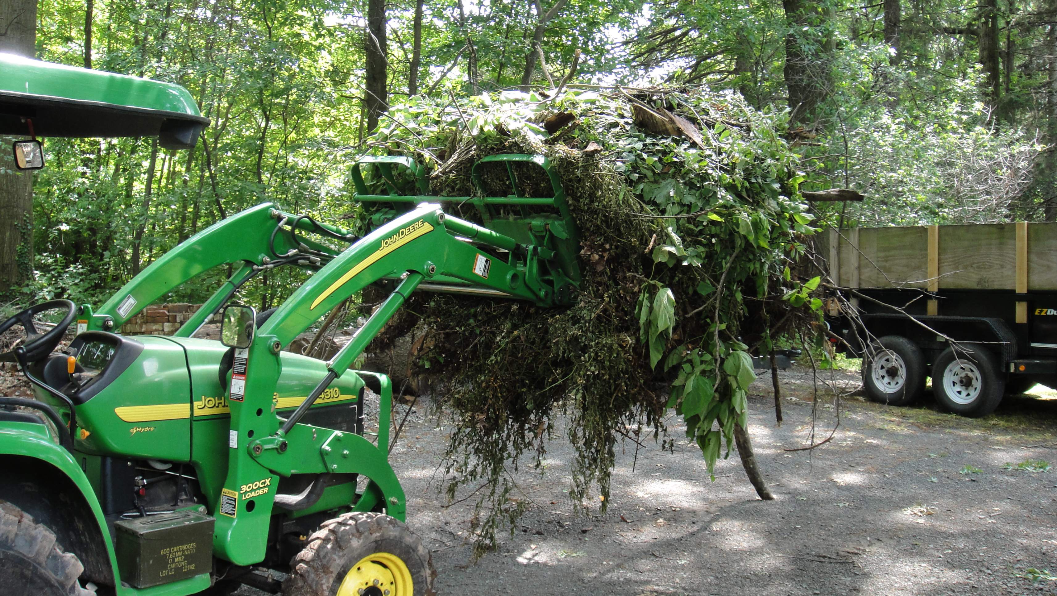

Looks great, Now I would add a bulkhead above, allows you handle larger bulkier loads, especialy brush.
JB

The quick hitch is a JD part that I welded on. It is designed to be welded on to the back of the bucket.

JB4310 - I have the plans drawn up for the bulkhead just haven't built them yet. I thought about it after I finished the main bracket.

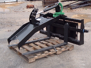

leblaken,
Nice job on the fork adaptation. I did something very similar like that for my PT.
Here are some other ideas you might adapt.

/ Finished my forks #14
Looks good!
The only thing I would suggest (and I did to mine) is to put a 4" spacer on the bottom of your FEL mount.. this allows you to tilt your load farther back in the event you are going down hill.
Anyone have more info on the grapple attachment? I can fab that up pretty easy just don't know much about hydraulics..
