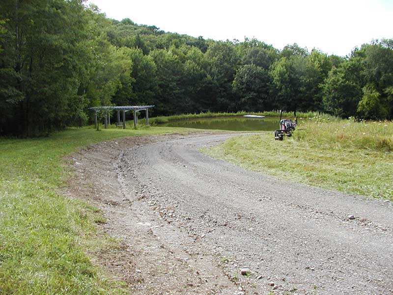

And here's an after picture. The 6 inch stuff is cut to 4 or so and the weedy bits cut well. The uncut stuff I cut with a two pass half overlap which went slowly but gave a fair cut. The goldenrod caused a lot of loading and went really slowly. I had been going back and forth but found later that a clockwise lap cut quite a bit better.
The driveway work is PT done too. And the slope behind the pond is where I'm stalling the wheel motors at 27-30 degrees.

That's a beautiful place you have! Thanks for the pics.

Alas, it's not mine. I have a 2000 foot or so private road here that I share with 3 neighbors. That's one of them.

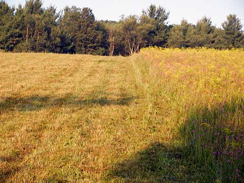

Test 6: Deflector off. 9-1/2 minutes at 24 inches per lap = about 1.1 acres per hour. Tolerable chaff cloud. Best cut and speed to date - see attached. For this test I made a set of blades from some cheap double edged reversible blades (with a wavy high lift profile). Unlike Charlie's offset blades these are not offset and seem to pretty well contain the chaff under the deck. Taking 24 inches per cut gives me a triple cut with the 72 inch deck and with the reduced loading the ground speed is roughly double what they would accept at 36 inches per lap. Also a quicky test on a previously mowed field seemed to do a good job of clipping off the stalks left behind earlier and at full tilt ground speed. I haven't had a chance yet to test cutting 6-8 inch grass but hope to soon.
