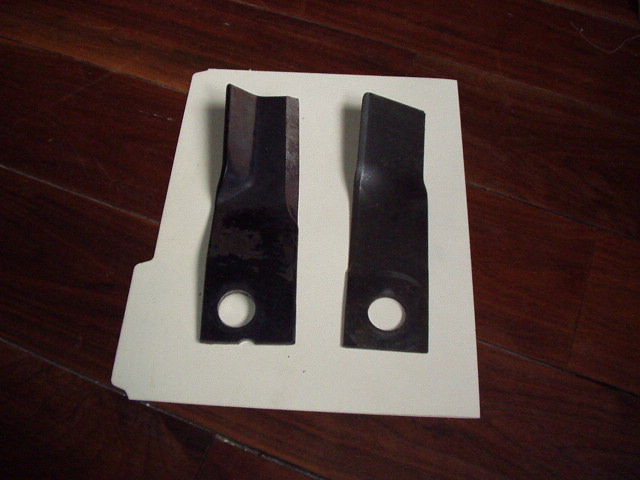

Re: Finish Blade test - results
The first post in this thread has a picture attached comparing the PT rough-cut blade with one I made by cutting a Gravely blade in half and getting a 1" hole drilled in it. I did some comparison testing, which was reported earlier. and Sedgewood (John Coxon) made up some blades from thinner lawnmower blades and did comparison tests with mine. He then sent me a set of his, and I did some mowing with both.
The result, John's blades are the best so far. They beat the factory blades and mine in each type of mowing I did. With the deck at its lowest setting, they do a finish cut that is acceptable on my lawn - but not Bubenberg's customer lawns or golf courses. Set a little higher, the blades do a good smooth pasture cut, with almost no missed area. The factory blades, and to a smaller extent my blades, leave a stripe and some tufts.
The attached photo shows one of my blades and one of John's, with his on the right. His is reversible, and has the whole blade area twisted, so the whole blade outside the stump jumper lifts. Mine has a level leading edge, and bends up at the trailing edge, also creating lift, but not as much.
So, now all I have to do is wear out two sets of my blades, and I can make some like John's.
I am going down to Power Trac with Bubenberg in November, and will see what they have in the works, and give them a bit more detailed report. Maybe they'll offer a revised finish blade set for the 72" rough cut.

Charlie <font color=red>So, now all I have to do is wear out two sets of my blades, and I can make some like John's.
I am going down to Power Trac with Bubenberg in November, and will see what they have in the works, and give them a bit more detailed report. Maybe they'll offer a revised finish blade set for the 72" rough cut.</font color=red> Take one of my blades along. The new set I made up from generic hi lift lawn mower blades is straight with the back upturned edge and cuts about the same as your custom set. The reversibles are still the best so far by a fair margin, even in full grown unmowed weedy fields. And they do a surprisingly good job on saplings too - I may never put the roughcuts on again.
</font color=red> Naw, toss 'em in the junk pile in the back of the shop with PT's finish blades and all the other experimental stuff that never quite worked and see if you can improve on the reversibles. Hmm... I wonder what happens with 4 reversibles per spindle... Four per spindle had a negative effect with the roughcut blades but maybe, just maybe... naw, the power consumption issue would still be there. I think.

<font color=red>Take one of my blades along.</font color=red>
John: I will take one of your blades and one of mine to Tazewell with me, and then send your set back. Even with a bit of distortion, the blades are good. A couple of them did eat major grooves in two of PT's expensive bushings. I was a bit surprised that the blades were so much harder than the bushings. I mounted them with a 1" flat washer, so they only had a little vertical play. Unfortunately, I had them all off and scrambled before I noticed the bushings, so I don't know which two caused the wear.
I've only used one side of your set, so expect a set with 50+% life to arrive by mid November.

Charlie <font color=red>I was a bit surprised that the blades were so much harder than the bushings</font color=red> Those suckers are hard! I had to draw some temper to get a drill to touch them and it was still a long slow process. guess I could have heated them some more but at the time I thought a little hardness might be a good thing. But maybe not - bushings and drilling time being as hard to come by as they are. The new hi lift set were very soft and a hole saw cut through them like butter.
And if PT wants to keep a blade for development purposes thats fine with me. It wouldn't bother me a bit if they got all the blade making fun.
