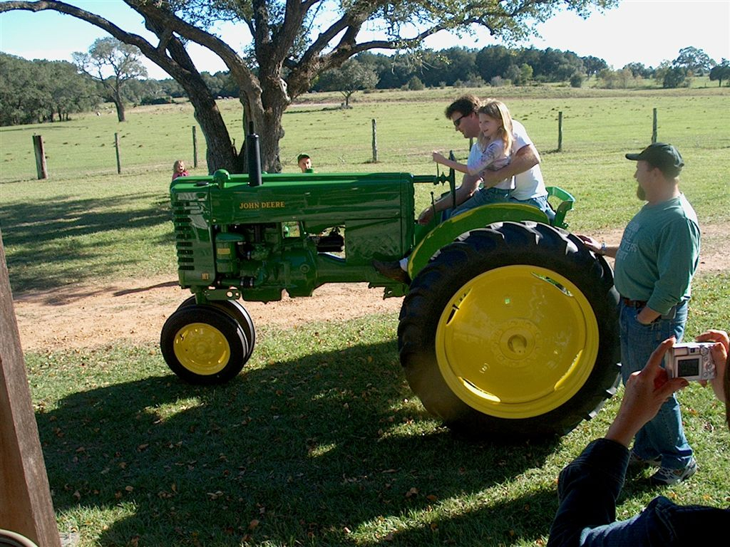

I have a 1951 JD MT and it’s 6V, positive ground. The posts are diagonal to ea other and battery needs to go into battery tray only one way so cables can properly connect.
Ques: what would a 20% increase from 6V to 8V do to the tractors electrical system? I have a 2-popper w distributor (points & condenser), generator, cut out relay, starter but no lights. What about CCA’s size if i could go from 6 to 8V? The battery has to have the same profile/footprint to work too. If the ROI is better on 8V & no issues. I’d go w it.
Here she is:

Will require adjusting the voltage regulator to about 9 volts. Or just use an 8 volt Battery Tender maintainer if it is a occasionally used tractor (which I'm sure a JD M is).
