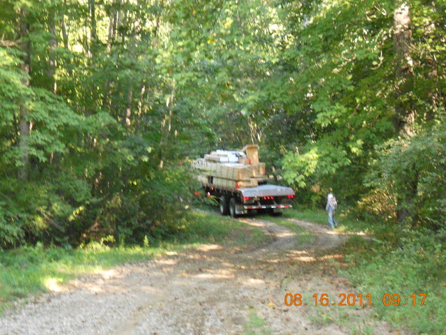

#23
As stated earlier, the guy decided to back up my 500' driveway.

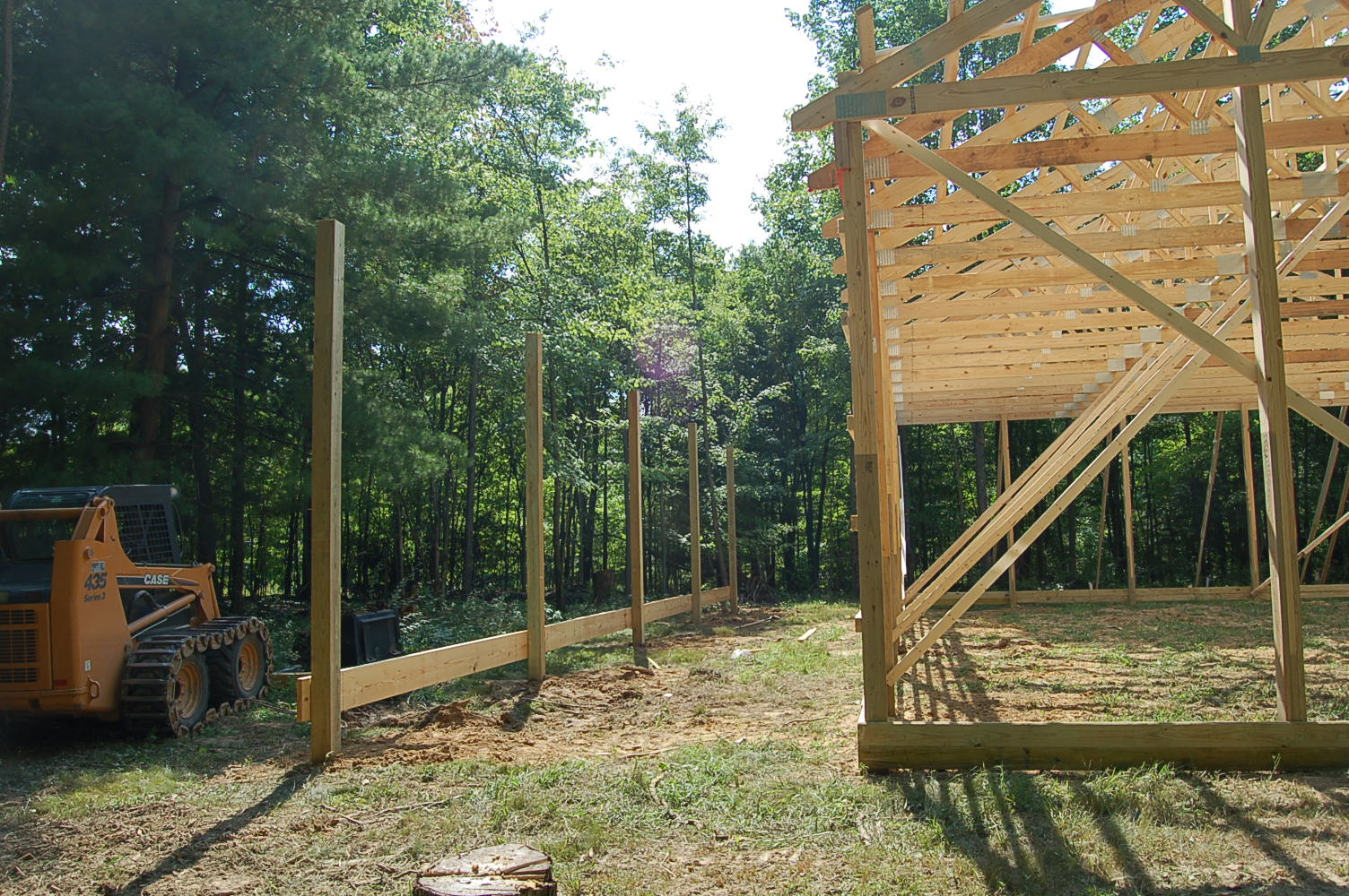

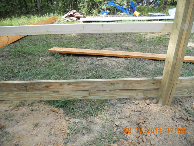

Here are the last photos of the day..
They got most of the posts in and were starting to put top joist on.. They are using glue-lam for these top joists and they seem to be PRETTY heavy. So I'm guessing that's why they decided to call it a day. Also they included the wrong posts for the shed roof. They said they will bring the correct ones tomorrow.

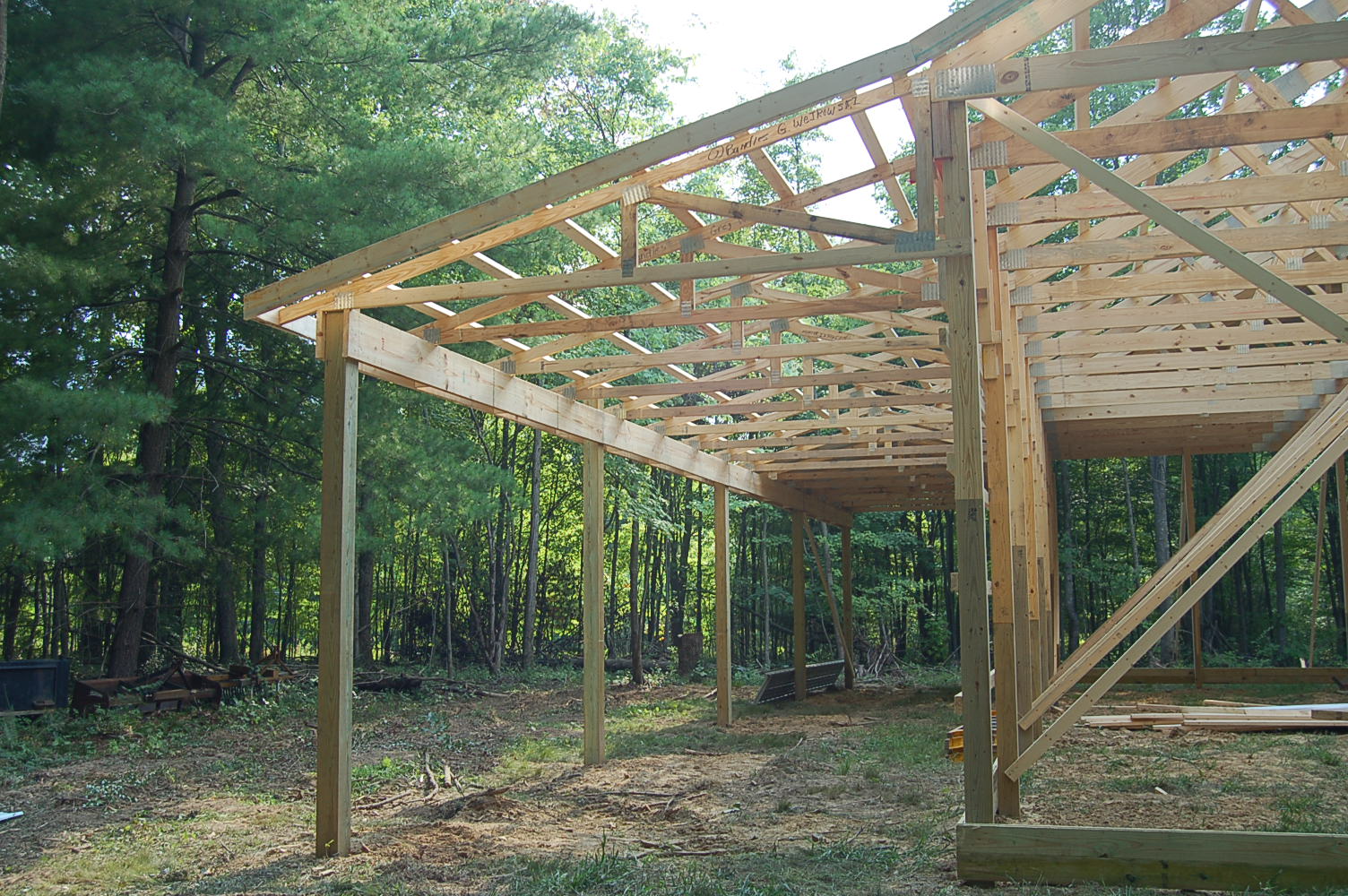

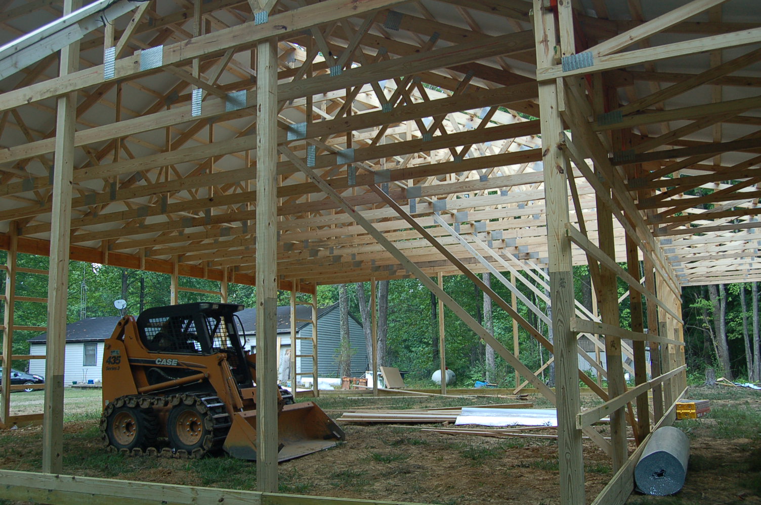

#26

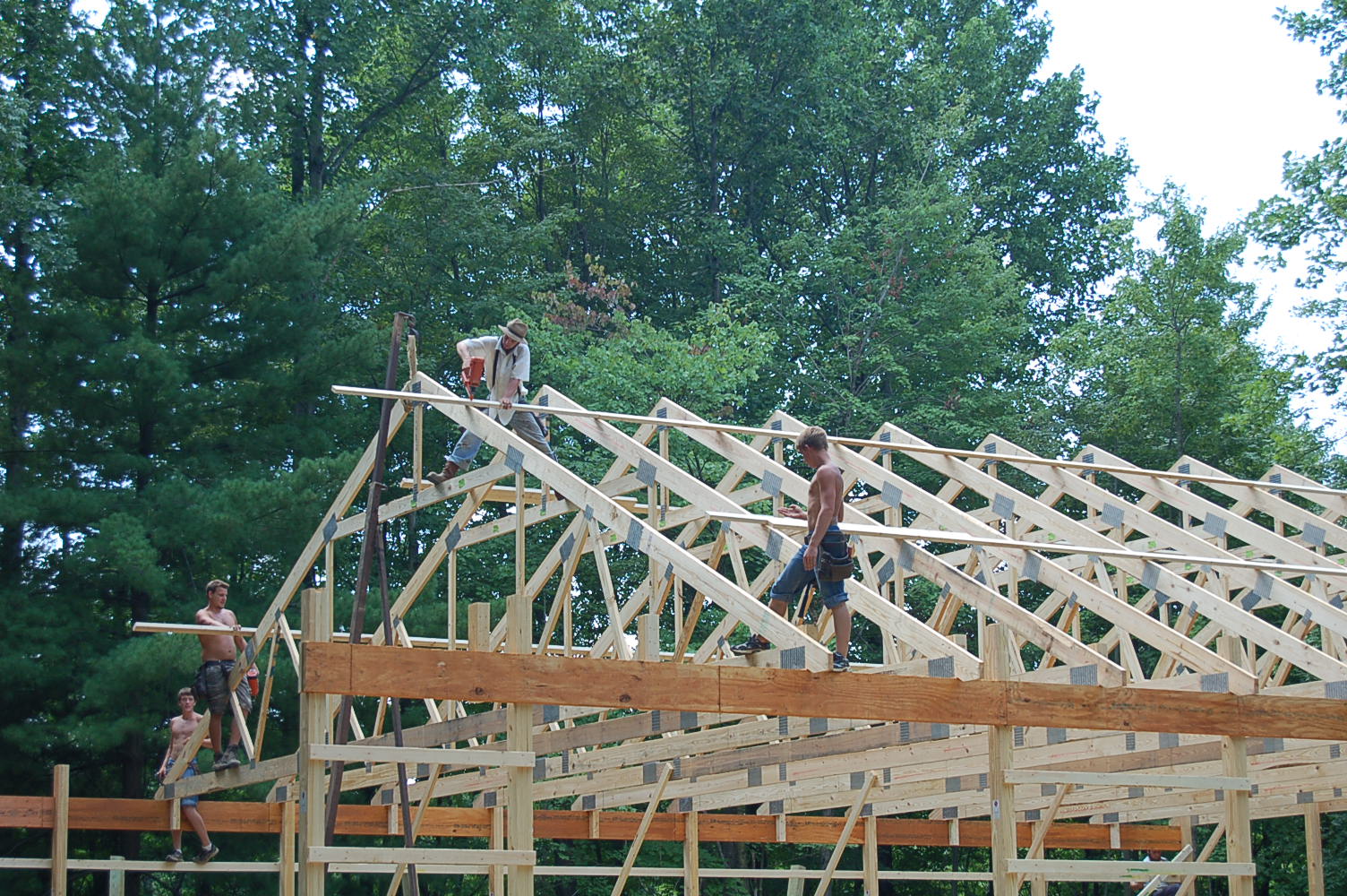

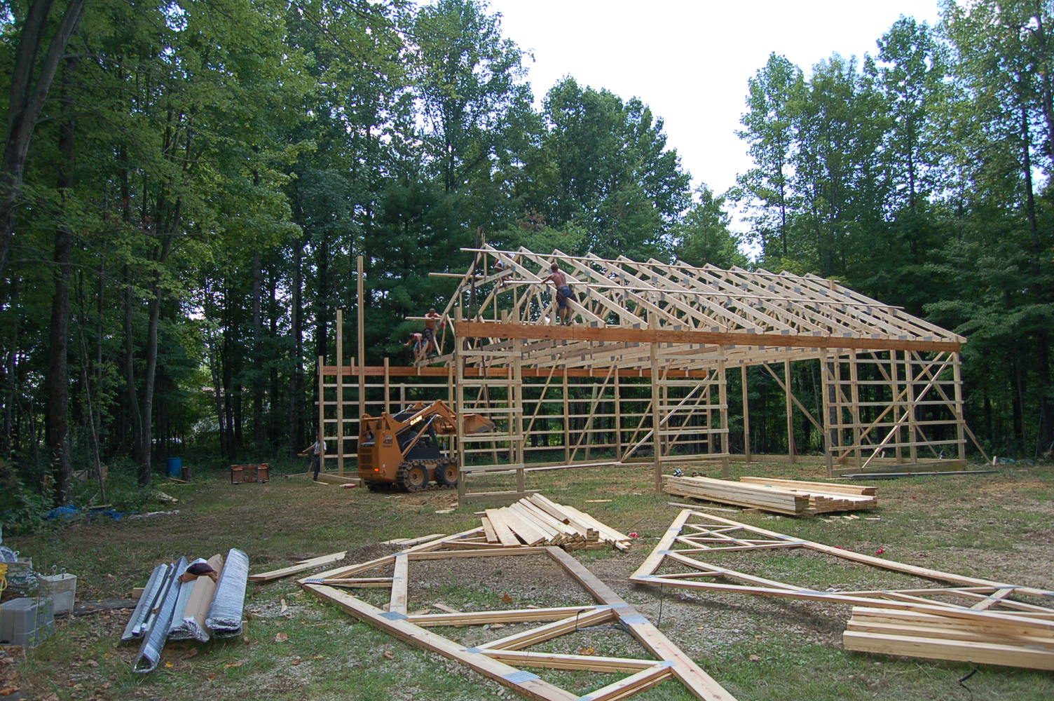

DAY TWO.
Looks like they will put in about 6 hours a day.. They get there just before nine am and leave around three. But they do have over an hour to drive each way. The foreman told me they wont be done until Monday or later.
Ok here are some photos of the first truss going up.

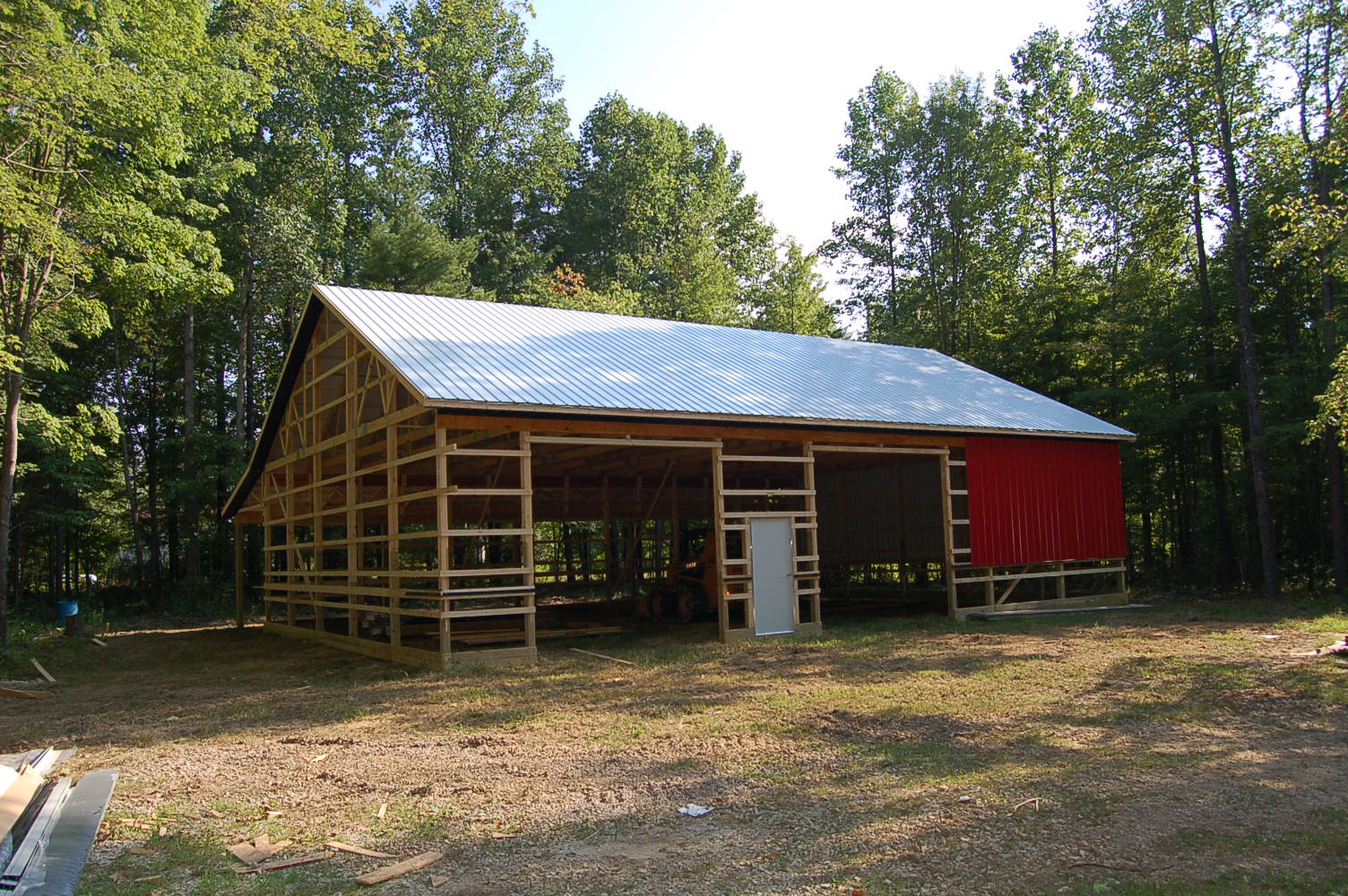

#27
Middle and end of Day Two..
I switched cameras to my SLR so I could hold it more steady. (steadier?)

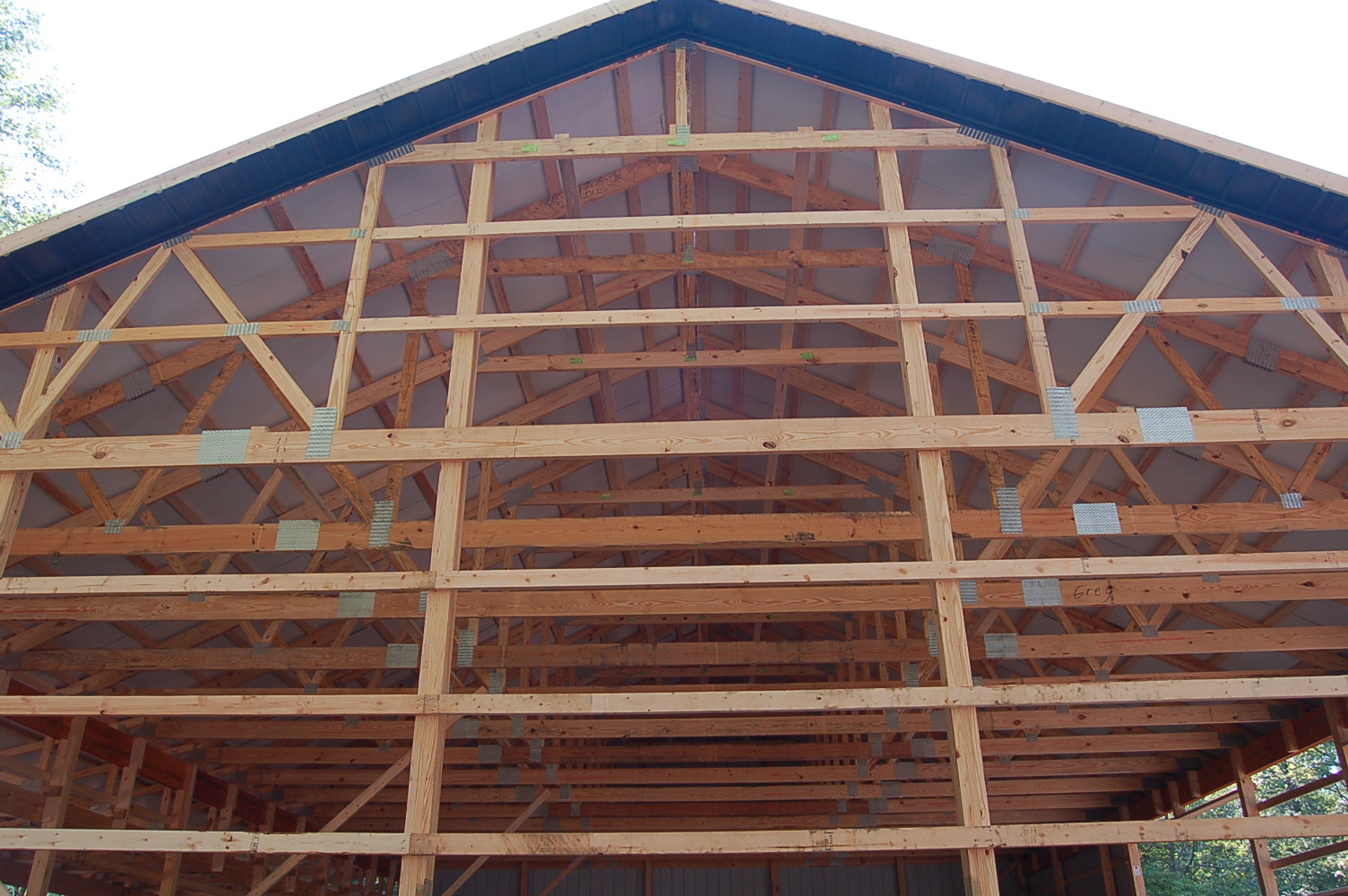

#28
End of Day Two.

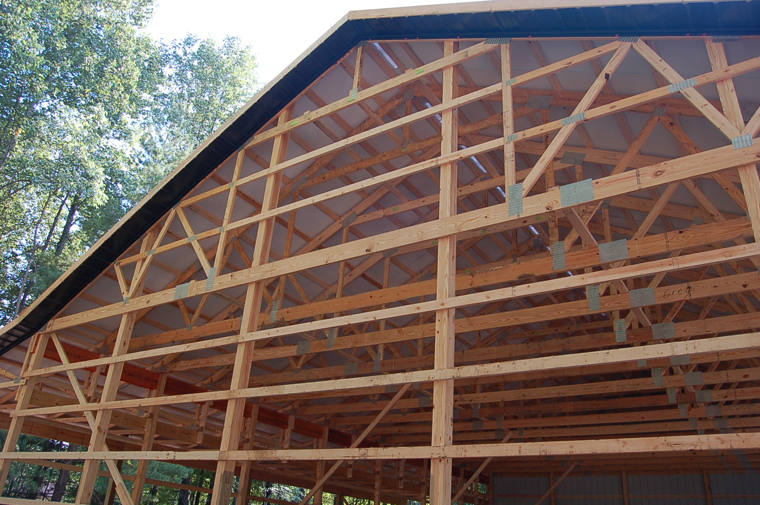

Sorry for the delay in posting.
Here is the day three. Sure seems like it's taking a while, but I guess you shouldn't rush quality work. LOL

/ Finally the barn.
#32

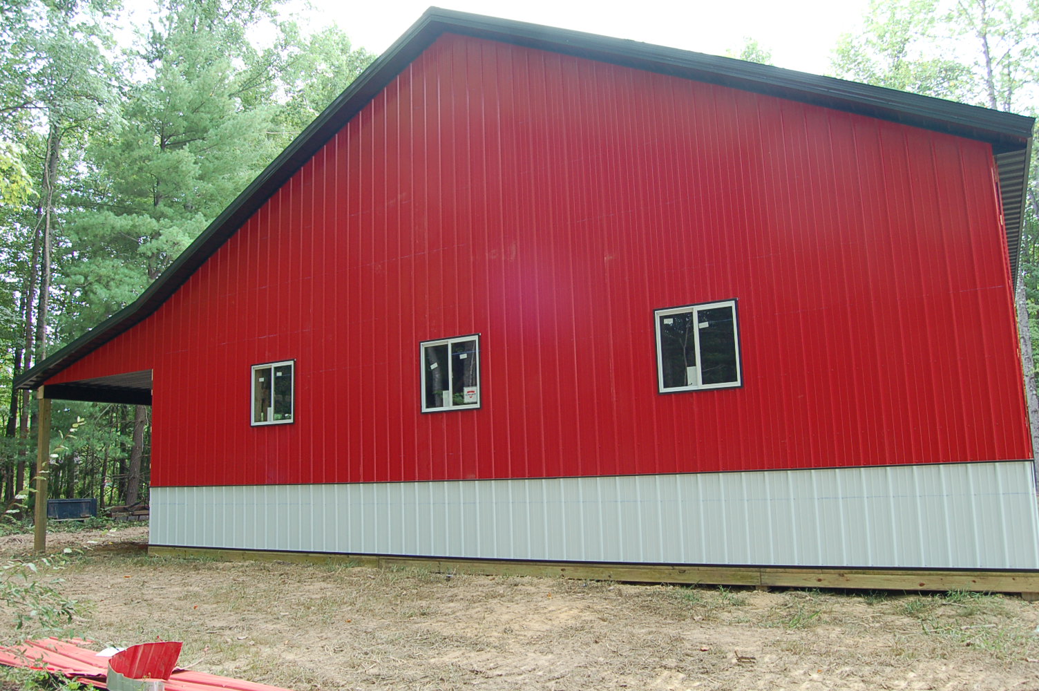

Day Four.. They finally started putting some siding on.
I'm starting to have a few questions about the build now.
My colors are as follows. Bright white roof, Red Siding, Bright white Wainscot, and Black Trim. On the right side they have the first wall of red siding up and no trim under the sheets to mark transition from Side to wainscot. Is this normal, because on the front there is some trim. Seems like the trim is more then just an accent but something to help direct water flow.

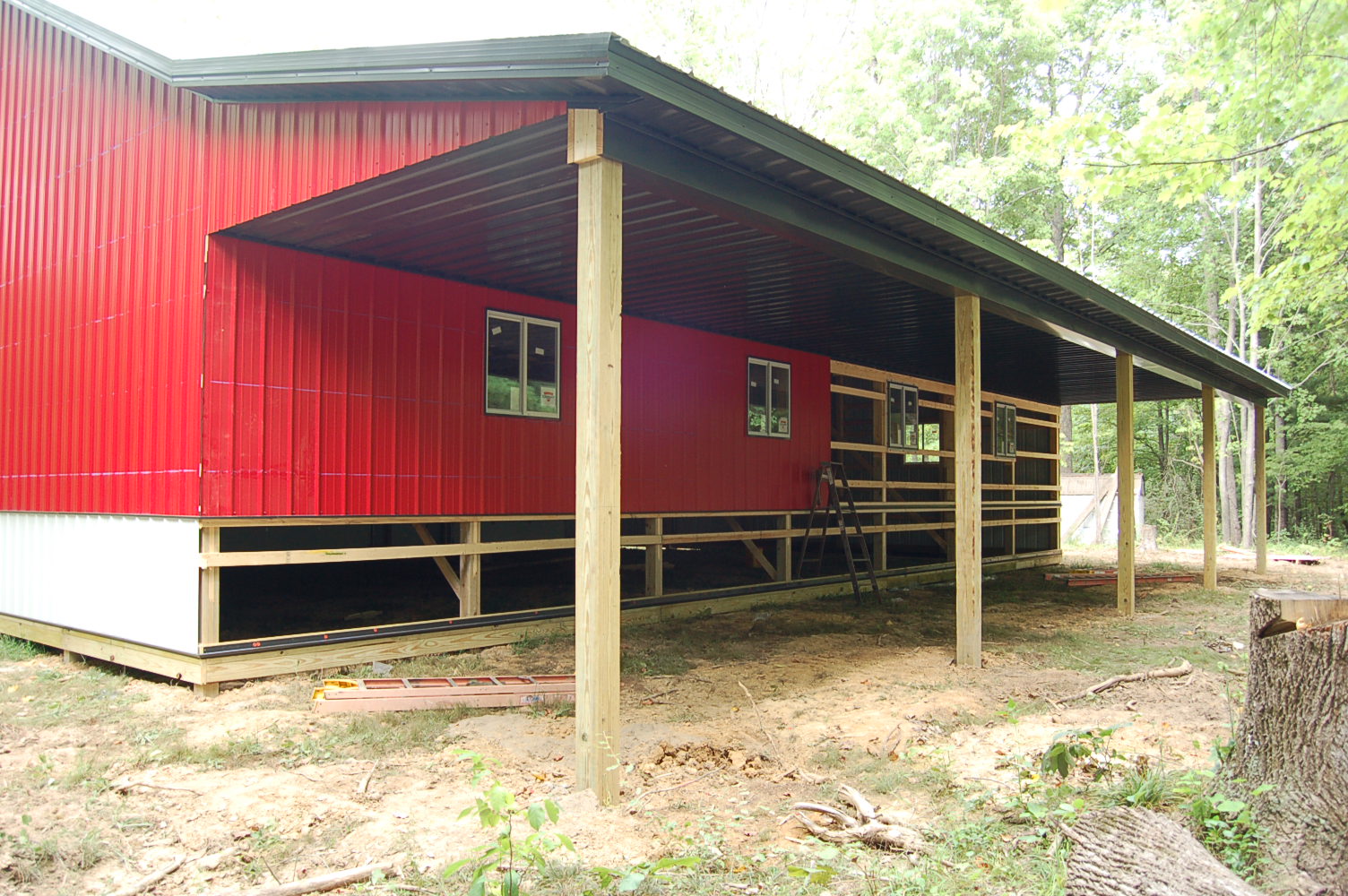

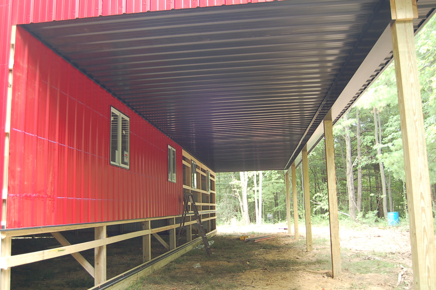

/ Finally the barn.
#40
Day Five and Six.
Got the doors hung, all the windows in and almost all the siding and trim on. Had to come back today to finish siding and trim. They actually scheduled 7 days.
