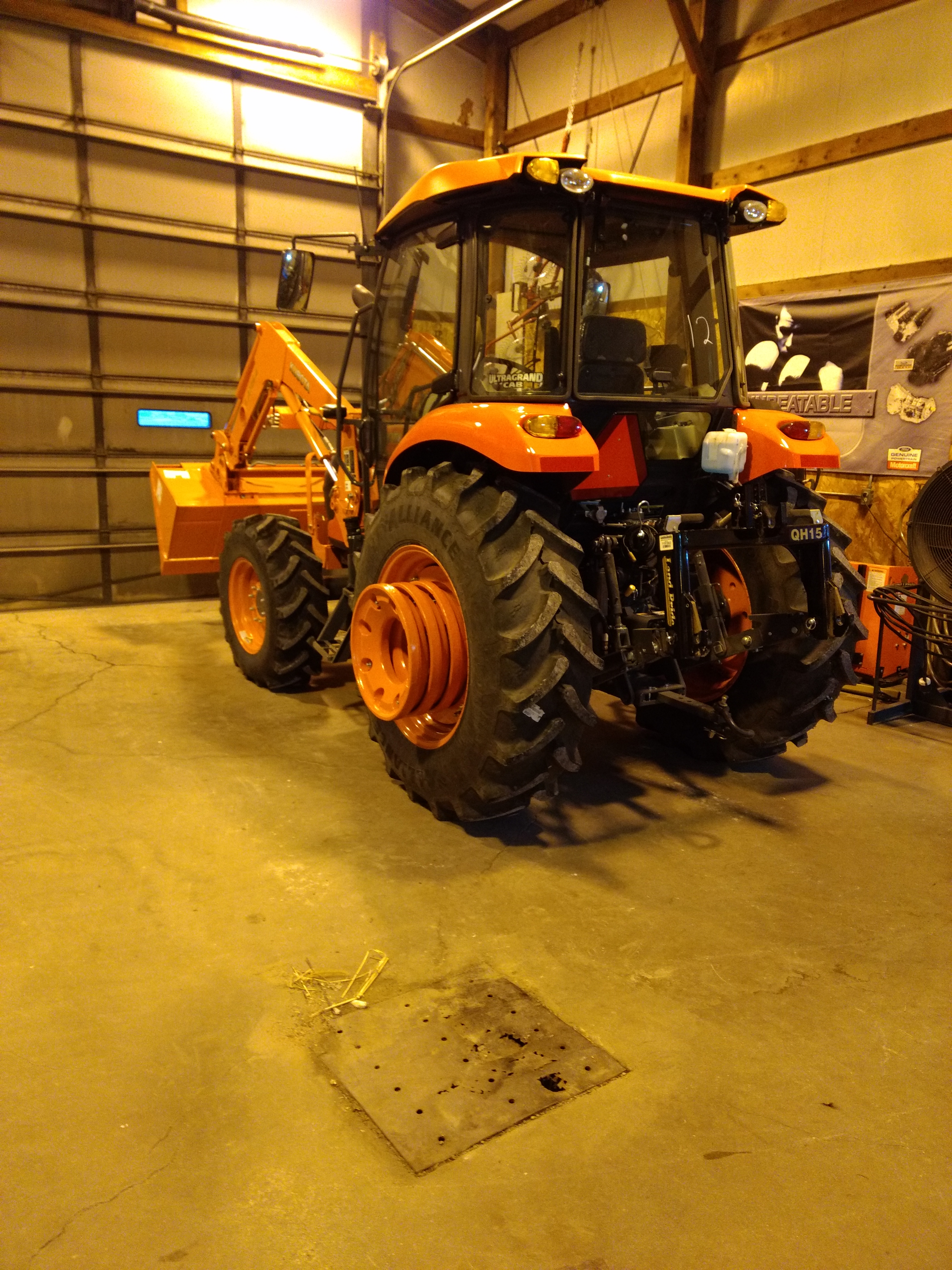

My buddy had his exhaust stack shortened 12” to be slightly shorter than the ROPS folded down, to get in Poultry Houses.
He’s really liking the Orange Unit :D
We got all four of his R4 Tires Filled today with 200gals of Fluid (25% AF mix) 1,600lbs Heavier :D
We still gotta order some rear weights for Superb Traction & Ballast.

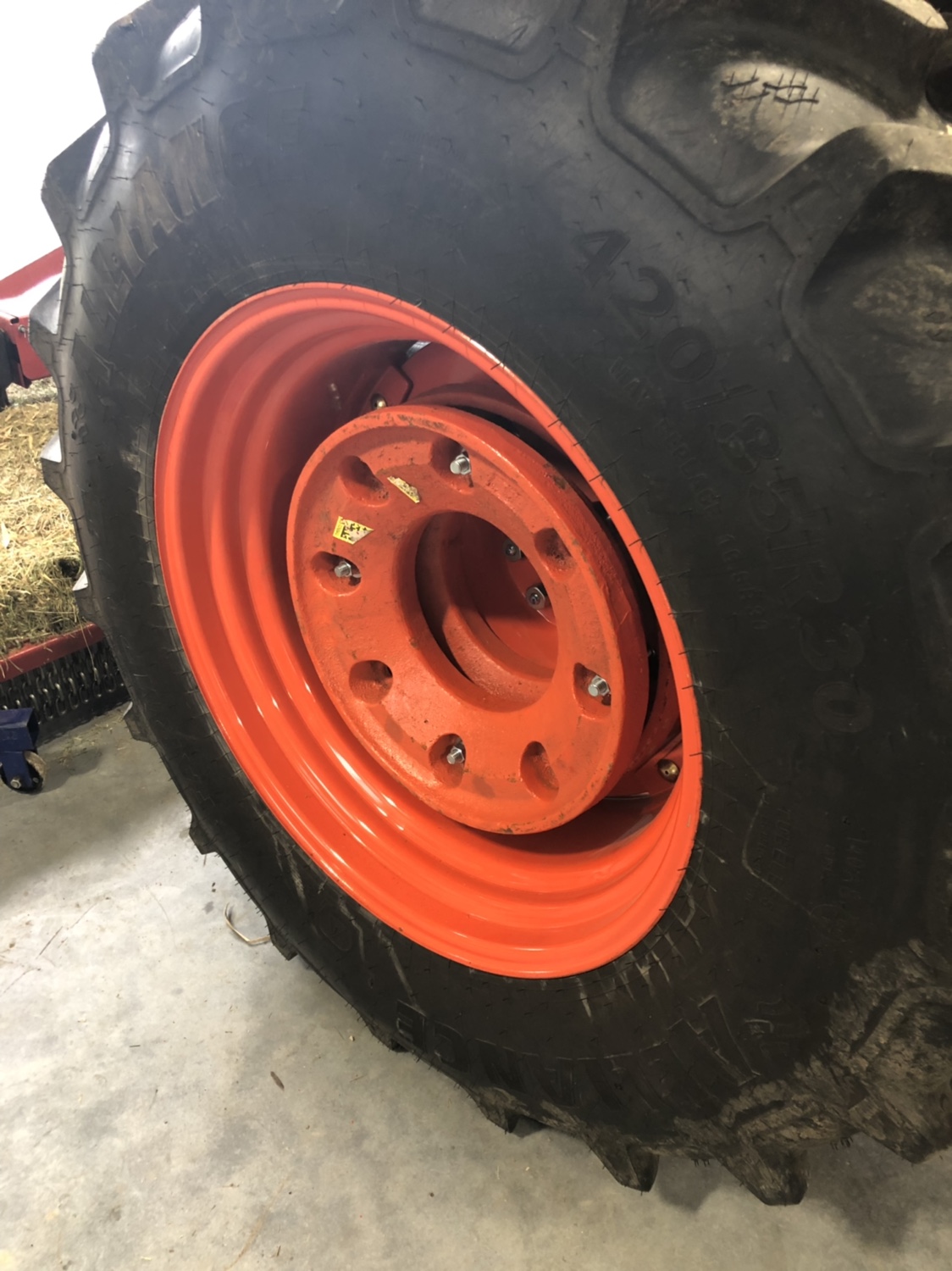

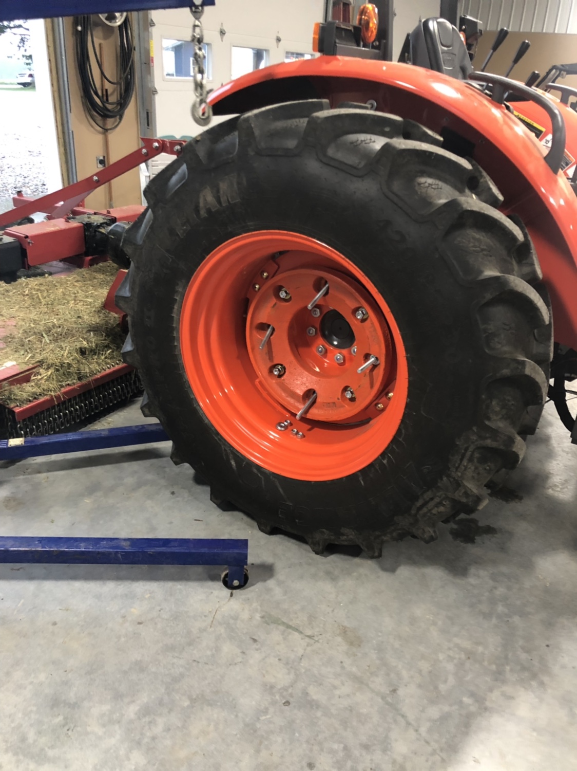

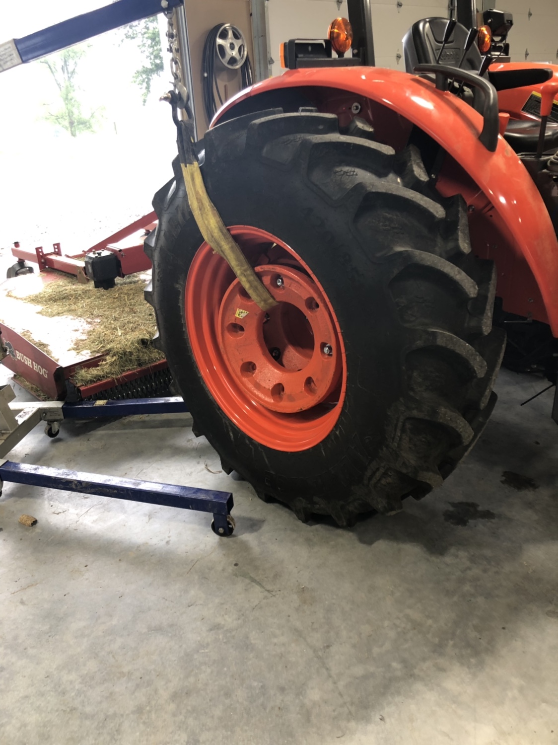

Brought it home and moved the front tires side to side to get maximum width out of it ... Its perfect, now both front and rear are right at 84 which is the same width as the bucket.

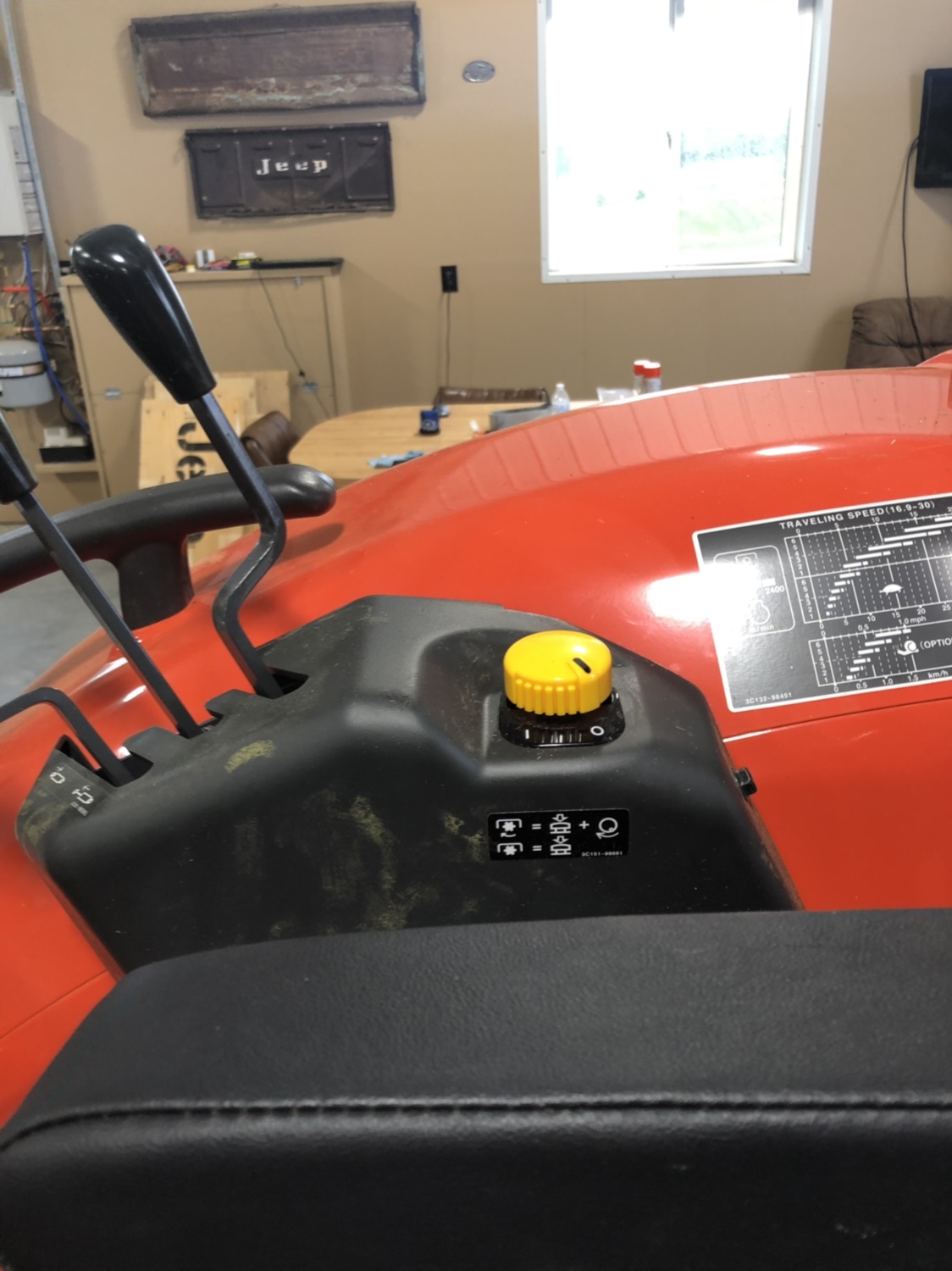

One other small complaint I have is the PTO switch. In its current location when I am holding on to the handle on the fender my arm lays right across it and kicks it off once in awhile. In Kubota痴 defense your probably not supposed to be on a bank so steep that you are holding yourself in the seat with that handle.View attachment 618488
By the way: It is cheap and easy to add a secondary driver's grab handle on top of that fender -- higher and a little more forward where your arm would not rest downward on the PTO control. I certainly use those handles a LOT on both fenders.

I'll have to look into adding that additional handle, thanks for the info! I already have the rear wheels/tires as far as they will go. It actually states in the owners manual that the front wheels like mine should not be changed. I have no idea why. We see stupid stuff like that in the automotive industry all the time.

As long as you have the rear tires out as far as they will go, the front ones do not matter from a tip-over standpoint because the front axle is pivoted in the middle. Lining up with your bucket or a mower, etc. were plenty good enough reasons for you to move the front tires out wherever you wanted.

I moved them side to side and they matched the bucket and the rear tire width. If I have some sort of failure that Kubota deems because I did it, I'll just chalk it up as part of the experience.
