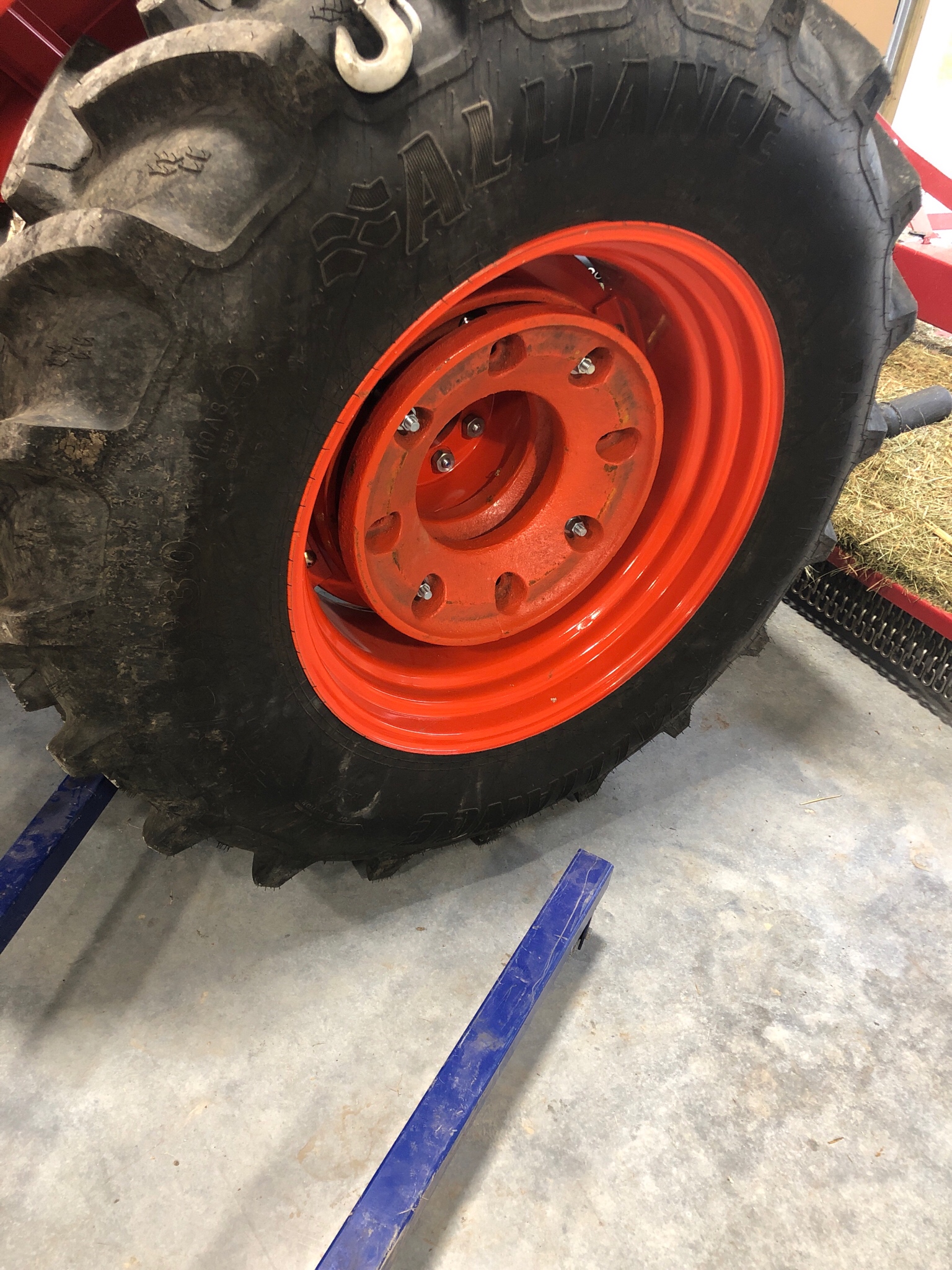

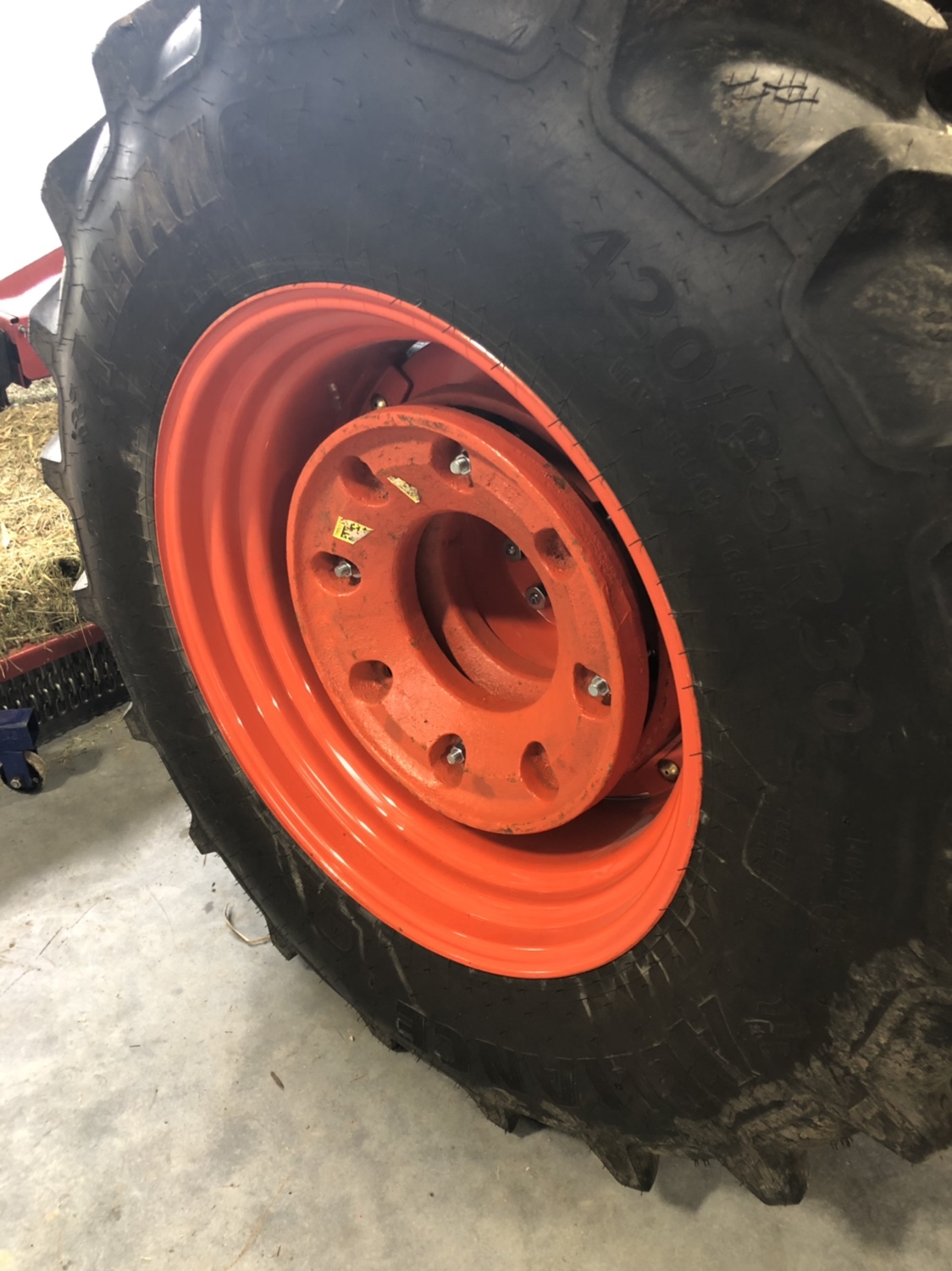

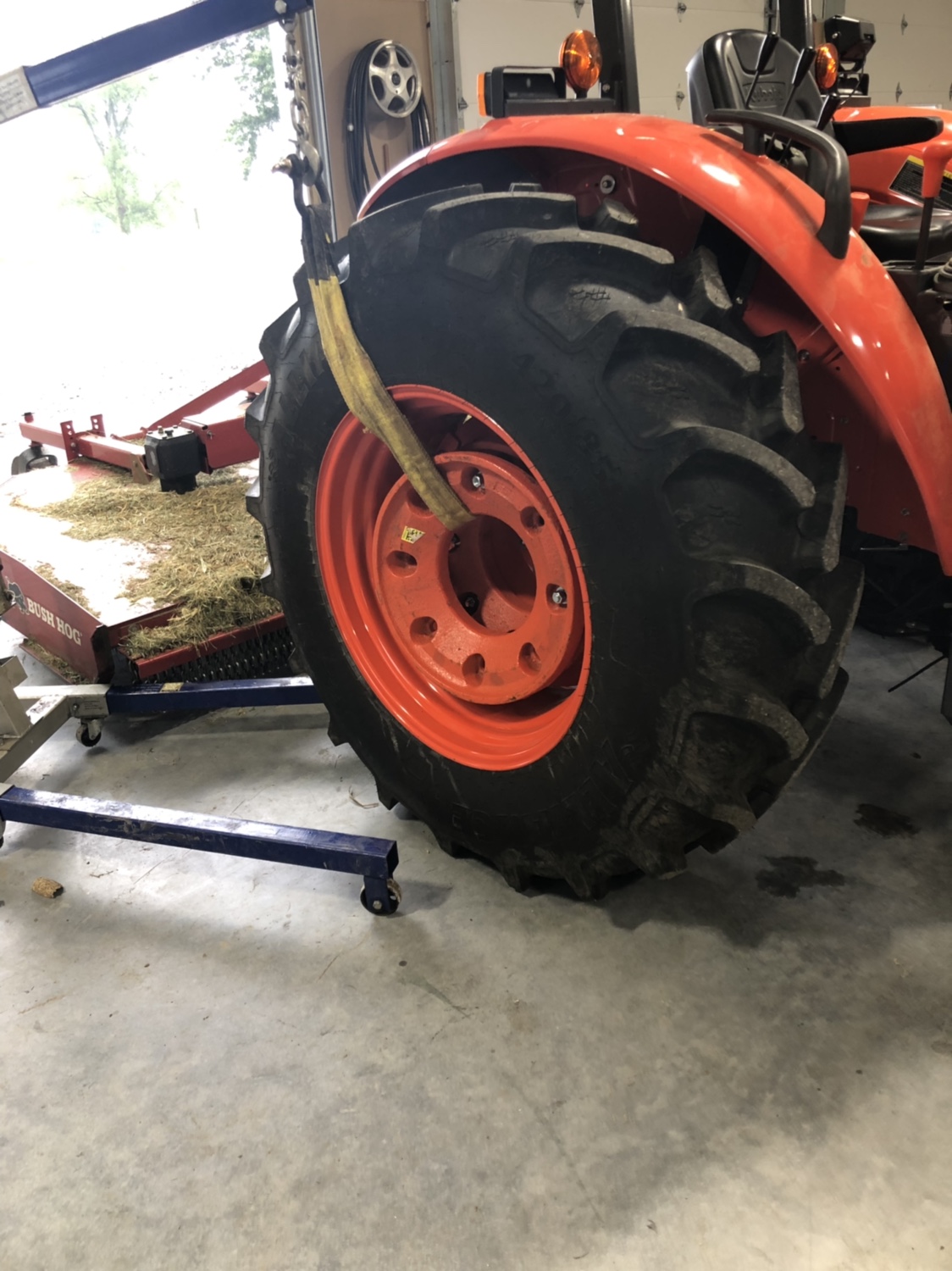

One side of weights on! The weights have been a bit of an issue with the tractor too. When I sent my quote to the dealer it had three sets of rear wheel weights, three per side. And it is worded (in my opinion) like each weight is 164 lbs. so I thought I was getting three sets of rear wheel weights each weight weighing 164 lbs. in realty I got two sets (4 total) with each weight weighing 82 lbs. according to the dealer Kubota will only let you hang two weights per side off the cast wheels. He did knock money off for that third set so I suppose he made it right. I may buy another set and put on though. I was worried about them sticking past the rim, and a third set would be perfect.

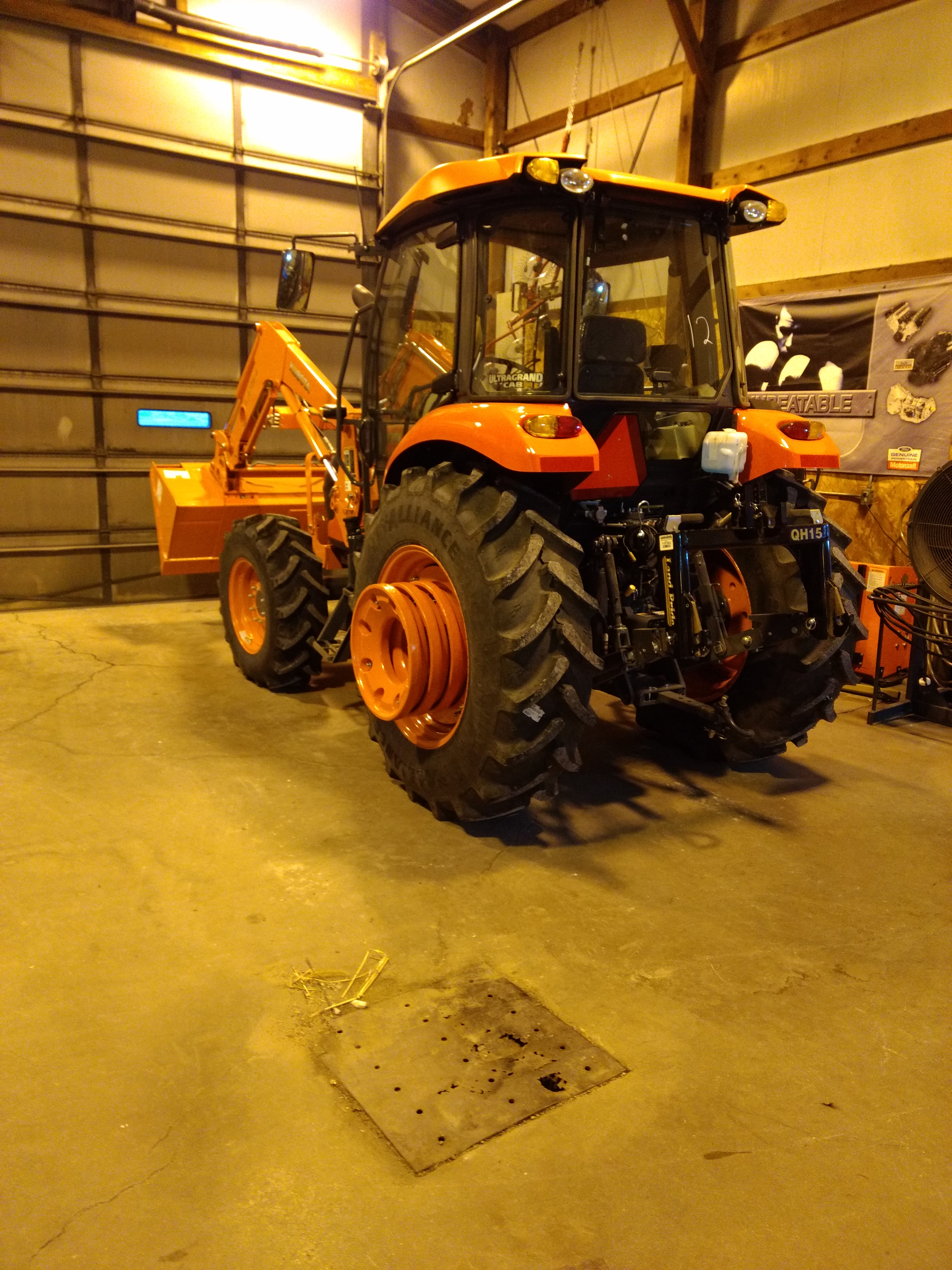

I bought an M7060 cab model, 12 speed last fall, ordered and received three sets of 164# weights to install on the cast wheels. Works great. Phone pics 081.jpg

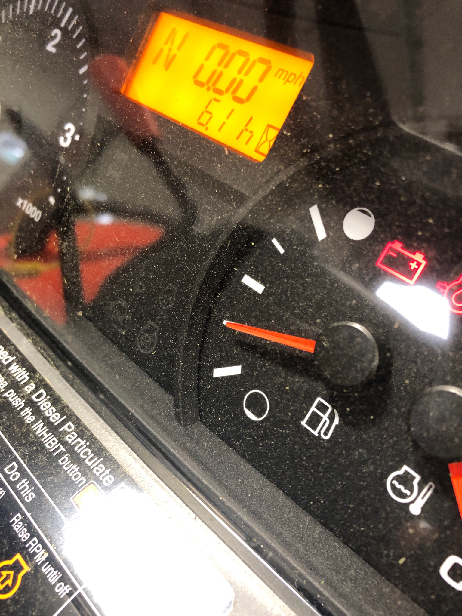

Like a previous poster said - "don't be fooled by the fuel gauge". My M6040 has a 18.5 gallon fuel tank. I fill it to the top of the neck after EVERY time I use the tractor. So when I go to use the tractor - I know the tank is completely full.
I can chip pine trees all day - the fuel gauge say I've used a quarter tank of fuel. However - when I fill it at the end of the day - it will take ten gallons. Chipping uses right at, a little more than, a gallon an hour.

I bought an M7060 cab model, 12 speed last fall, ordered and received three sets of 164# weights to install on the cast wheels. Works great.View attachment 618585
I did read in my OP manual yesterday that Kubota suggests only two sets of weights per side with cast wheels. I can't imagine that third set would cause any issues, but it gives Kubota an out if something were to happen.

I have found with my 7060 and cutting, I'm using about 1-1.25 gal/hr. This is with a 6' cutter on the 3-point. The ROPS model has an 18 gallon tank. For you to use 13.5 gal in 5 hours, that's seems really excessive. Maybe the tank wasn't full when you started?
Also, you are correct in that ePTO reduces RPMs about 400 RPM when working at a 540 PTO speed. I like ePTO a lot.
