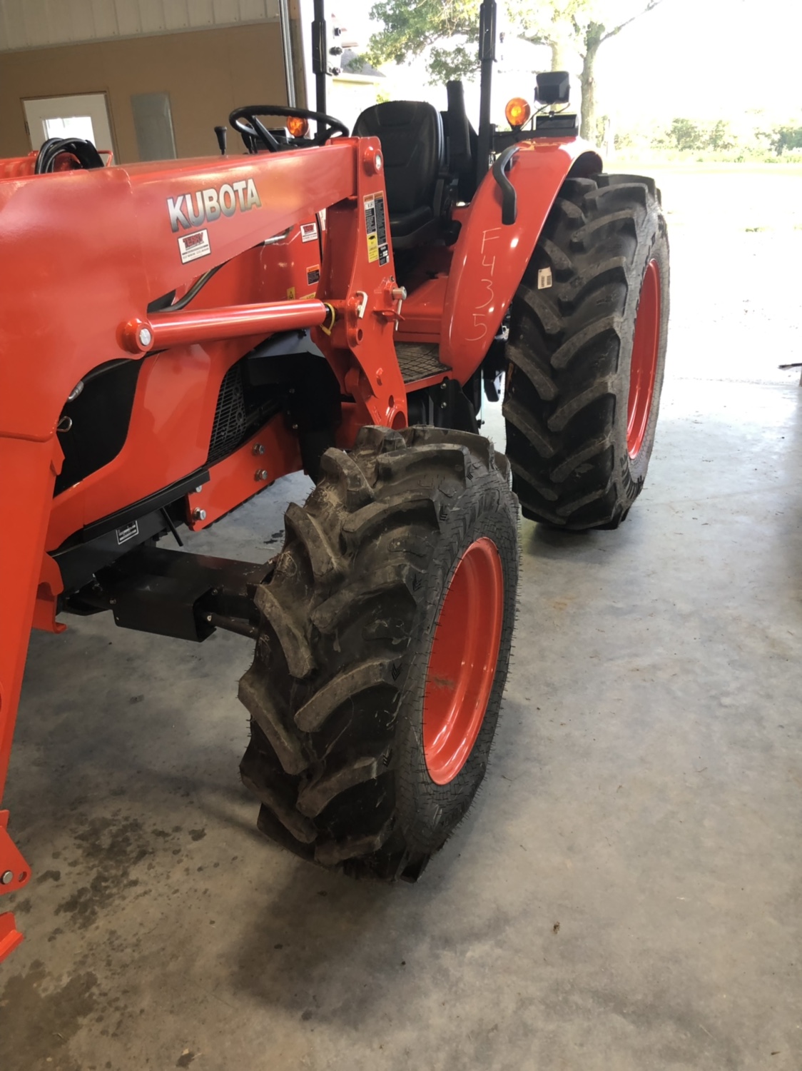

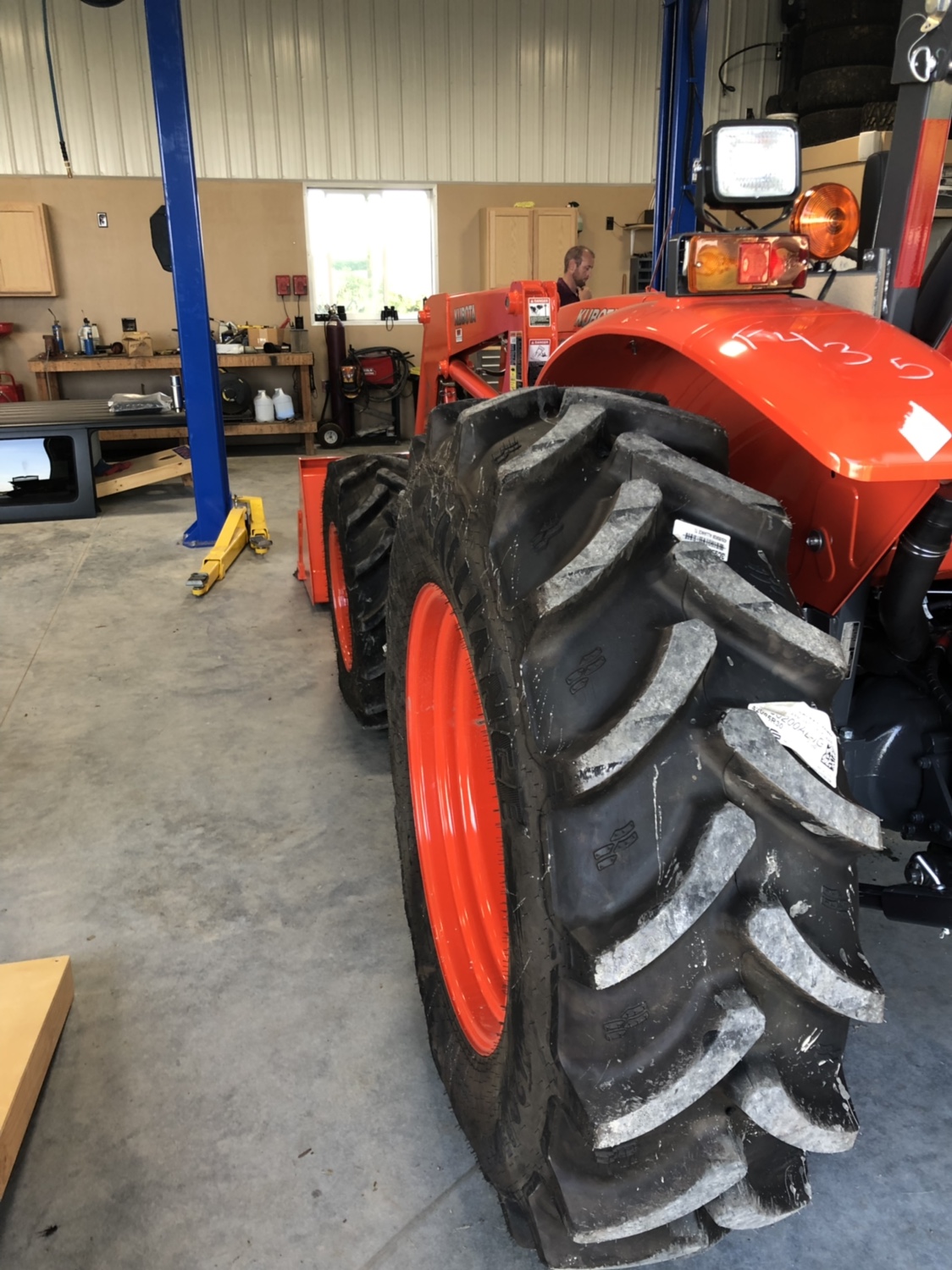

Finally got the new tractor Friday afternoon. Doesn't have my weights, third function, or canopy installed yet, but I was tired of waiting and needed to get some things done so I took it as is. I'll put all that other stuff on as time allows.
Brought it home and moved the front tires side to side to get maximum width out of it. The dealer said that Kubota has a strict policy about moving the front wheels out so they wouldn't do it, but I was welcome too. Its perfect, now both front and rear are right at 84 which is the same width as the bucket.
The left front tire does contact my down exhaust at full crank, but its not bad, and I think I can modify the pipe and it will be just fine.

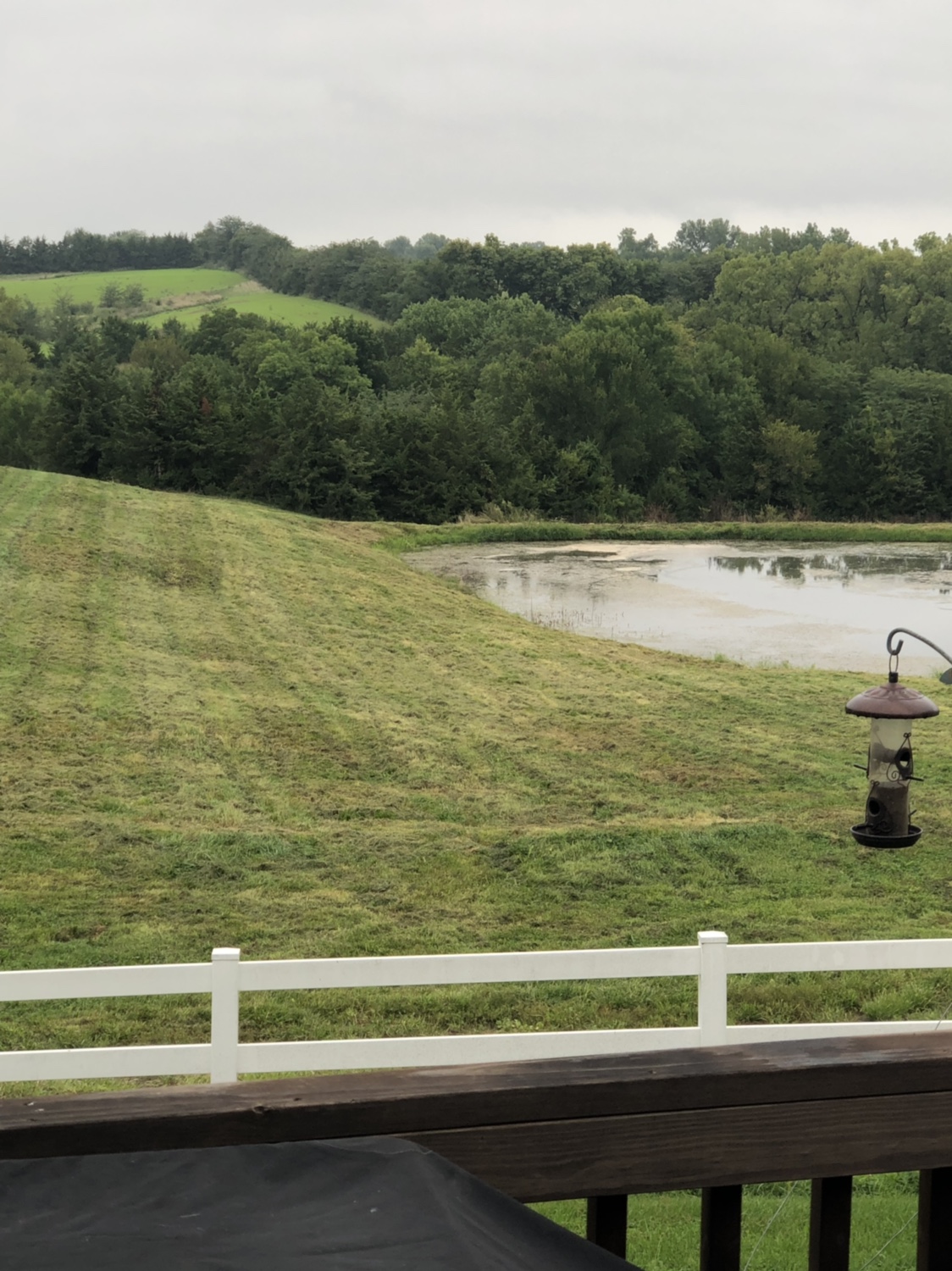

Ran it 5 hours yesterday mowing pasture behind the house. I love it! Its a WAY better machine than the Massey Ever thought about. Pulled my 8ft Bush Hog with ease. Mowed some pretty heavy stuff and it never bogged down at all. Feels pretty stable so far, but I'm still getting used to it. I don't have a level spot on my 20 acres, and there are a few spots that can make a guy nervous. I love the bigger radial tires. Mowed in 540rpm and 540E both just to try it. Both worked well. Lowered the RPM about 400 rpm between the two. I'm not for sure how much fuel I really used yesterday, but I used 3/4 of a tank in those five hours. Makes me think the tank isn't a very big, or it's really drinking some fuel. Hopefully that might get a bit better as it gets broke in.

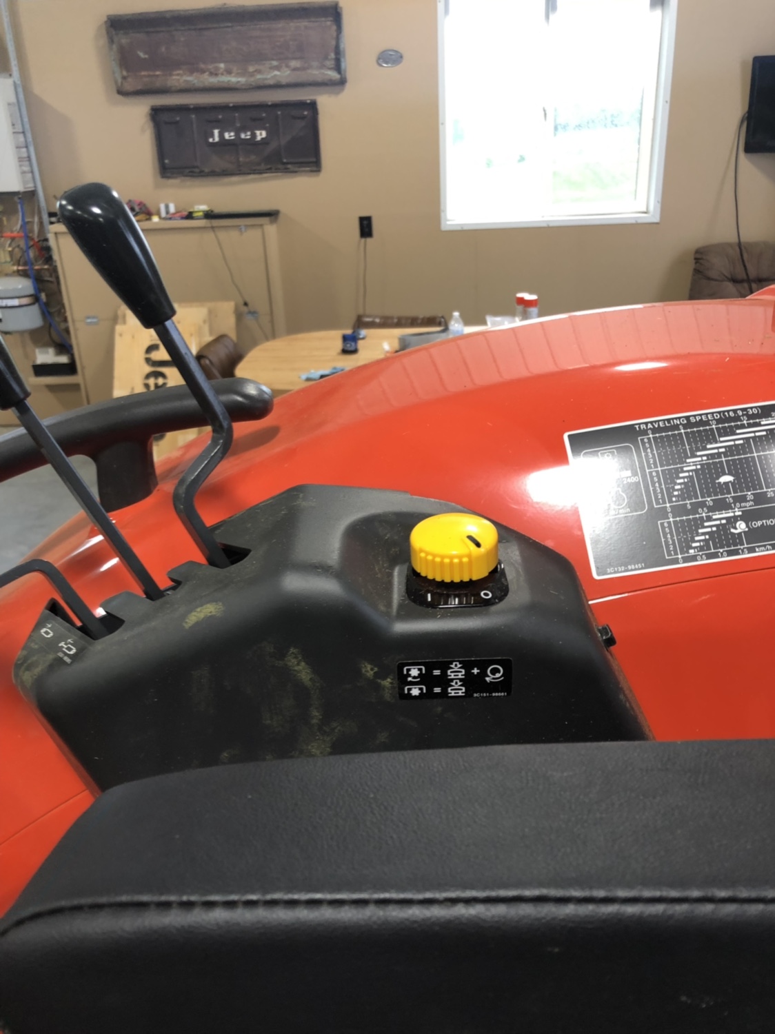

One other small complaint I have is the PTO switch. In its current location when I am holding on to the handle on the fender my arm lays right across it and kicks it off once in awhile. In Kubota’s defense your probably not supposed to be on a bank so steep that you are holding yourself in the seat with that handle.IMG_3413.JPG

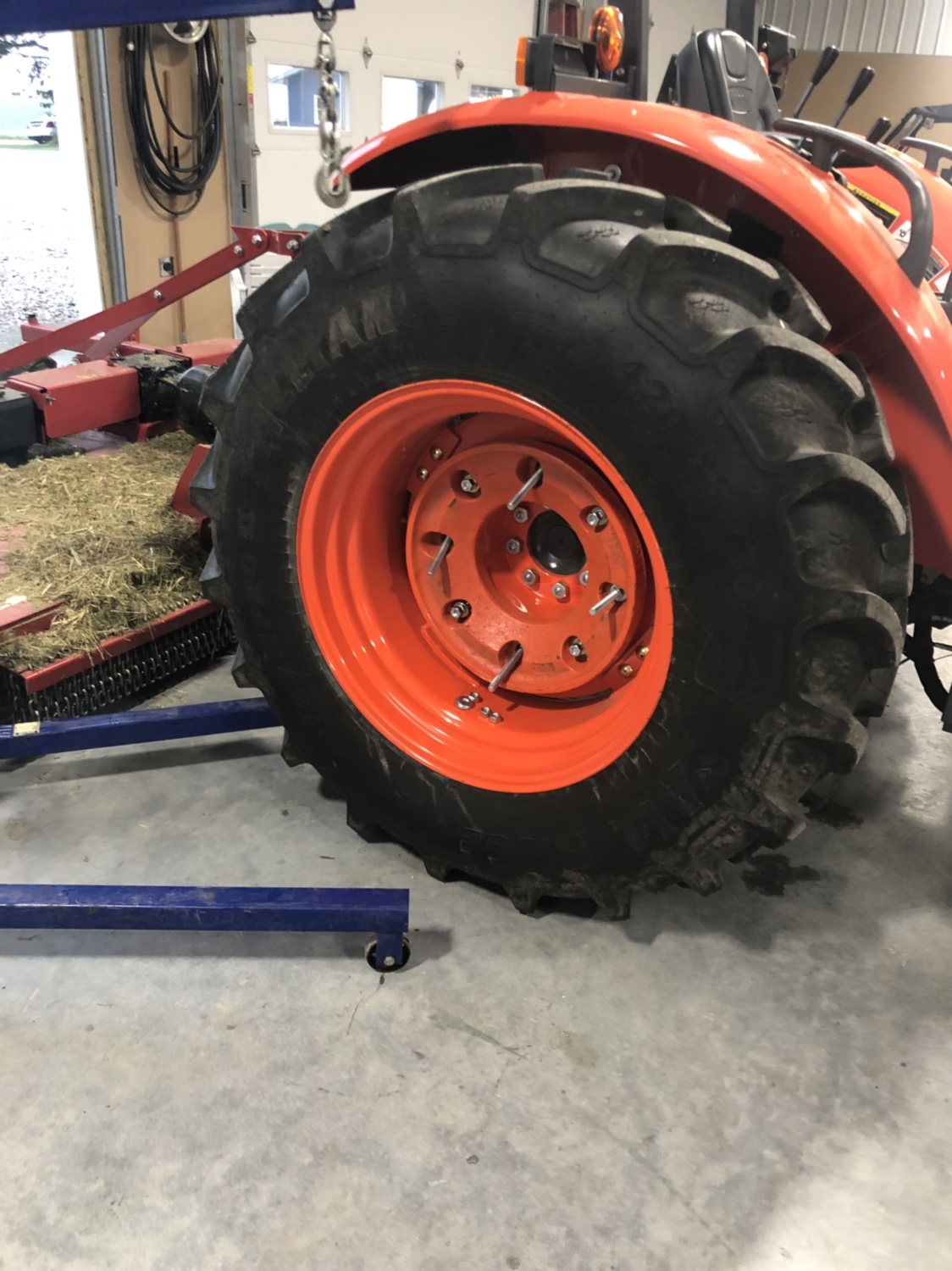

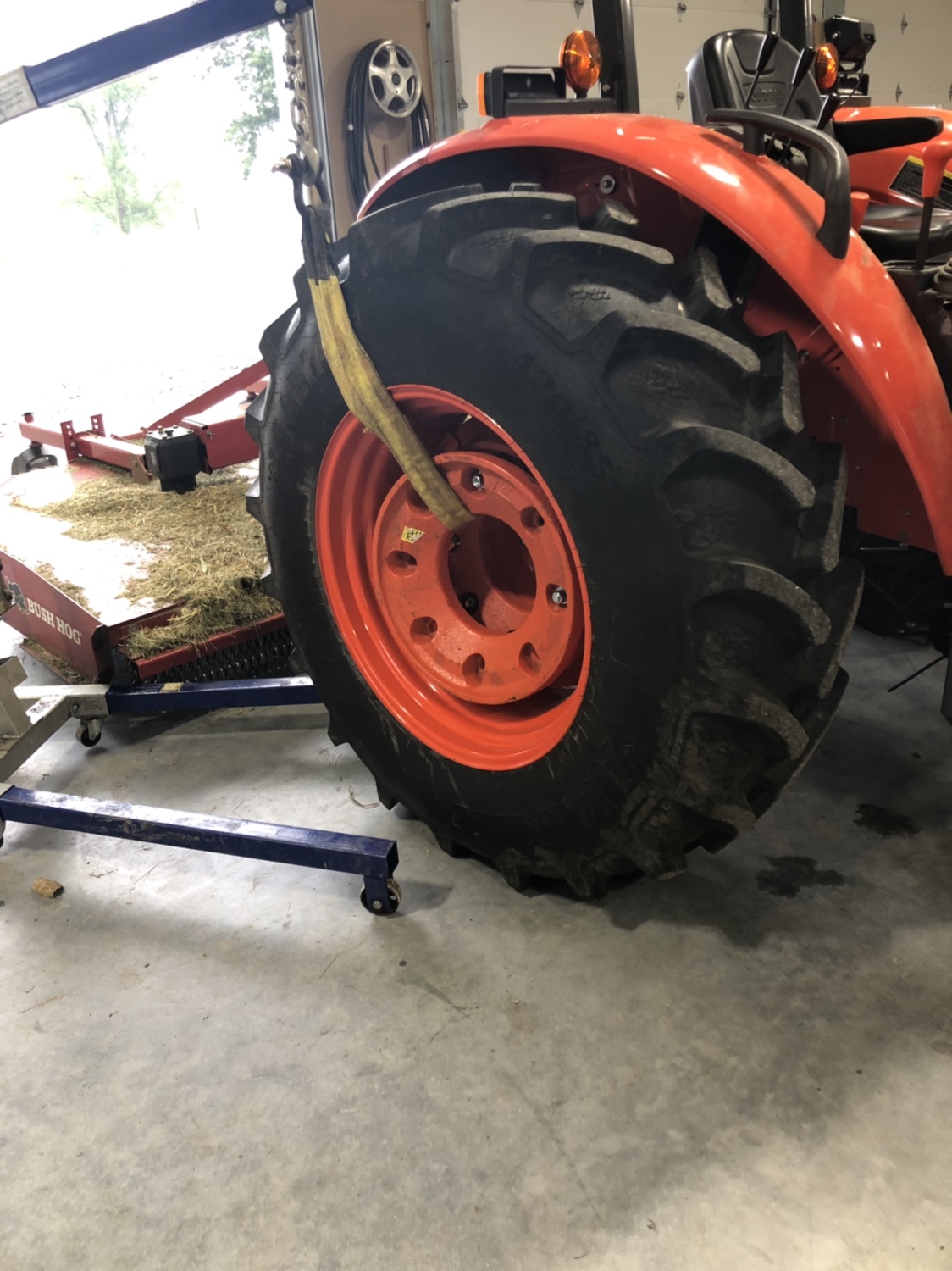

One side of weights on! The weights have been a bit of an issue with the tractor too. When I sent my quote to the dealer it had three sets of rear wheel weights, three per side. And it is worded (in my opinion) like each weight is 164 lbs. so I thought I was getting three sets of rear wheel weights each weight weighing 164 lbs. in realty I got two sets (4 total) with each weight weighing 82 lbs. according to the dealer Kubota will only let you hang two weights per side off the cast wheels. He did knock money off for that third set so I suppose he made it right. I may buy another set and put on though. I was worried about them sticking past the rim, and a third set would be perfect.

The two set limitation is dumb, as you doubtless have figured out. If you were to fill the tires you would have more than 250 lbs in each. There’s no restriction on liquid ballast.

It will probably end up with washer fluid in the rear tires. I can buy it super cheap at work, and this tractor will always be parked in a heated shop so I’m not worried about anything freezing.

One other small complaint I have is the PTO switch. In its current location when I am holding on to the handle on the fender my arm lays right across it and kicks it off once in awhile. In Kubota痴 defense your probably not supposed to be on a bank so steep that you are holding yourself in the seat with that handle.View attachment 618488
I wonder if we can move the existing handle rearward? Or design another one rearward from that one?

If the power of your FEL versus weight of the tractor is similar to my M9540 you'll probably need fluid. I have cast centers and one pair of weights plus liquid and I still carry a BB for ballast.

The wife helped me get the other side!

I had to have bucket weight yesterday and I’m glad the bucket is as big as it is. I was backing over the pond bank to mow it and a couple of times I thought I was going to go over backwards. Went and got a big ol scoop of black dirt. Still felt like I was going to tip over backwards but just kept telling myself there surely wasn’t anyway I could.
