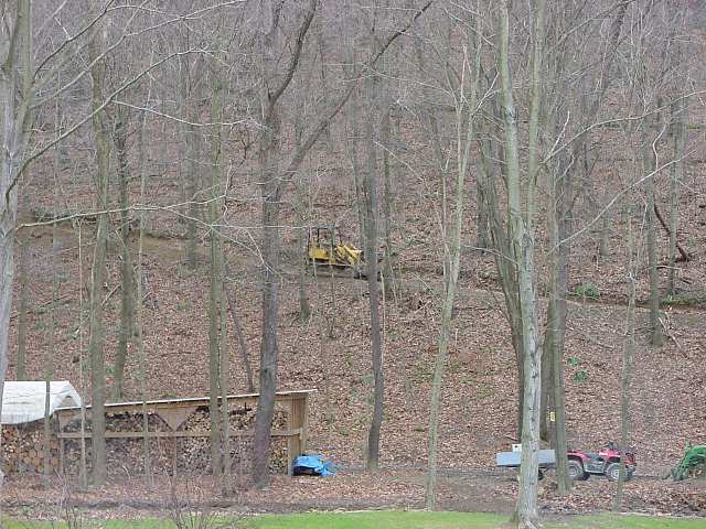

It seems time is of the essence but is getting a dozer in to cut trails to traverse the hills (to each terrace) an option? Long-term solution?
I have a very large hill also. There was no way my tractor (JD 770 4wd) nor my Kubota RTV (UTV) nor any of my ATV’s could make it up without me cutting trails to traverse the hill.
Depending on the weight of your sprayer, I don't know if the RTV could get up if your tractor can't. I’ve hauled a lot coming down the hill with the RTV but never up. If you were considering a RTV, I’d see if you could have a demo done on your hill before purchasing.
What kind/size tractor do you have? Is the sprayer mounted on the tractor (if so, where?) or does it tow behind?
Attached is a picture of the bottom of my hill. If you look closely, you can see the trail zigzag (back behind the dozer). The hill goes back about 1050’ but elevates about 300’.
