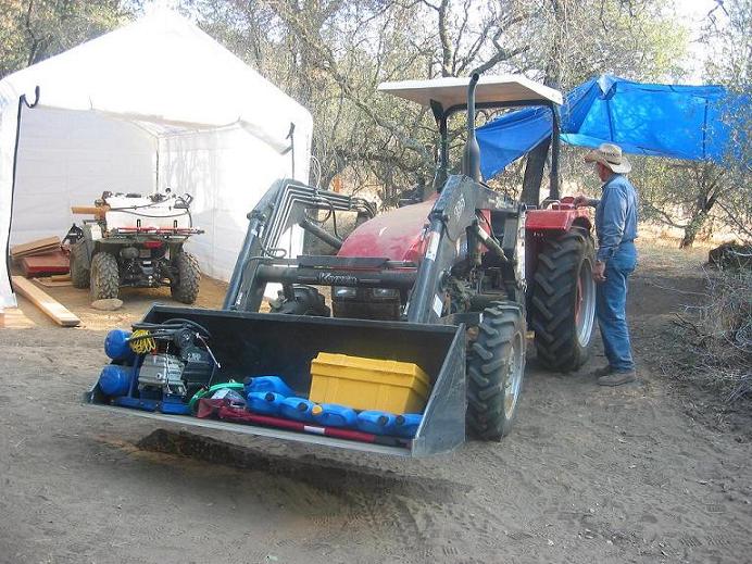

Is your tractor 2wd or 4wd? It will make a difference as how much to fill the tires. Whether you have 2wd or 4wd it is important to have proper weight distribution to maintain stability. Use the tire size/weight chart that Greg provided to tell you how much weight you're adding or the chart provided in the following link.
THIS WEBSITE is what I used as a guideline to fill my tires.
Note that they reccomend a 60% front and 40% rear weight distribution for a 4wd tractor (when static). I also used the "footprint" method they described to determine proper tire traction and inflation after filling. The attachment shows all the stuff I had to take up to my wellsite to fill the tires. I only mixed a couple of gallons of Anti-freeze per tire because it rarely gets to freezing where I am.
Hope you find the link to be useful.
