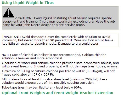

sorry to bother you guys with another question but... everyone on here says to fill the back tires for ballast and stablition. so i called the dealer and was going to have him fill my tires before i picked up my 3032 next week. he says deere doesn't recommend filling them because of the damage to the rims. will this scew up my warranty if i fill them somwhere else?

Your manual says this... I use windshield washer fluid in mine, and has worked fine for over 13 years...and tubeless.
I think your dealer is pushing to sell weights. I add a heavy ballast box to get additional weight, that I pick up with the iMatch so it is easy and quick to add or subtract.
