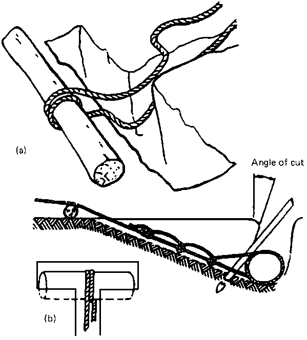

On a sandy beach, bury the spare tire or a log;
