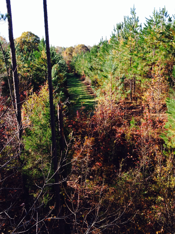

Should be simple. Bush hog it low. Wait for some rain then drill. Oats are easy , will germinate quickly. Then fertilize anytime afterwards. Sitting in a stand now looking at one I planted a month ago.
