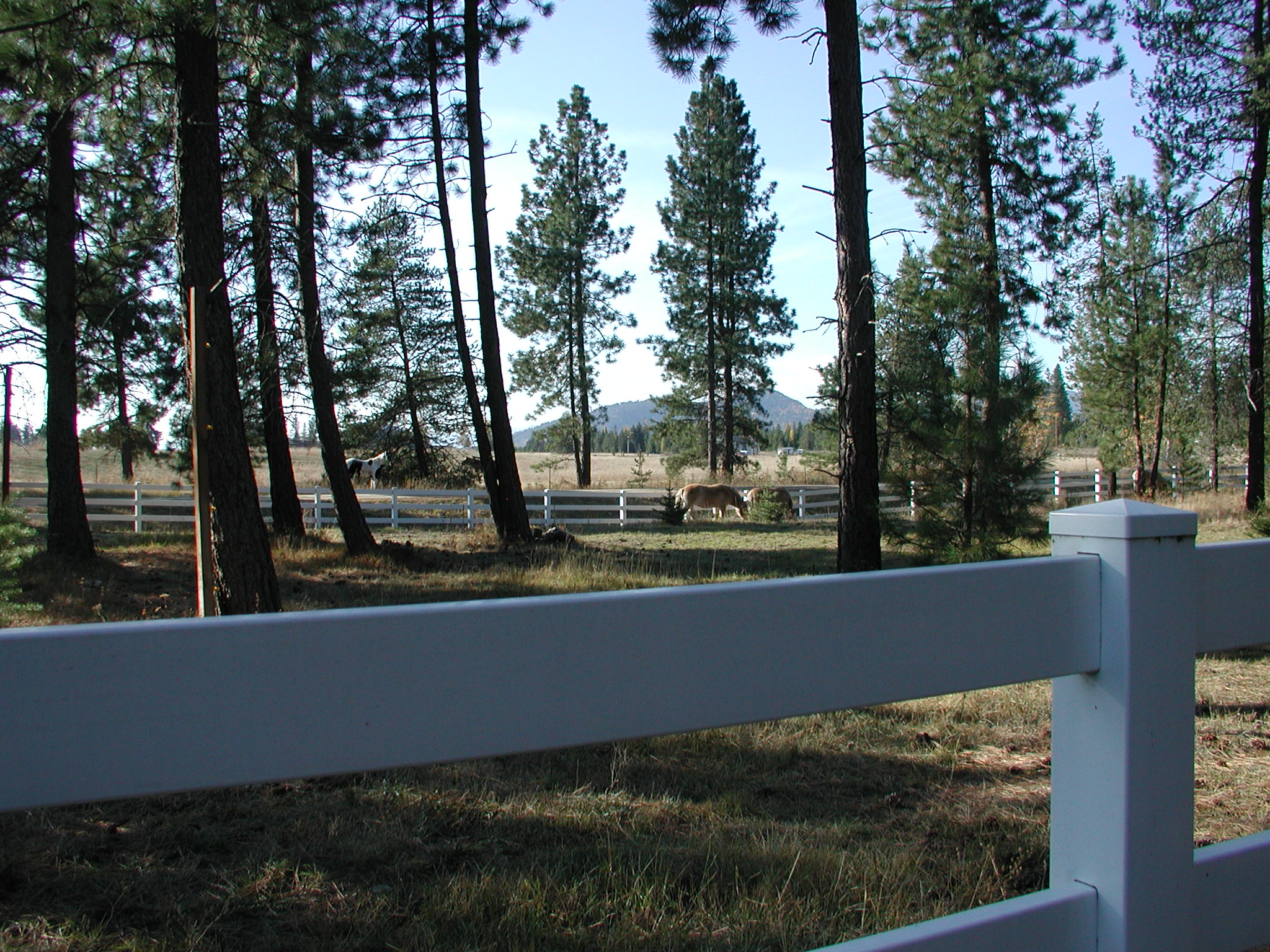

I have alot of fence. My favorite is the 3 rail white vinyl. I intalled 1320' in 2004 and its still like new ... easy to clean with a pressure washer. I did run an electric wire on the inside, easy to do just screw the insulator to the vinyl post ... that keeps the cows, horse's or what ever away from it.
My least favorite is the 3 rail wood around the house ... the weather is heck on it, boards twist, bow, crack and it always needs maintainence.
I also have 5 strand barbed wire, 5 strand horse wire ... yards with cattle panels ...
Again my favorite is the vinyl ... cost more ... but unless a fire comes thru I don't believe I will ever have to replace it.

Also if you go vinyl there is a trick to it. Got to be dead on for the 16' rails they have clips to install on the ends to hold the rail into the post.
You can not just pull up a string mark the holes at 8' O.C. and go drill them all cause you will be off and find yourself doing alot of hand digging.
I pulled up 1320' of poly baler twine as tight as I could without breaking ... put in some t-post to keep the string off the ground. Started on one end and blasted in several holes only to find I was reeming them out to maintain the 8' o.c. then I changed up and I used the actual 16' vinyl rail ... laid in the ground centered on the last post installed and then measured the 8' used the hand PHD to start the pilot hole and then another one at the end of the 16' rail and went on 2 holes at a time installing the rails as I went.
I would also go about 100' up the line and get the string height where I wanted it for the top of the vinyl post use a rubber mallet to tap the post down to the string height, plumb the post, pour in sackrete, intall, the rails and move on.
