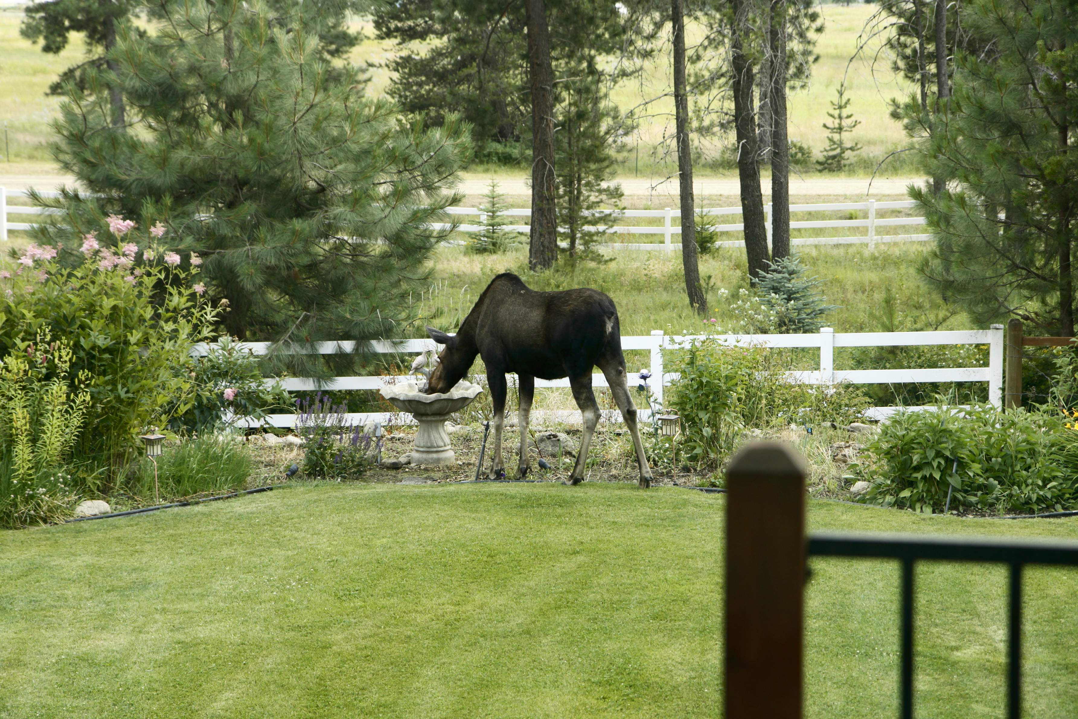

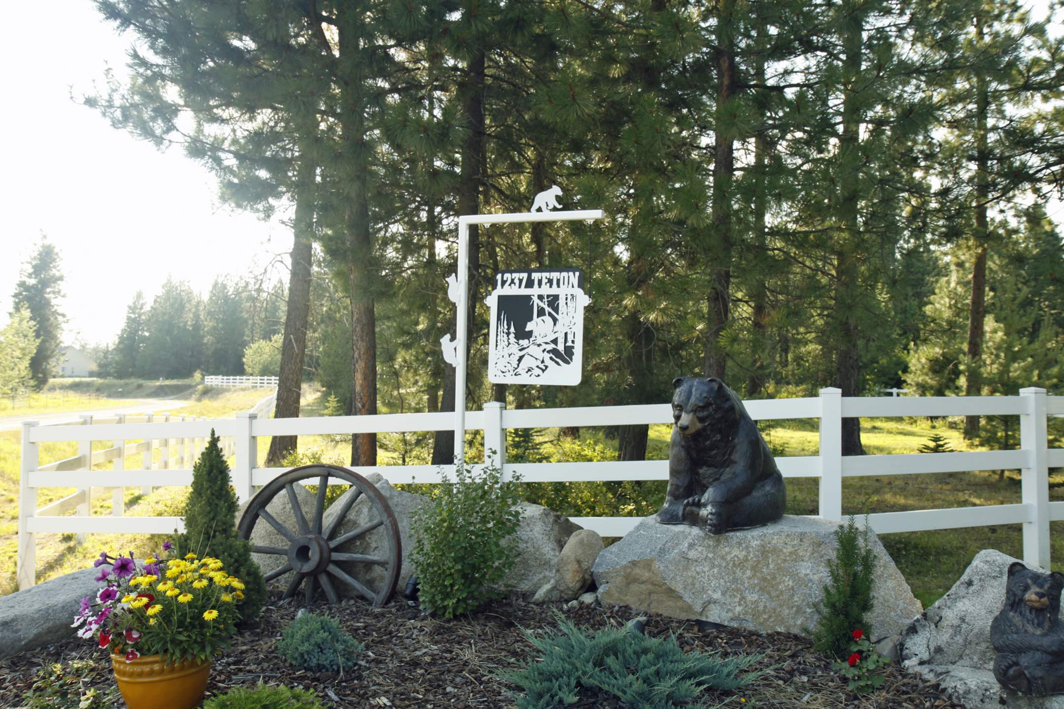

Ive been putting up fence for WAY longer than i ever want to remember. I ended up installing 3 rail white vinyl fence out front ... about 1,200 feet of it if i remember correctly. LOVE that stuff. did it about 8-9 years ago.. still looks like new.
For the rest, i used to use 4x4 treated posts till 3 years ago when a very heavy snow year SNAPPED over 30 of my 4x4 posts.... snapped them like a toothpick.
Now i will only use 6x6 posts. I drill 9" holes 36" deep, then widen them slightly with a hand digger. I tried digging 12" holes but my ground is so hard, i never was successful. I also set all my treated posts in concrete and mound the concrete up at the top to prevent water sitting on the post.
Moose seem to like the fence and drinking fountain...er fountain too
I have friends that swear by 6" round posts, and some even have hydraulic post pounders to set them. I really don't think that they end up going very deep with them though.
I HATE wooden split rail fences, as ive had them in the past and their a maintainance nightmare. Had to paint them every other year to keep them looking half way nice. Split rail fencing just turns black in a few years. Lets face it... real wood sucks for maint.
