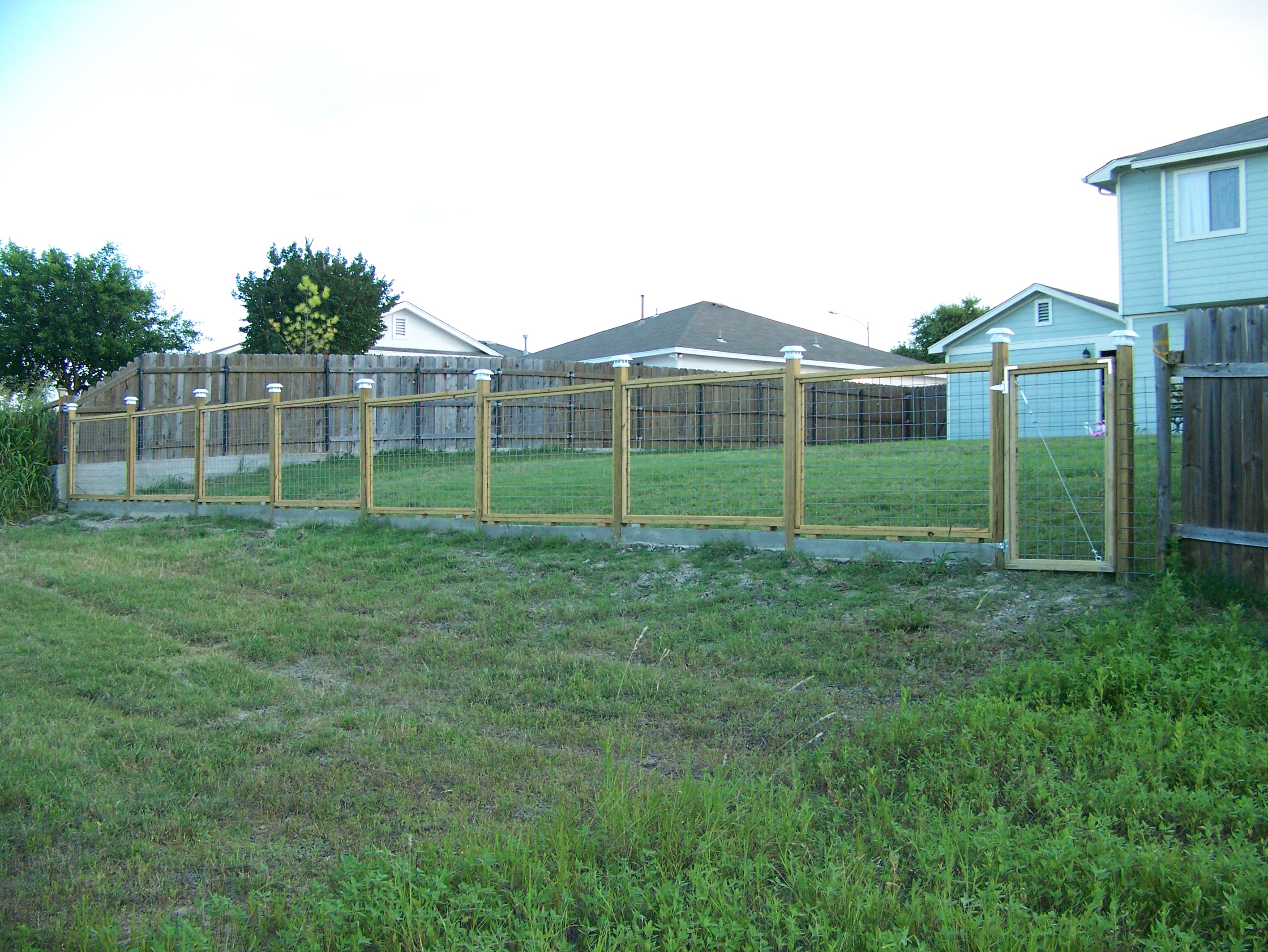

Really love the use of concrete under the fence panels!!!! That's the best, and only way, to stop anything from digging under it.

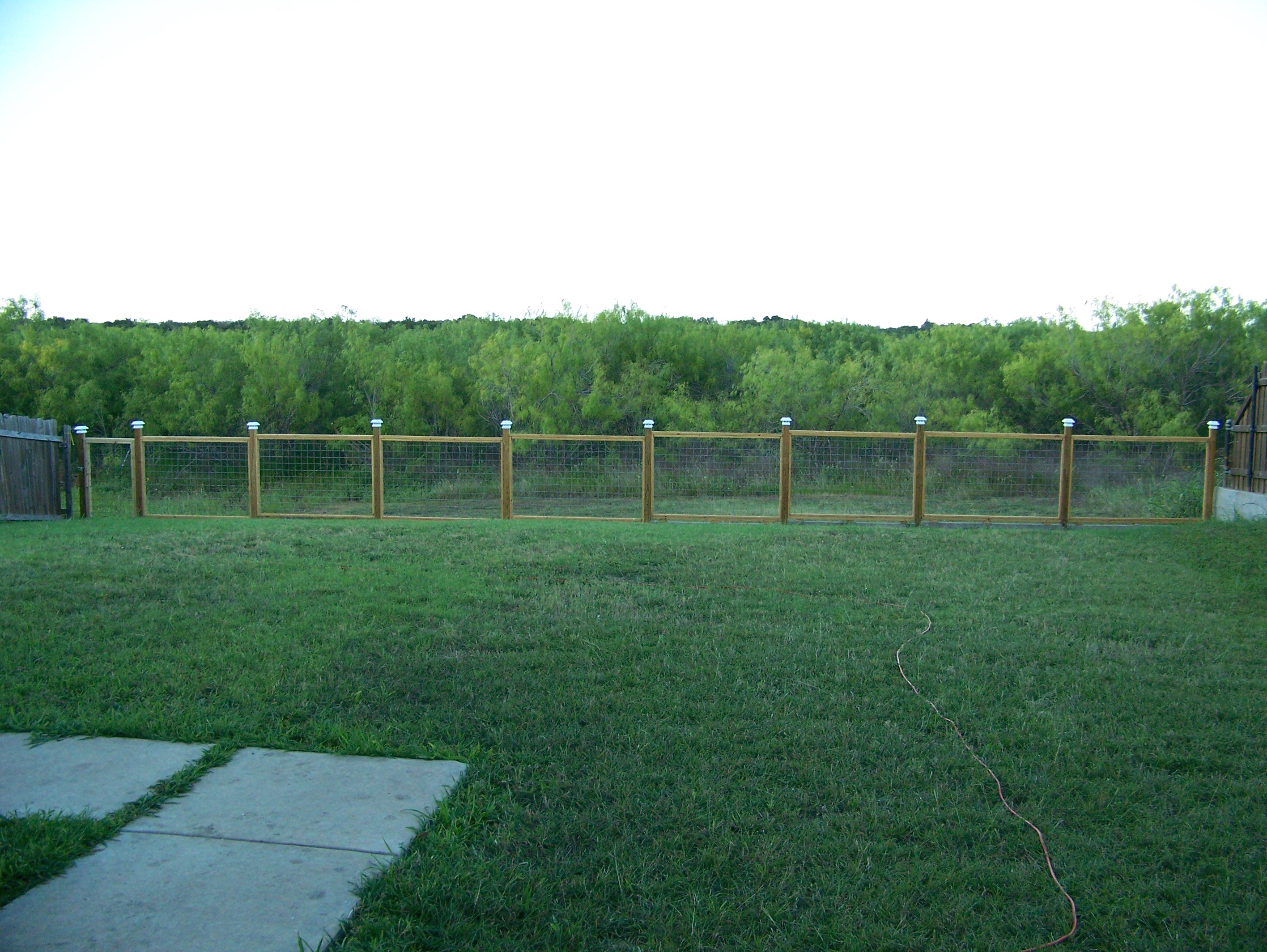

Here is how I solved the sloping problem on my daughter's welded wire back fence I put up 3 years ago..........View attachment 585359View attachment 585360
For anything wire out of square, I just trimmed the welded wire with bolt cutters.
Here is a link to the thread I have on the fence build... https://www.tractorbynet.com/forums/projects/336054-my-daughters-fence.html?highlight=
hugs, Brandi

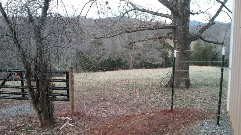

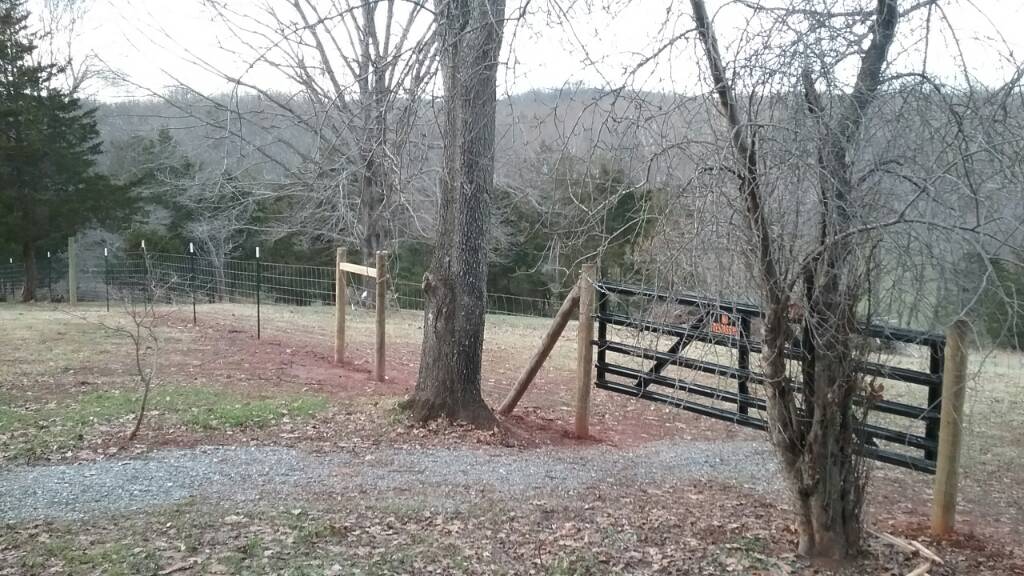

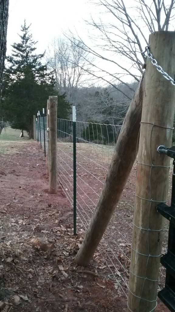

This is what I've been working on. I haven't finished with the T post clamps which is why the bungee cords. I wanted it 8" off the ground so it's easy to mow under. Eight ft. 6" treated posts, I measured and used string and level. I'll have electric on top.20190101_162935.jpeg20190101_162941.jpeg20190101_163017.jpeg20190101_163037.jpeg20190101_163146.jpeg
   / Fence Building #19
you wont be mowing with that 8 inch high bottom, the horses will keep that mowed for you they will be down on their knees taking care of it
