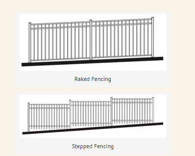

Any tips on how having the planks (rails) follow the slope of the land?
You can Rake the fence or step it - How to Install Fencing on a Slope - MMC Fencing & Railing
If your land, like mine, has ups and downs but not slopped as shown in the example below you can leave your posts out of the ground 56" or greater and follow the recommendations as posted in the RAMM FENCE installation manual.
DETERMINING POST TOP & BRACKET LOCATION • After paint is dry you need to determine the tops of your post. From this line you can determine the bracket locations. Everything, all post tops need to be over 56 inches. • Mark on the side of the post a small line at 54” from the ground. Do this on all posts. • Starting at an end post and using a thick and visible string wrap it around every post. • Make sure it is tight between each post. • Site over the string line and you will see abrupt changes in the flow. By raising and lowering the string line you can make the flow smooth from post to post. • You are looking for the average height of your fence over the entire length. • Make sure you are satisfied with your flow of the string line because this will influence the overall appearance of the fence itself. • Usually look at your string line from various angles. • More than one opinion is helpful. • Keep the corner and end posts string at the 54 inch mark, do not move the string line on them.

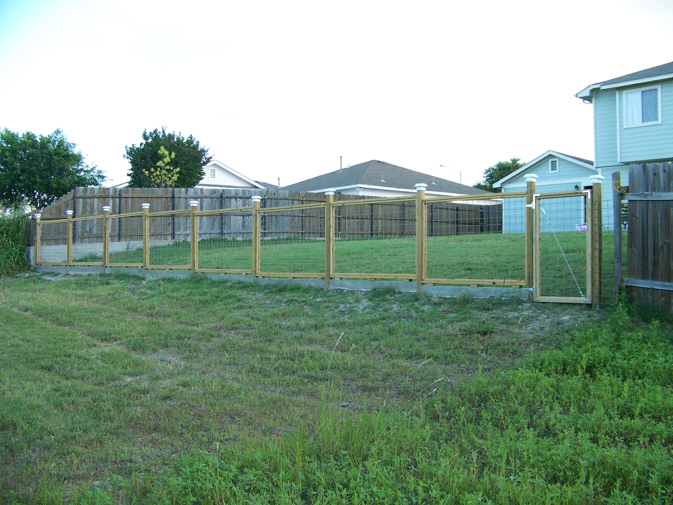

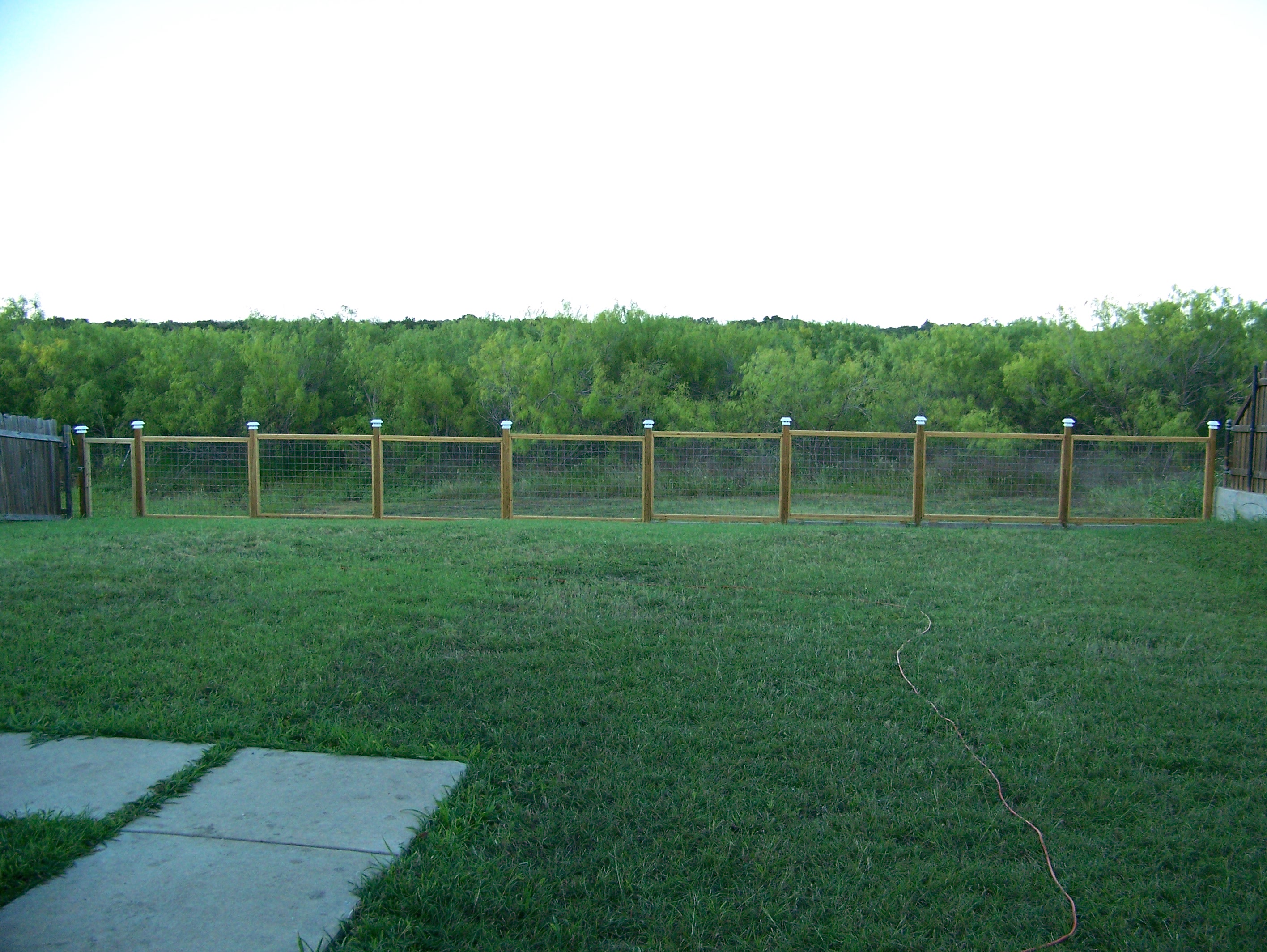

Here is how I solved the sloping problem on my daughter's welded wire back fence I put up 3 years ago..........View attachment 585359View attachment 585360
For anything wire out of square, I just trimmed the welded wire with bolt cutters.

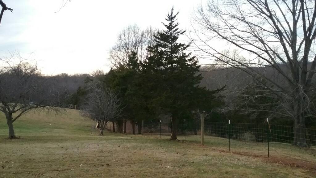

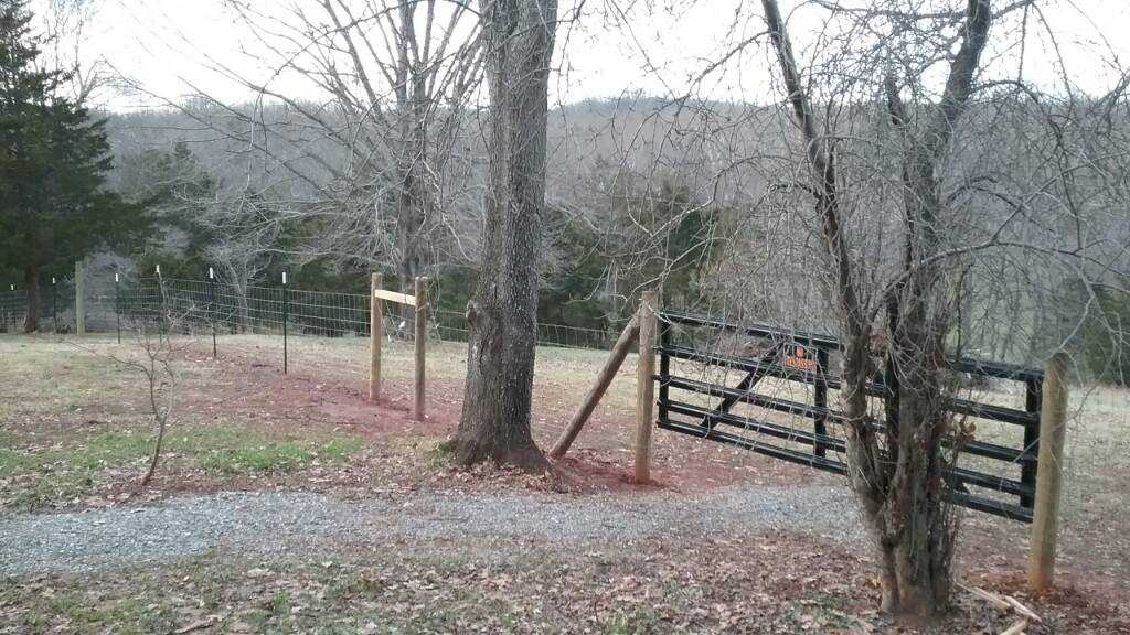

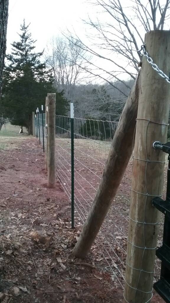

This is what I've been working on. I haven't finished with the T post clamps which is why the bungee cords. I wanted it 8" off the ground so it's easy to mow under. Eight ft. 6" treated posts, I measured and used string and level. I'll have electric on top.20190101_162935.jpeg20190101_162941.jpeg20190101_163017.jpeg20190101_163037.jpeg20190101_163146.jpeg
/ Fence Building #19
you wont be mowing with that 8 inch high bottom, the horses will keep that mowed for you they will be down on their knees taking care of it
