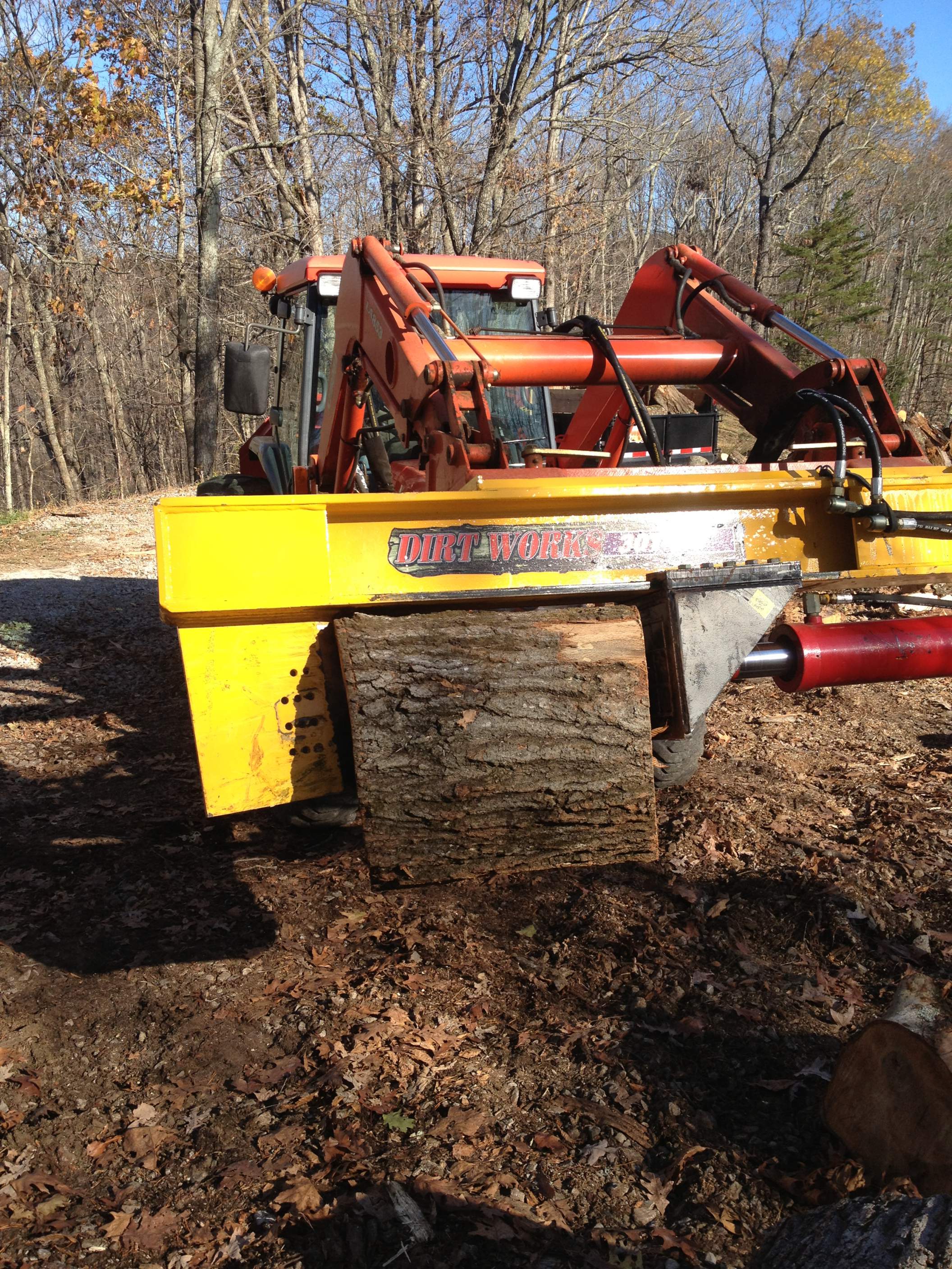

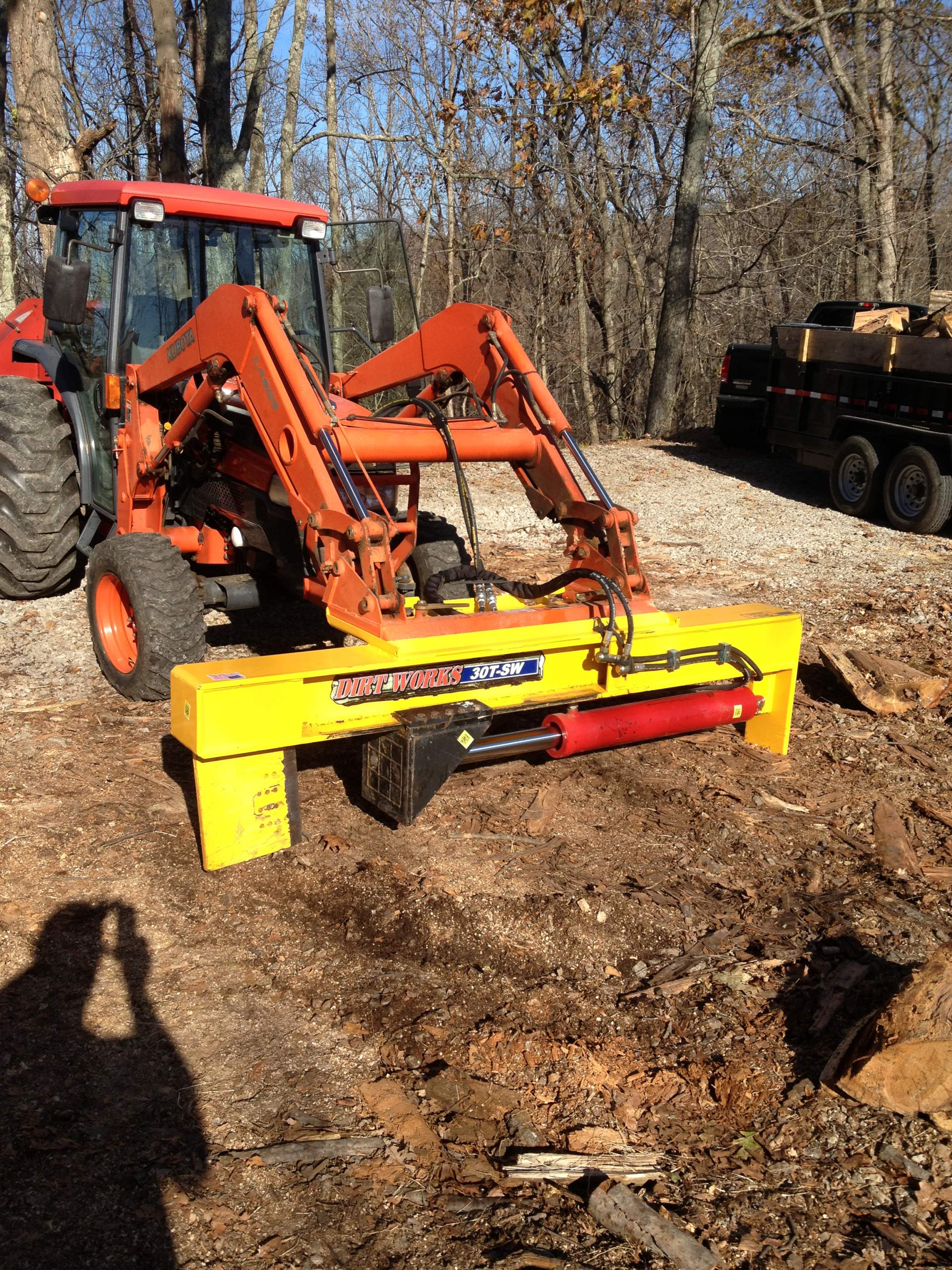

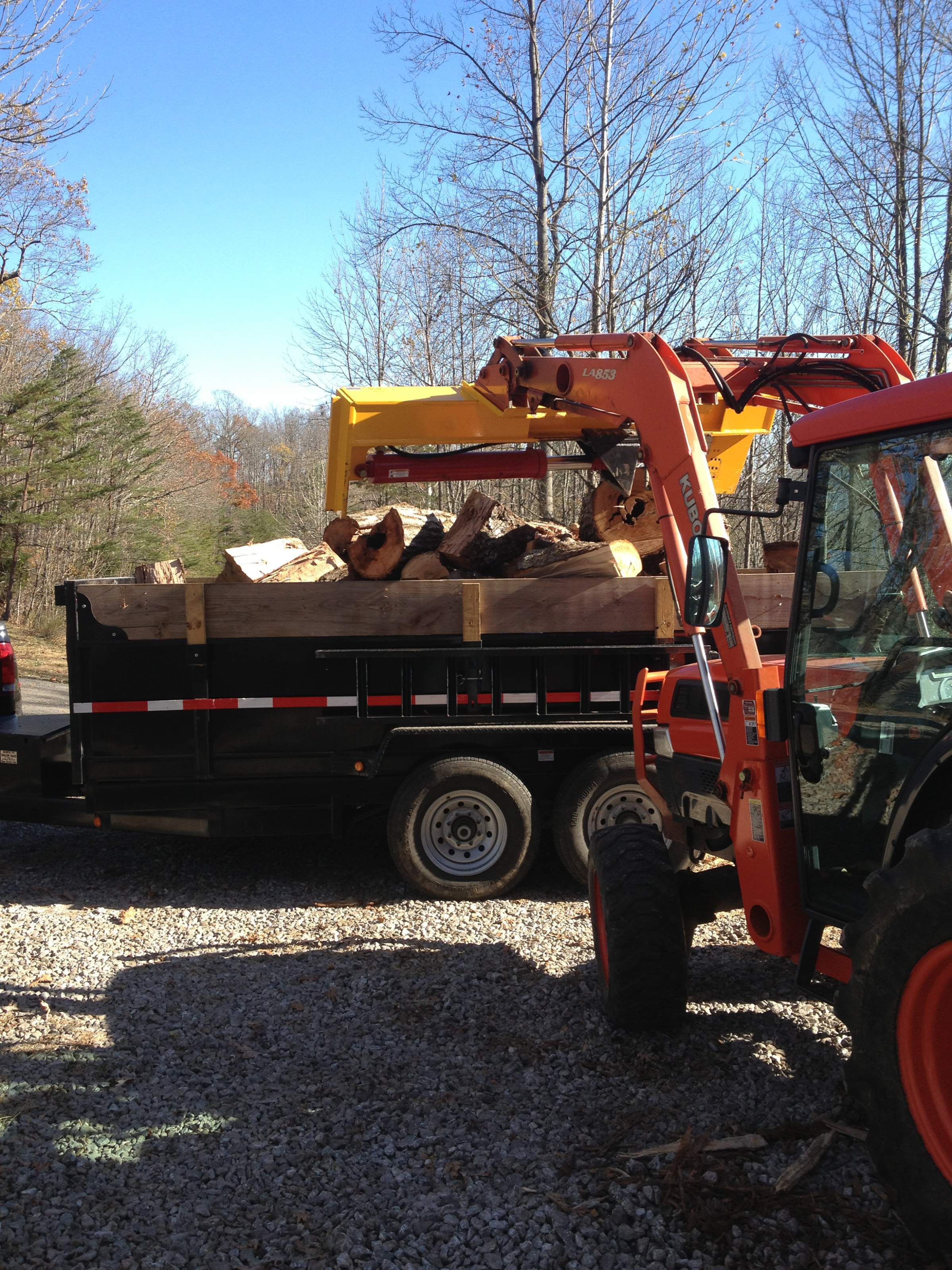

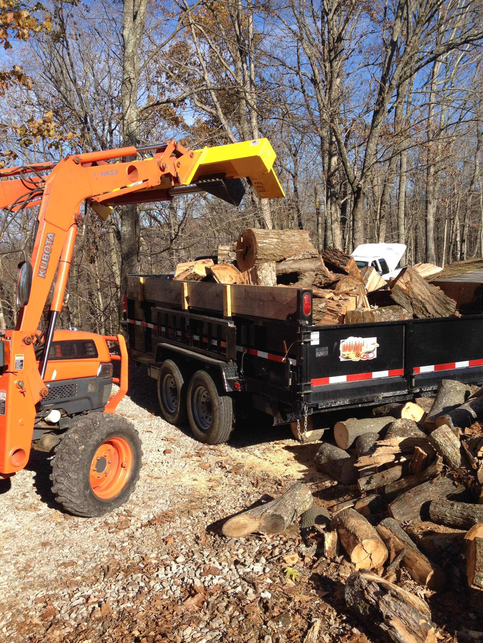

I got my splitter on Friday and I'm glad I did, splitting and handling the wood will never be the same. I quarter the large pieces of wood and let them fall into my dump trailer, then I haul it to my splitter. I raise the dump bed with the tailgate on the trailer shut resulting in never having to bend over and lift another piece of wood off the ground. I touch the wood one time (by hand) and that's splitting it with the SuperSplitter and stacking it. I love the visiability with the sideways splitter and cycle times are not bad at all. By the time I get the tractor turned around the splitter is open and ready for the next piece.
I give this splitter two thumbs up for ease of use and keeping possible back injuries at bay. Tomorrow I begin teaching my wife proper operation so I can continue sitting in the lawn chair with a cooler close by. Supervising is a true art and I must continue mastering/perfecting it.
View attachment 288276View attachment 288277View attachment 288278View attachment 288279View attachment 288280
I know this is an old post but I'm building one of these splitters on Friday. I noticed you're not using the wings on the wedge for the 4-way split but you also said you quarter the rounds. Is there a reason you're not using the wings? Didn't know if perhaps you didn't purchase them of you did but didn't like them?

The wood I was splitting was of all different sizes and the wings that created the 4-way wedge was splitting the smaller diameter wood into pieces too small for what I like so I took them off. On the larger wood the 4-way wedge was perfect. The splitter I have has 3 different heights I can mount the wings and I should of tried the different heights but I was in a hurry. I will mount them at the "half-way" height this week which will allow the smaller wood to be unaffected by the 4-way and just be split in half. I'm thinking of doing a video and even mount a Hero HD camera on the splitter itself to enhance the video, will see.
