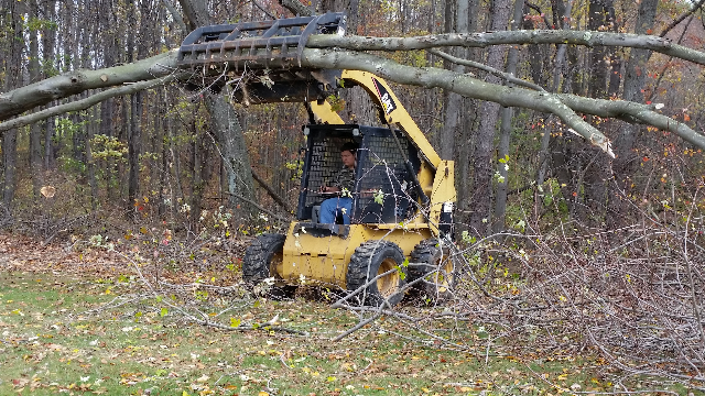

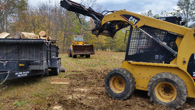

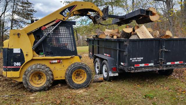

I'm still here and i check in,spend most of my time in the ventrac and ford forums..,i get busy and dont have time for the internet except for stuff i have to do,not fun stuff like coming here ;).Just a note on my splitters pressure,the machines relief valve hits at 3335 psi,not 3000psi,and i dont think ive ever hit it....nothing to stop it yet...and to answer the question on why such a long beam,because im loading my dump trailer with it directly,and it makes visibility much better when splitting vertically,id be looking at the back of the attachment plate if it was shorter...im very glad its this long,its worked out great and it still easily fits in the bed of my pickup,so when i transport the ,machine with the grapple on it i lift the splitter into the bed of the truck with the grapple and load up and go.i just finished using the splitter hard for a week here,ill put some pics up soon...my boys use the splitter more than me i preffer to do the cutting.
/ Homemade Skid steer log splitter
#19
Here's a few pictures from this season's wood gathering... I admit it I cheat a little, using my two and a half yard loader to take out the big trees and we hand load its bucket with anything that doesn't need to be split, it then goes right in the trailer while the caterpillar walks on breaking down the big stuff it goes pretty quick with just me and my 2 boys. With a pair of 372 XP s, one of them ported, bucking logs goes pretty quick too
