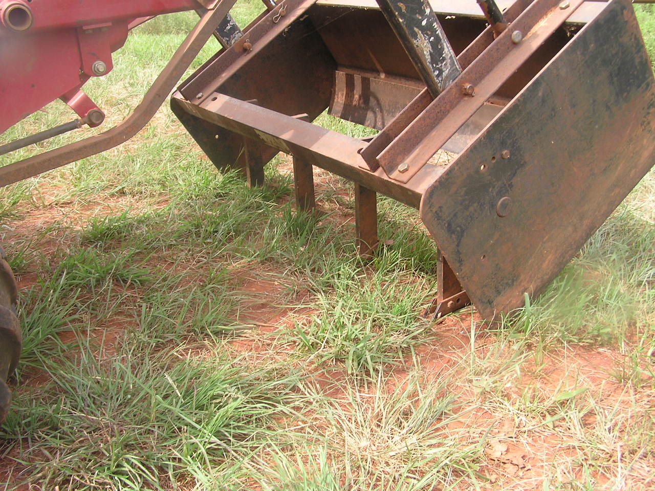

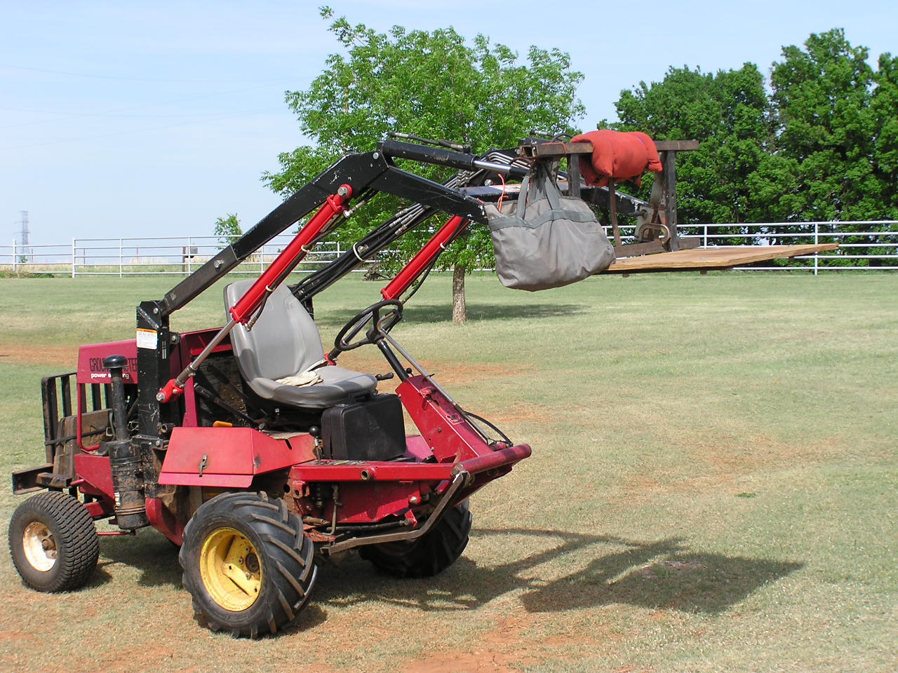

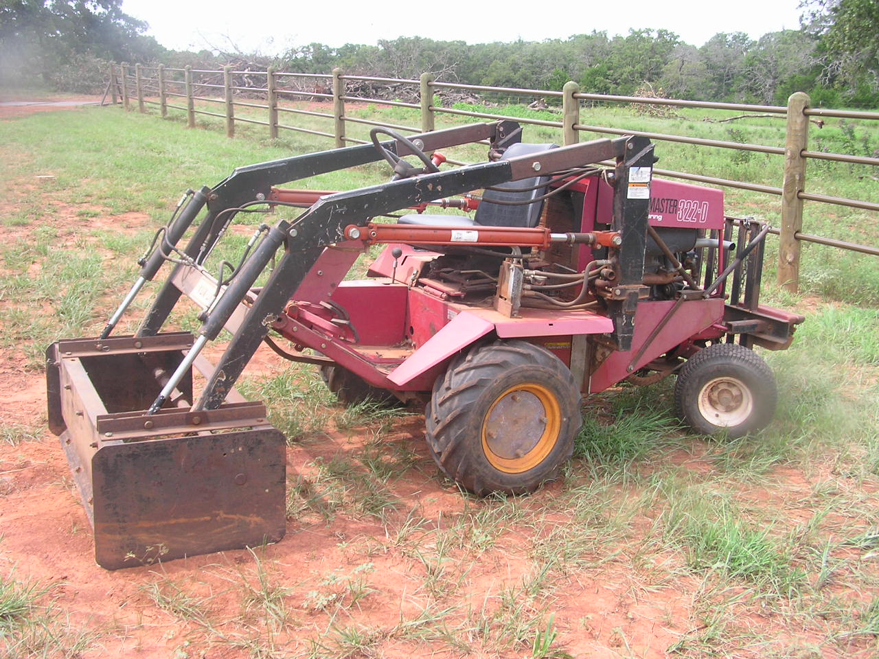

Millnturn, thanks for the kind words and good luck on your build.
Your idea of lifting the deck with the loader looks good on paper, but you need to remove the deck, (read the manual first), drive the traction unit around, come back and put the deck back on. You might decide to make it strictly a loader.
Your model number is 30795. If you don't have a manual you can download it from: Toro |
The quick attach is a good idea, but I think skid steer may be too big. Most skid steer attachments are heavy. check the size of the mini track loader QA plate, it is an industry standard also. Attachments and TORO Dingo: Compact Utility Loaders, Dingo Compact Utility Vehicles | Toro
I like the single arm loader, my V417 has one. 👍 But I have no trouble getting on or off my two arm loader no matter where the arms are.

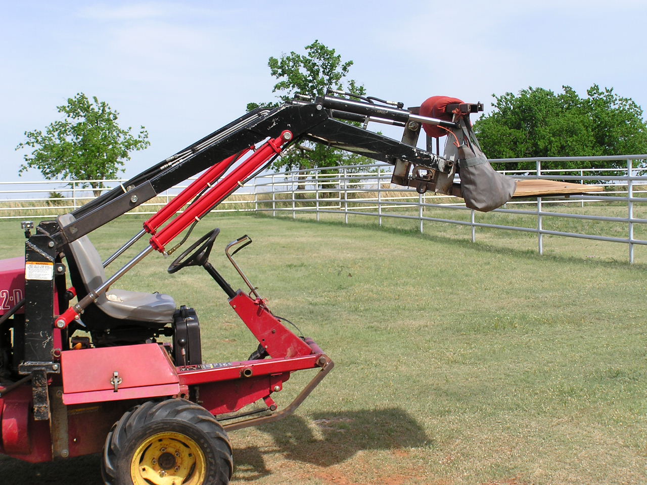

Looking forward to your build thread. Maybe you can get some ideas from this amazing little TORO Loader: It was a TORO GROUNDSMASTER 217D
Feel free to PM me with any questions.
/ FEL, TORO Groundsmaster Put Together #62

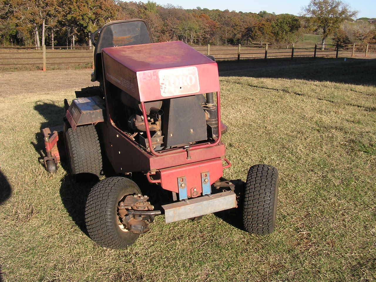

Xfaxman,

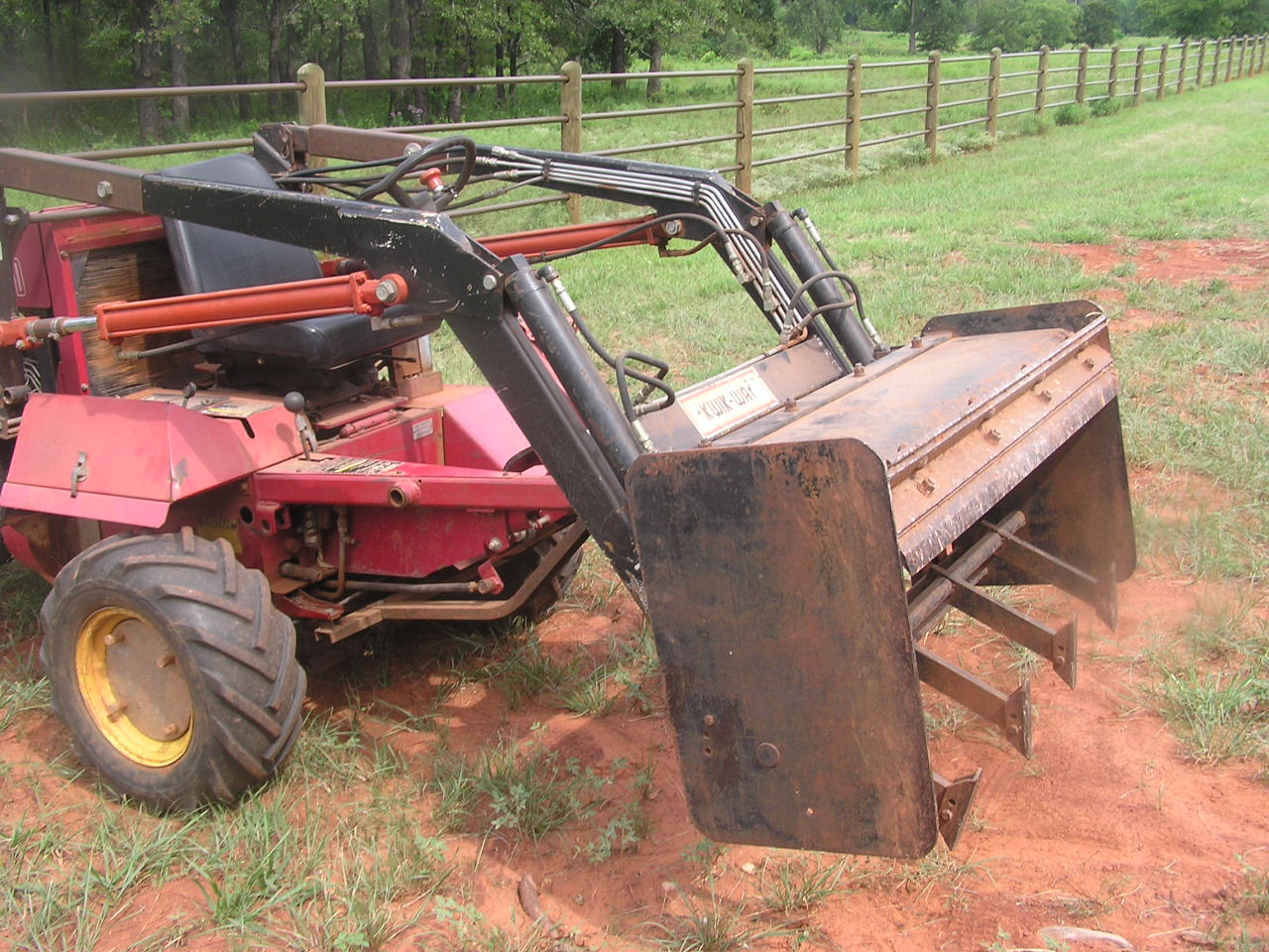

Thank you for the comments. All good thoughts and advice. As I said, I just got the machine, the gears are turning, but fabrication has not yet begun. I am sure there will be a great deal of changes in design before I'm done!
I am going to start the project by modeling up the Toro in Solidworks 3D CAD software. It's an incredibly powerful tool, and ideal for a project like this as it allows you to design individual components, assemble them, then move them through their range of motion. It will help me sort out cylinder strokes, check for interferences, and produce part files I can send off for laser/waterjet cutting of parts. I'm beyond excited to be at the point of welding, painting and assembling this thing!
I agree that the mower deck install/removal is a bit awkward. I've already done it a few times, just messing around. I've got it down to about a 10 minute task now. I live on 5+ acres of mostly hilly field grass. I mow about an acre of lawn around our home with my JD 318 on a weekly basis. I will be using the Toro with it's beast of a 72" deck to mow the field grass. It's picked clean of rocks, doesn't have brush, and only needs to be cut 2 or 3 x a season. The deck wheels adjust up to 6.5" cut, and the rear discharge should should have a pretty good flow of cuttings. It should work very well for that, and I don't mind doing the deck install a few times a year.
You bring up some good points regarding the quick attach. I think I would be better served by a custom, scaled down version sized for my machine. After all, I'm not going to go out and buy any attachments for a skid steer, I'm going to build everything myself. Might as well build it the right size.
I have no doubt that a two armed loader would work well, and entry/exit would be fine. Just look at yours! However, I am really liking the one armed concept. It will require much more complex fabrication of the arm (mitres, bracing, gussets, and more gussets), but I think it could turn out really cool and functional.

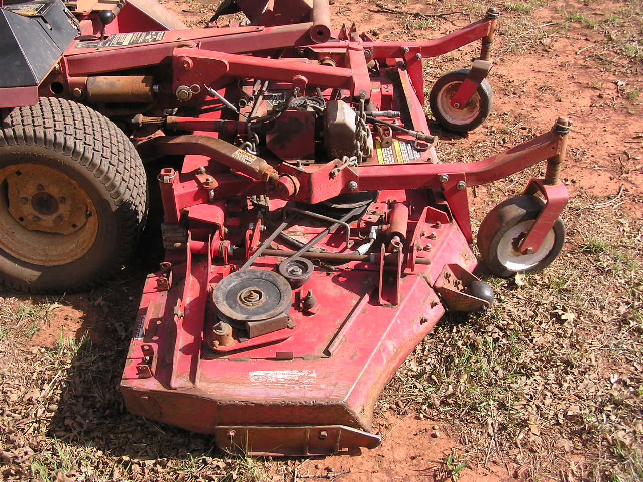

#63

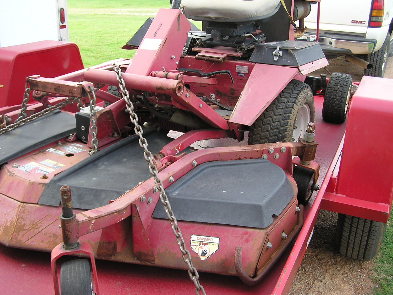

I agree on the scaled down quick attach, that is what the Dingo uses.

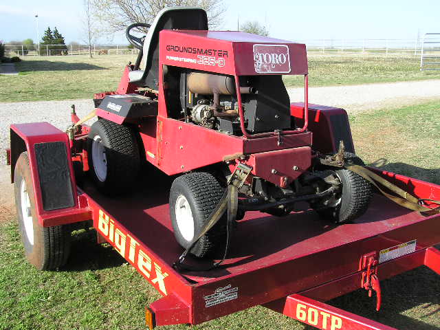

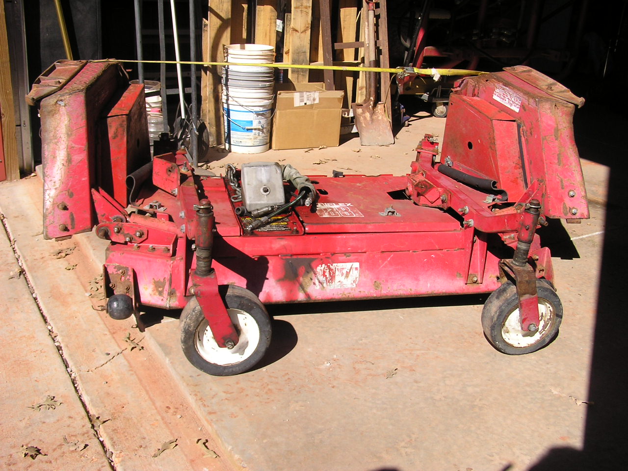

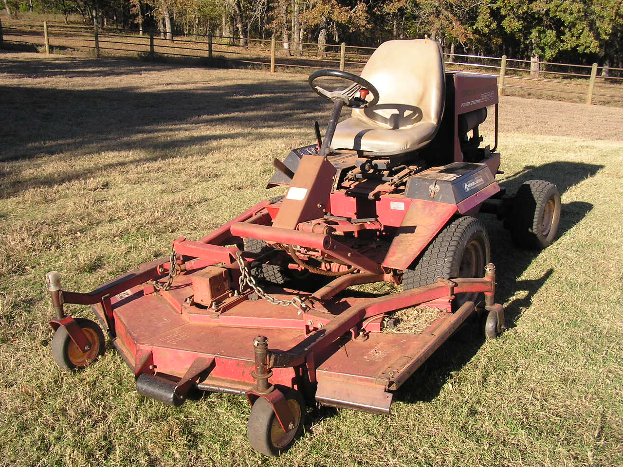

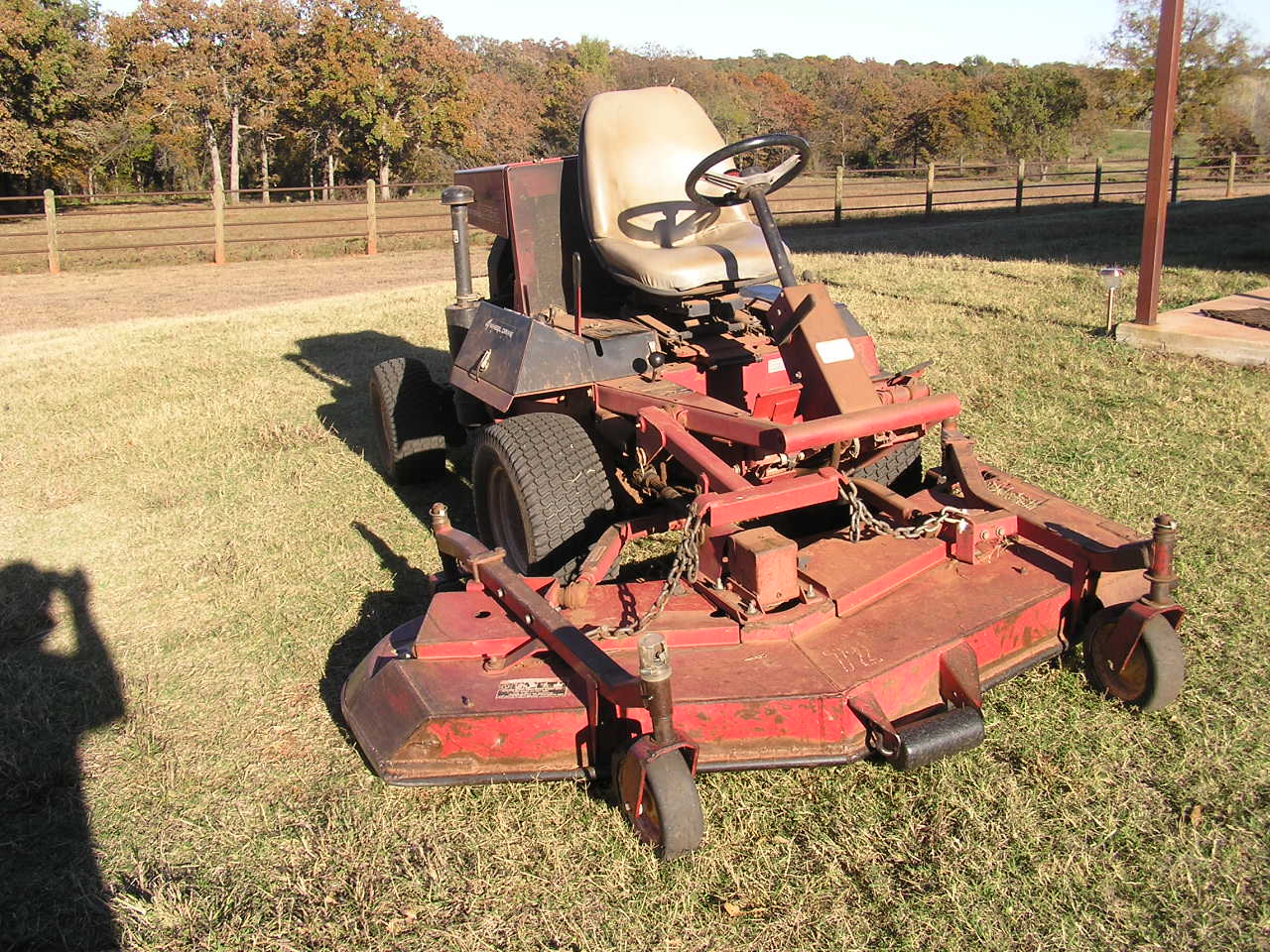

I got this 72" side discharge deck and a two wheel drive 325D back in May of 2005. Still using it on the 4WD now.

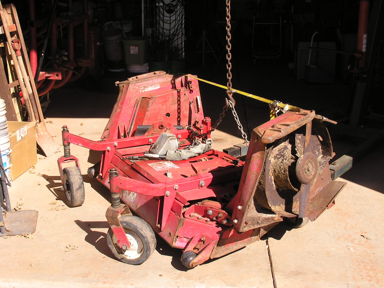

Got this 60" flail deck a few years later.

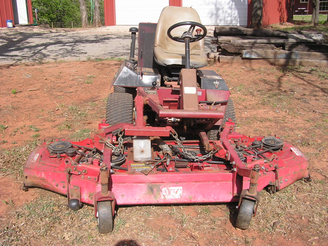

Picked up a parts 325D and a good 72" recycler deck in May of 2008.

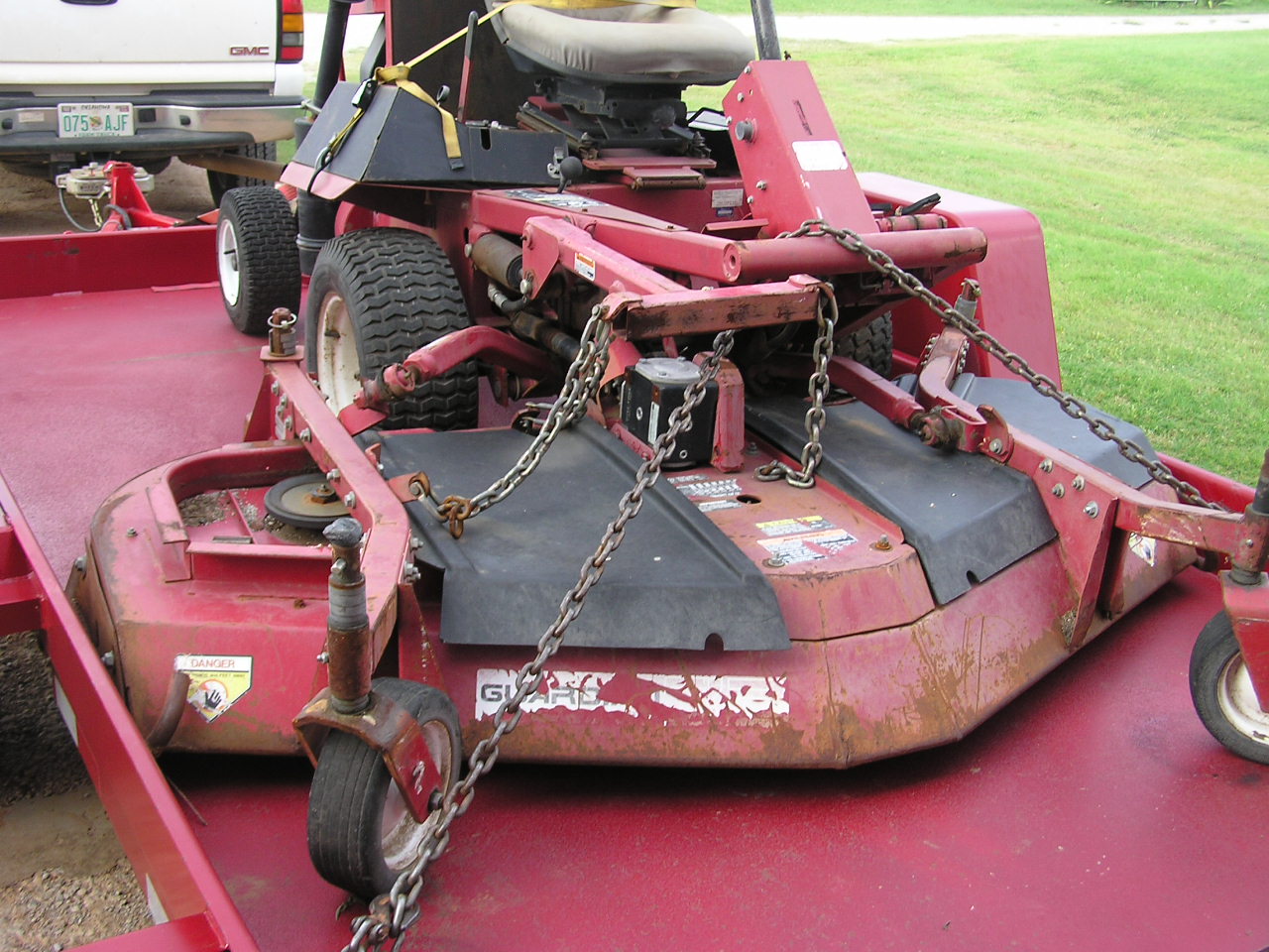

The latest one is a 88" Triflex rear discharge deck in november 2013.
Still using all three rotaries, so I have some experience changing decks.

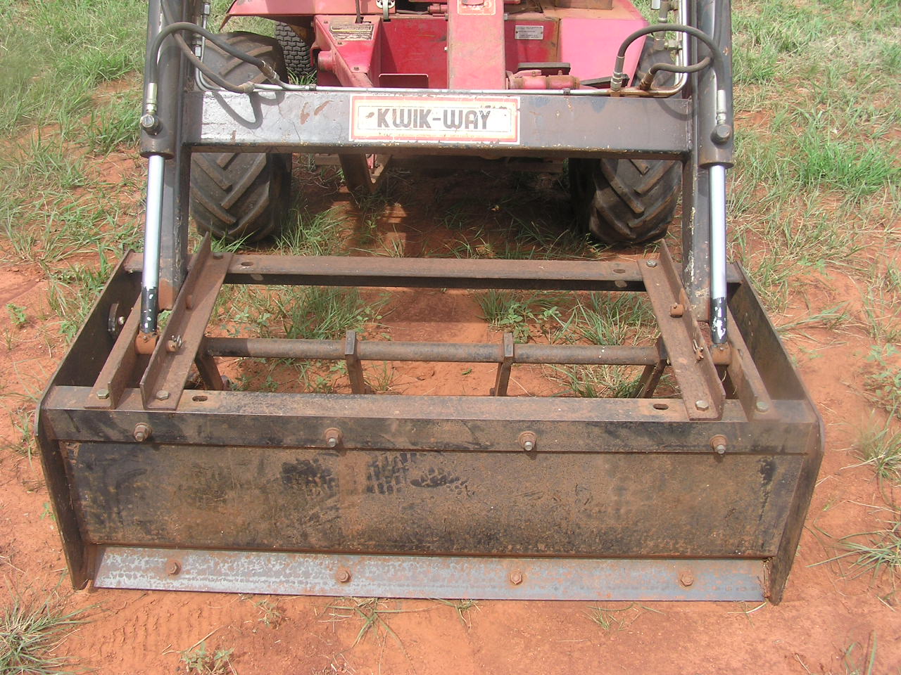

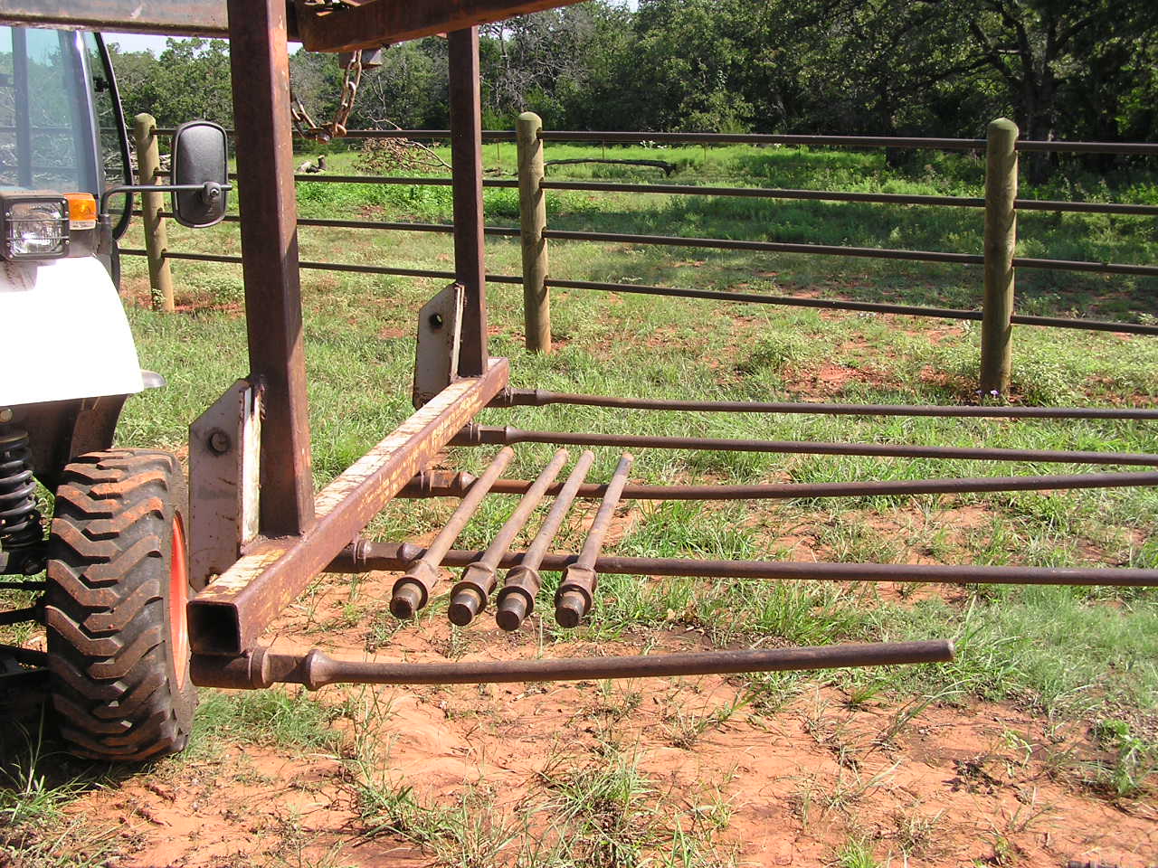

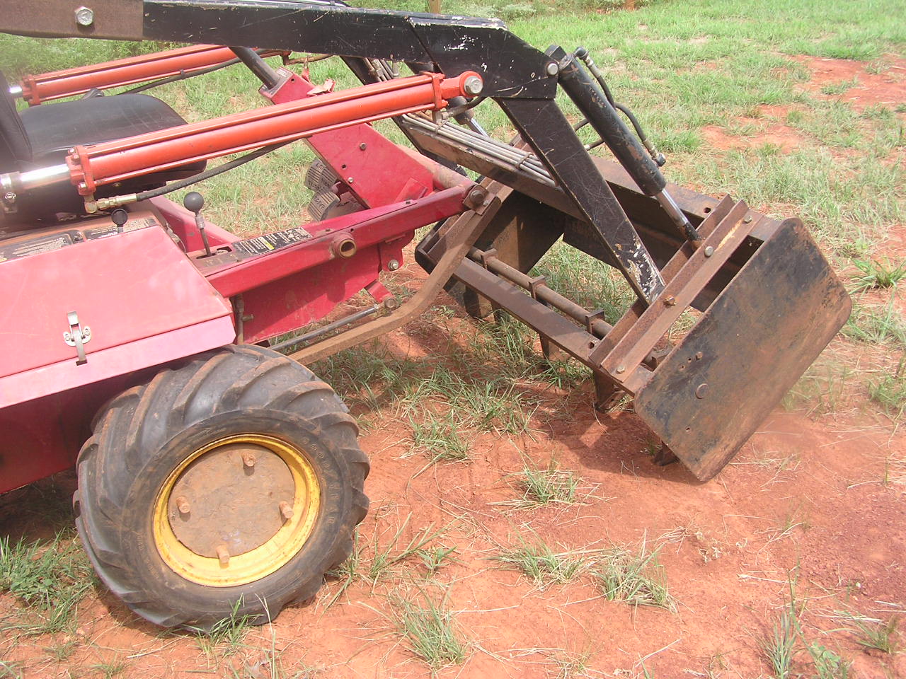

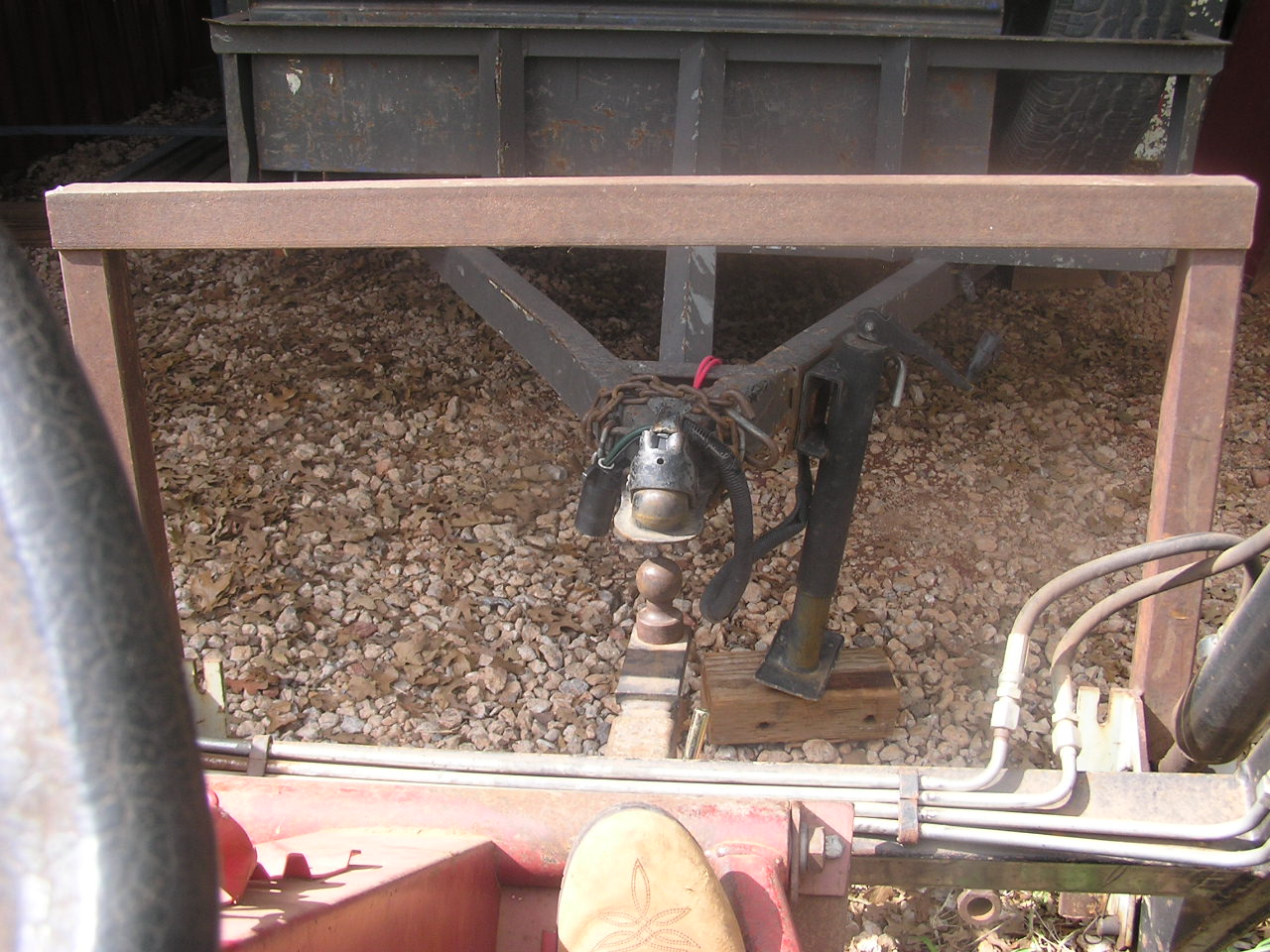

Made this receiver hitch many years ago for a garden tractor, sold the tractor, saved the hitch.
Bought two square U bolts and put the hitch on the brush fork frame. :thumbsup:
The view from the seat.
Very easy to maneuver a trailer.

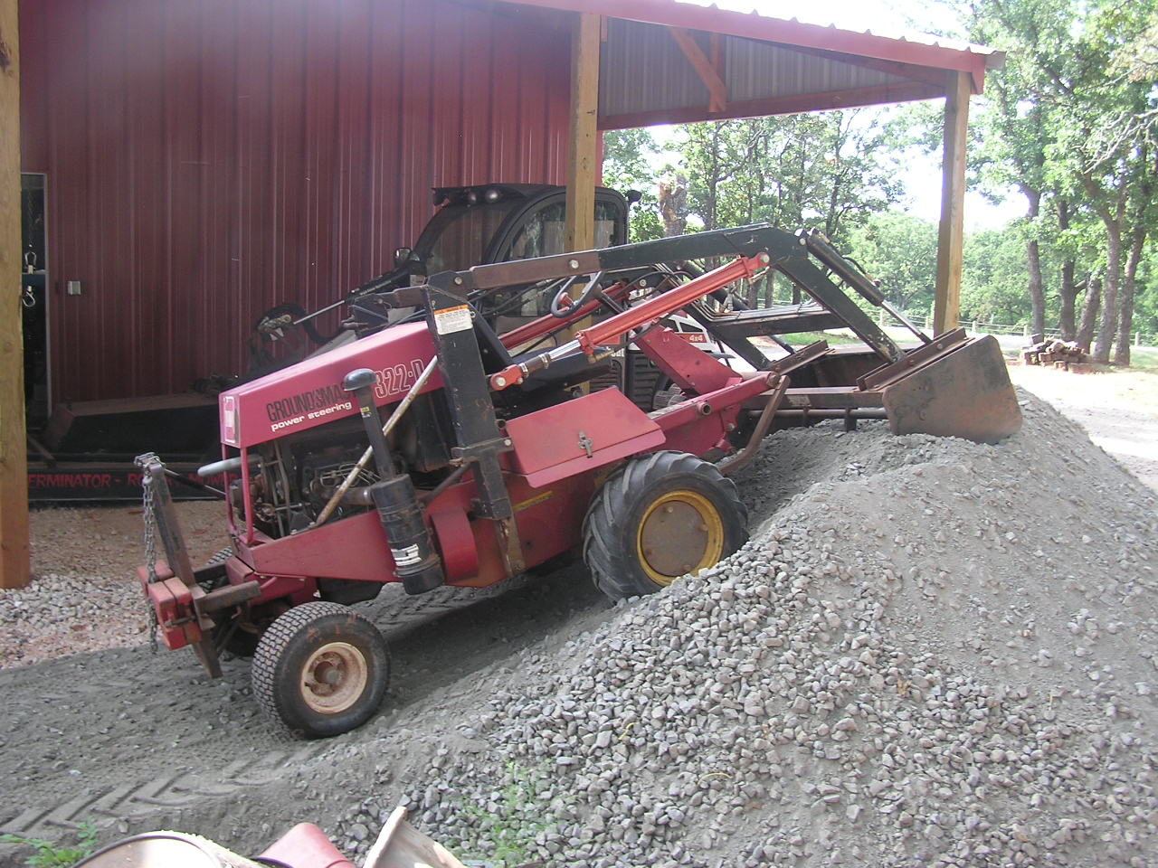

#71

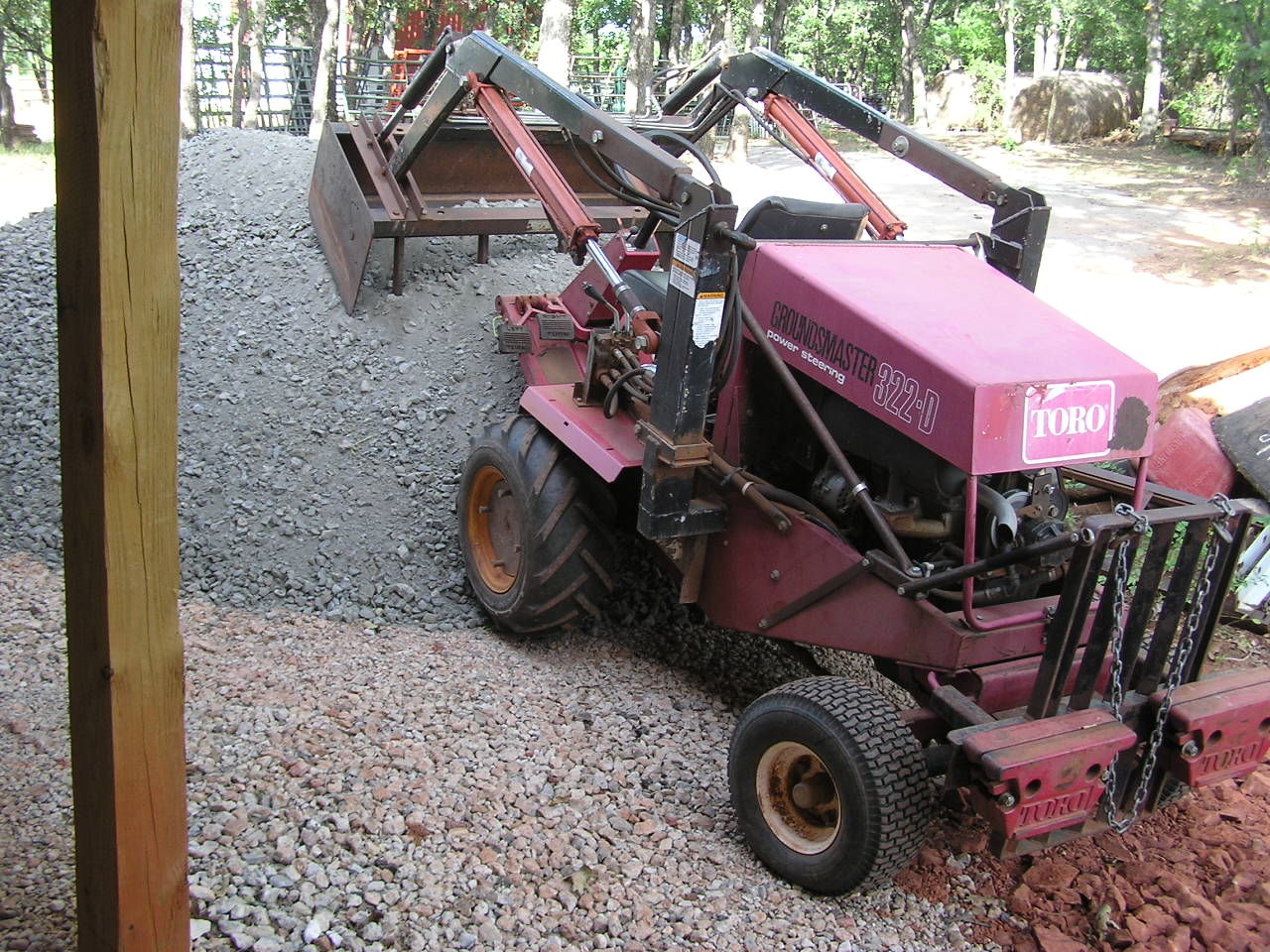

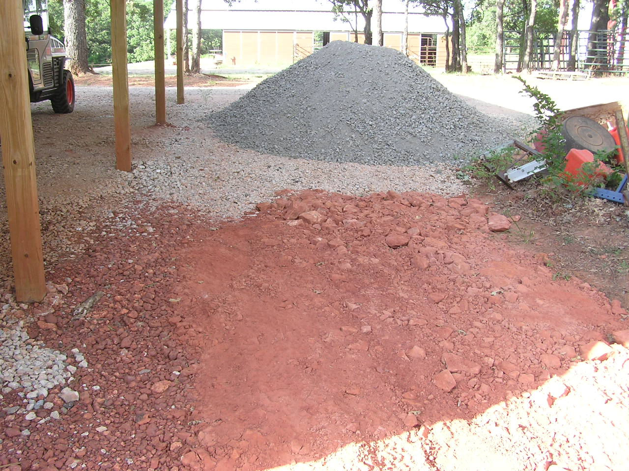

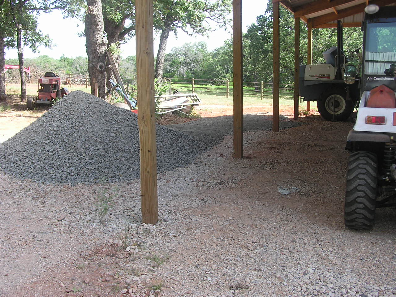

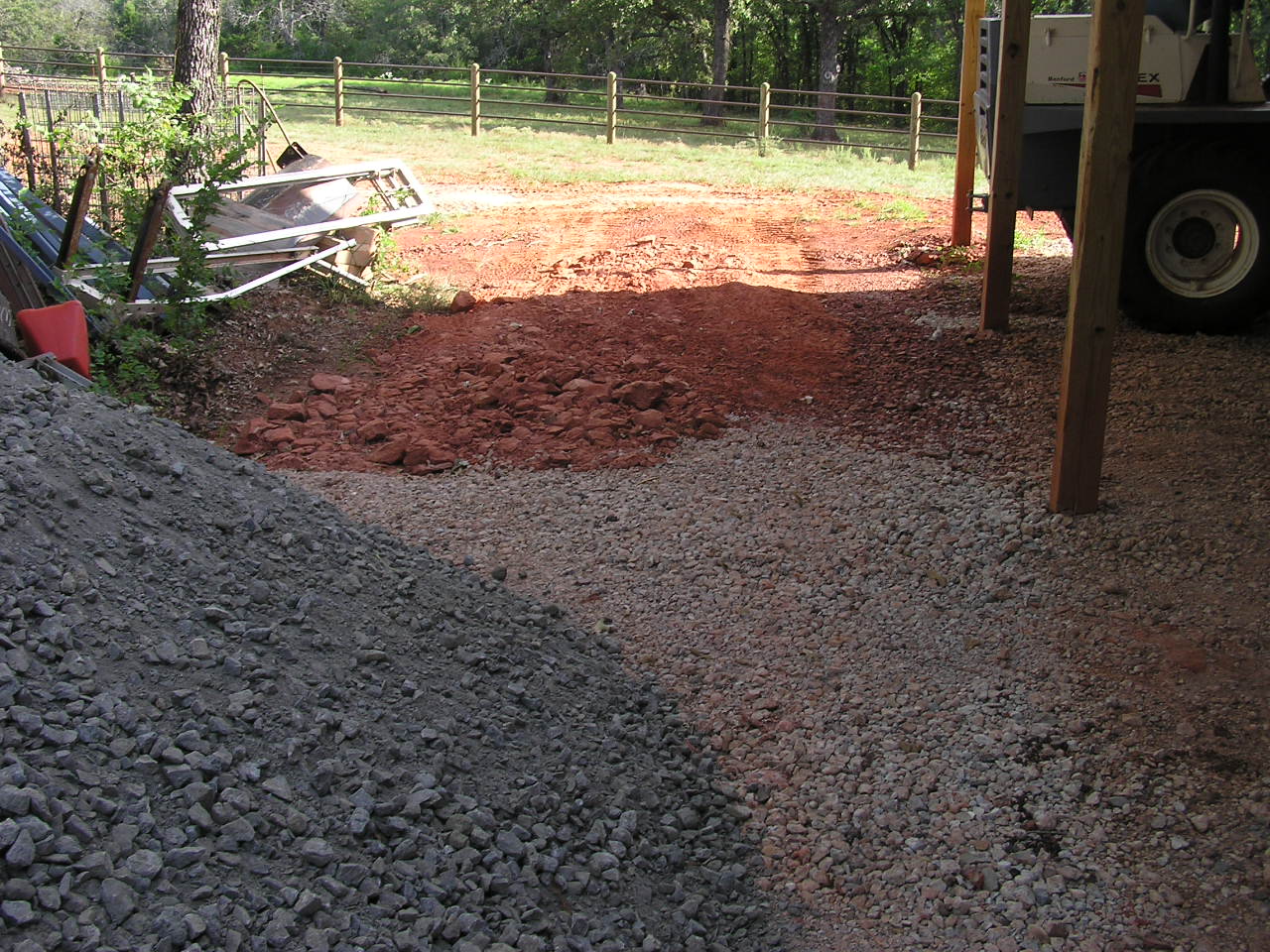

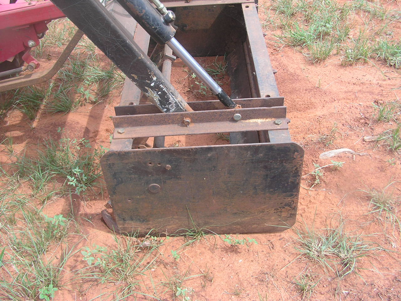

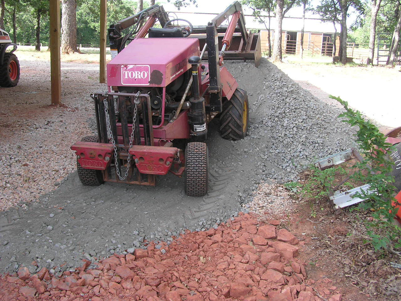

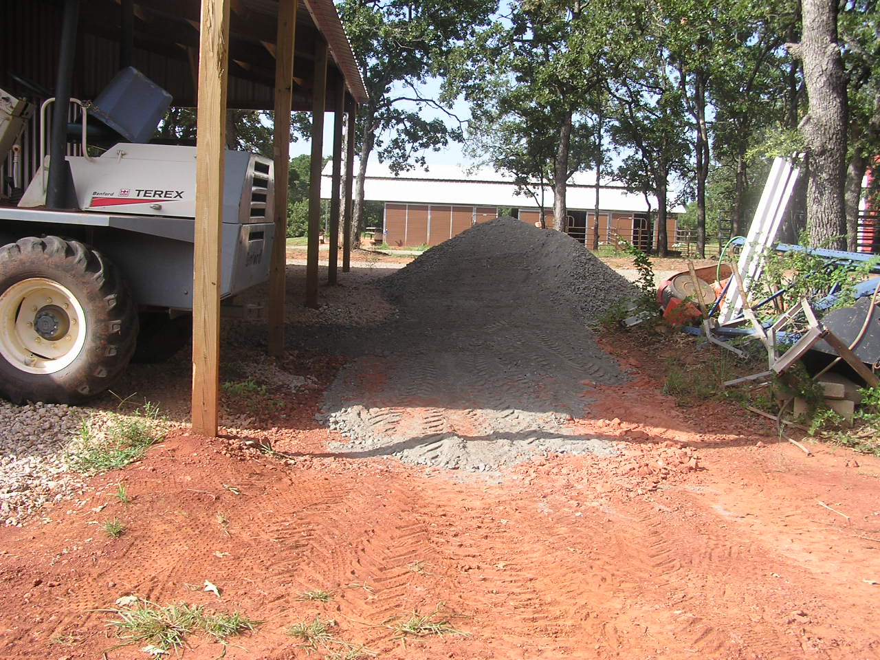

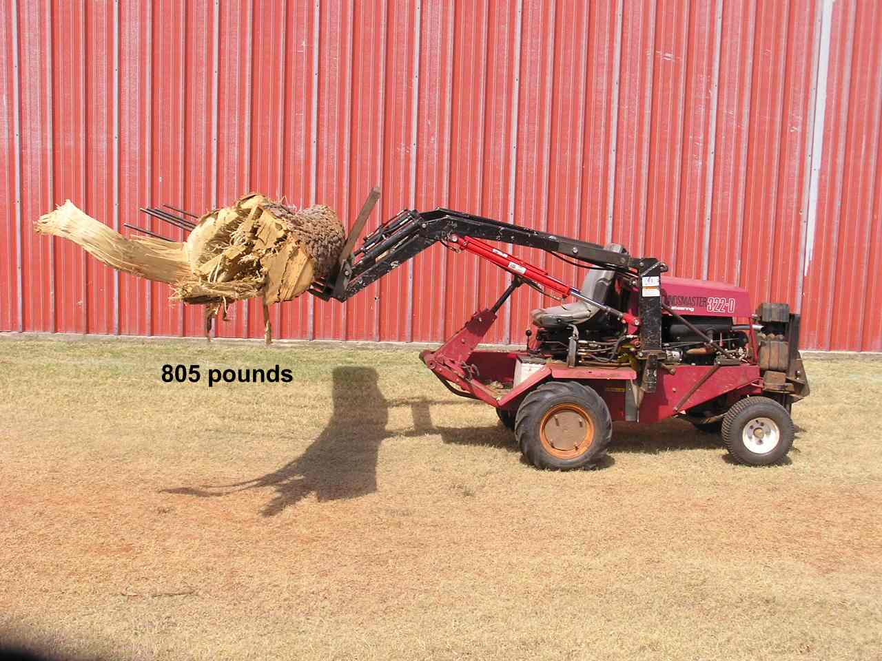

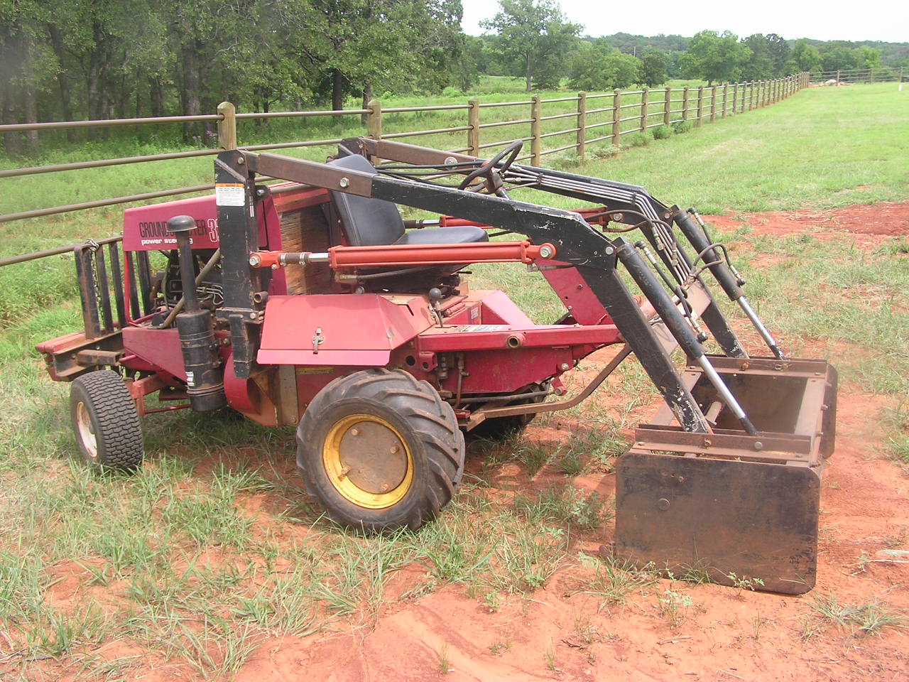

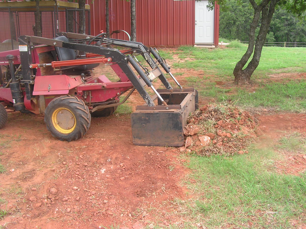

Needed some gravel on a bare spot on the driveway. The bucket was already on, so I went to what is left of the gravel pile and scooped some.
Went back for more.
Missed it dumping out of the bucket due to shutter lag. :eek:

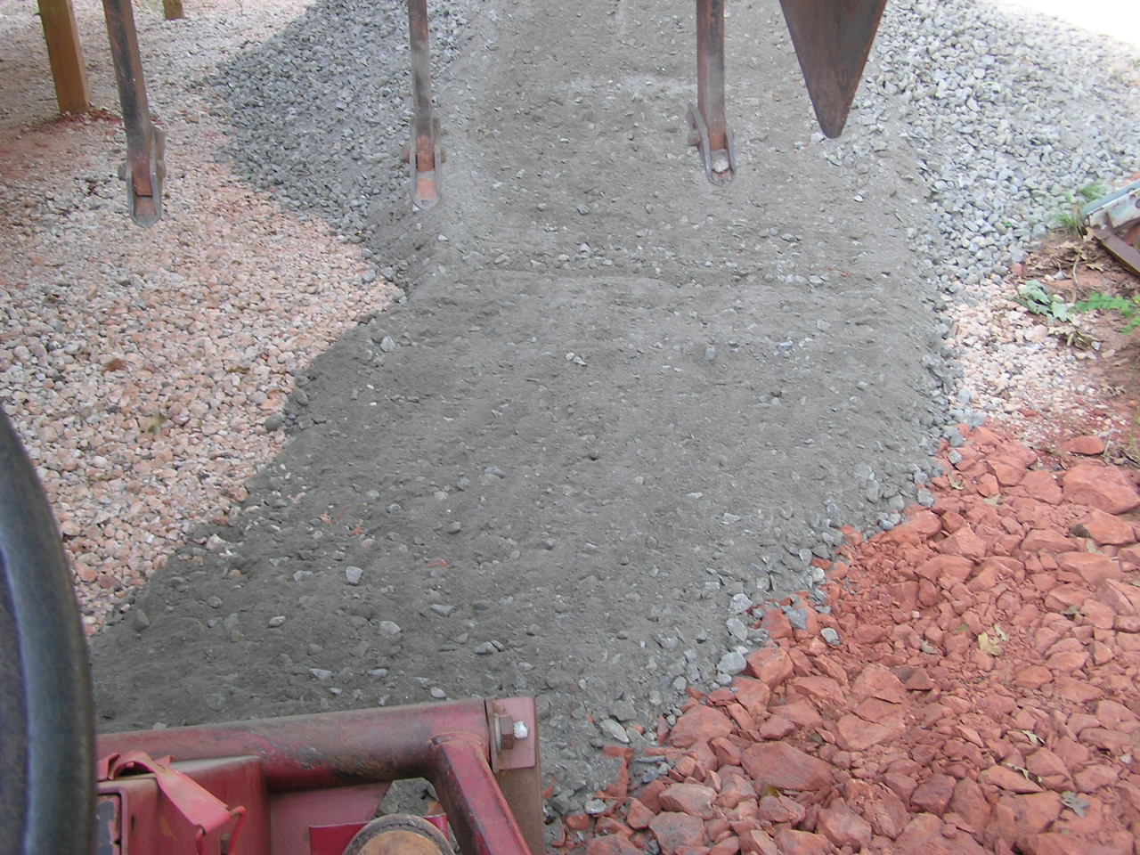

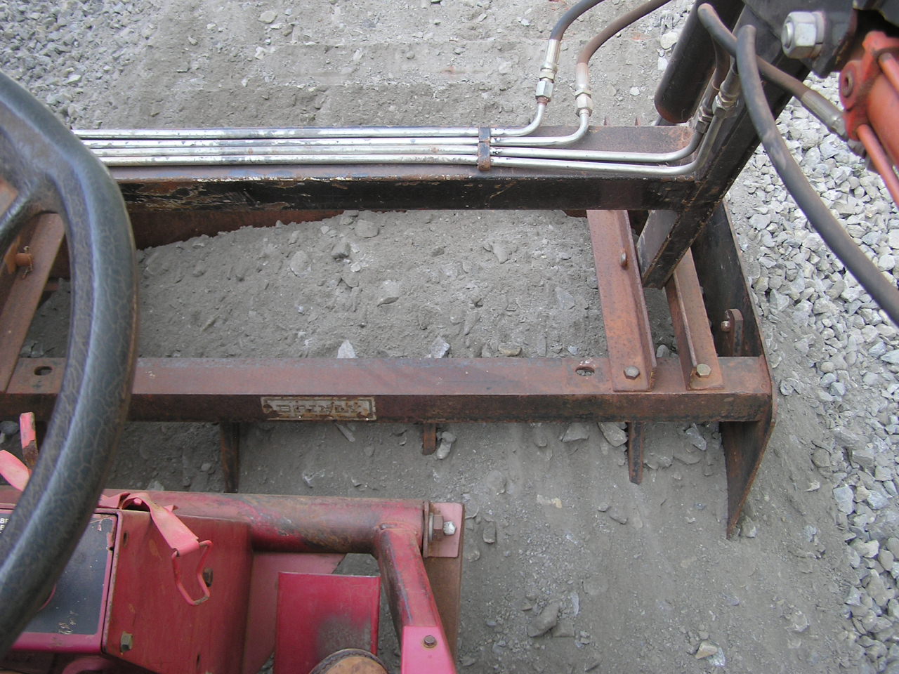

From the seat, good view of back dragging with the bucket edge.
Finished result.

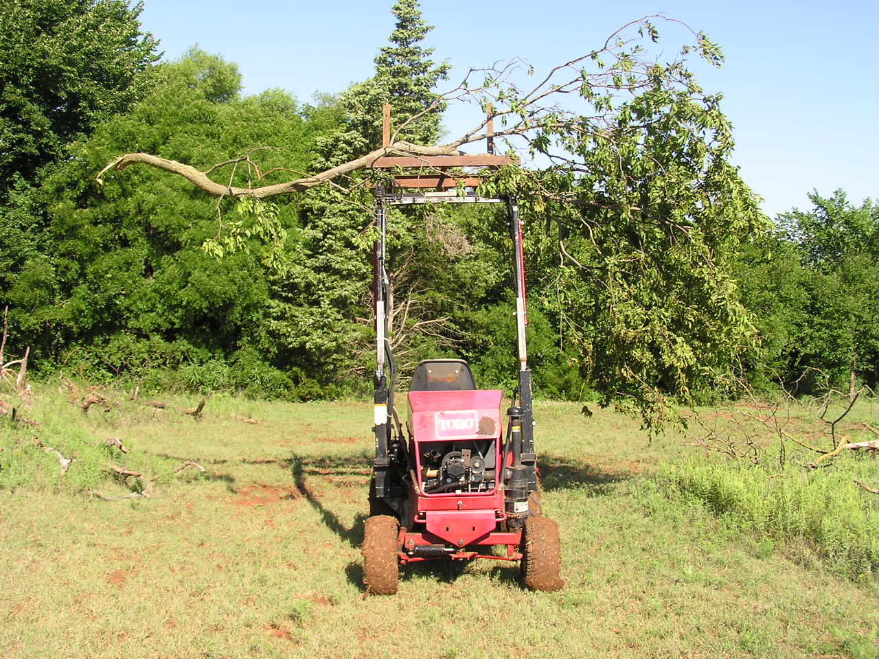

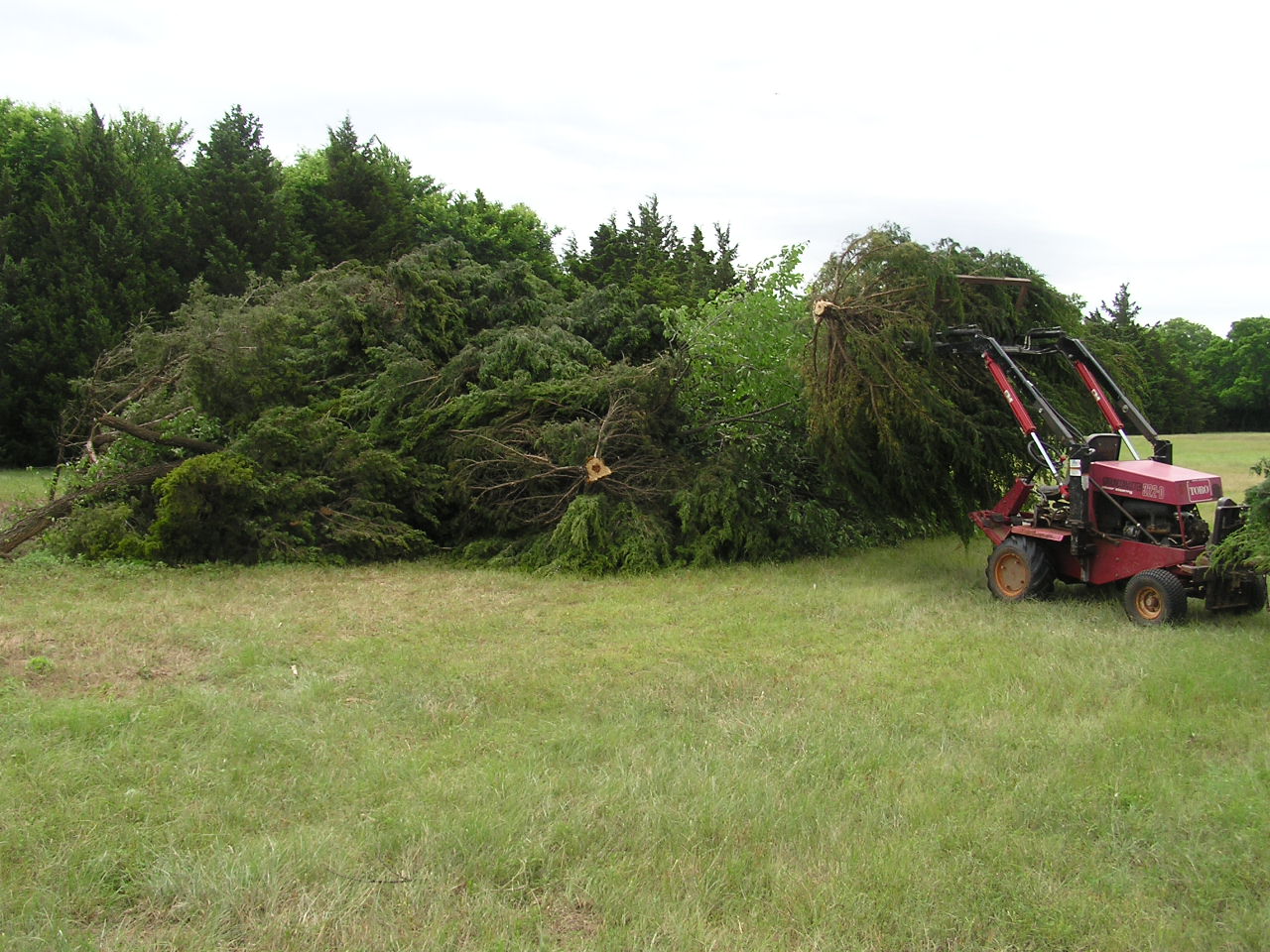

Still using the 27 year old TORO that I have owned for 14 years. :thumbsup:
Had some small dead branches laying around, so I hooked on the little dump trailer and put it to good use.
It is the beginning of the new burn pile! :D
