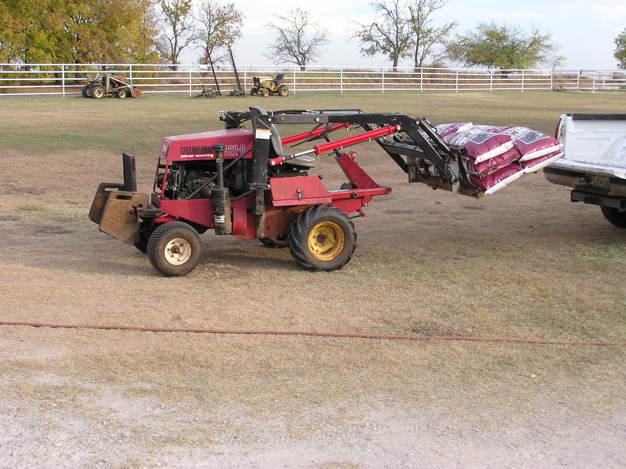

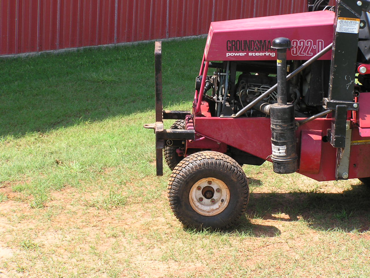

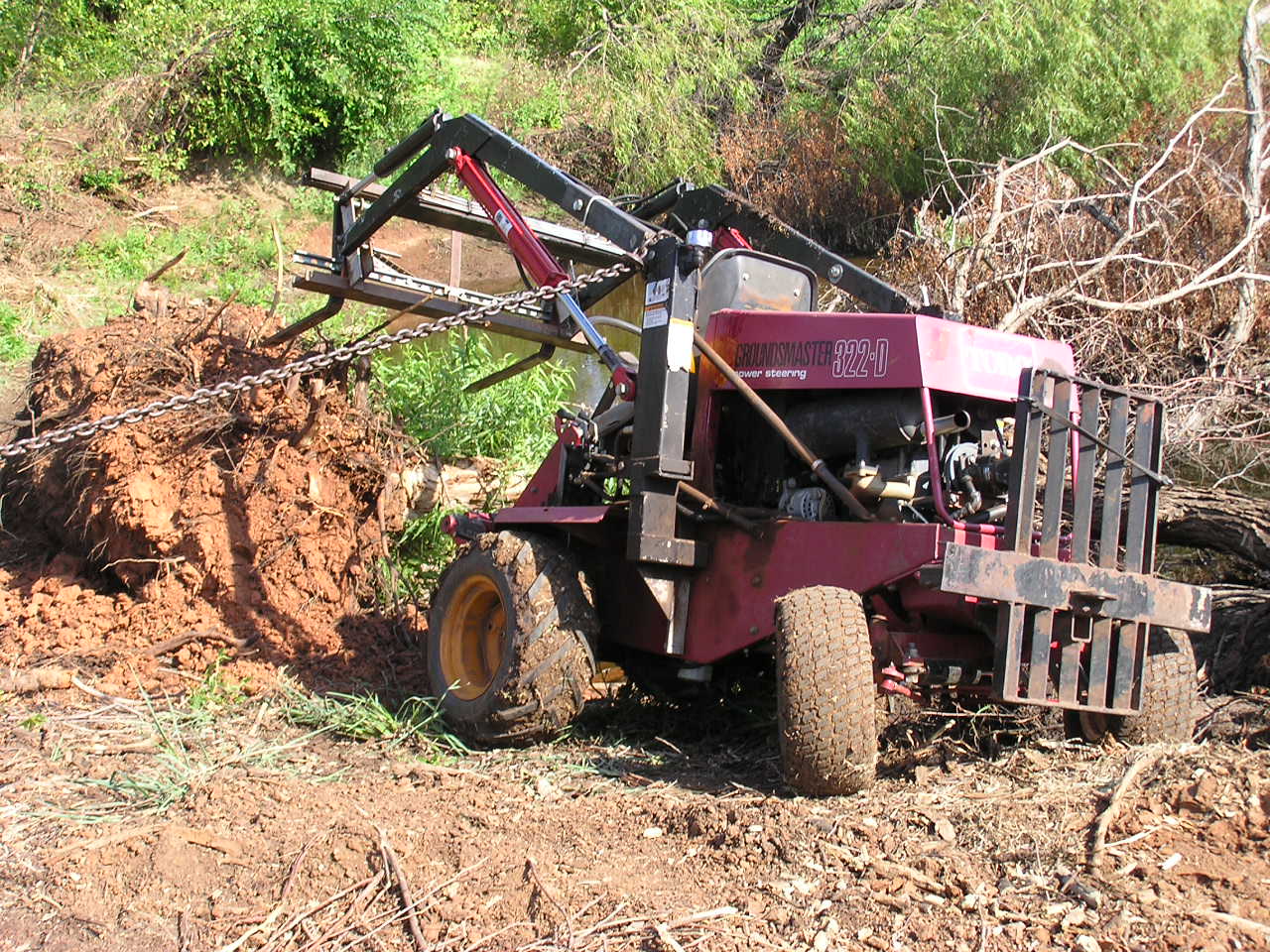

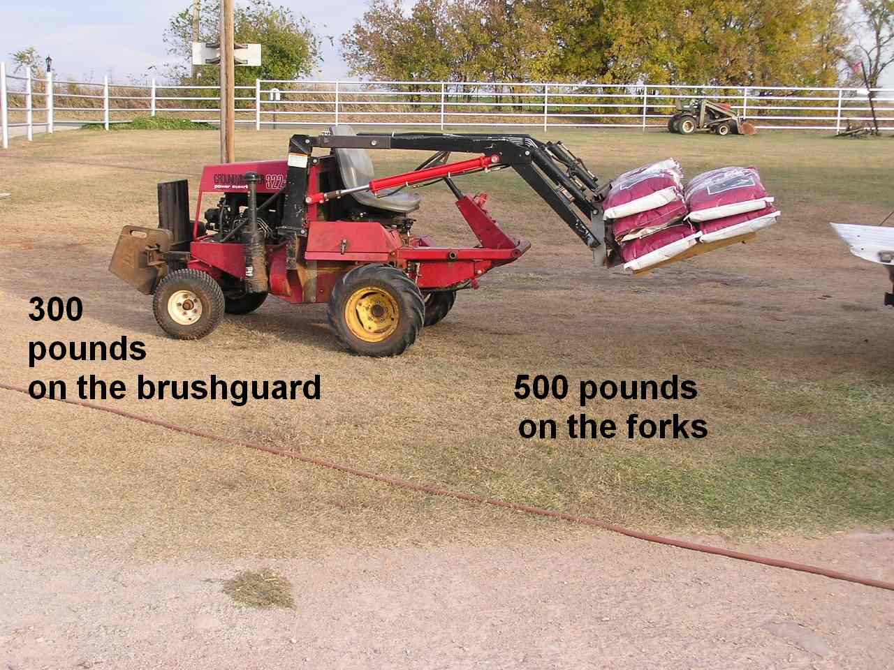

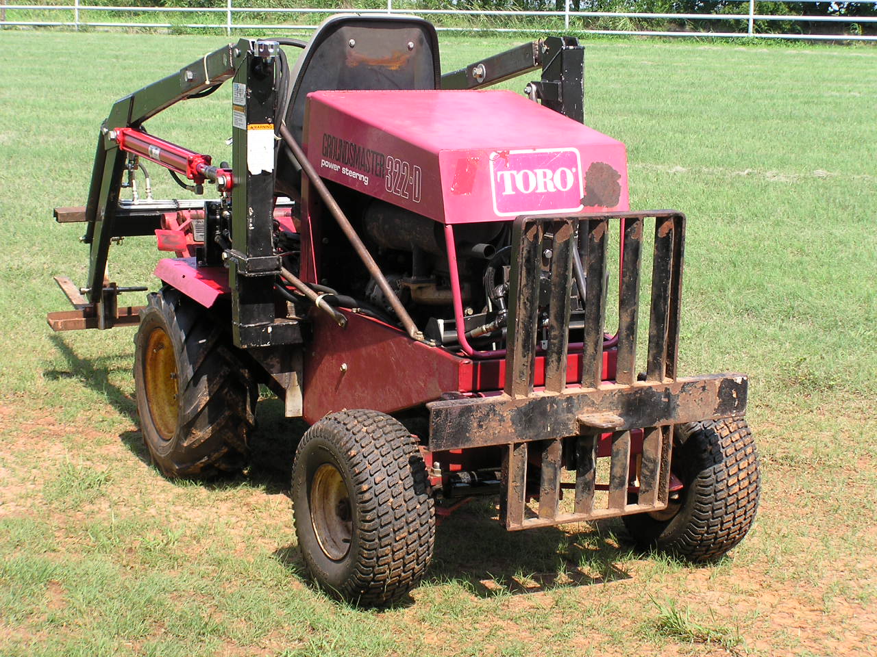

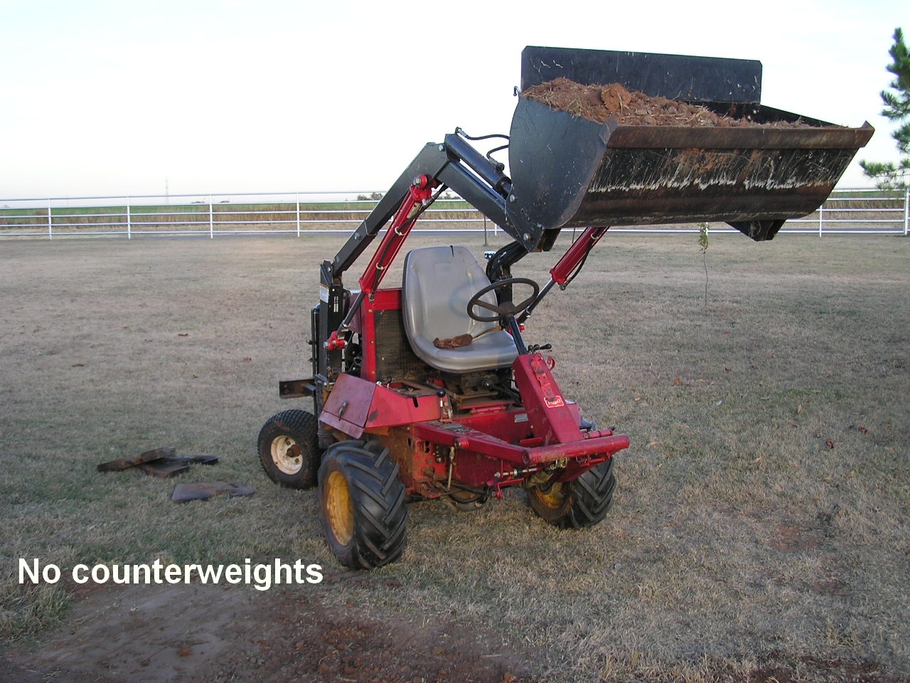

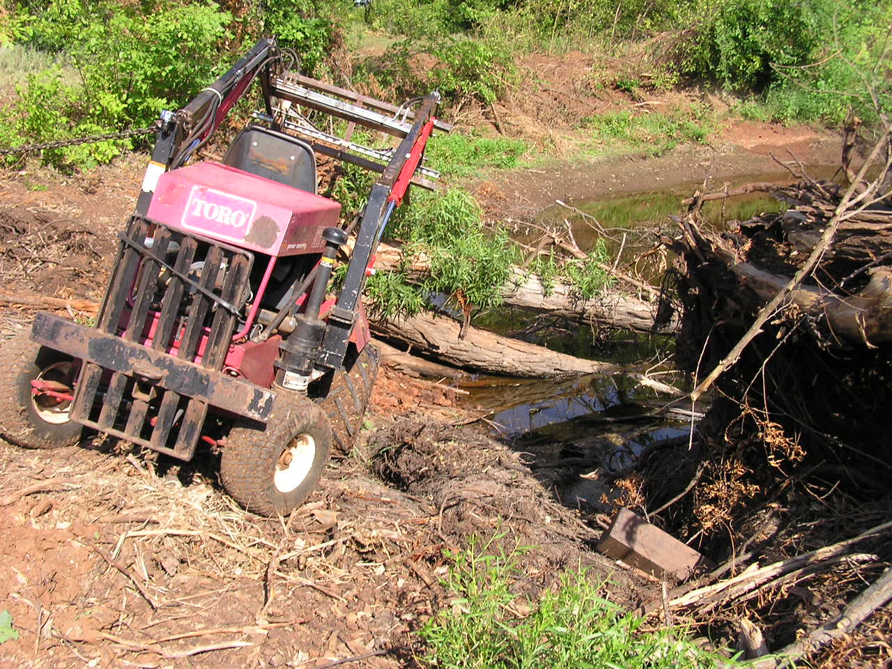

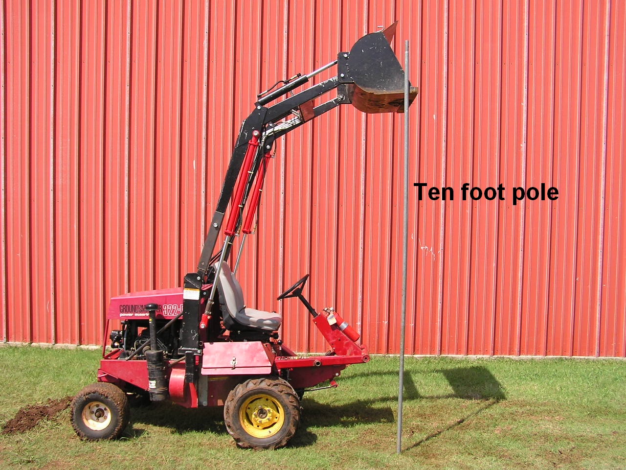

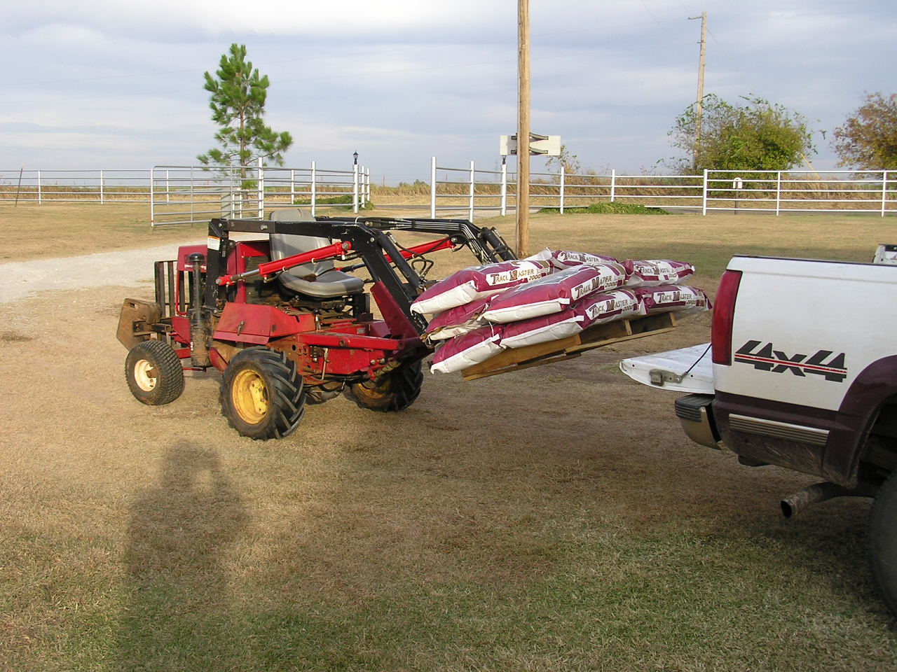

Cool build, how much can you lift?
I struggle with anything much over a hundred pounds.:D

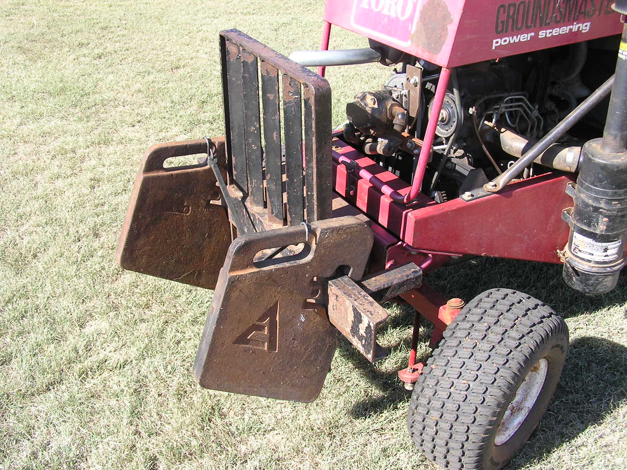

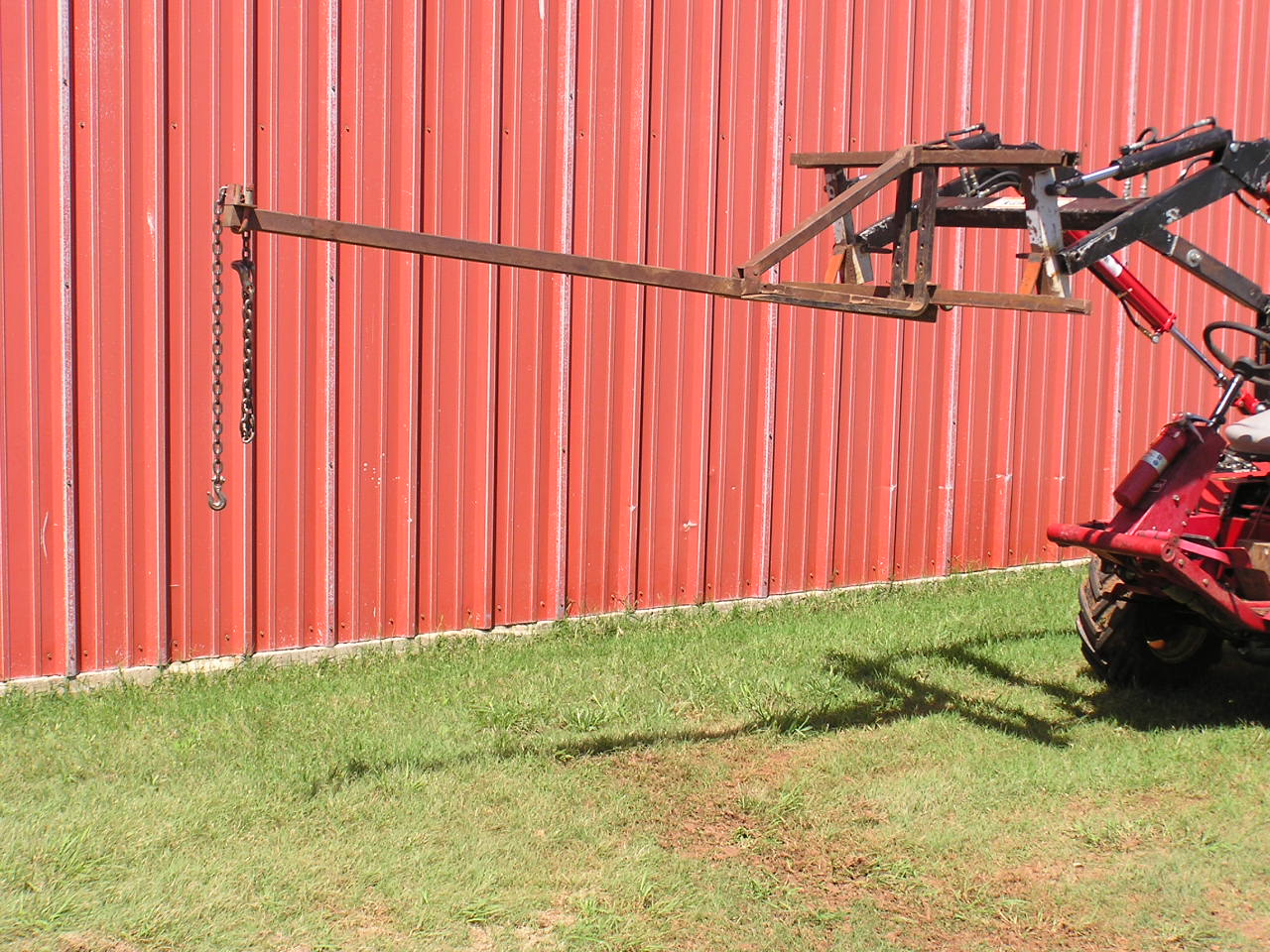

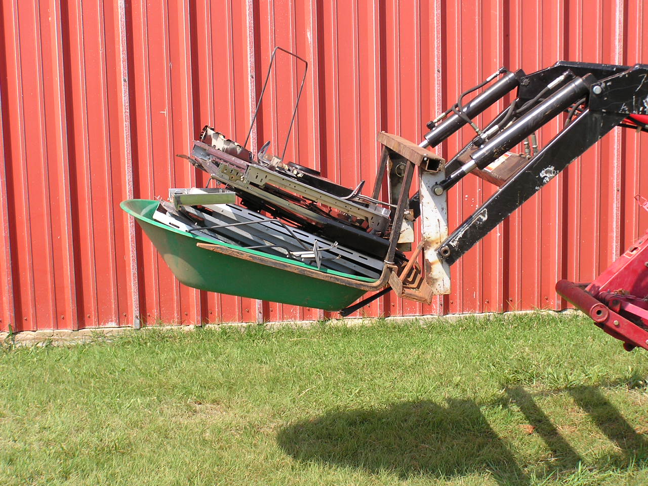

The biggest thing with the TORO is a log that I weighed on the platform scales at 805 pounds. It will lift 300 pounds with no extra counter weight on the back.
640 lbs. of concrete.
The big cottonwood tree trunk, on the brush fork. Notice one extra suitcase weight on the back.

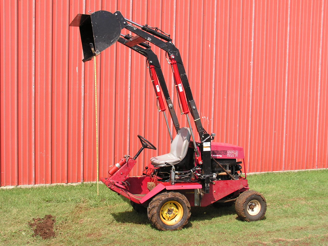

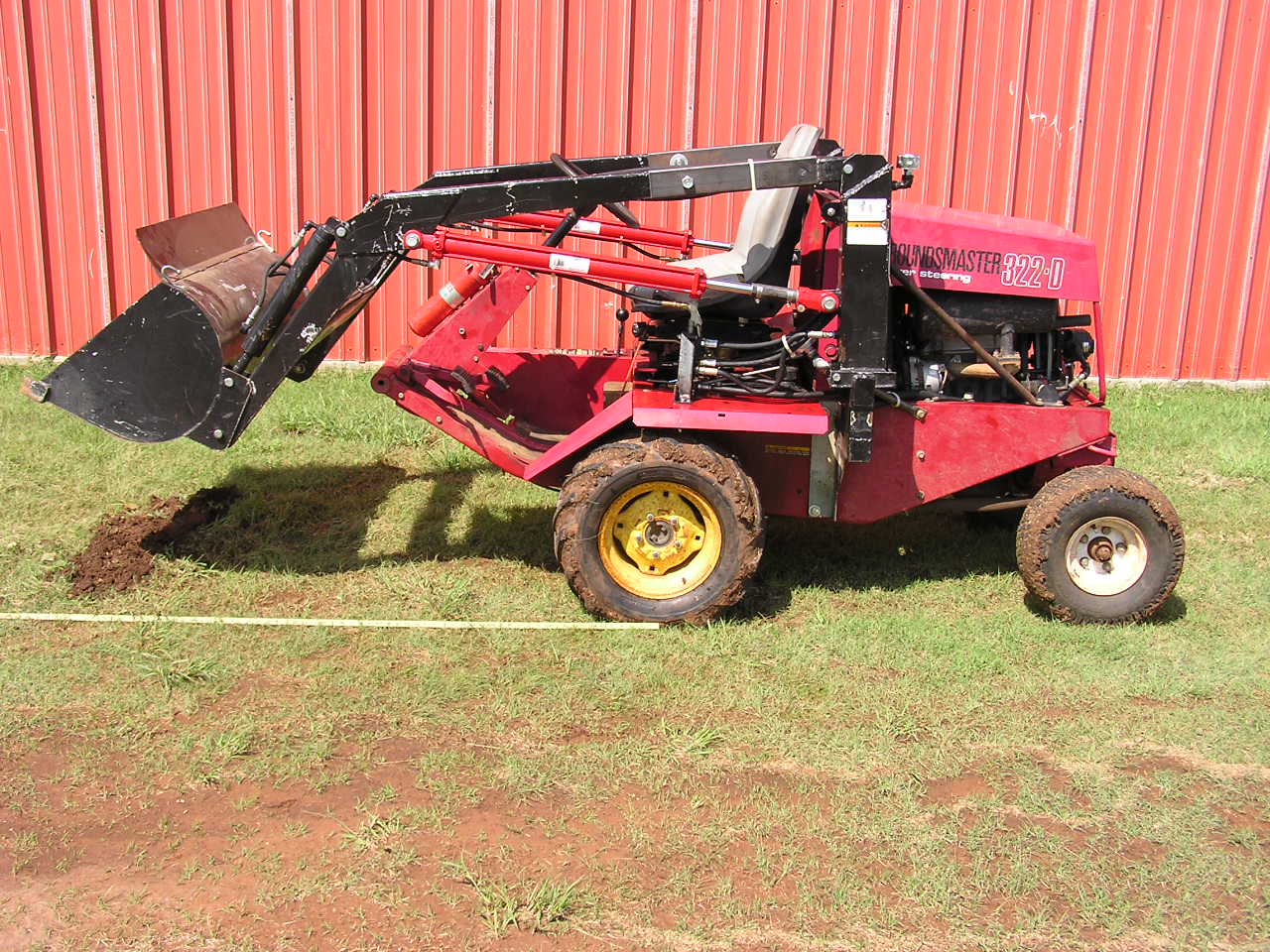

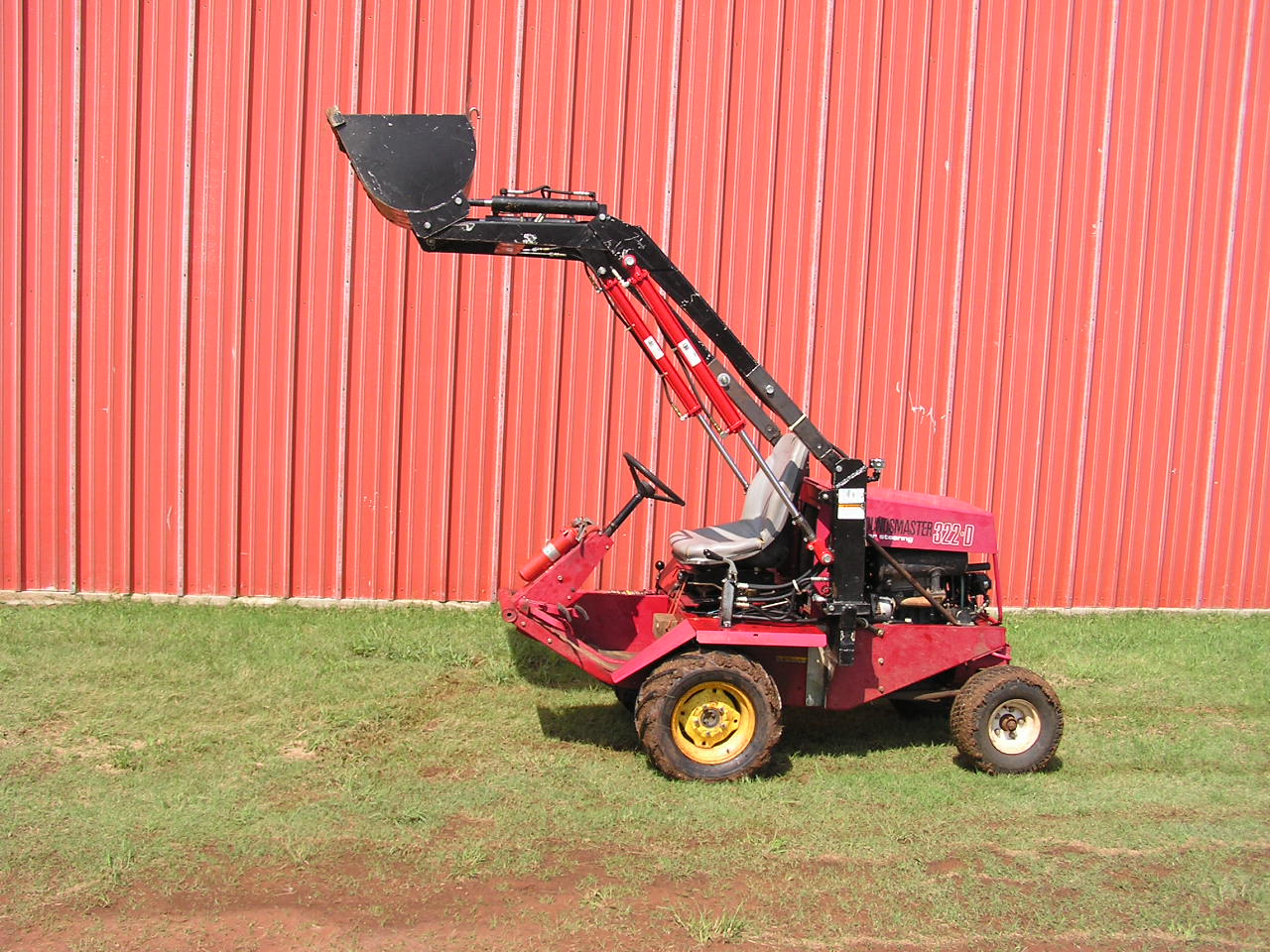

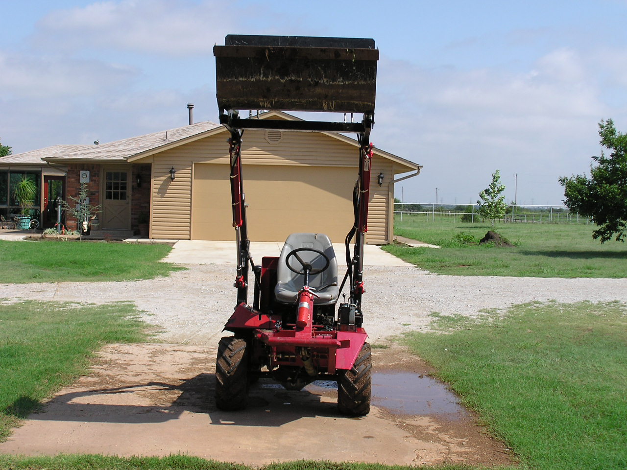

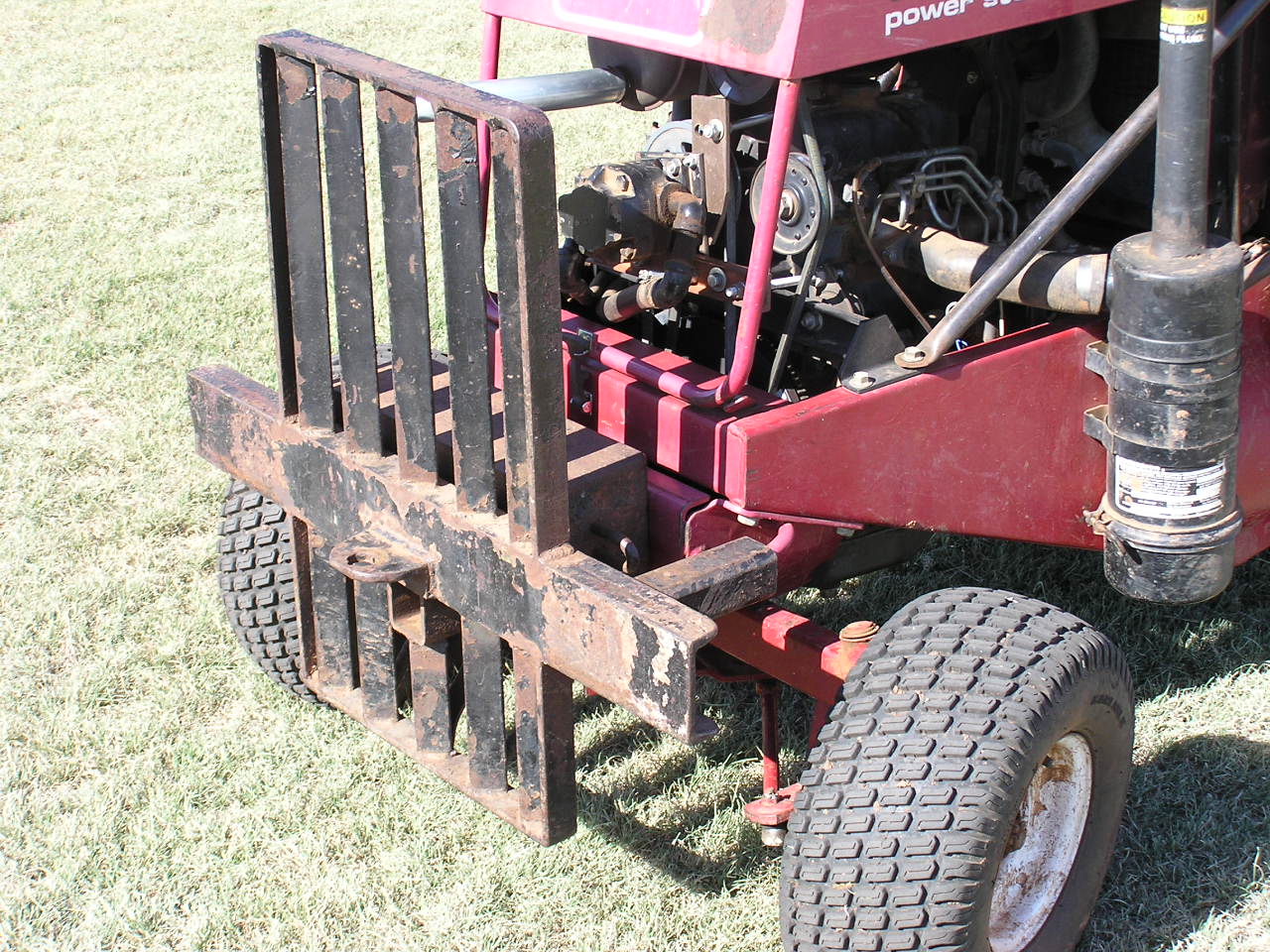

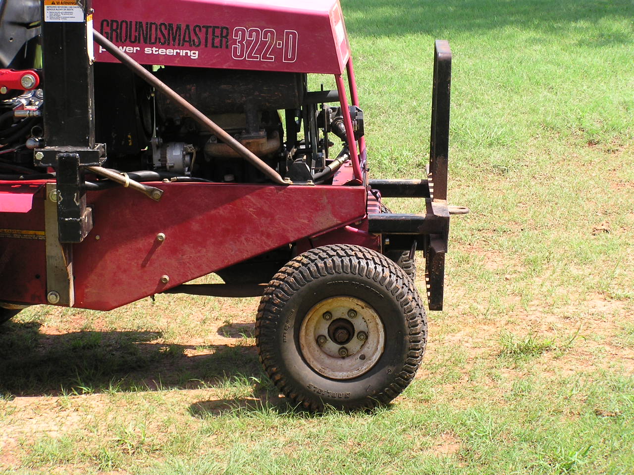

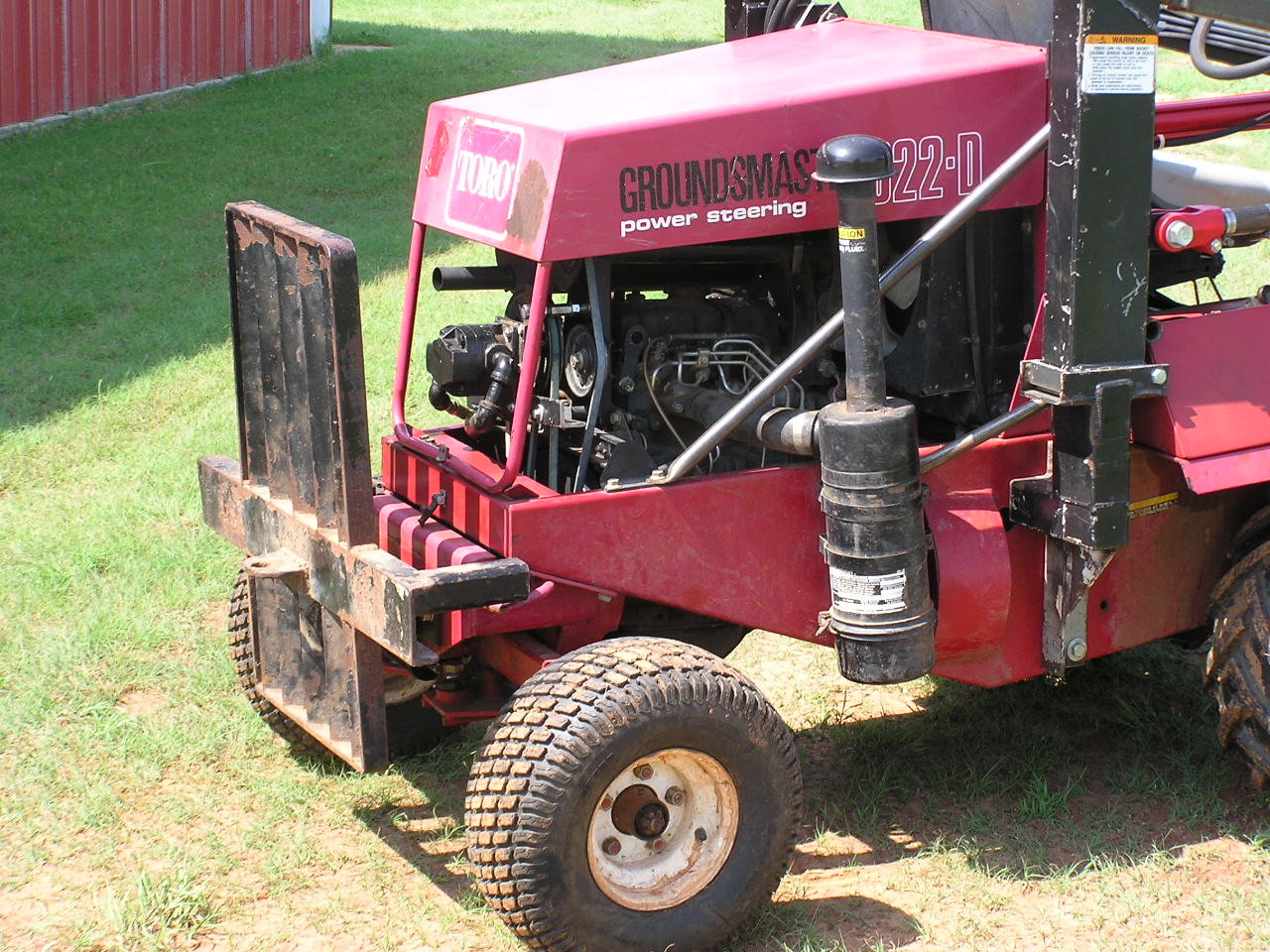

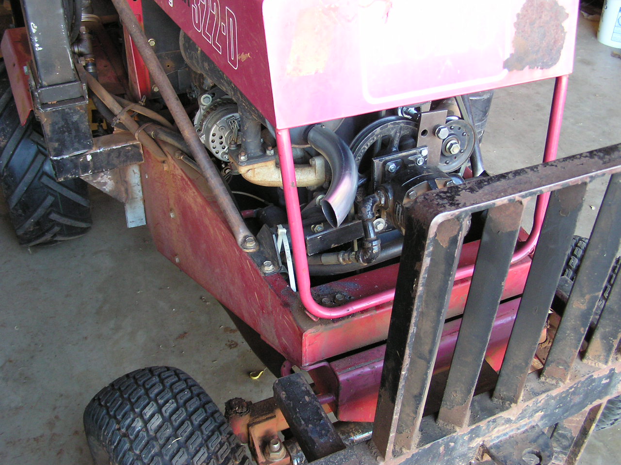

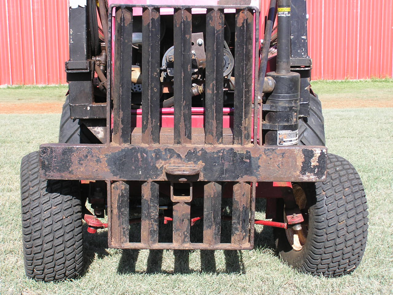

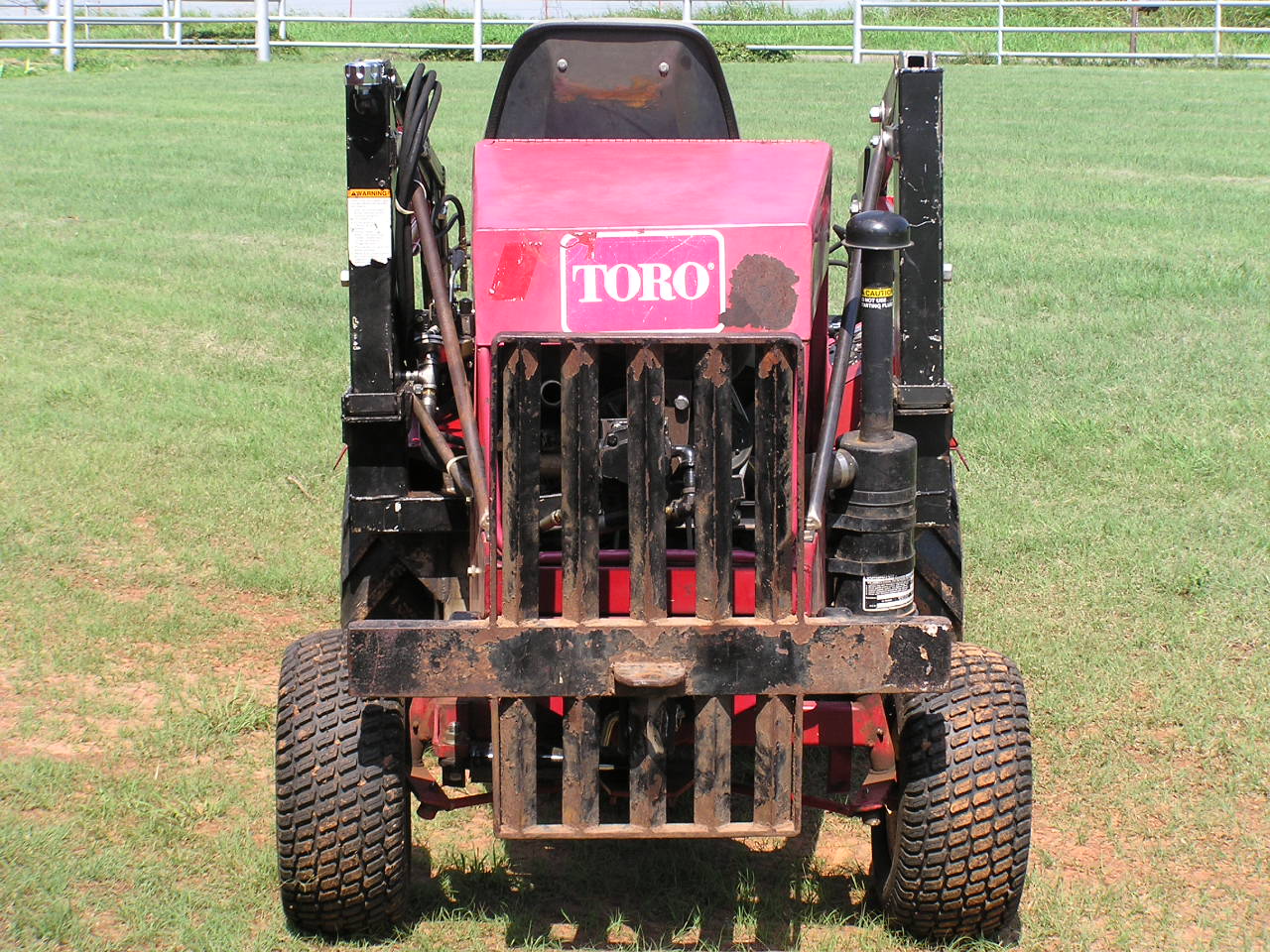

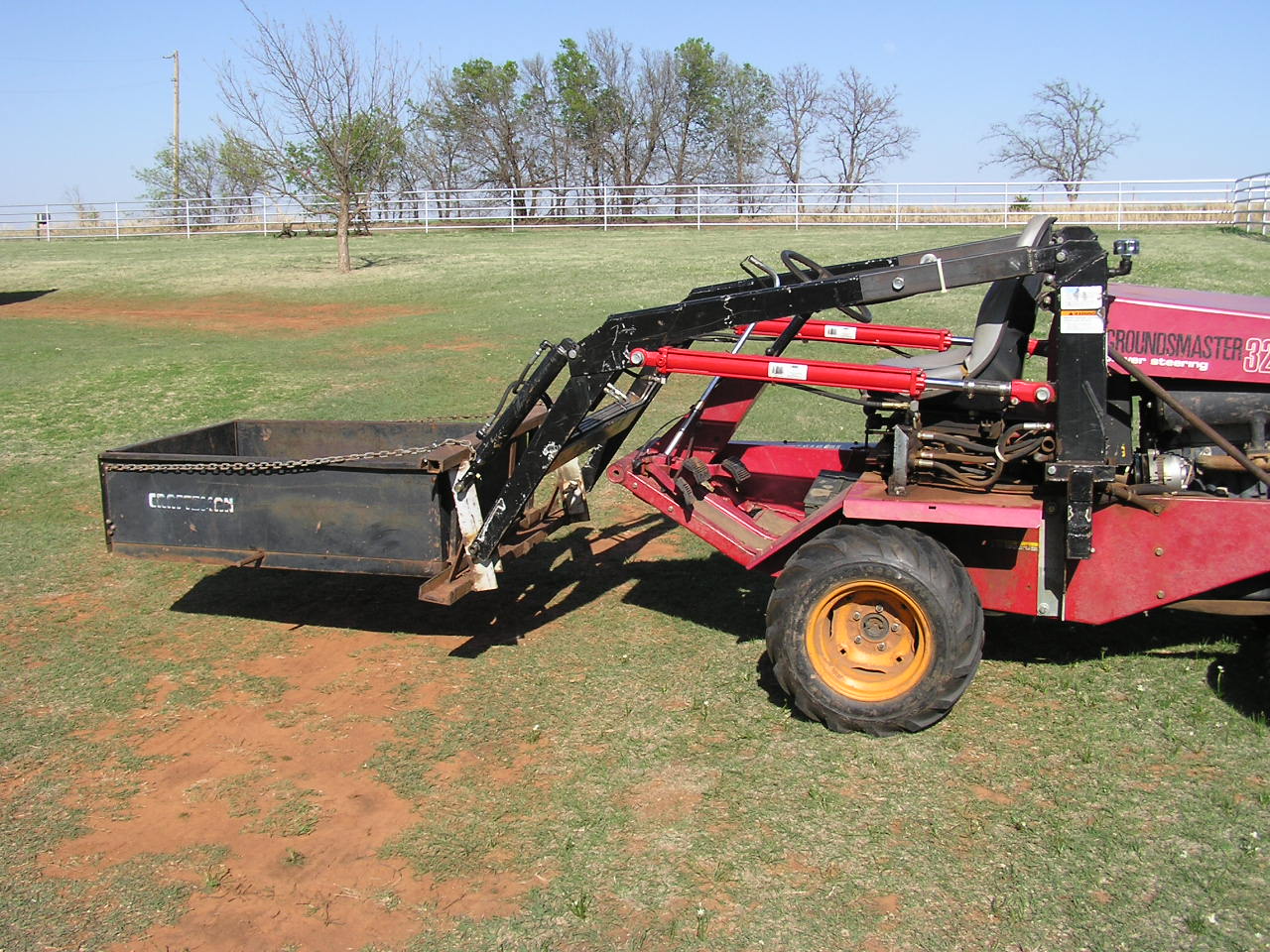

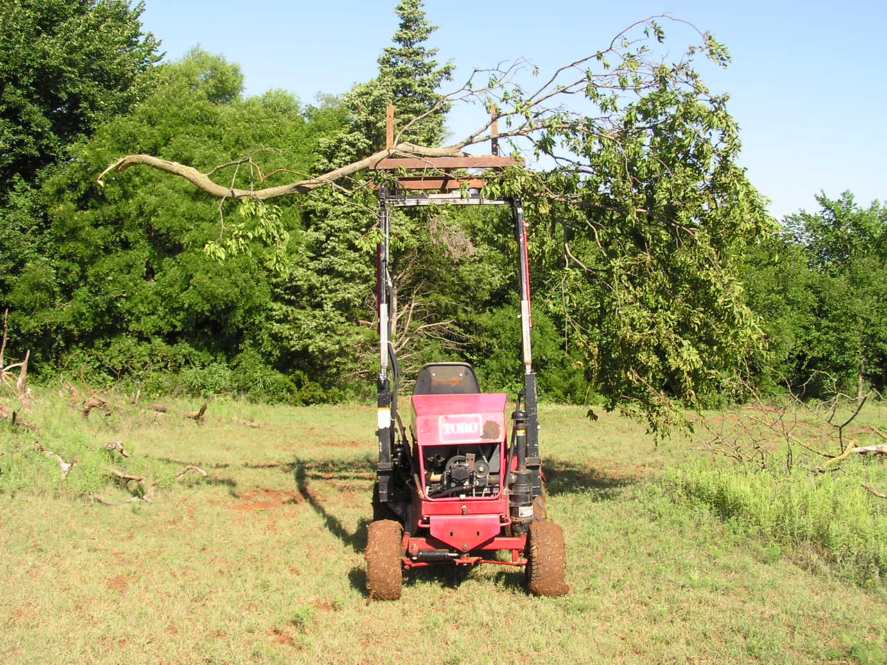

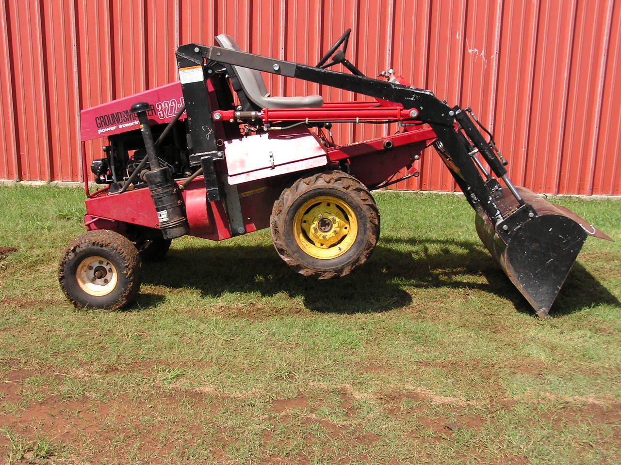

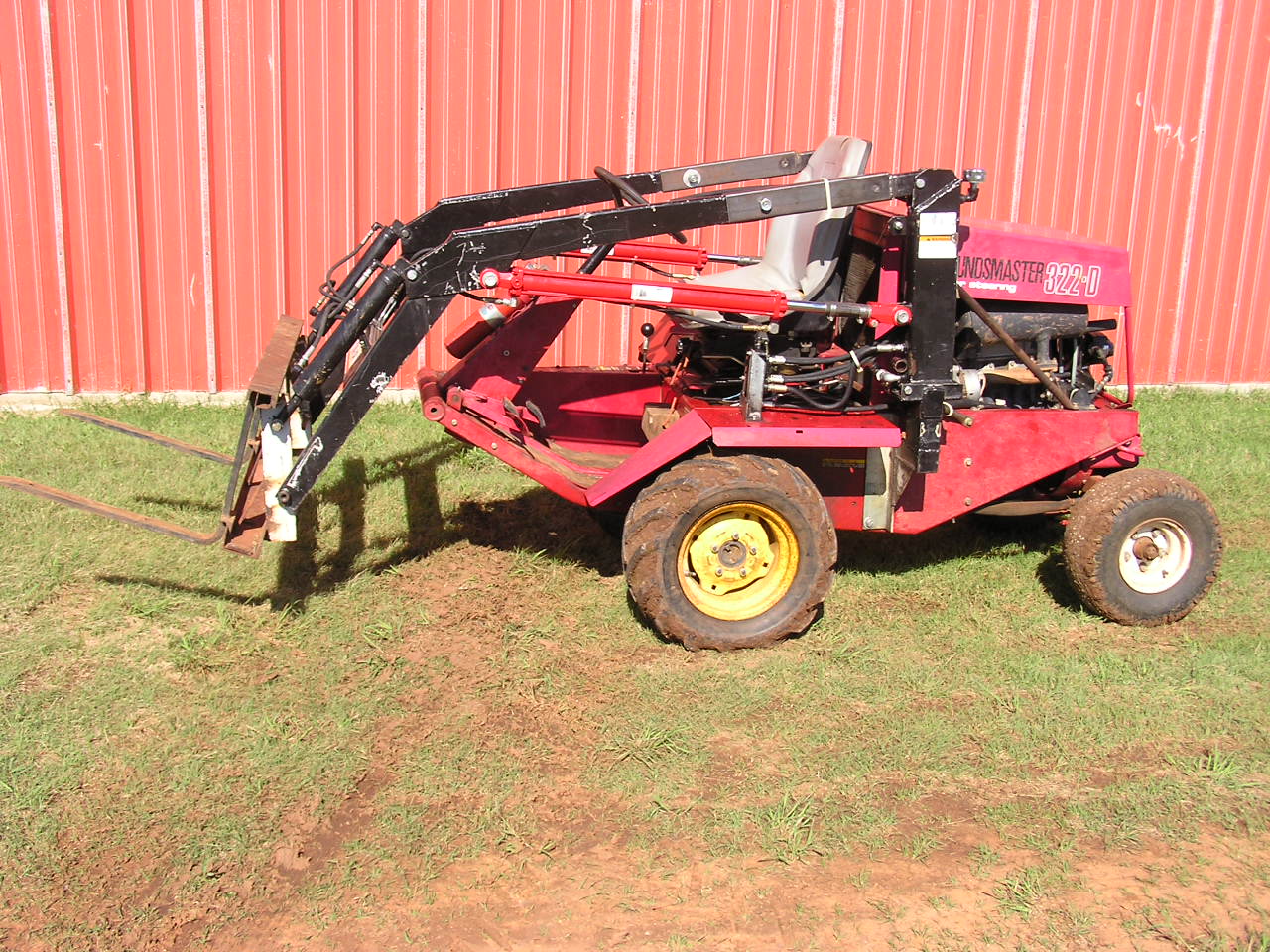

How difficult is it for you to climb on and off the rig due to the loader frame?
Not very difficult, since the seat is offset to the left side. You climb in just like a skid steer.
If the arms are down, step on the bucket, or fork frame, grab the arms and step on the TORO frame on the right side, then grab the steering wheel and slide into the seat. If the arms are up enough to duck under, just step on the TORO frame on the right side, grab the steering wheel and slide into the seat.
The first two pictures show the seat offset.

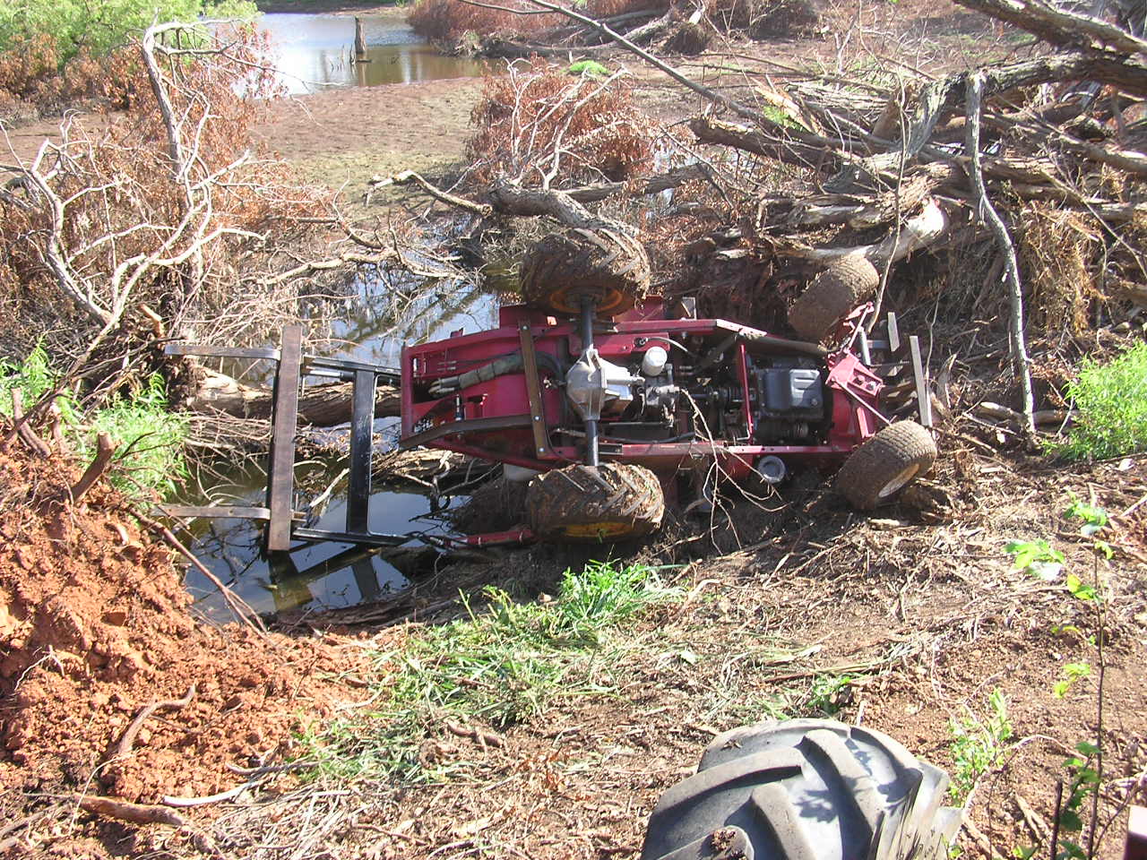

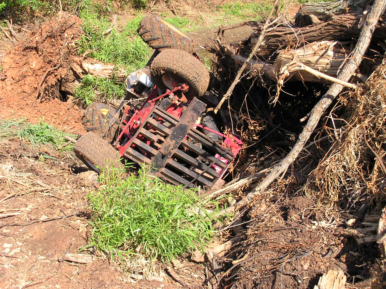

/ FEL, TORO Groundsmaster Put Together
#29

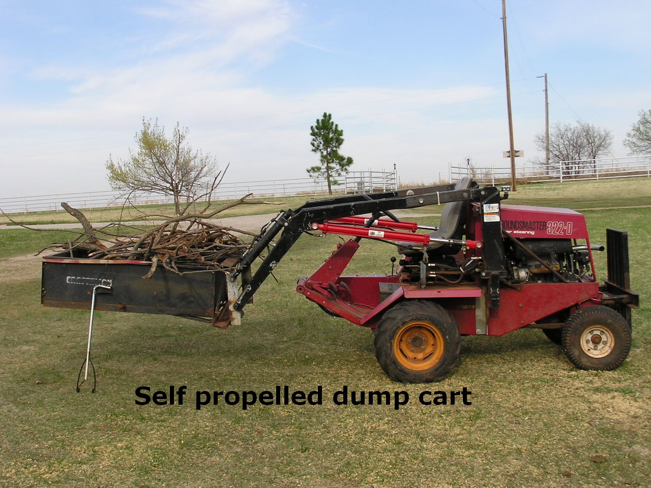

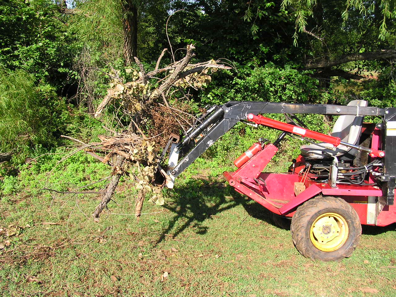

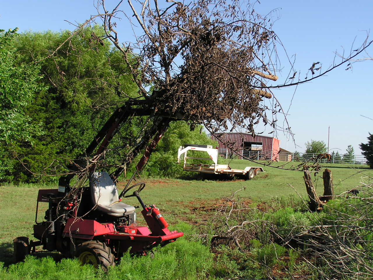

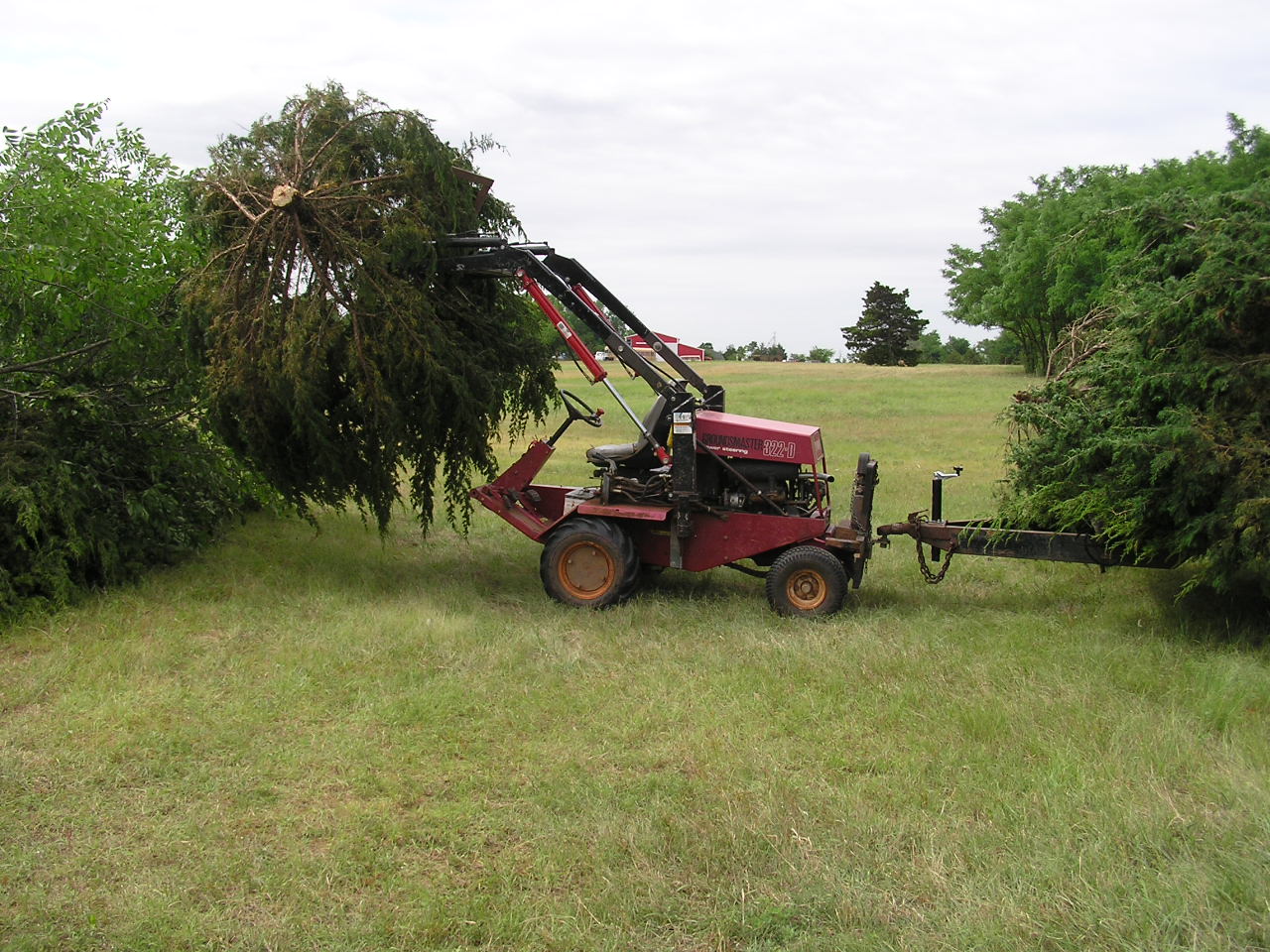

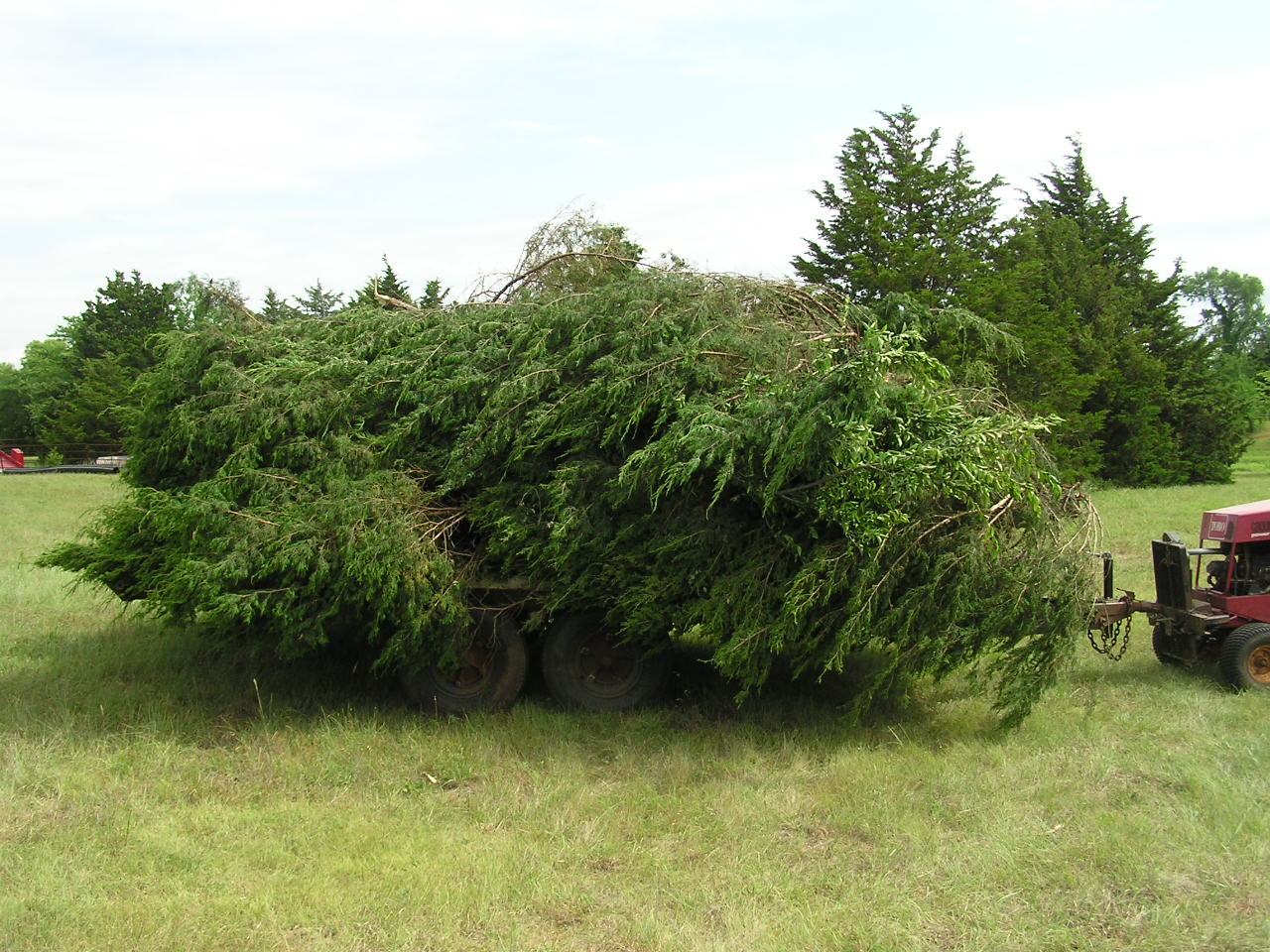

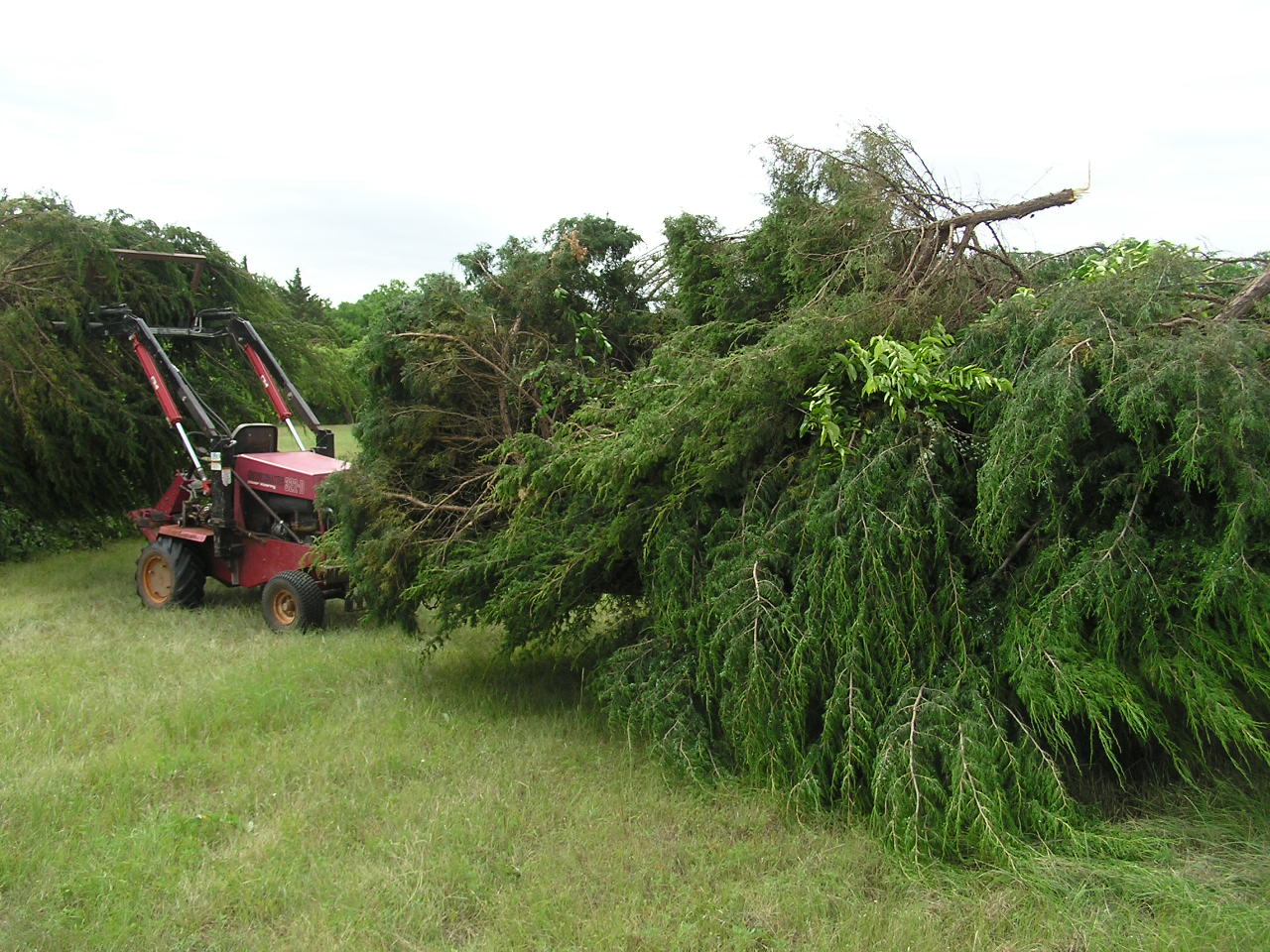

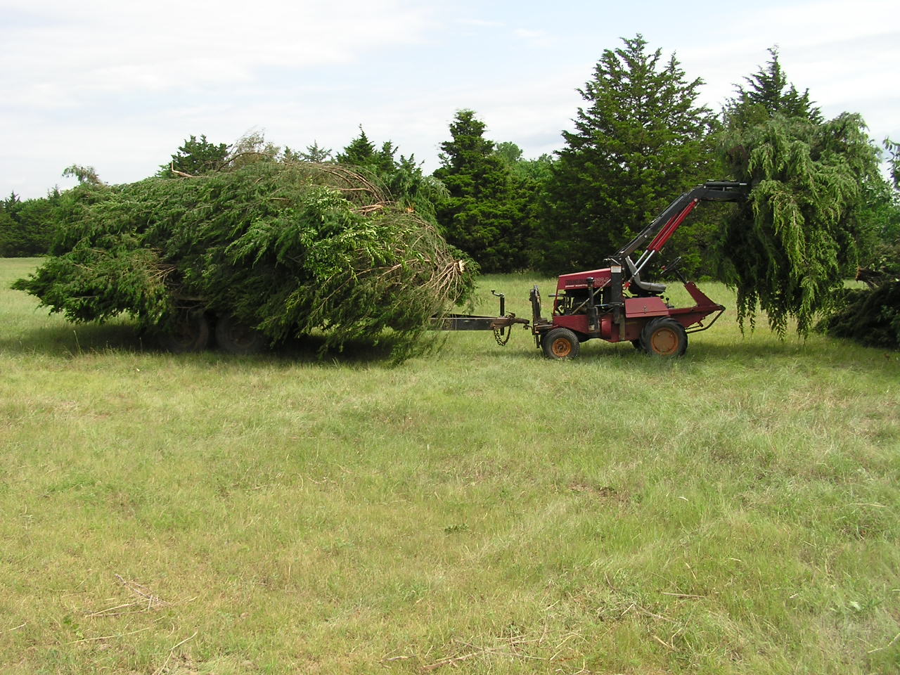

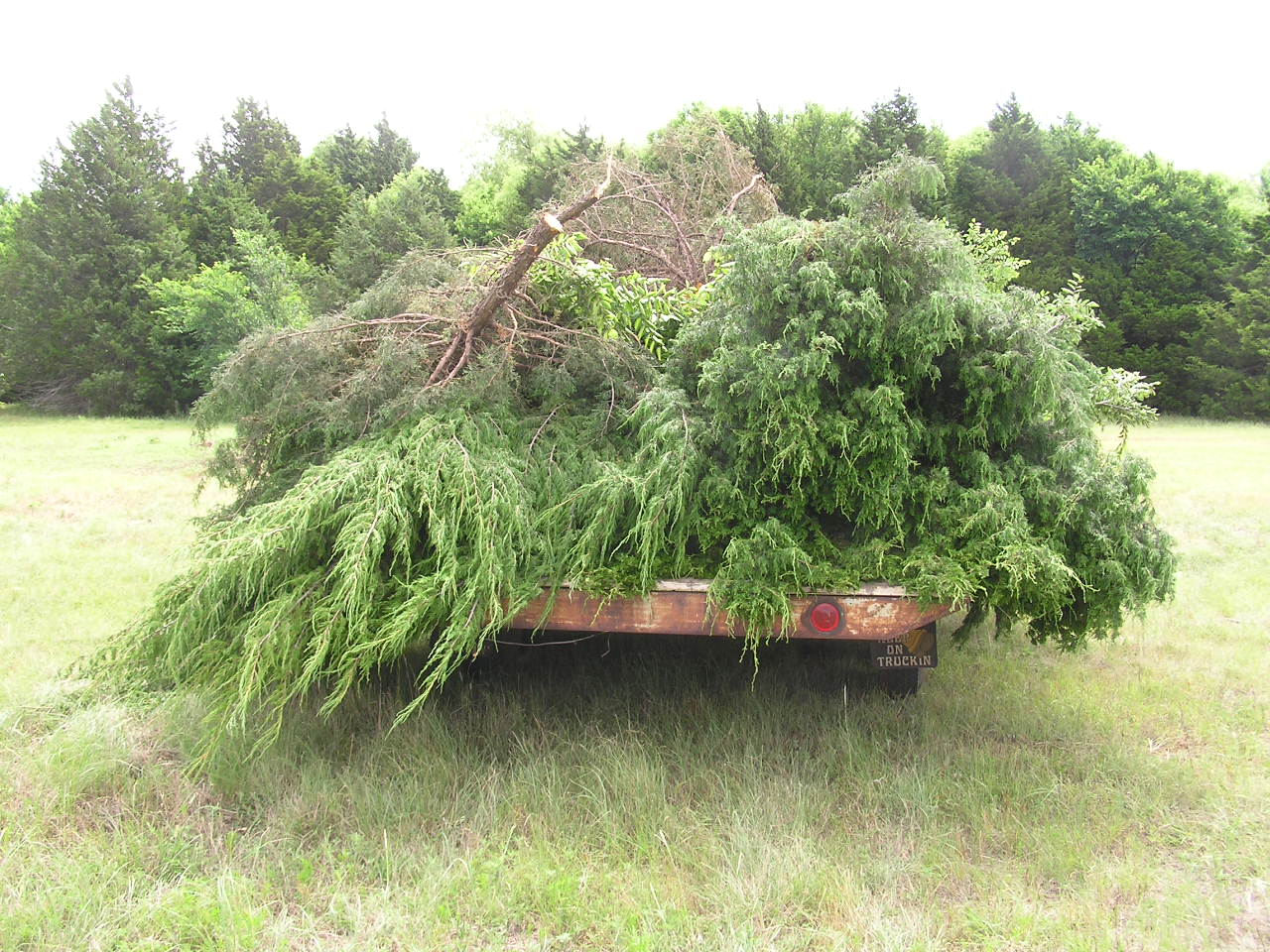

Some pictures taken 6-14-2009, using the brush fork and a deckover 8 x 16 trailer.
Loaded the trees on the trailer, then hooked on and pulled it to the brush pile, unhooked and unloaded it with the TORO.
/ FEL, TORO Groundsmaster Put Together #30
View attachment 306699View attachment 306700View attachment 306701View attachment 306702View attachment 306703View attachment 306704
OK.............I just gotta ask.
In every picture, you are hooked to the trailer. Watcha doin, flipping the brush over your head onto the trailer???:laughing:
Yep, sure looks like it. :)
Guess I could change the pump pulley to increase the flow rate and do it! :D

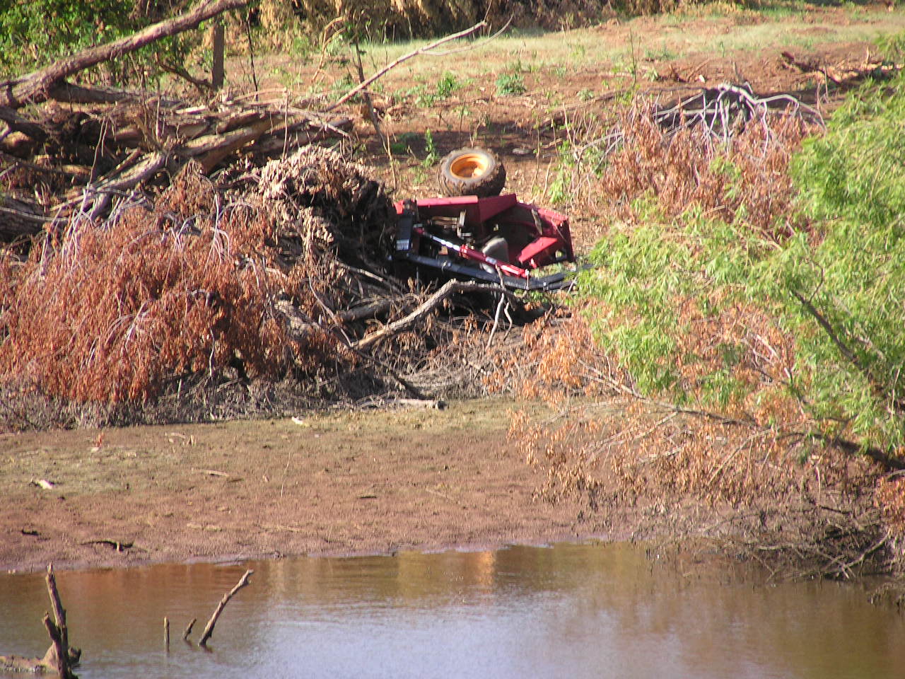

Here is one that could have landed on my head, I didn't level the forks when I raised it.
/ FEL, TORO Groundsmaster Put Together #33
Be careful. Don't want to see anyone get hurt.

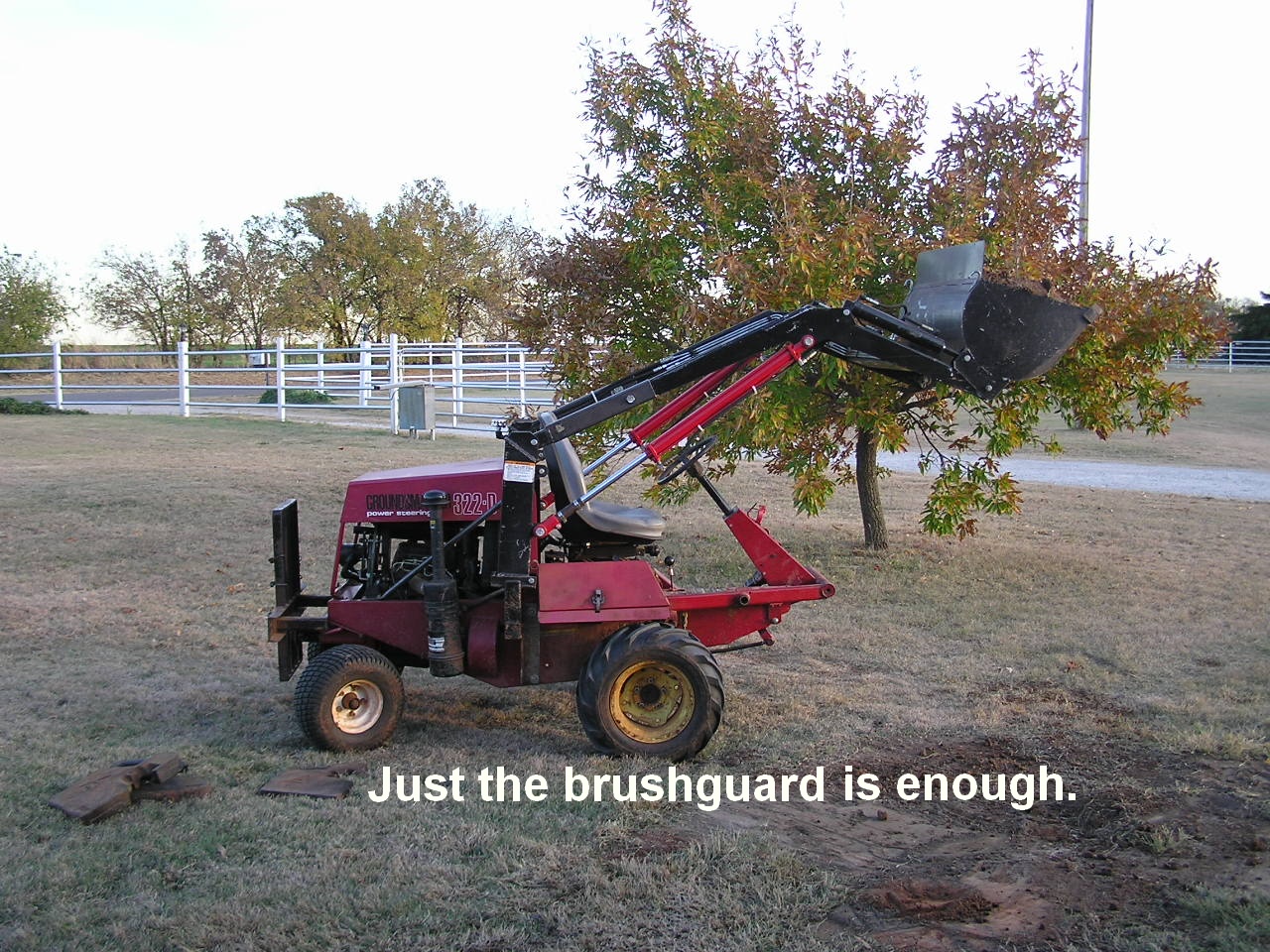

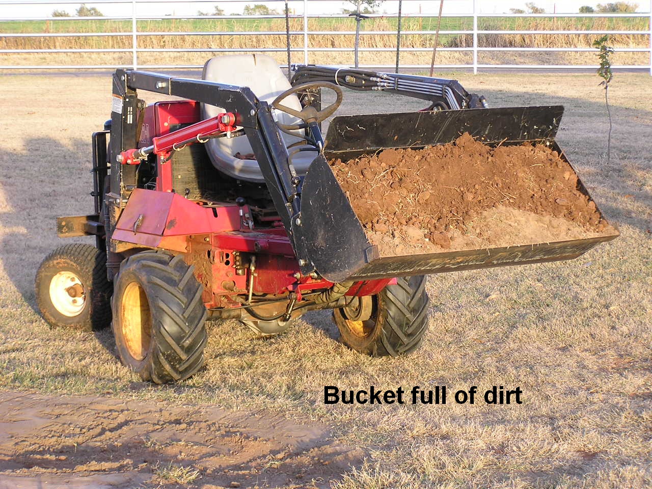

Neat idea.
So this thing is front wheel drive, what happens when you try to put downforce on the arms for diging? Do the front wheels loose traction?
#35
Neat idea.
Yep, the trick is, to keep the bucket tilted down slightly, to pull down as it goes forward.
I use it with the brush fork, or the 4' boxblade in float, most of the time, so it isn't a problem.

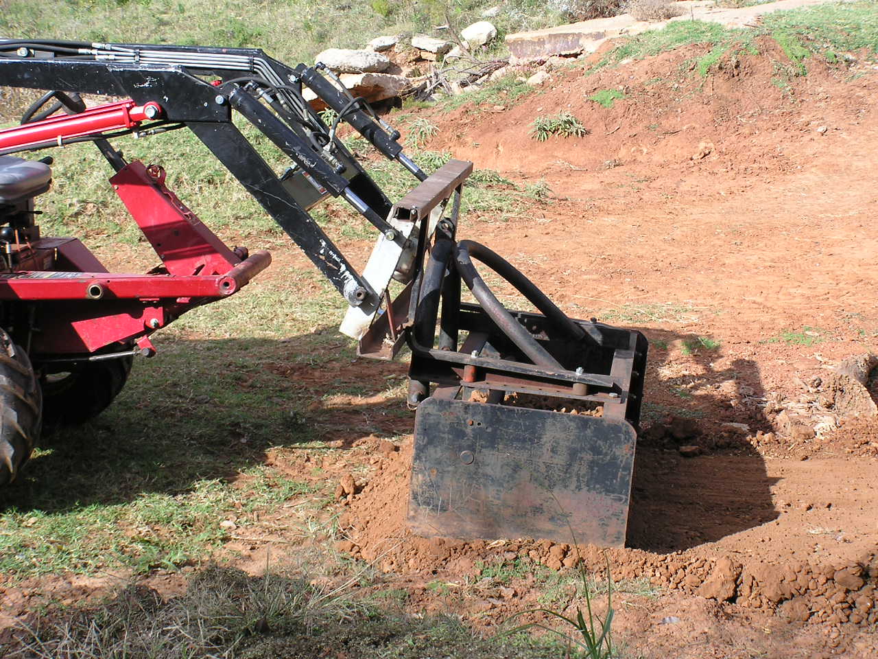

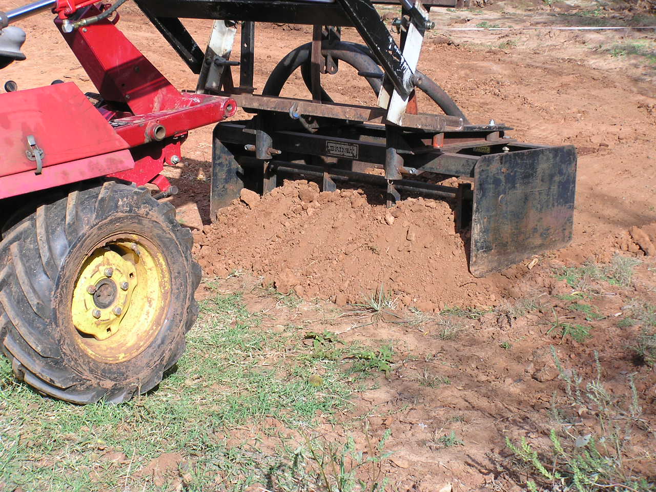

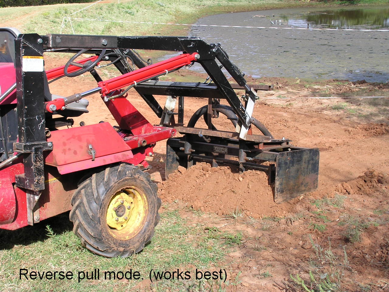

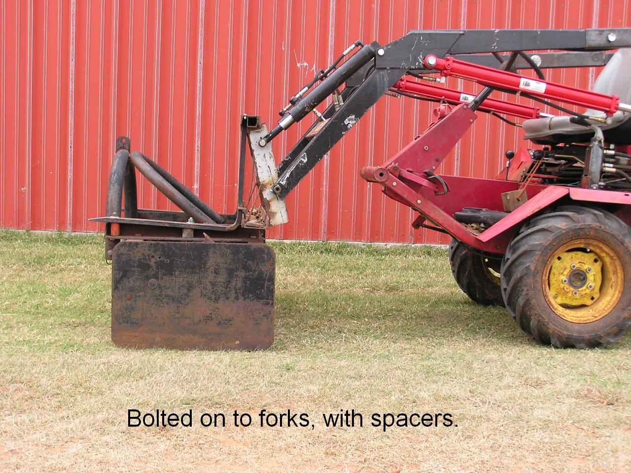

The box blade.
The way it was, 10/20/2005, bolted to the forks.
A few years later I removed the 3 point frame, drilled holes in some angle iron and bolted it to the box blade.
Can tilt it to use the rippers without moving dirt.
Can use it this way to scrape root balls on trees that have been pushed over.

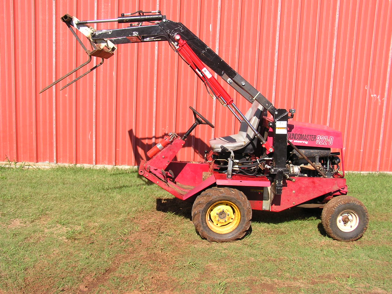

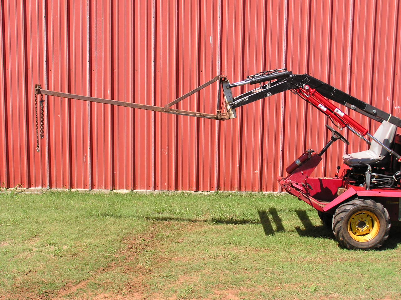

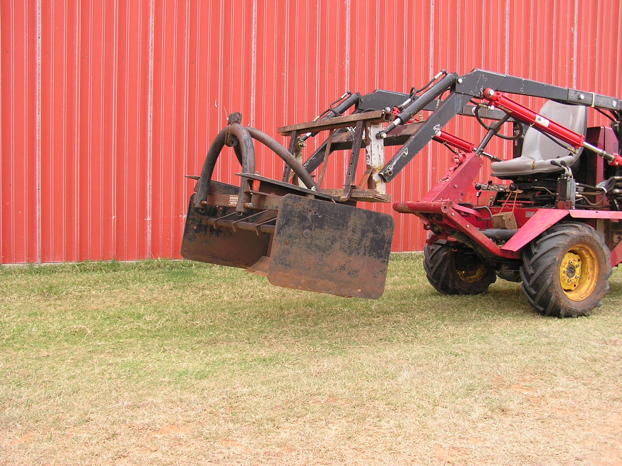

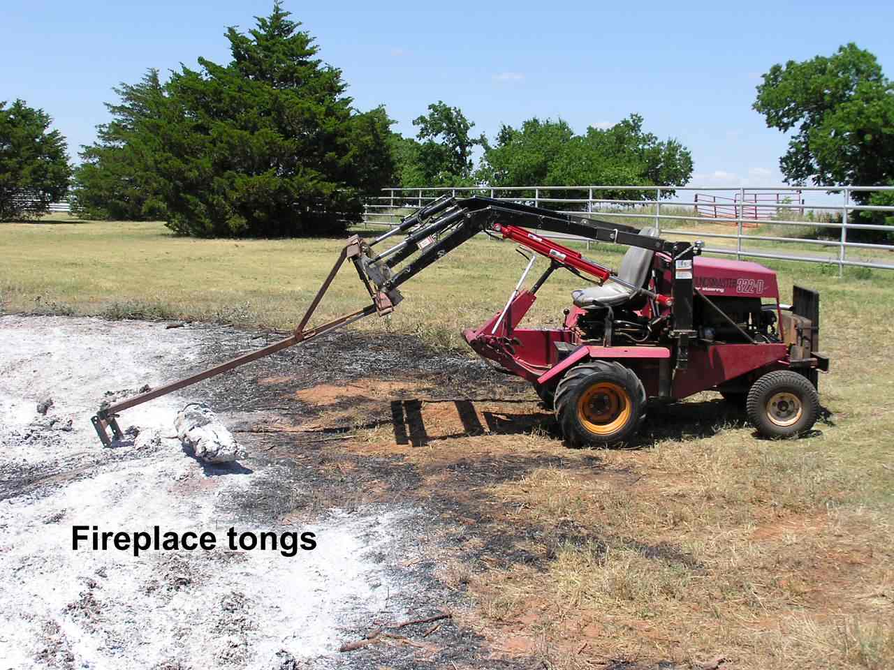

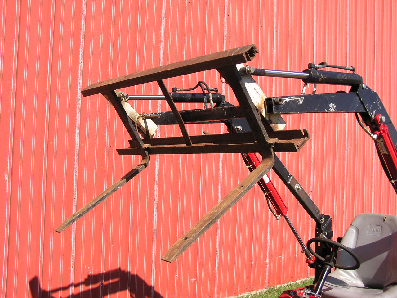

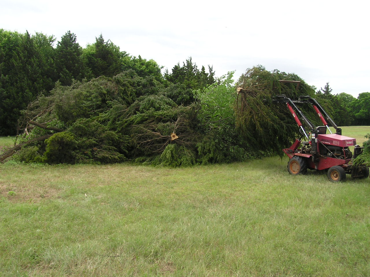

Brush fork, didn't take any pictures of it back in June of 2009, when I made it, so I took some now.
Used 3/4" sucker rod cut to 4' long and some square tubing. Welded the couplers to the bottom of the frame.
Have a set of 2' long rods that I use for moving round pen panels, RR ties and other things.
Here it is with a little stick on it.:D

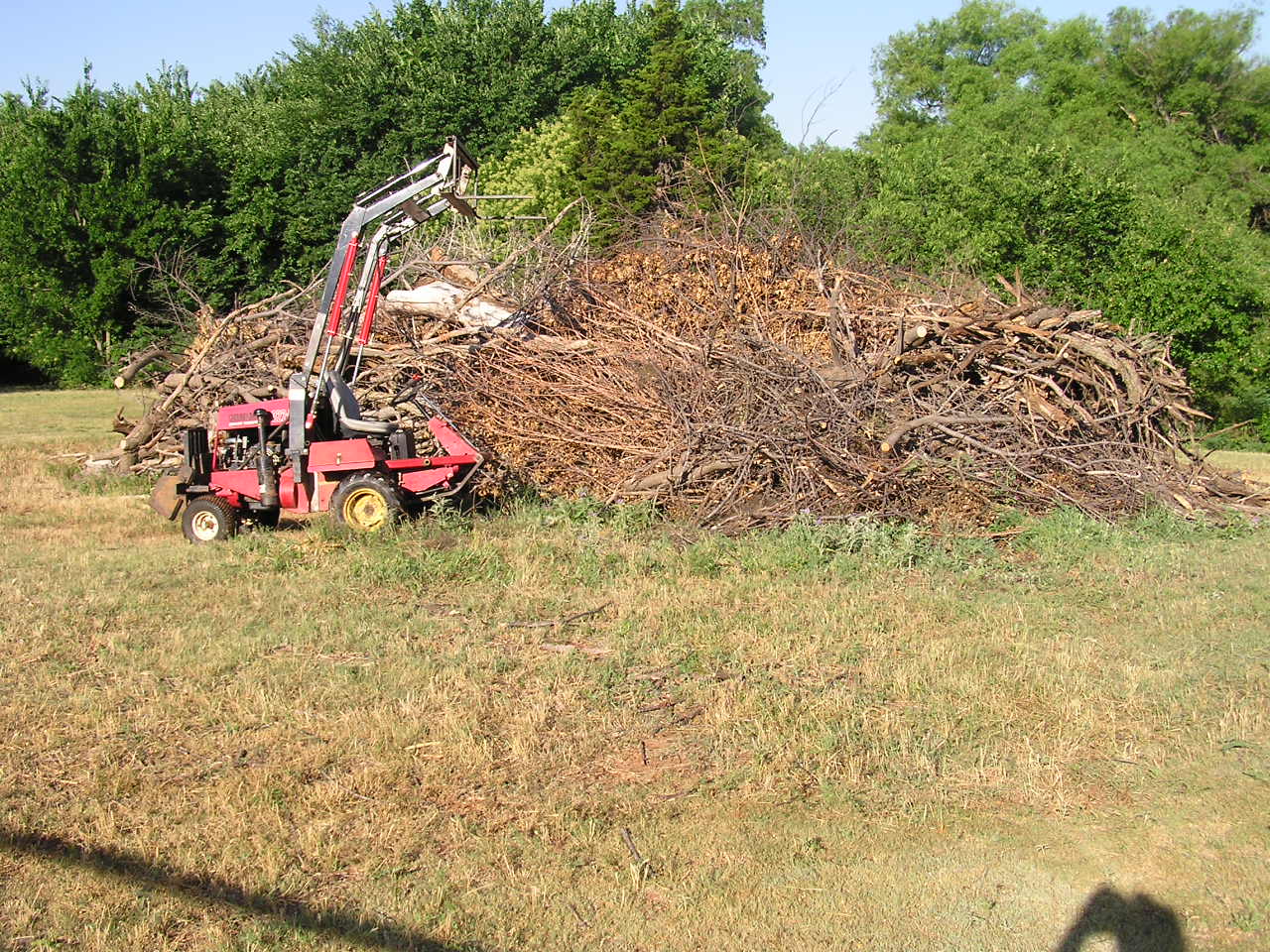

Adding a cedar tree to the pile that I made with the brush fork.
