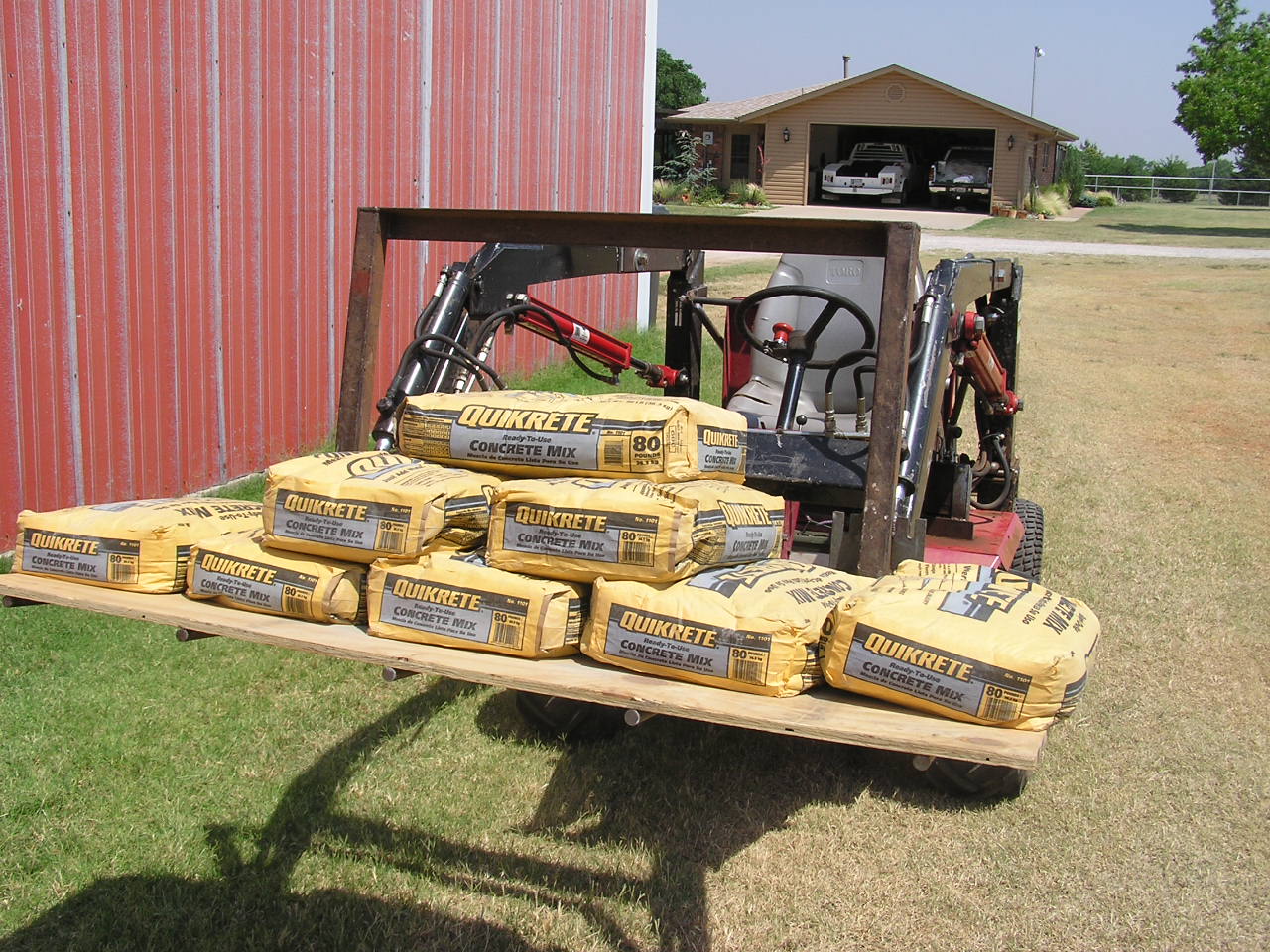

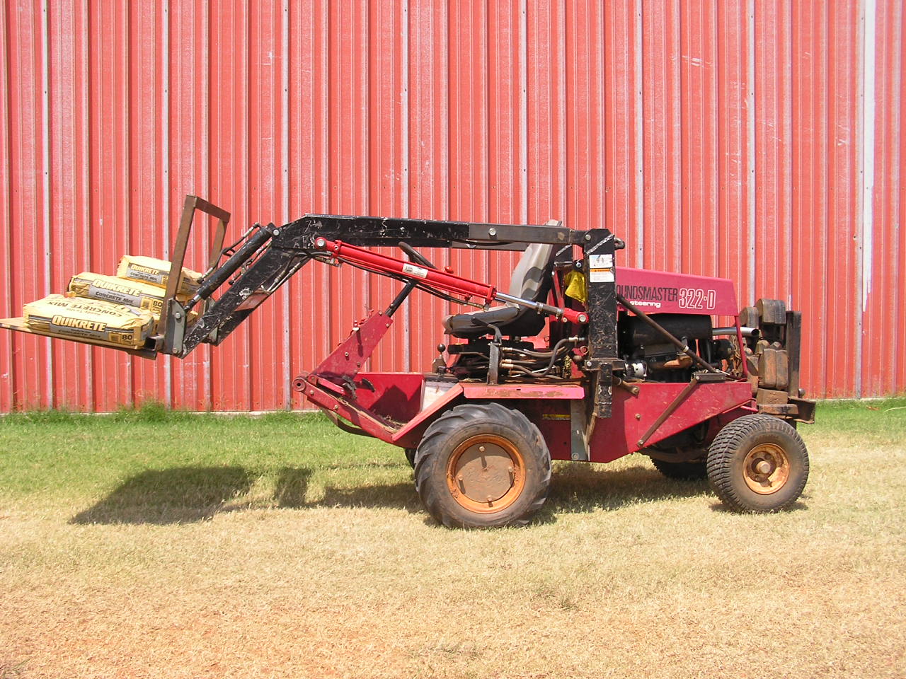

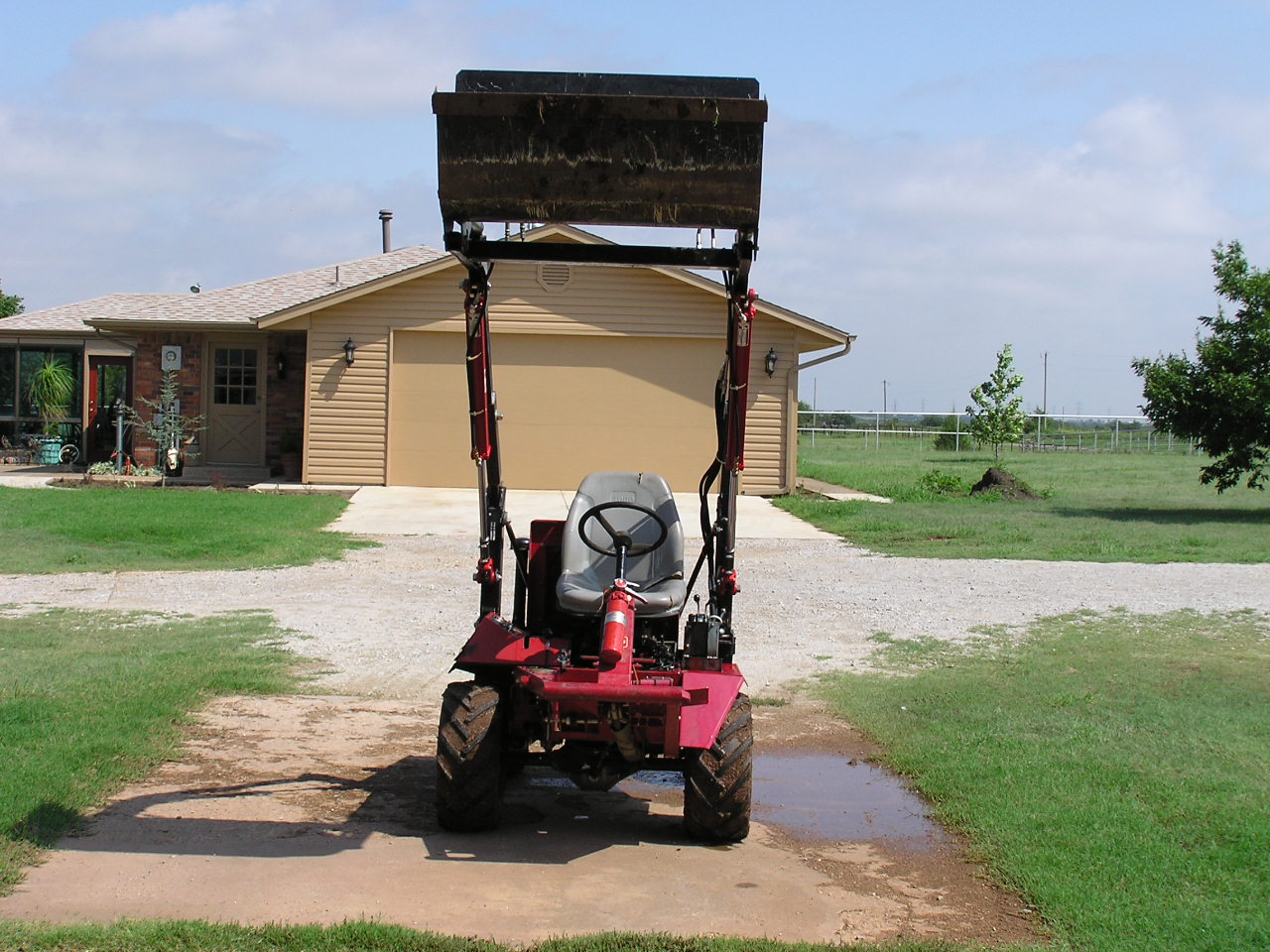

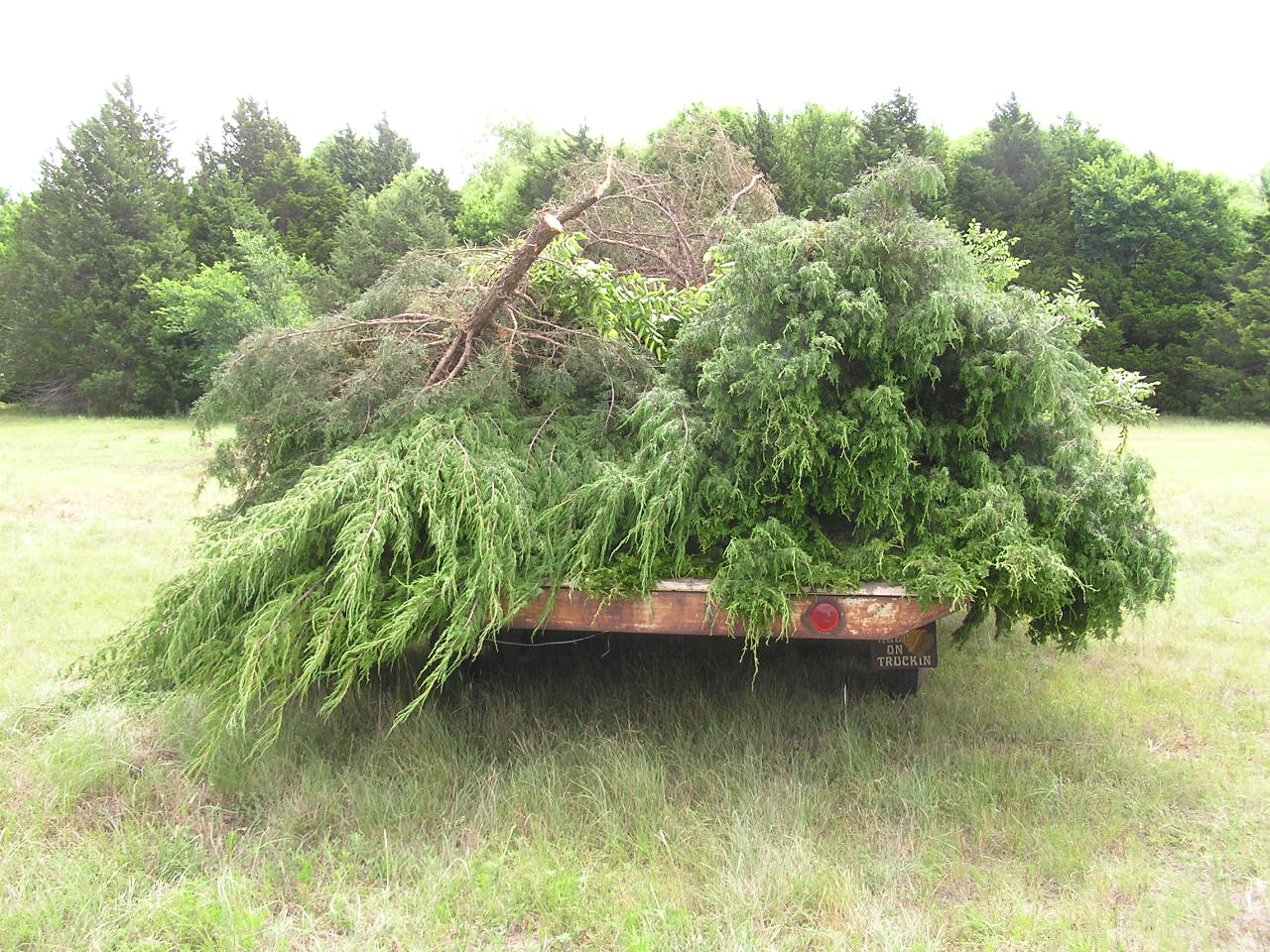

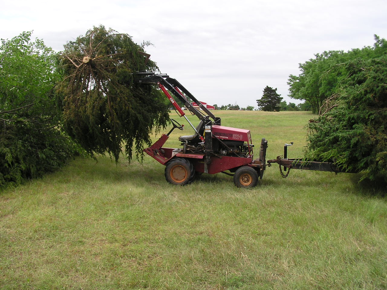

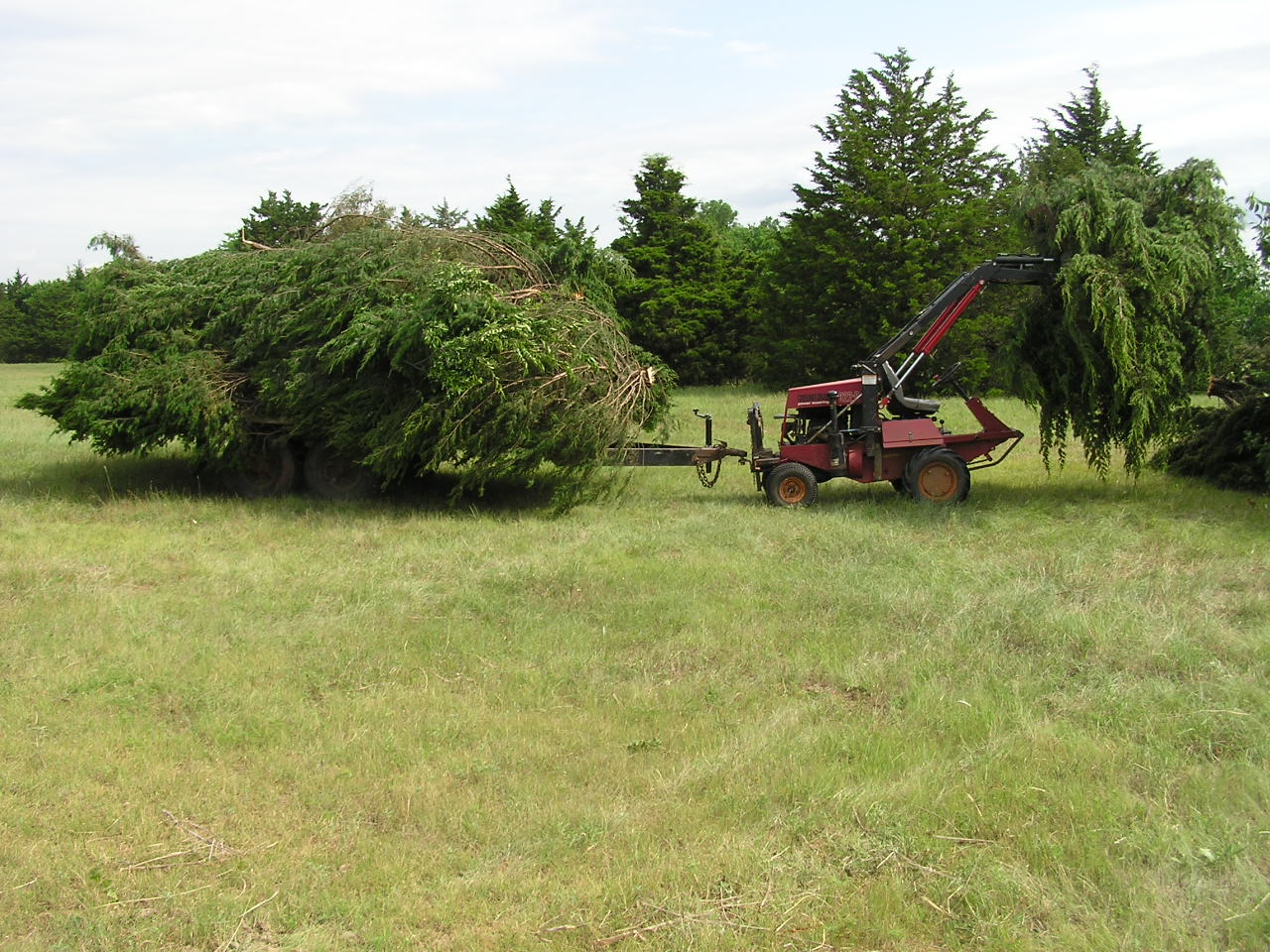

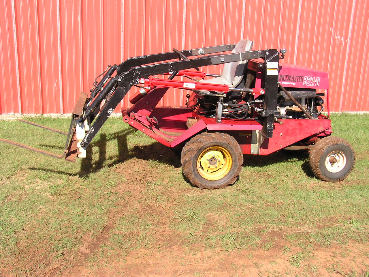

Put the 4' long brush fork on today, first time in several years.
The brush fork can be a pallet fork! :D
You can easily see the ends of the forks from the seat.

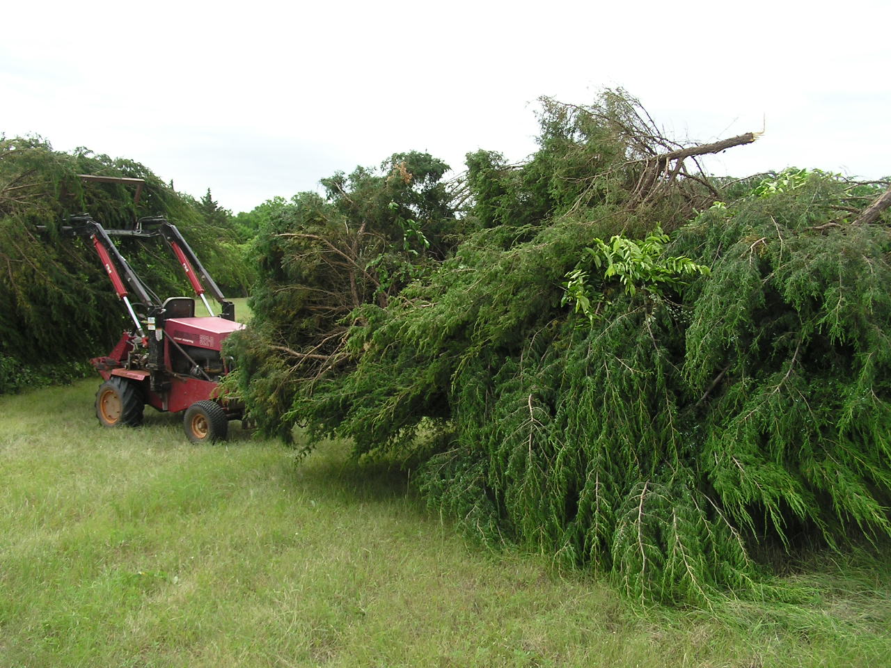

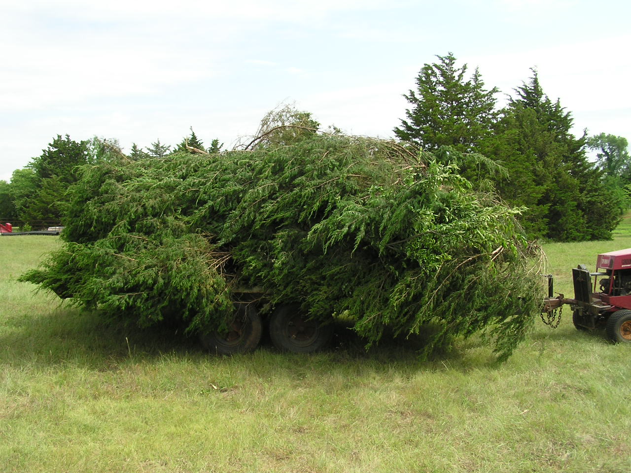

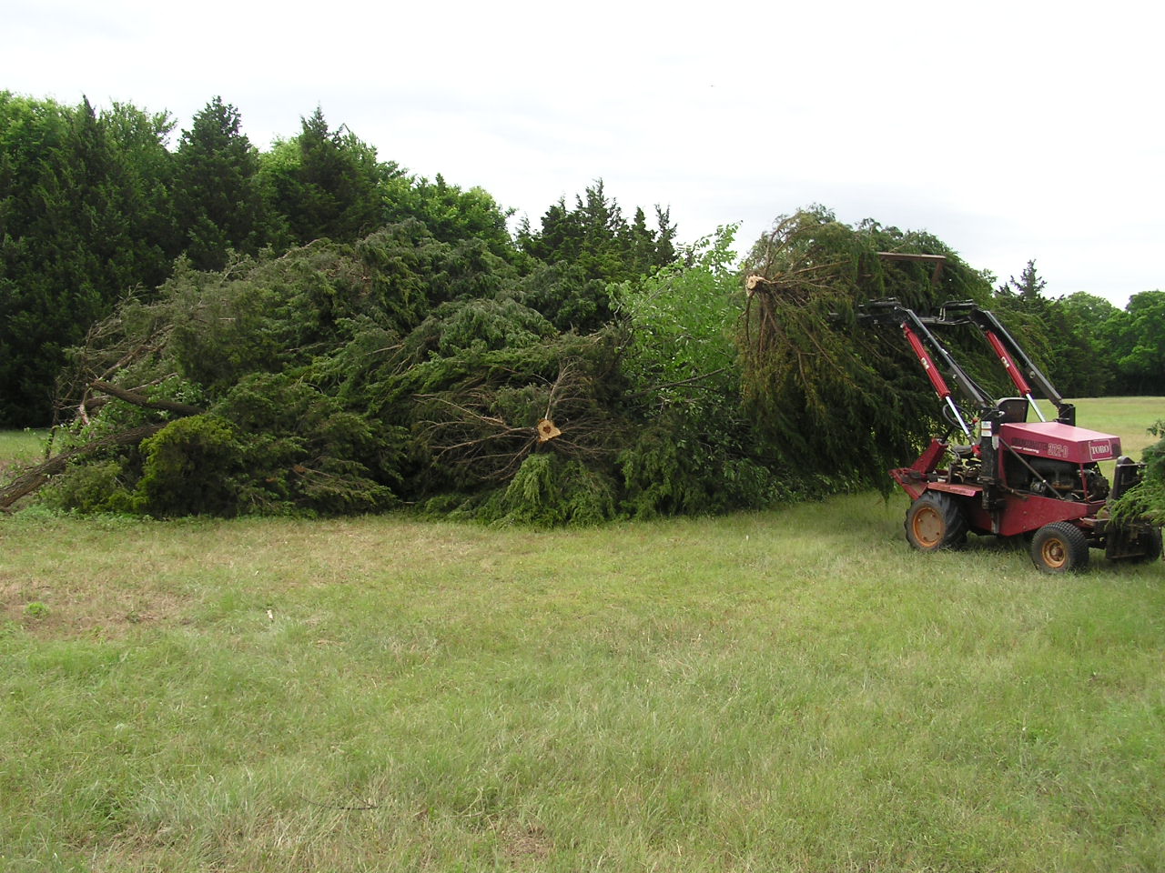

Headed for the pile. Forks are 9' 3" above ground level, at the pile

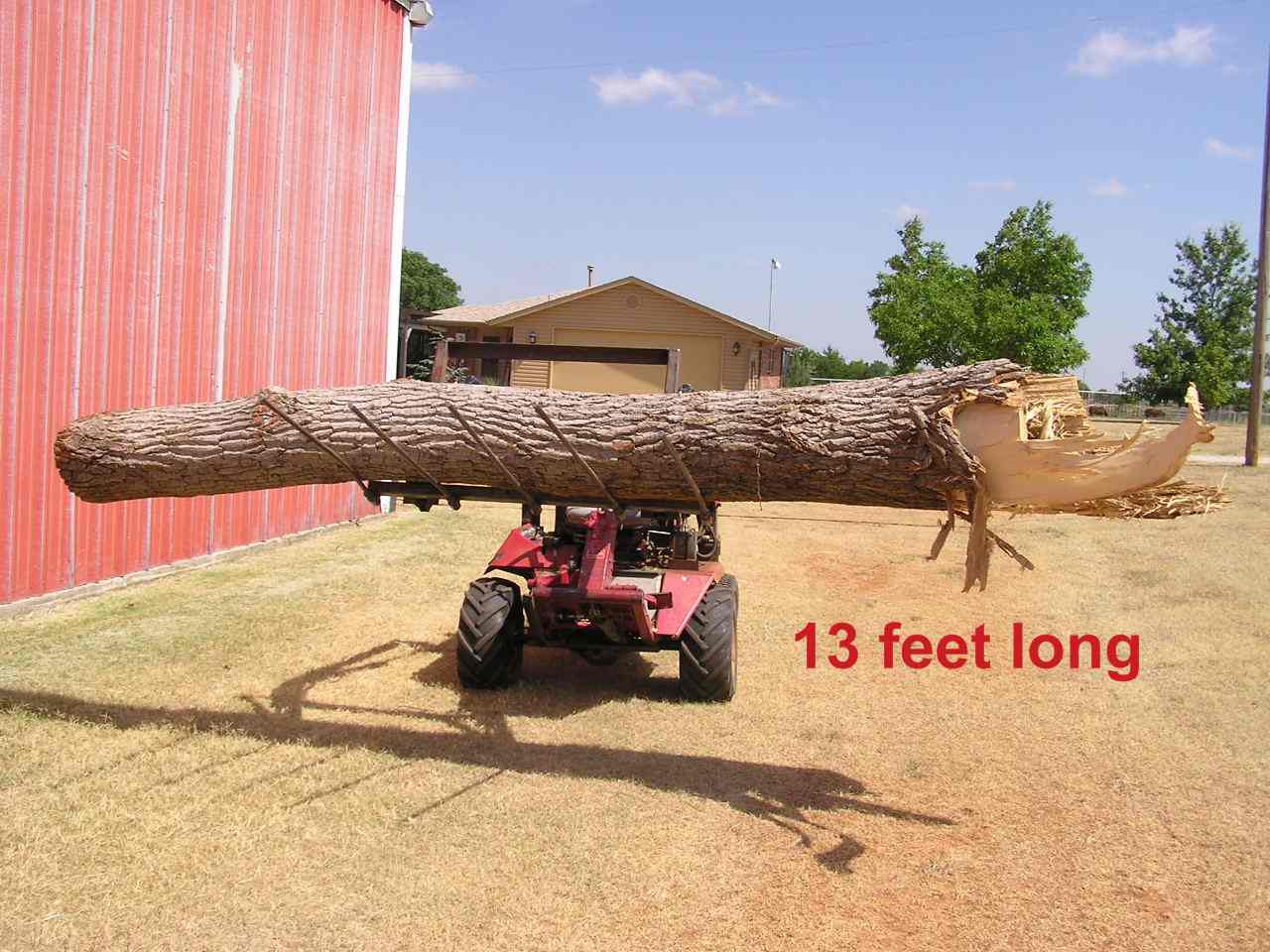

Removed the 4' long rods from the brush fork frame and put two short rods on it, to move some cattle panels.
3 ten footers.
8 twelve footers.
8 sixteen footers.
Had to add more counterweight for these! :thumbsup:

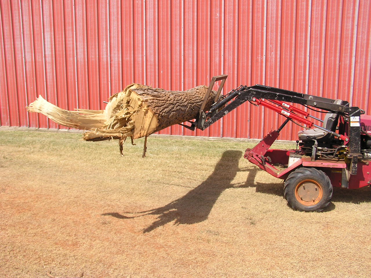

Not the big ones.This is the heaviest thing that I have lifted and had to add extra counter weight to be able to steer! :D
We use the Toolcat to set out the 5x6 round bales.

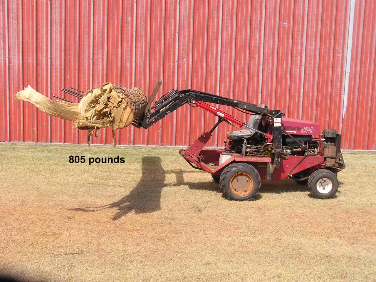

/ FEL, TORO Groundsmaster Put Together #48
WOW, 805lbs is way more than my garden tractor loader will lift.
#49

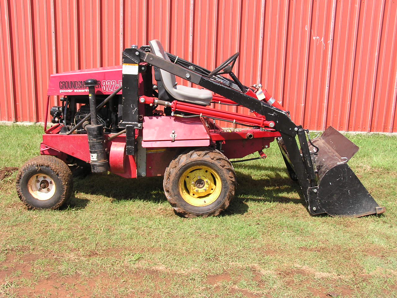

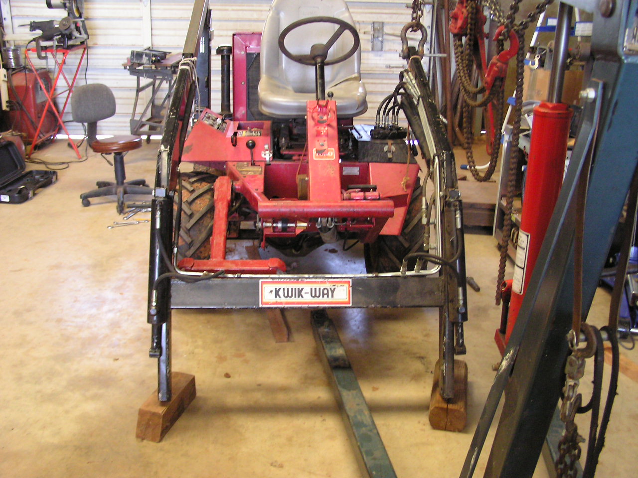

On garden tractors the lift rating is limited by the size and strength of the front axle and spindles.
The load rating for the Dana front axle on the TORO is 1800 pounds and this heavy duty K-W garden tractor loader can handle the weight.
I just have to add more ballast when lifting heavy.

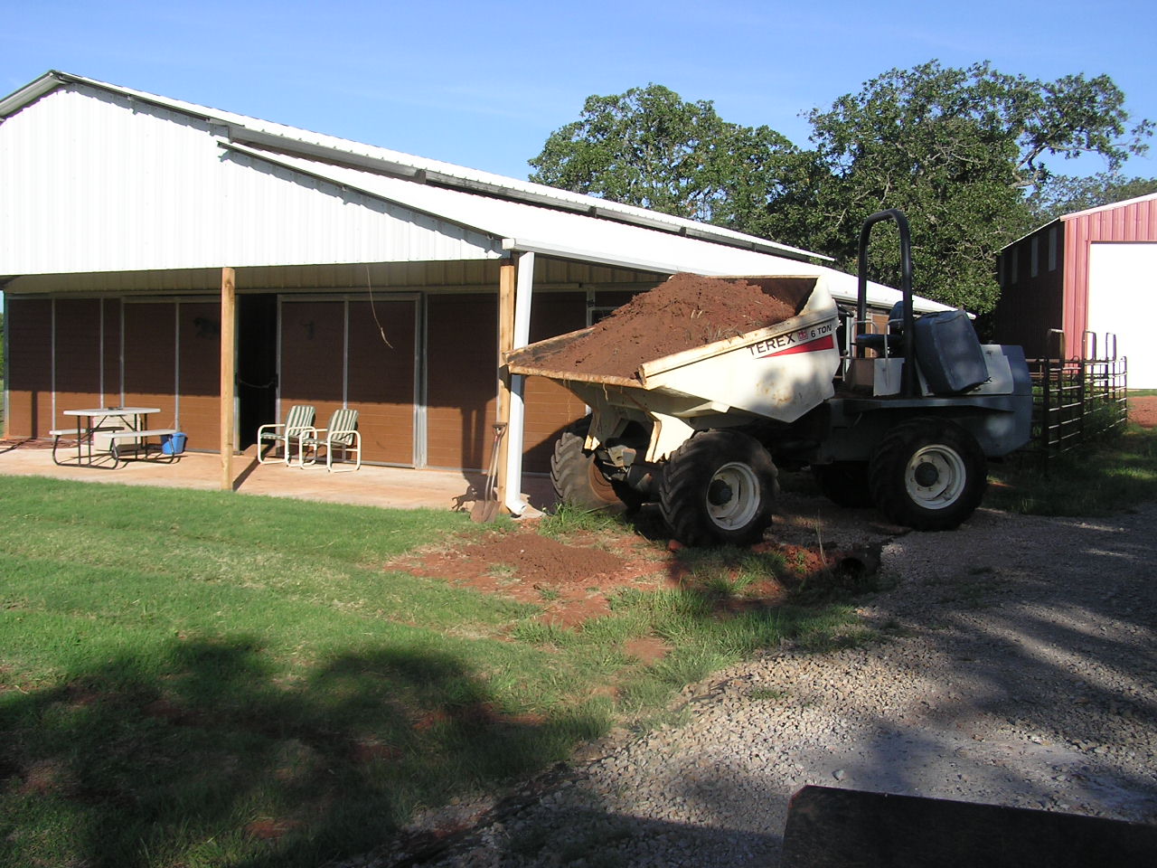

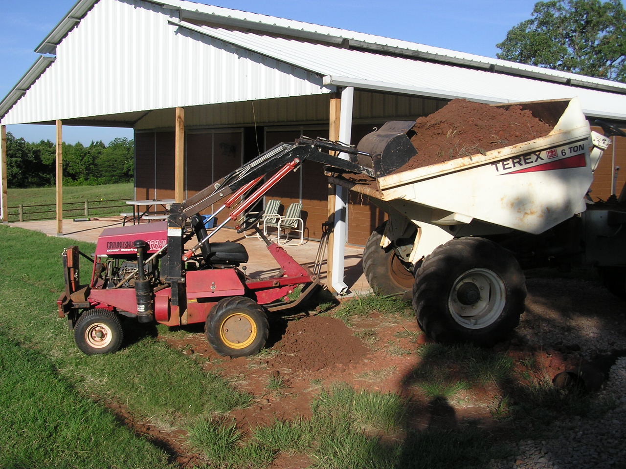

This is the first time I have removed dirt from the dumper with a loader, always just dumped it before.
Filling the gaps in the sod with topsoil.
View from the seat, looking under the the bucket as it dumps.
Now the bermuda can spread. :thumbsup:
