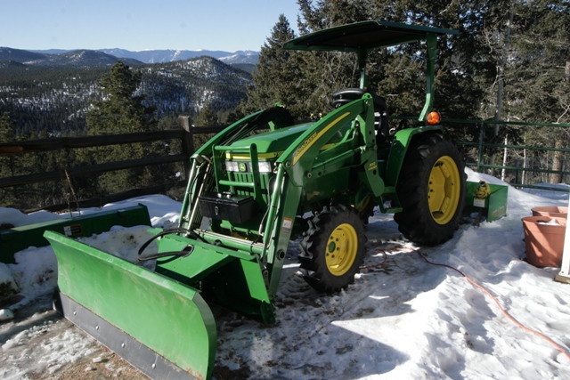

I have a 6' frontier blade that I bought from JD and it mounts on the quick disconnects on my 790 FEL. It works well for me. I can't usually use my float or it will lift the front wheels up but otherwise it moves snow well. Beats the heck out of a rear blade, or a FEL bucket, or a walk behind snow blower which are two things I tried before. Yes it is way out in front and you have to be careful when you turn around and it would be nice if you could float it but it beats what I've tried before.
See attachment.

Mech;
How does the JD blade "feel" on the loader? Does it feel like a full bucket of stonedust when you lift it? Does heavy snow push the tractor around? (by heavy I mean in the 1 foot deep range) Do you know how much the blade and mount weigh?
I ask because when I was buying my 2520 the owner and salesman at the dealer swore up and down that although the 200cx has a higher lift capacity than the 300 loader, the 72" blade would be way too big for "the little 2520" and if I wanted one I should look to the 3x20 series at a minimum or better yet the 4x20 series. The 790 is not a lot heavier tractor than the 2520, (less than 100 lbs if I remember correctly)
I ended up with a Curtis 5' plow and while it appears to work well, it's simply not wide enough when angled and I get a lot of driveover. It would have been nice to get that extra 6" on each side.
Tom
/ FEL + snowplow = clear driveway? #5
It feels only a little heavier than the empty heavy duty bucket and I have hydraulic angle on it. The salesman would have sold me the 7 ft blade. I don't know how much it weights. If I float the blade it can become impossible to steer but otherwise it handles easily. I bought this late last April and here we don't get wet heavy snow except March and April and I haven't plowed a foot plus of that yet but I don't expect any problems based on how easily it plows in the higher gears and 6-8" of snow and even larger snow banks. I think my 790 weights about 2100 and my box blade about 700 and I have filled tires. The 2520 shows as 1865 on the JD website. Maybe others have a longer experience with their FEL blades.

I'm also happy with my frontier blade on my 790. We still haven't had a big, heavy spring snow but I was out last night clearing slush that had refrozen into deep ruts. I was pushing frozen slush that came over the top of the blade and there were no problems. Yes it pushes to the side once and a while and I did loose traction once going up a hill and had to take another run but I continue to be impressed with this little tractor and the blade. So much better than the rear blade I used on my previous tractors.

72" wide and don't know how heavy but doesn't look to be as heavily built as your setup. I wouldn't want much more weight on the front of my 790. It is a lot better now that I have the rears filled but the tractor is still pretty light.
