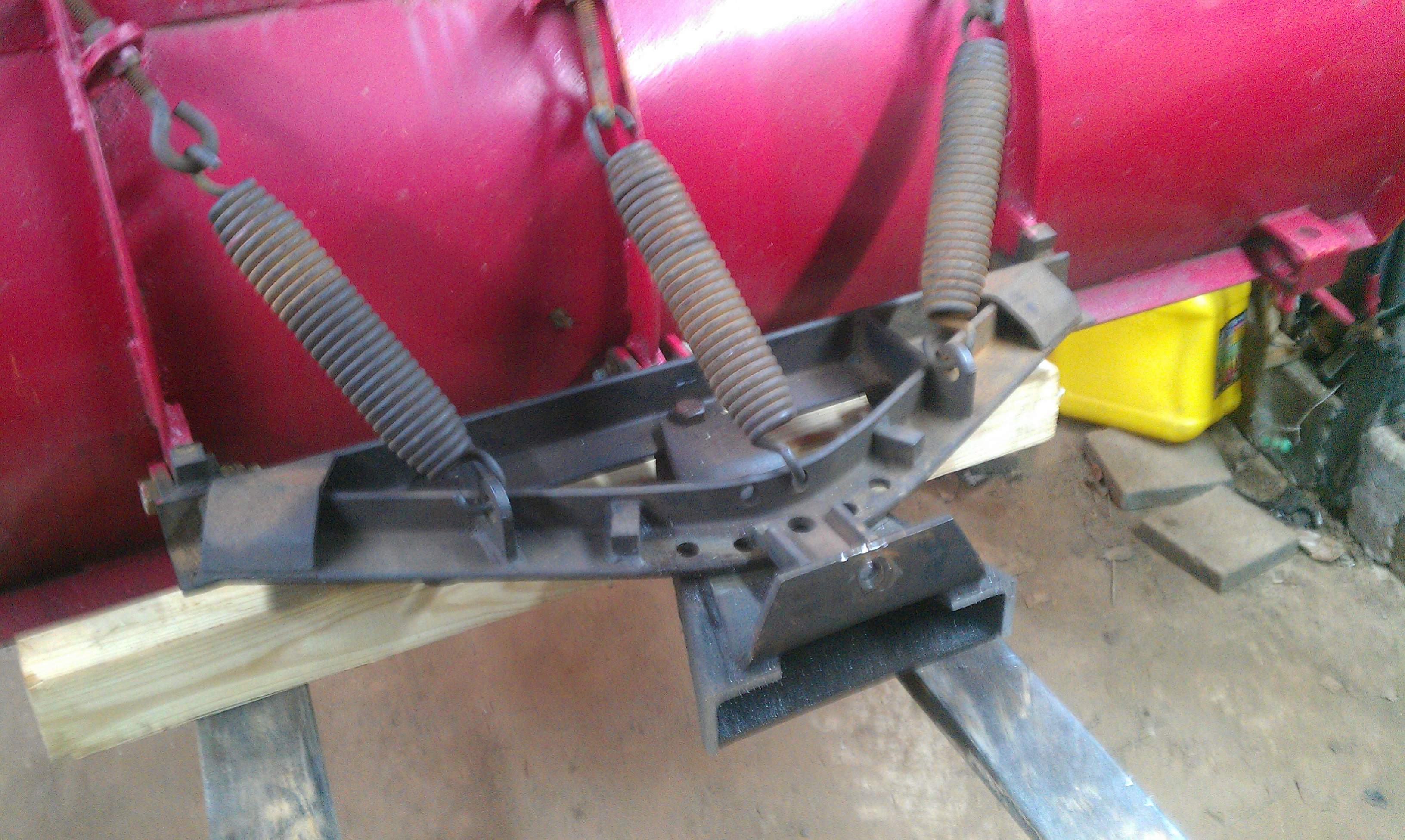

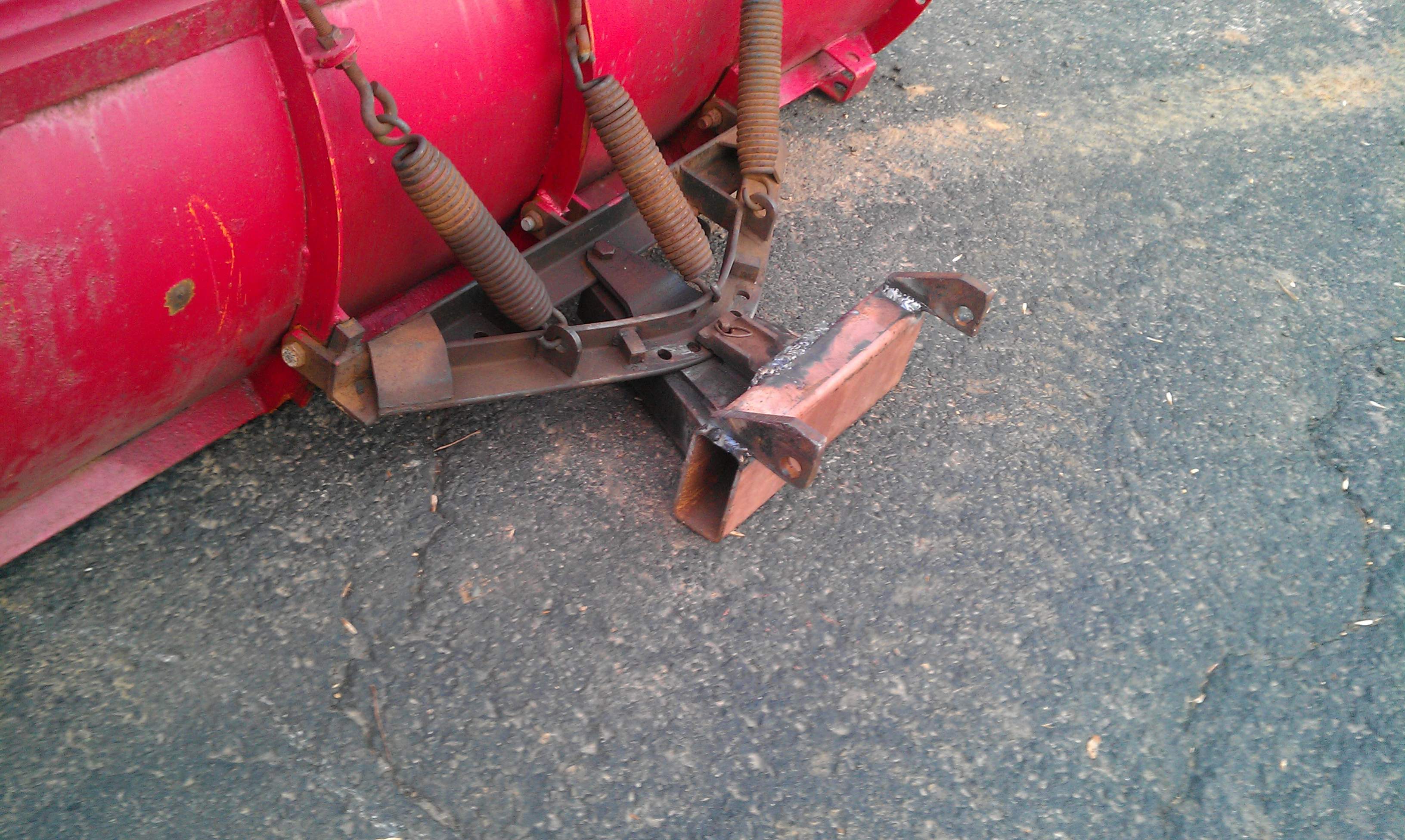

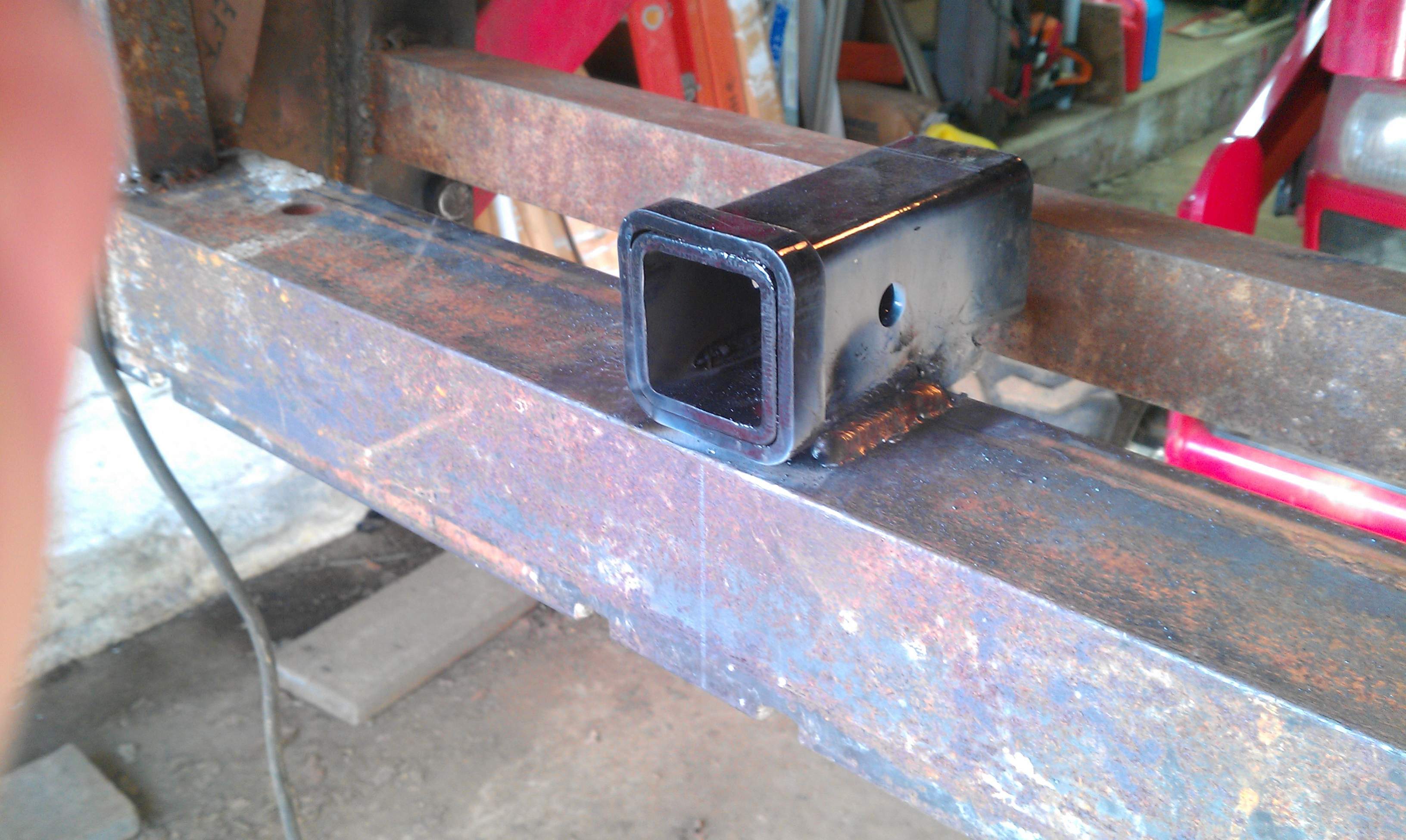

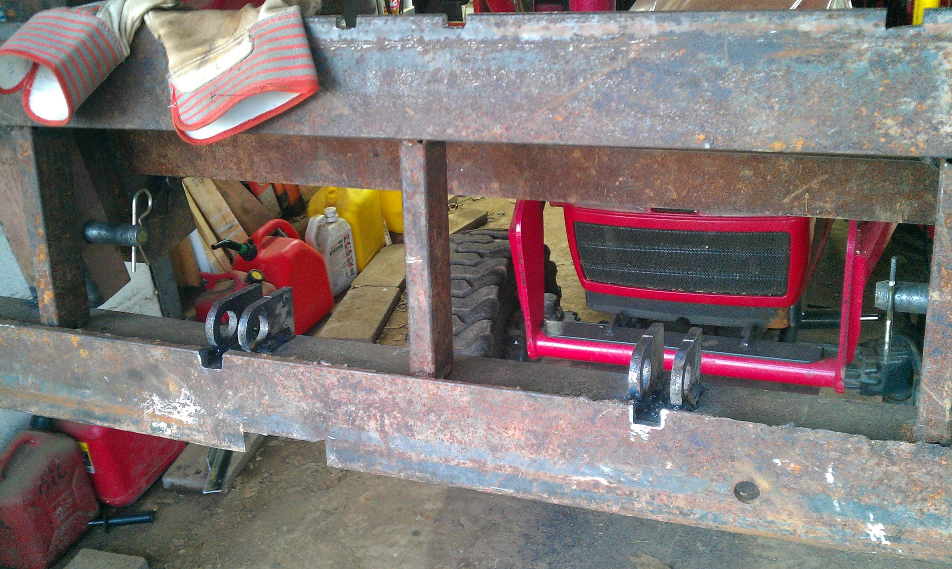

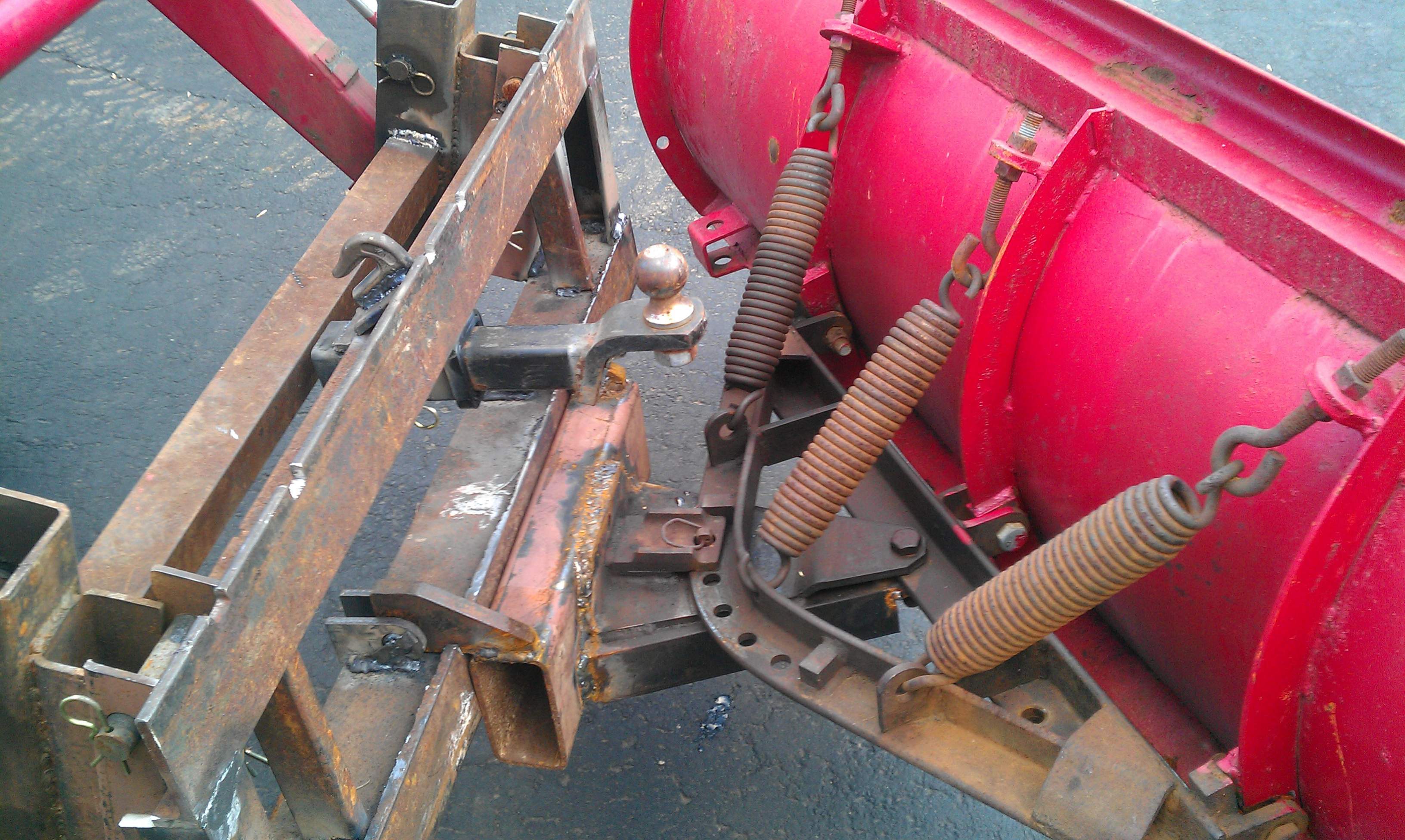

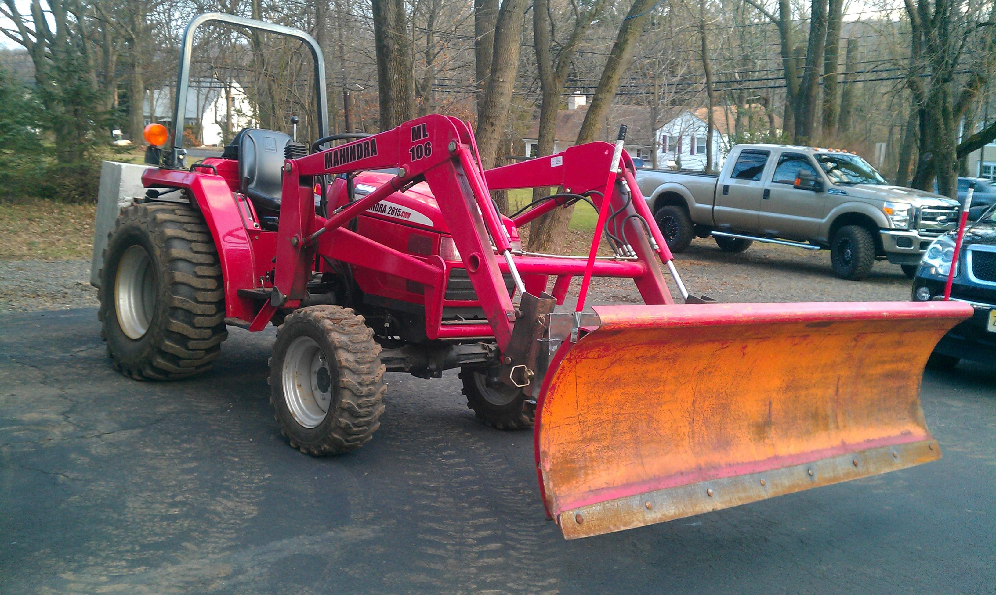

More pics. Also added a hitch reciever and chain hook to the pallet fork frame. Now its a multi purpose attachment-pallet forks, snow plow, trailer mover and chain lifter.

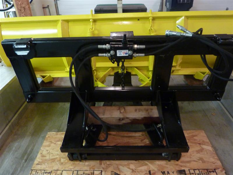

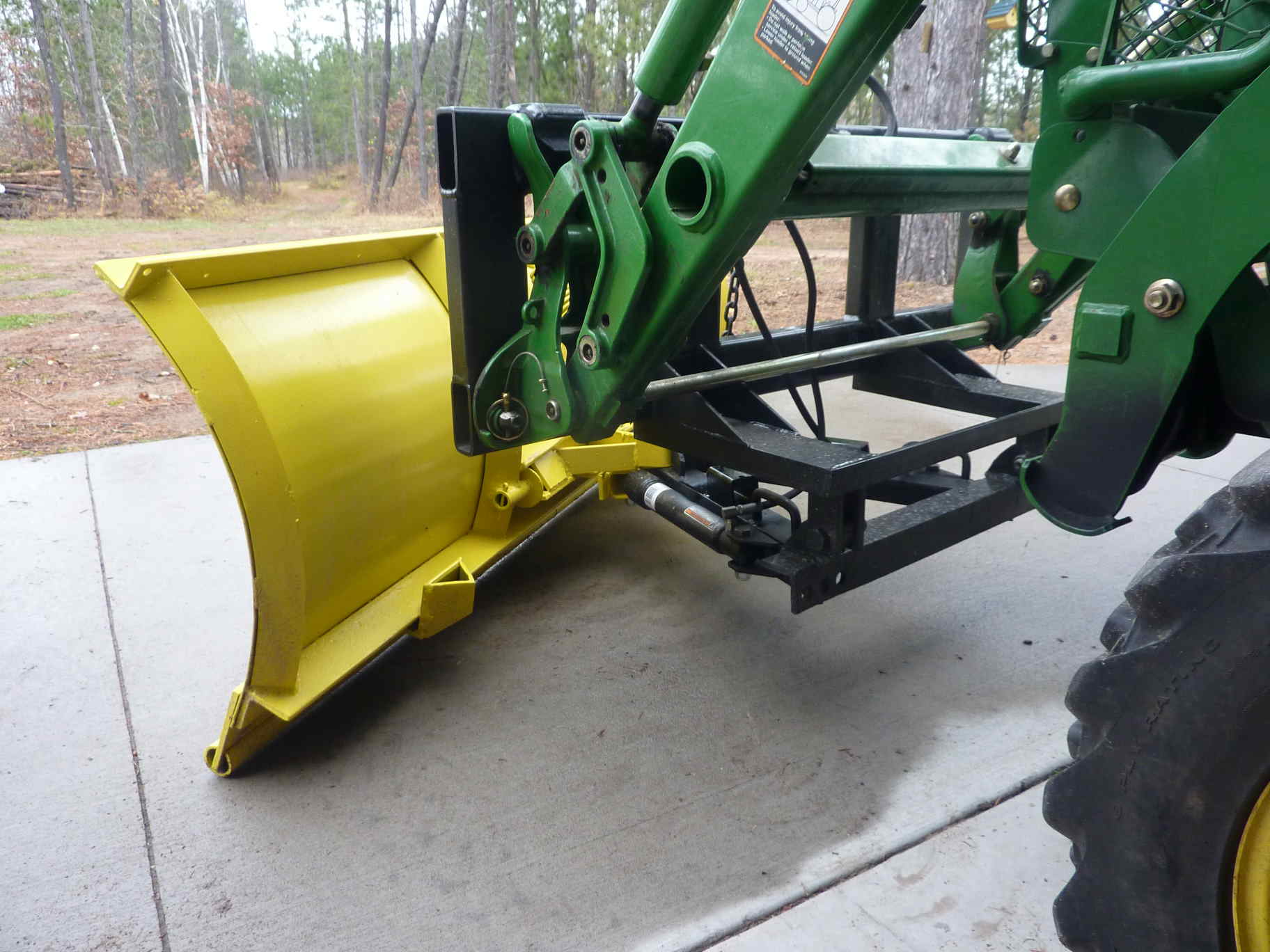

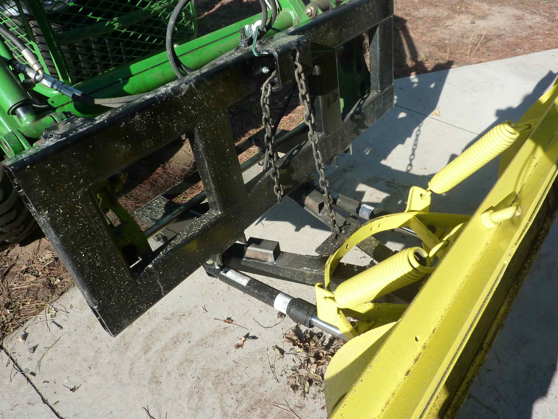

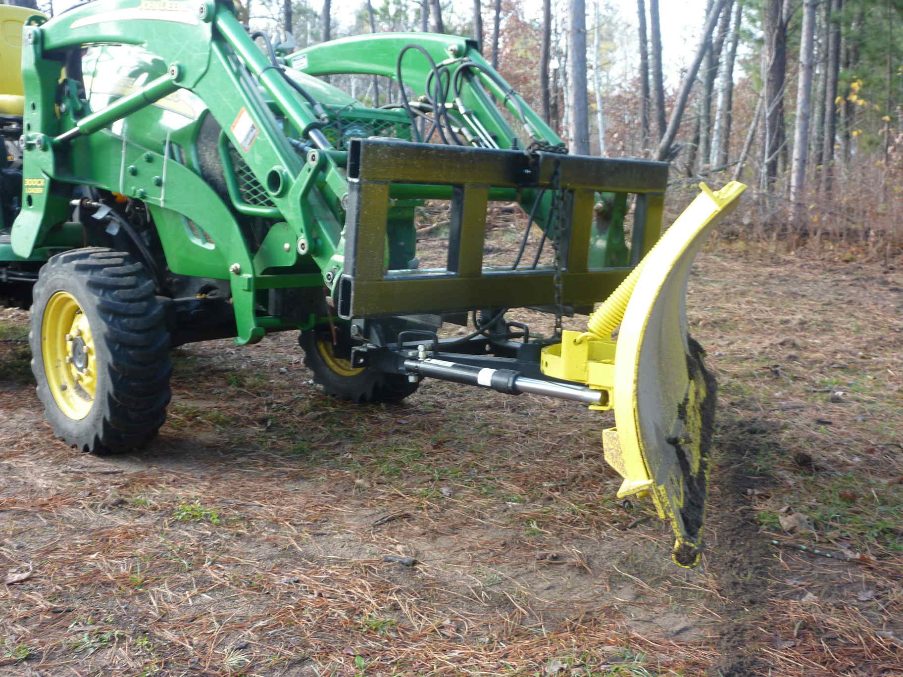

I did something similar with my old plow and pallet fork frame. Works great.

/ FEL Snow Plow #23
Interesting, different takes on the concept. Both look effective, but you guys got to get some angle cylinders, get with the 21st century :)
JB
JB,
I agree with the 21st century comment and plan on adding the angle cylinders in the near future.:thumbsup:

Woodtick, I like your setup, had I seen yours sooner I probably would have done something similar.
JB, I just got done cutting the cylinders off. I'm only plowing my driveway and its not too big. If i had to plow multiple driveways, or plowed commercially I would go with hyd angle but my manual setup should do for now.

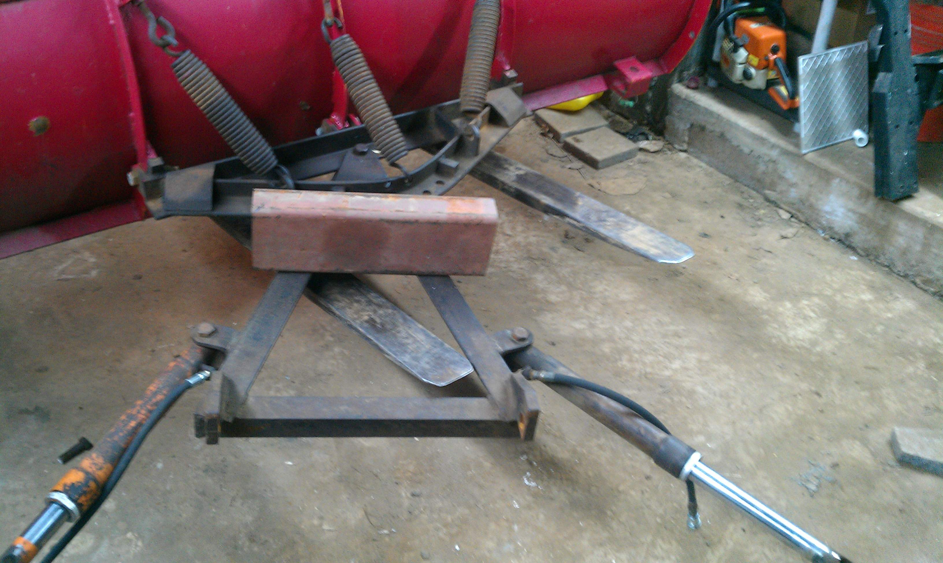

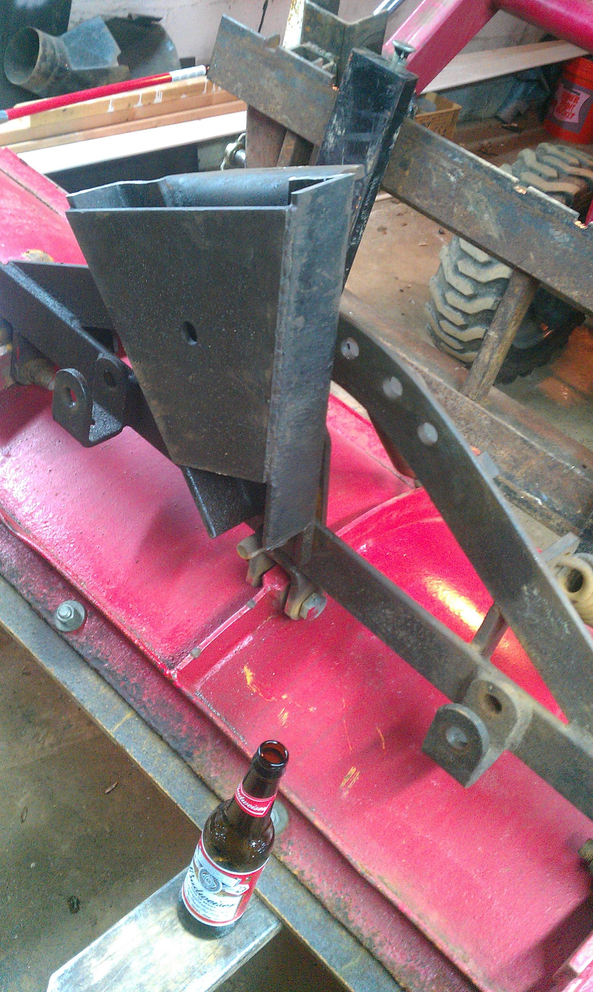

Its been a while since I last posted on the progress of the plow set up. I did some cutting and welding about 2 weeks ago and finished it up today. Here are some pics.
nice beer bottle
:thumbsup:

Its better than the bucket only but without angle cylinders I could not imagine using mine. You will want them sooner than later, much sooner.
