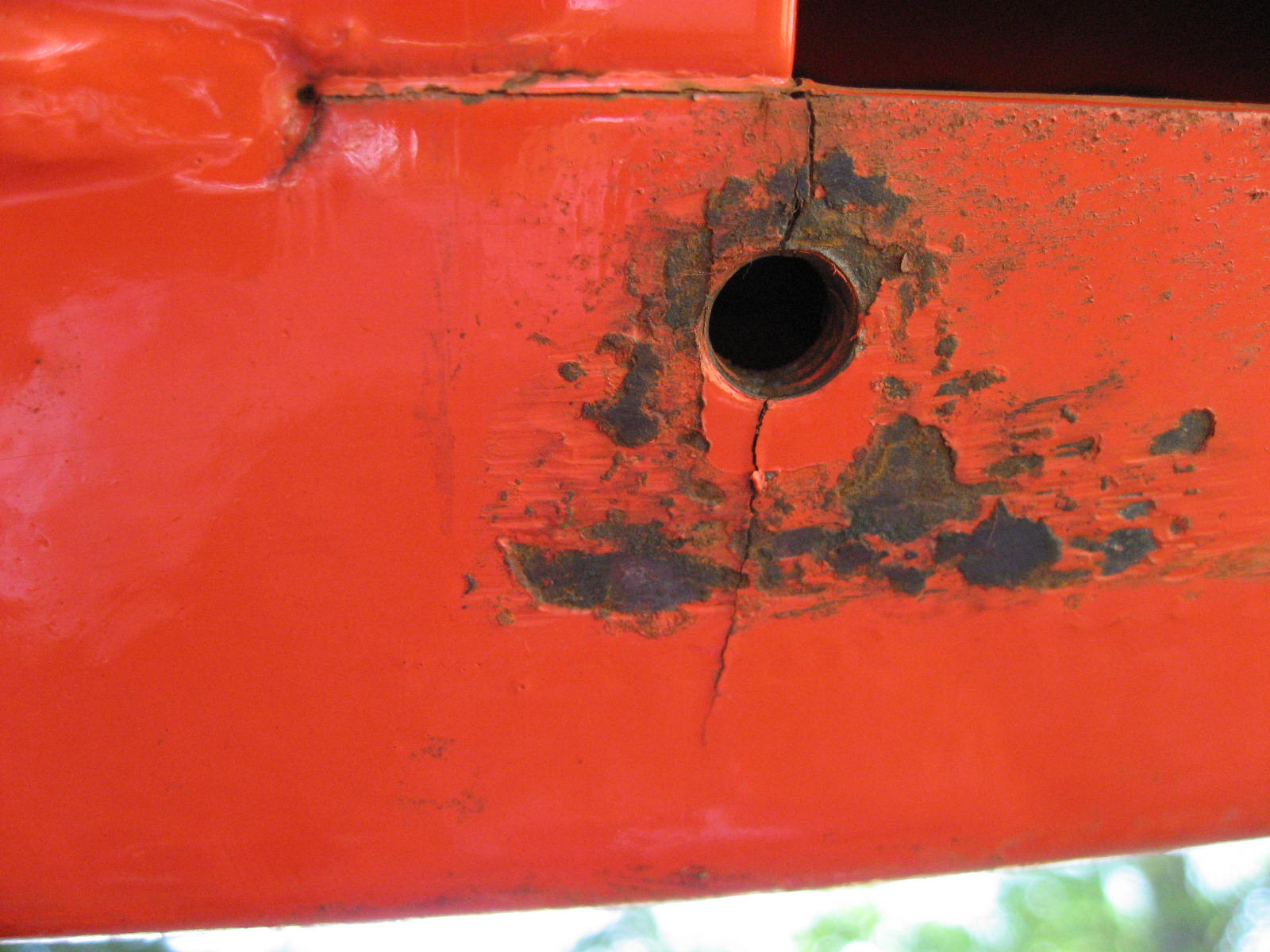

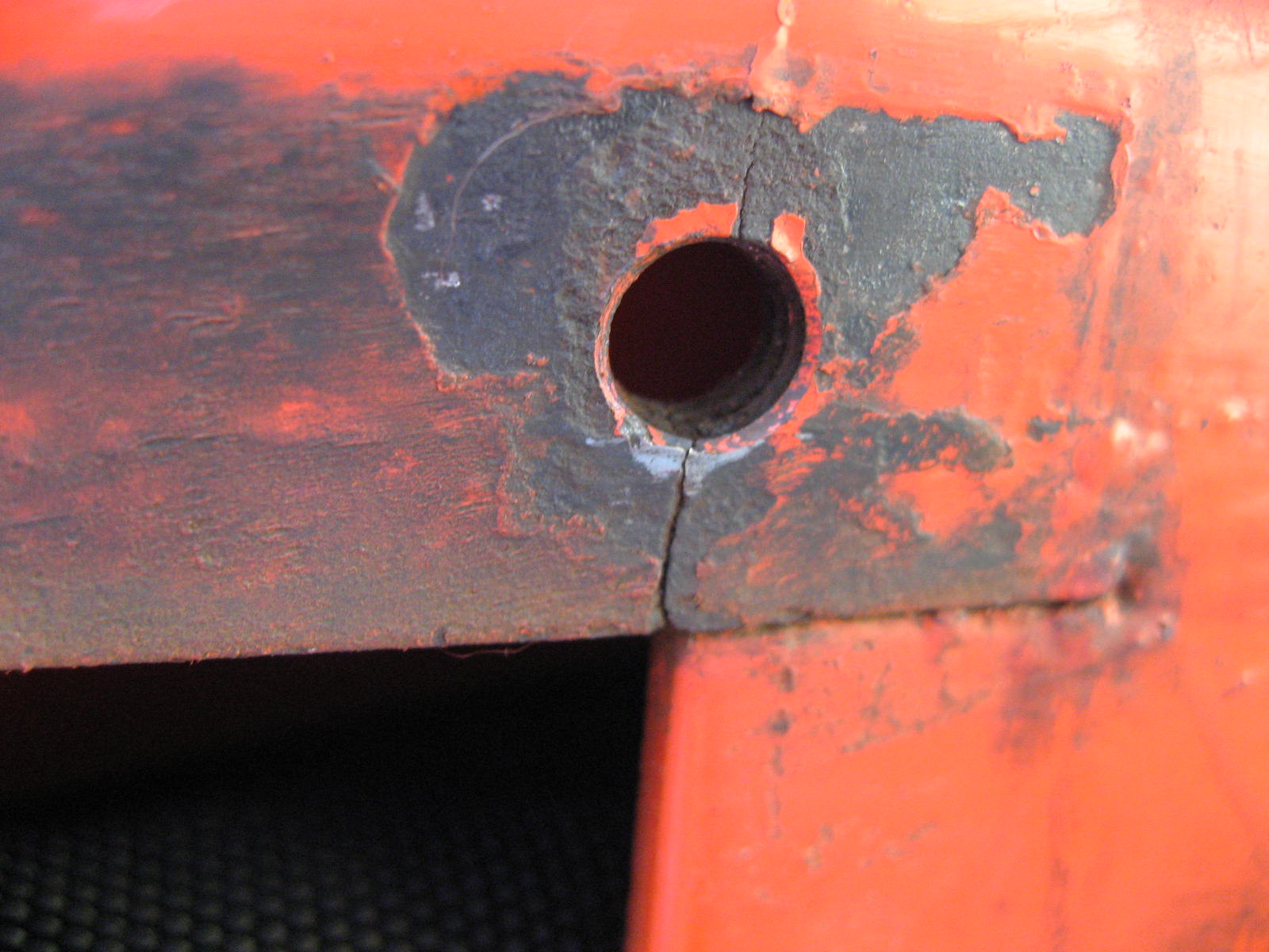

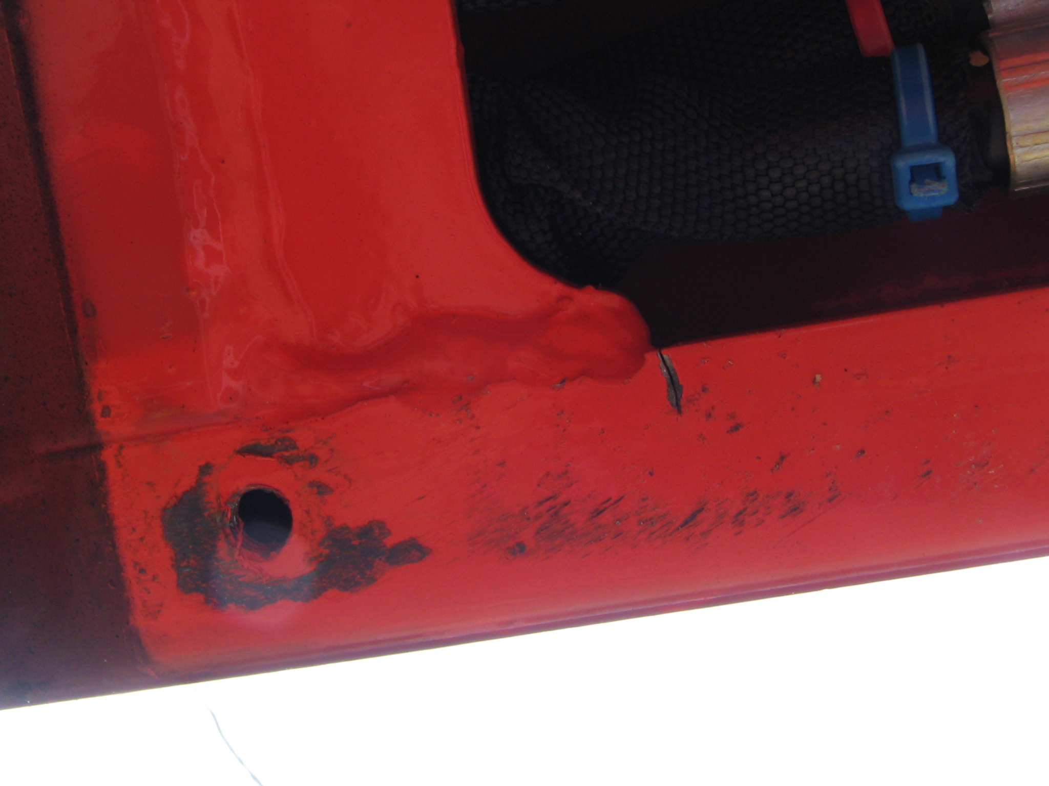

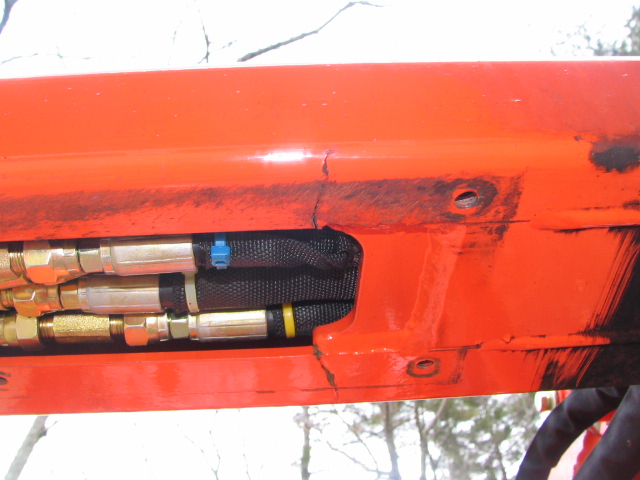

Well I hadn't checked my cracks in a while, about 2 years. The first 2 pics are from April 2006 the 2nd pics are from April 13, 2008. The pics are basically the same shot just 2 years later. I called my dealer and he asked for me to email them to him because Kioti wanted to see them too. My "cosmetic" cracks have started to grow. I know I checked them last year but only by see if they had grown past the inspection plate, and they hadn't but that was probably spring 2007. I'm interested as to what Kioti will say, as they told my dealer that they were probably just cracks is the paint. I wonder if they would be willing to place a bet on it..... say like new loader arms. I'll keep everyone posted.
By the way it is cracked at all four locations, just didn't want to post all the pics... you seen one cracked loader you've seen them all at this point.

Id sand off the paint and repaint to eliminate those paint cracks. Id be worried that they would progress into the steel.:rolleyes:
larry
