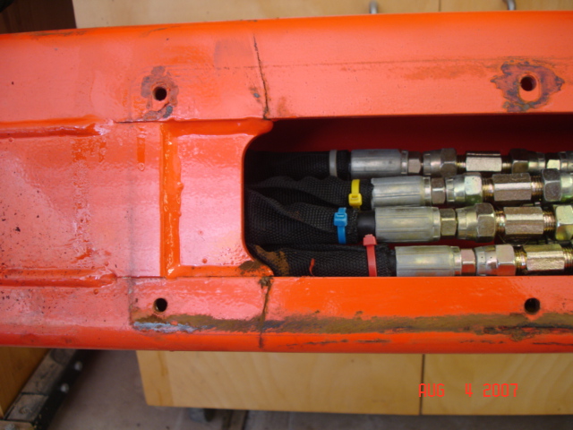

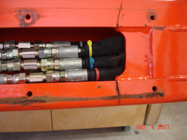

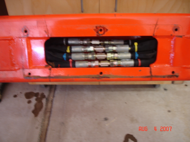

HODAK said:
Ahhh, a trip down memory lane.............. Glad to accomodate you with some pictures. These were taken as I was preparing to upgrade.
HODAK, thanks for the pictorial review! I needed it because I stopped checking back on the related threads a yr ago when they came out with a 'fix'. I think I posted on one of the earlier threads briefly altho I dont own a Kioti. I feel there is some sensitivity regarding negative review of a design by non owners, so I tried to avoid belaboring. In truth tho, seeing this go on convinces me that faulty design that affects any tractor make owner affects all tractor make owners to some extent. It does this by dragging down the 'good enuf' bar and thereby lowering expectations. We as any owners, have a right to expect that the design of our Utility device provides for its use as such - and if not, that the maker will be proactive in correcting it. The design that Kioti has used in this case is not good. As mentioned in this thread, not extending thru the arms is a mistake. Not the major one evidenced in your photos however. The problem shown there is that of an open section that undergoes torsional cycling/twisting back and forth. Thats what a loader does to it constantly. From the picture its apparent that the maker saw a weakness and reinforced the perimeter of the opening, but unfortunately not with enuf finesse. To improve their chances they should have paid close attention to round and smooth edges in both dimensions and also to optimizing the reinforcement that is offered by the cover plate - by using more and smaller bolts to clamp the mated surface [bare metal not painted] with a high strength green Loctite in the joint. For those of you without cracks wanting to improve chances, radiusing those edges around the opening will give a little insurance. The Loctite is easy too, but there are too few clamp points to realize the actual significant advantage this tactic can give. ....Once cracks start they will progress. Before covering them up with the 'fix' it would be best to stabilize them by drilling a 1/4" holejust beyond the end of each [so you get the stressed pre cracked metal] and try to radius the top and bottom edges of the holes as well.
To really fix it elegantly a redesign with round tubing must be done. The hoses have to stay outside. I gather thats what theyre doing on the new model? Mission accomplished. Unfortunately not retroactively.:(

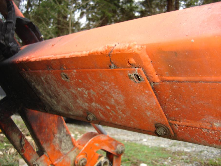

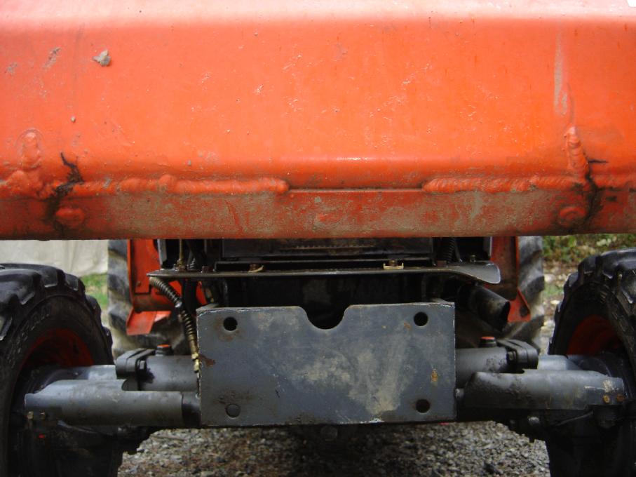

Holy crap! I was cleaning this thing up to sell it and guess what I found!
241 hours.
Cracked
Calling Jon Depratt in the morning! Already been talking to him about a dk40se hst.. But not if kioti doesn't fix this. I'm sure they will.. The cracks don't exactly improve my resell value!
/ FEL repair kit #80
Sorry to hear you've joined the crack club.
