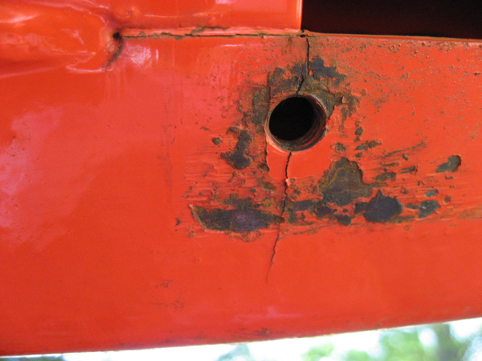

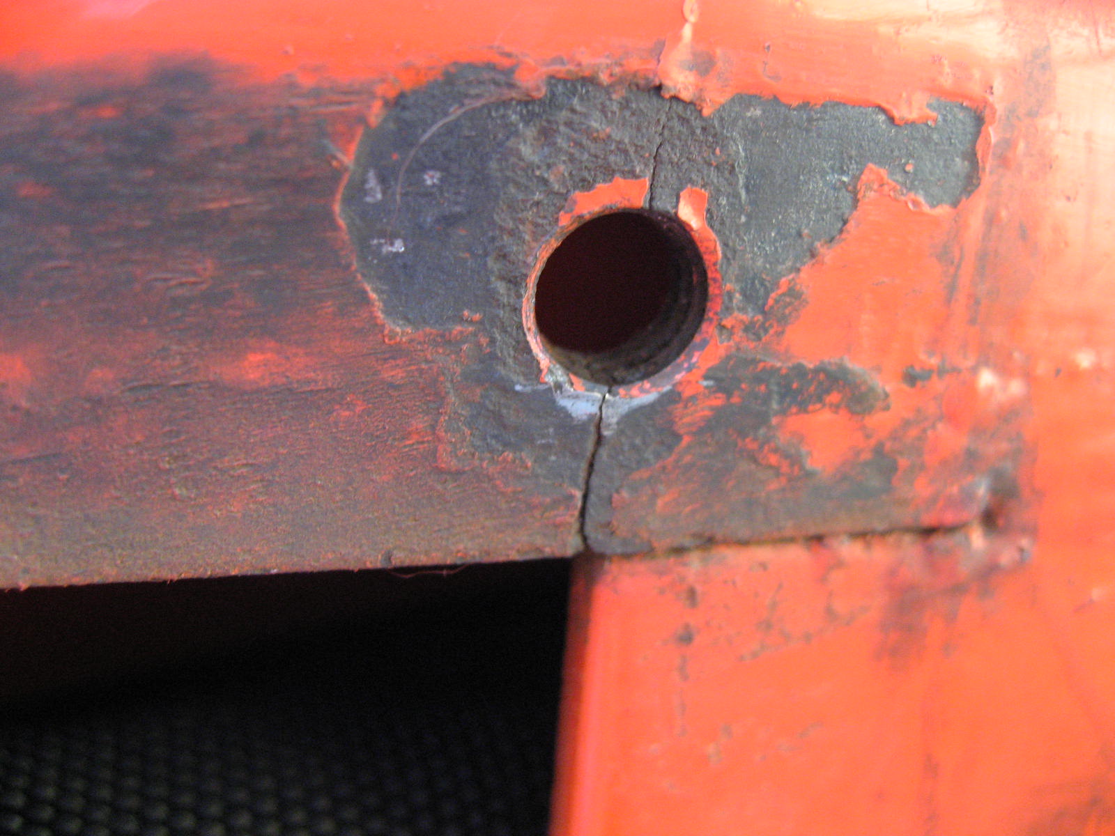

Pardon my ignorance, but just where do the cracks appear? On the weld joints? In the plate itself?
With apologies to Kentrodngun, I will just add that the cracks appear in different places on the KL130 and KL120. You saw the photos from Hodak's KL130...here are a few photos of the KL120. KL120 cracks tend to appear in the corners and typically go through the bolt holes as there is no welded plate insert as with the KL130.
For what it's worth, I agree with Kentrodngun's frustration but this topic will clearly not go away until Kioti resolves the issue. The continued bantering has much more to do with Kioti's lack of communication on the subject than anything else. It is an issue that affects a substantial number of TBN members so boring as it may be it is more relevant than "which hydraulic oil" should I use etc.

MY former dealer gave me a kit, the kit for the 120's when I have a 130. I returned it and now they are no longer a Kioti dealer(Harvard Power).
My cracks are now at the edges and I'm watching closely to see if they start up the sides.
I'm at 250 hours. The loader is used for spreading loam and mulch mostly.
Has anyone seen them up the sides?

3) Had four 1" long cracks at bolt holes
4) Dealer installed kit 50 hrs ago - cracks have not grown since and I still have a higher lift capacity than your 20hp tractor. :D

I happen to own the KL130 arms and the KL130B arms. Cracks developed on the KL130's at approximately 130 hours. Bought new (KL130B's) and installed myself. Presently at 296 hours. Rick and Amy assisted me when I made this choice. Again, my choice and I am a satisfied with my decision.
In my opinion, dealers are stuck in the middle and should truly be disappointed with the way KIOTI handled this issue. I'm hanging on to the old arms for a while longer just in case there would be a new development...... It sure is nice to hop on the tractor and not think about the cracks extending.
