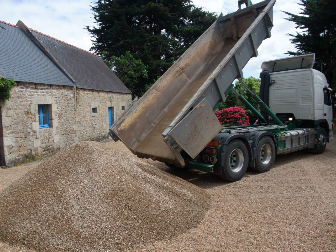

Watched a dump truck up the road as he backed in to a slightly off-level area. The side to side angle was very slight,...but I couldn't believe he was going to dump on that angle. Up went the box,...then,...Oooh Ouch! Over she goes!
Made me think how often I've started raising my tractor bucket and realized the slight grade, (side to side) could easily tip me over! Level 'er up a bit!
Just thought it worth a reminder that a loaded bucket can change the centre of gravity drastically as it gains altitude!!! Of course even an "empty" bucket in a raised position while driving off level or turning, can easily cause a roll over. One more tip,.. backing up with bucket raised, then turning and braking will roll you over quickly!! (Ever realize how often we do it without thinking?)
Think safety!
