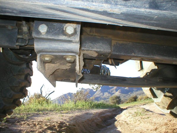

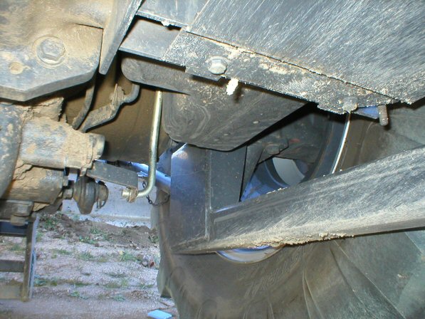

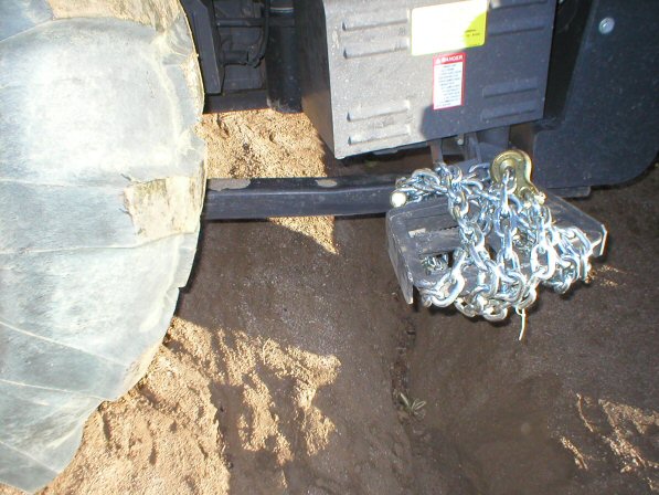

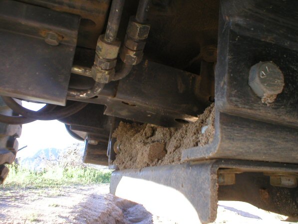

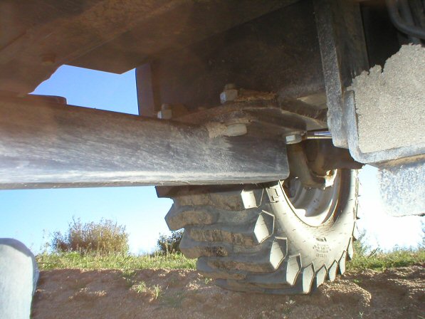

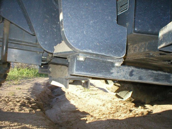

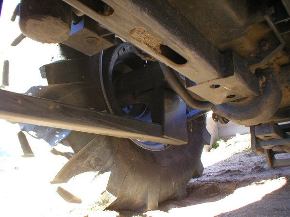

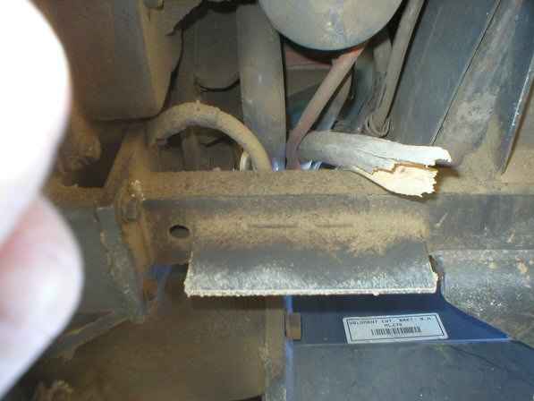

Here are a bunch of pics that I took of the underside. Found a 7/8"-1" stick shoved up from the bottom all the way up by the sheet metal for the cowl.:eek: Does not appear to have caused any damage.
The sub frame is made from 2 1/2" square tubing and each tube has a factory bend in it. My cross brace is bent and the drive shaft cover above it is bent up about 3/4". (maybe .090 thick, but I doubt it) And I saw that somewhere apparently I was deep enough in mud that my filters got drug through the muck.:eek:
All the more reason to get my skid plate made.:eek:

Thanks for the great pics Brian! Im on it with my dealer and tech rep. It is weird how difficult it is being to get complete delivery on my tractor after 2yrs of trying. The list just grows. Even tho they seem to pay attention the list just grows. I guess Im just going to have to notch up my prompts.
For you, I have an idea for a quick, low effort, high satisfaction project. Invert that c channel to above the brackets. Looks like it will fit just like mine with about 1/4" notched out of the flange ends. You can do this while youre restin laying down. Youll be glad you did.:)

After seeing all the dirt that the cross member drags up, that inversion will get done here shortly.;)
