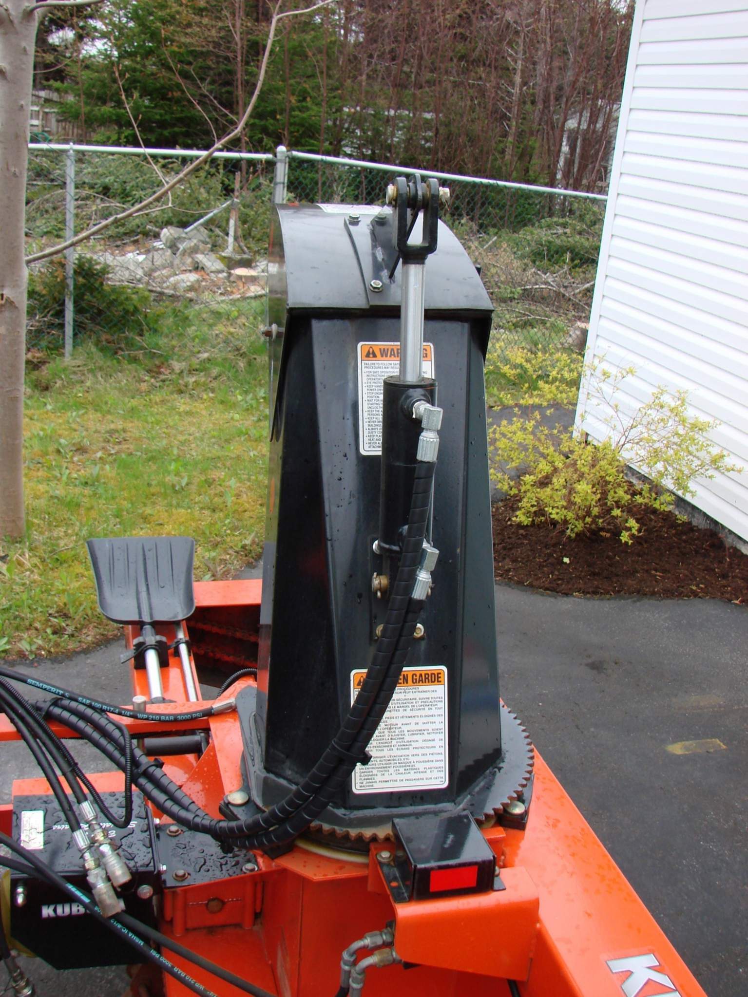

/ FEL mounted plows? #31
I had this kind of setup and found it to be too long overall. So I built a sub-frame and mounted the plow to the tractor and used the loader valave for the control.
Regards,
Chris
