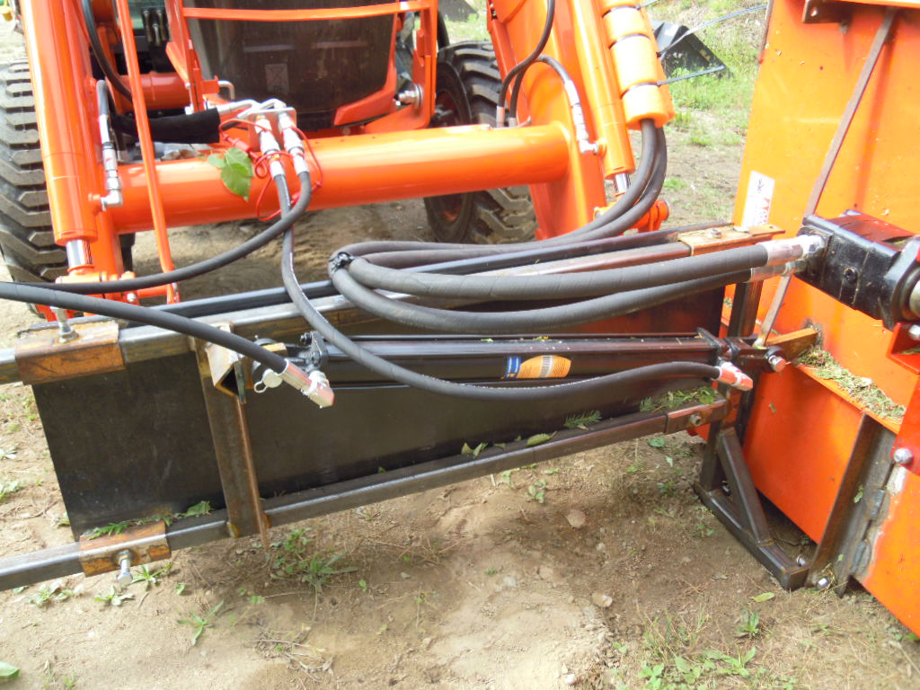

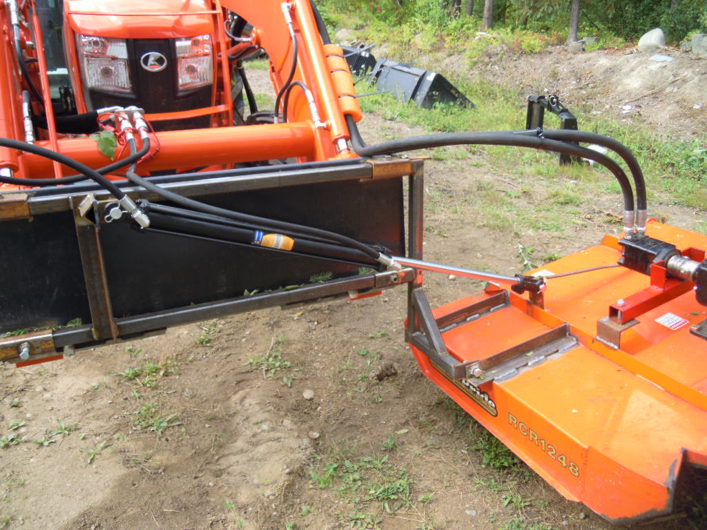

Here are a couple of pics of the hydraulic cylinder setup.
You are right about the rails to move the mower further out and the intention is to get it away from the cab more, when the mower is used in a vertical position. That would be useful when trimming branches along the fence line and keep flying branches away from the cab. I got the idea from the Limb Ninja.

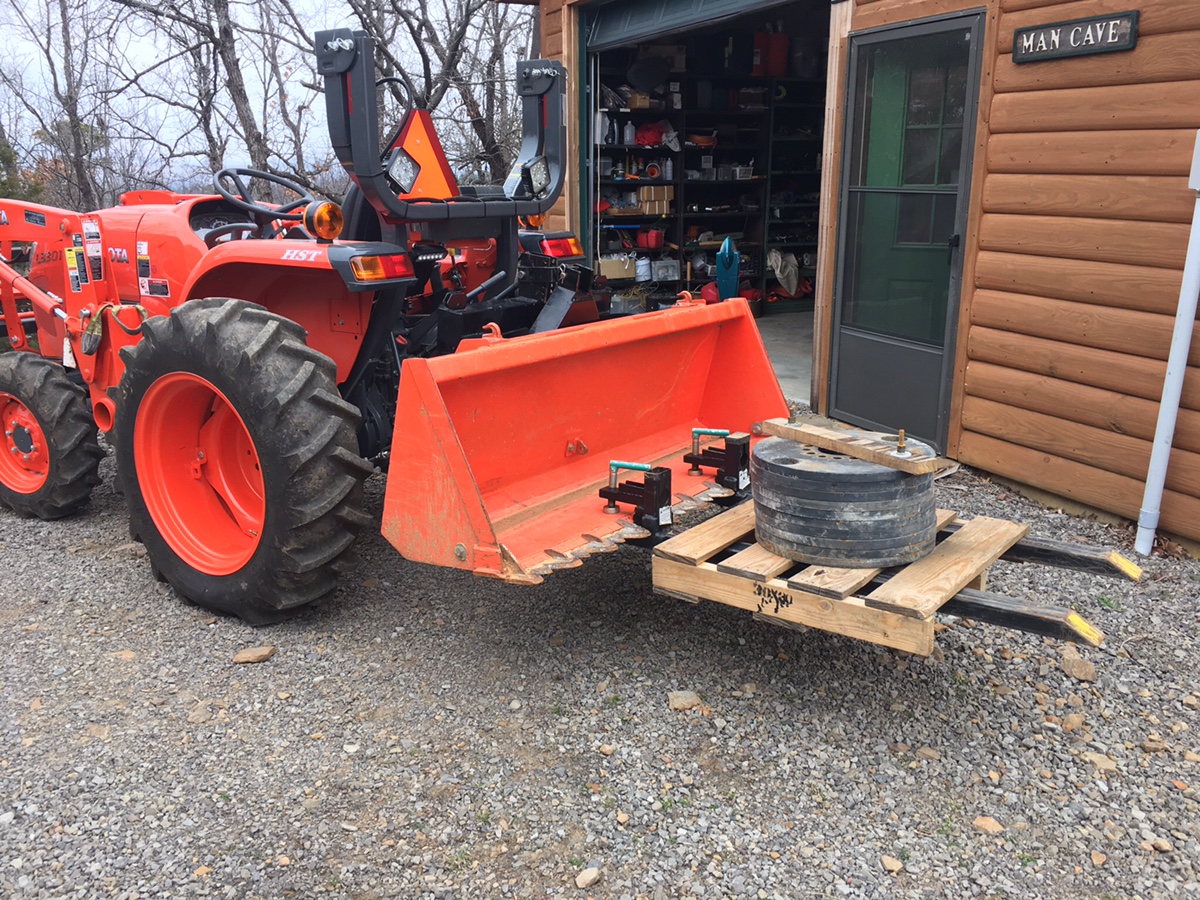

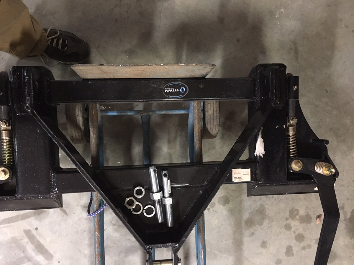

With this from Titan, (I did have to modify mine for quick hitch), you could use it on the rear.

Yeah, it looks like the horiz tubes are much like the Ninja. Just mumbling to myself now with the new pictures (good pics to show the angle adjuster) -- that single vertical tube may tend to get bent if you hit stuff with the cutter. I feel a brace coming on.
Me too. Great ingenuity but hitting something unseen is going to bend things. Fantastic work :thumbsup:
View attachment 618457View attachment 618456View attachment 618455
Great idea. I already have a 6' 3PTH brush mower, so no need to mount this one on the back. Plus I cut off all the 3PTH stuff to make this lighter. It's odd that I went the opposite route and made an adapter to mount my 3PTH stuff on the front of the tractor.
After my first runs with this thing and having the tubes pushed out from the framework by about 18", I could see the flex in the tubes and initially thought I was going to have to remove them and go with a beefier system. However after a little thought I decided this might be a good thing because if/when I hit something solid the tubes will get bent and not something more expensive to repair, like the FEL. Replacing the tubes will be relatively easy and cheap. Time will tell if this is an issue but for now I will use it as is. The only thing I am struggling with is the snappy movement when the mower is in the horizontal position and the hydraulic cylinder is use to lift it. The initial movement is too snappy for my liking. I can see that it's due to the geometry of the cylinder and mower deck pivot locations. I tried to use flow control valves to slow things down but the ones I bought didn't do anything and I will be taking those back.
