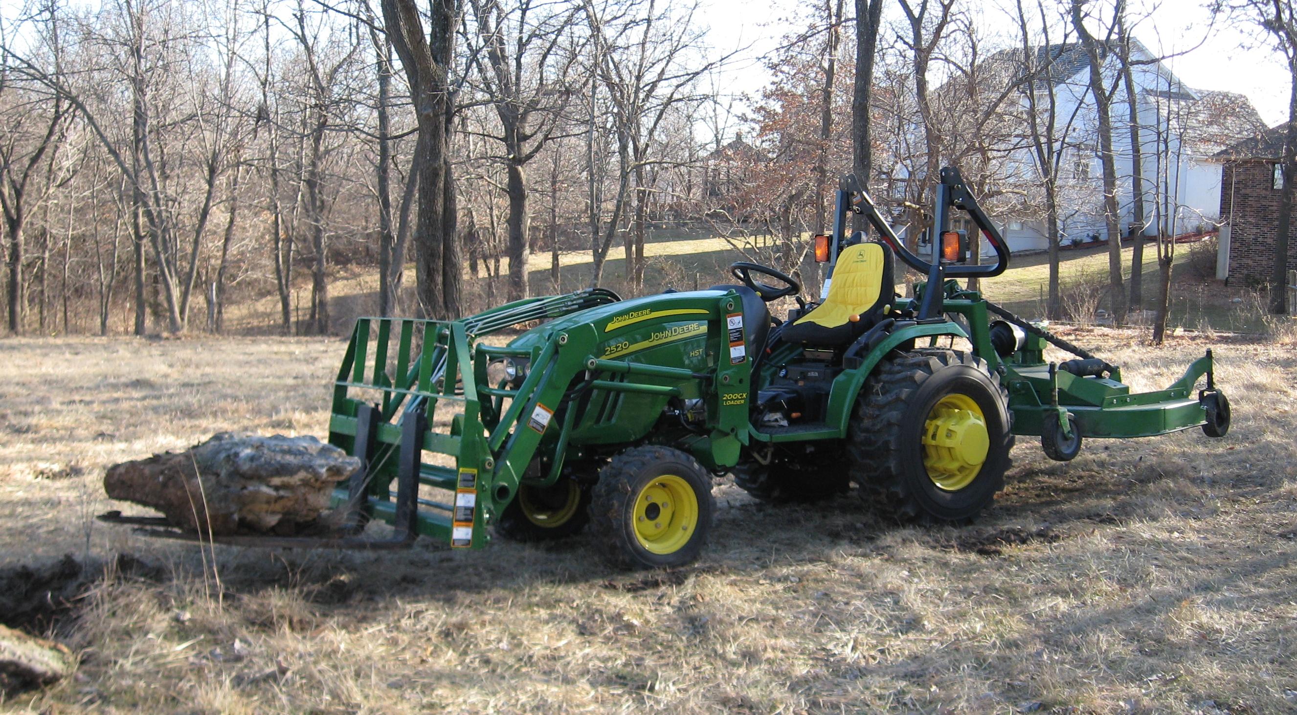

I like having the brush hog attached while using the loader. It has weight low and far back and it offloads the front end nicely. The only drawback is in tight places turning around. And 4wd is nice for braking. I have uneven ground and I have to be extra careful using any weight on the loader. Once you lift a rear tire it scares you to death.

My tractor is rear wheel drive with front wheel assist and I load the rear to keep it that way, not front wheel drive with big old rear wheels to help the little ones. Those big old rear wheels sure well push alot.

Pat, I believe that my JD 2305 is adequately ballasted, I have the rear tires loaded with rim-guard, and I always have either the backhoe or the weight box on. The dealer that I bought the tractor from does not sell a tractor with a fel without including a weight box. My weight is filled with concrete and weighs about 800 lbs. I also have carried something very heavy on the pallet forks and had to go down a small hill to get to the basement garage to my shop. When I do that, with something very heavy I go down the hill backwards and that feels much safer. With the loaded tires and the weight box, I cannot lift the rear tires, the fel does not have the capacity to do that and my guess is that that is what Deere has in mind with their guidelines for proper ballasting which I meet.
