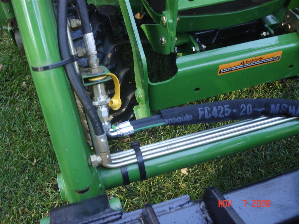

/ FEL connection hoses- marking them? #4
Matched-color dust covers on both M/F sides of the quick-connects is a handy and easy way to always get your connections right.
That is the way most of mine are...and I also use different colored cable ties also for identification.
