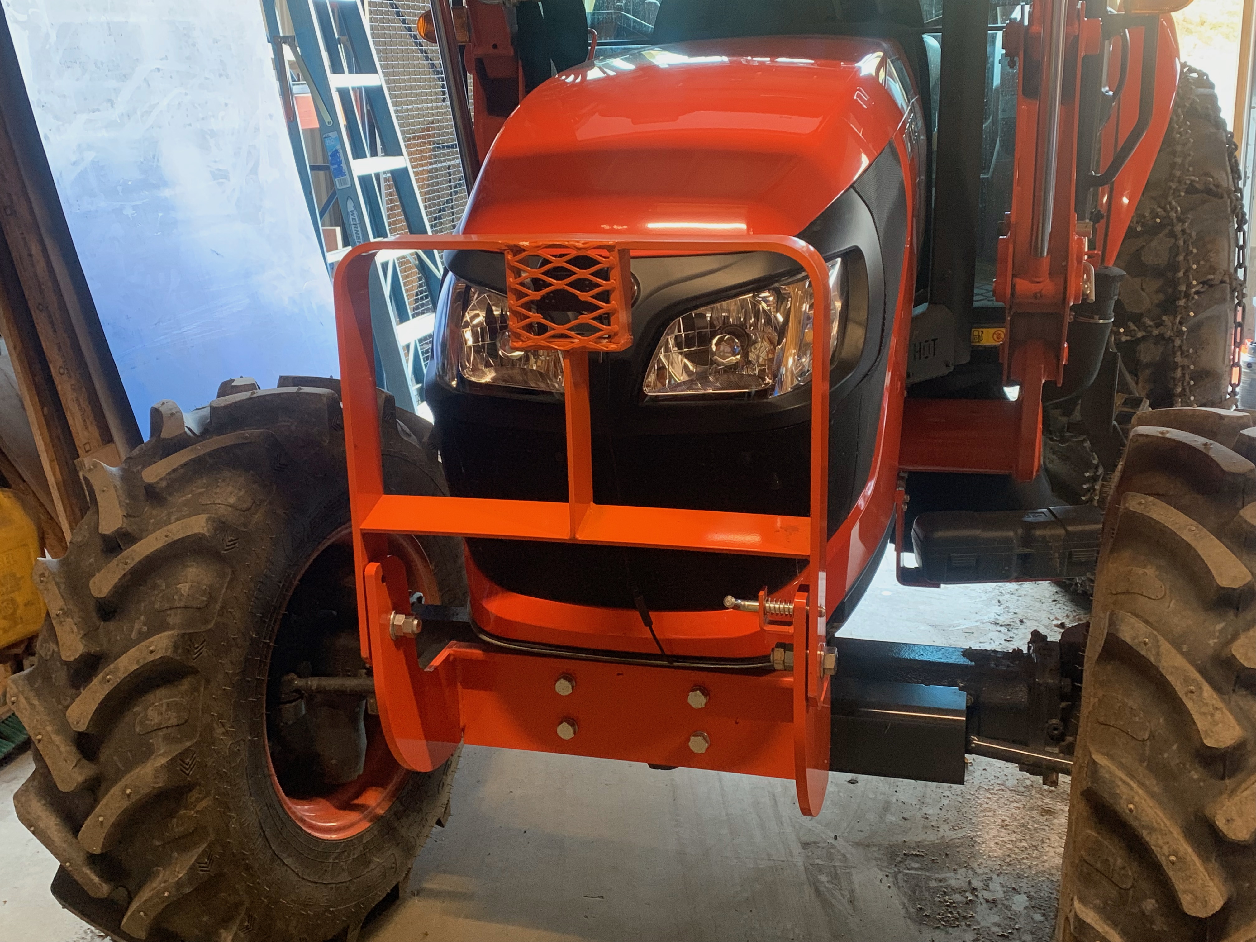

I did not mount mine on my FEL. It is mounted in the brush guard and worked well for hookups and decent with the forks.
Mike
