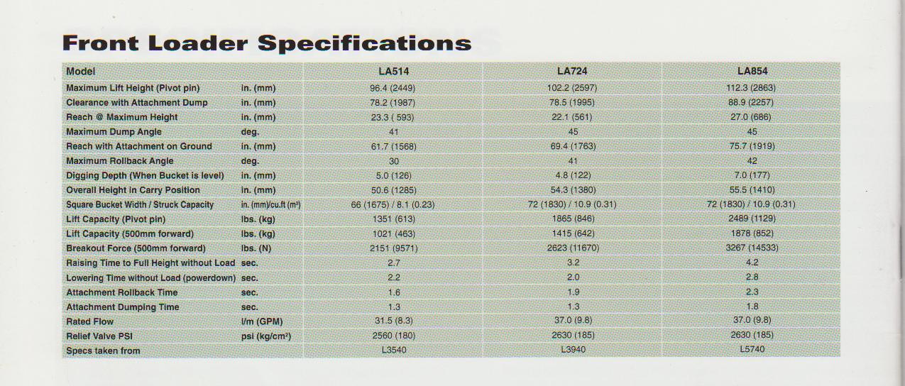

The loader spec. sheet says that the lift cap. @500mm forward and max hight is 1415 lbs. At the pivot pins an 1500mm ht it goes up to 2324 lbs.
I would like to check the Hyd relief setting. Can I do this by plugging a pressure gauge into my rear remote, or do I need to connect to the loader valve?
This is from the Kubota 3240 brochure.
Just noticed this; In the brochure it says that the specs. were taken from a L3540 @ 2560psi, and a L3940 @ 2630psi. When I look in my OM, system pressure is the same for these three models and listed as 2567 lbs for L3240, L3940 and L4240. I don't get it???
JJ I'm not sure what you want me to see in the spec. Please explain.:newhere:
Bill
I think the main reason they are telling you what tractor the specs are taken form in because of the lift height, the bigger tractors will lift higher.
/ FEL bypassing
#16
I get that, it's the pressure difference that seems weird. The brochure lists different pressure for the different models. According to the OM they should be 2567 lbs.
