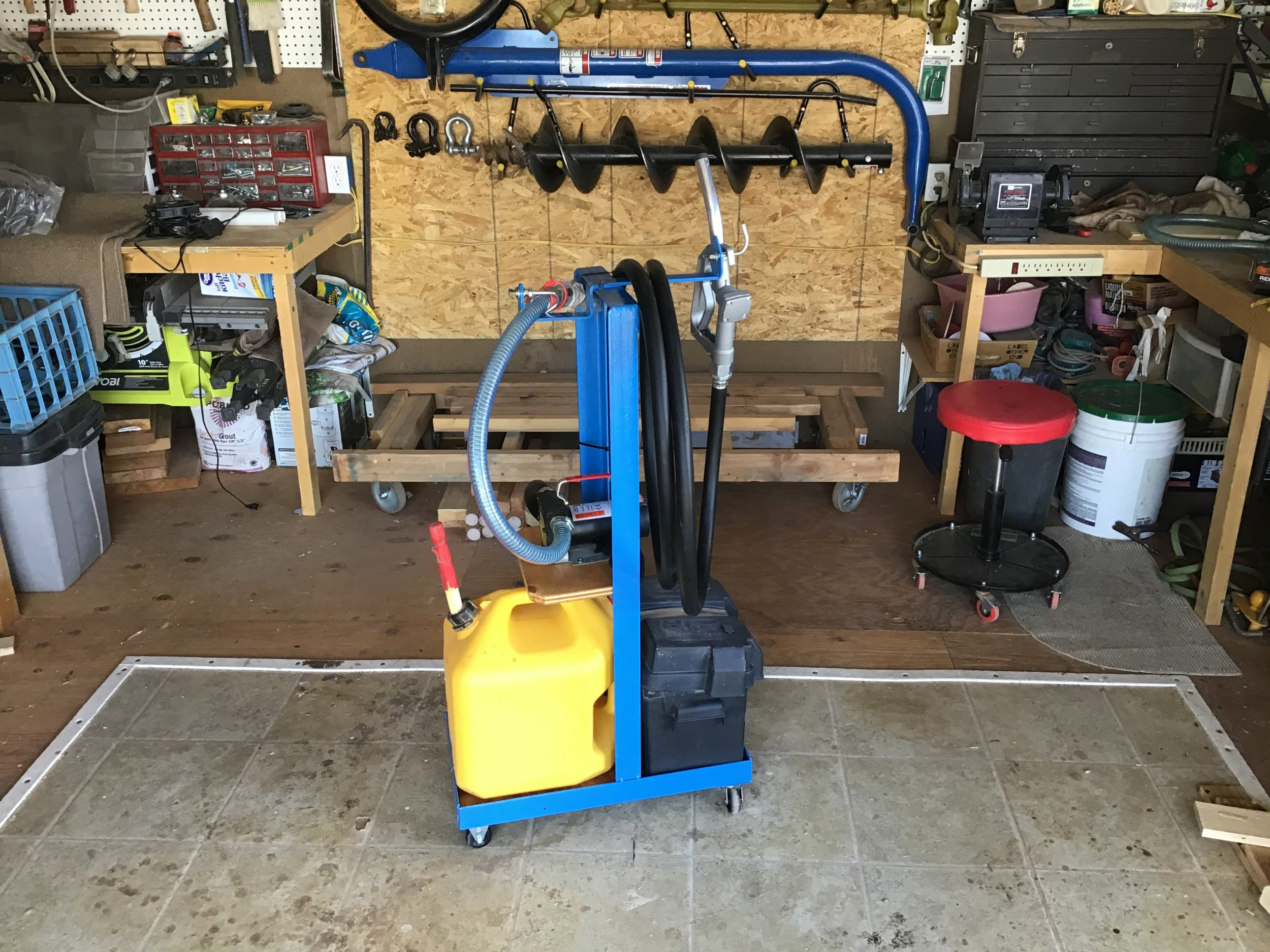

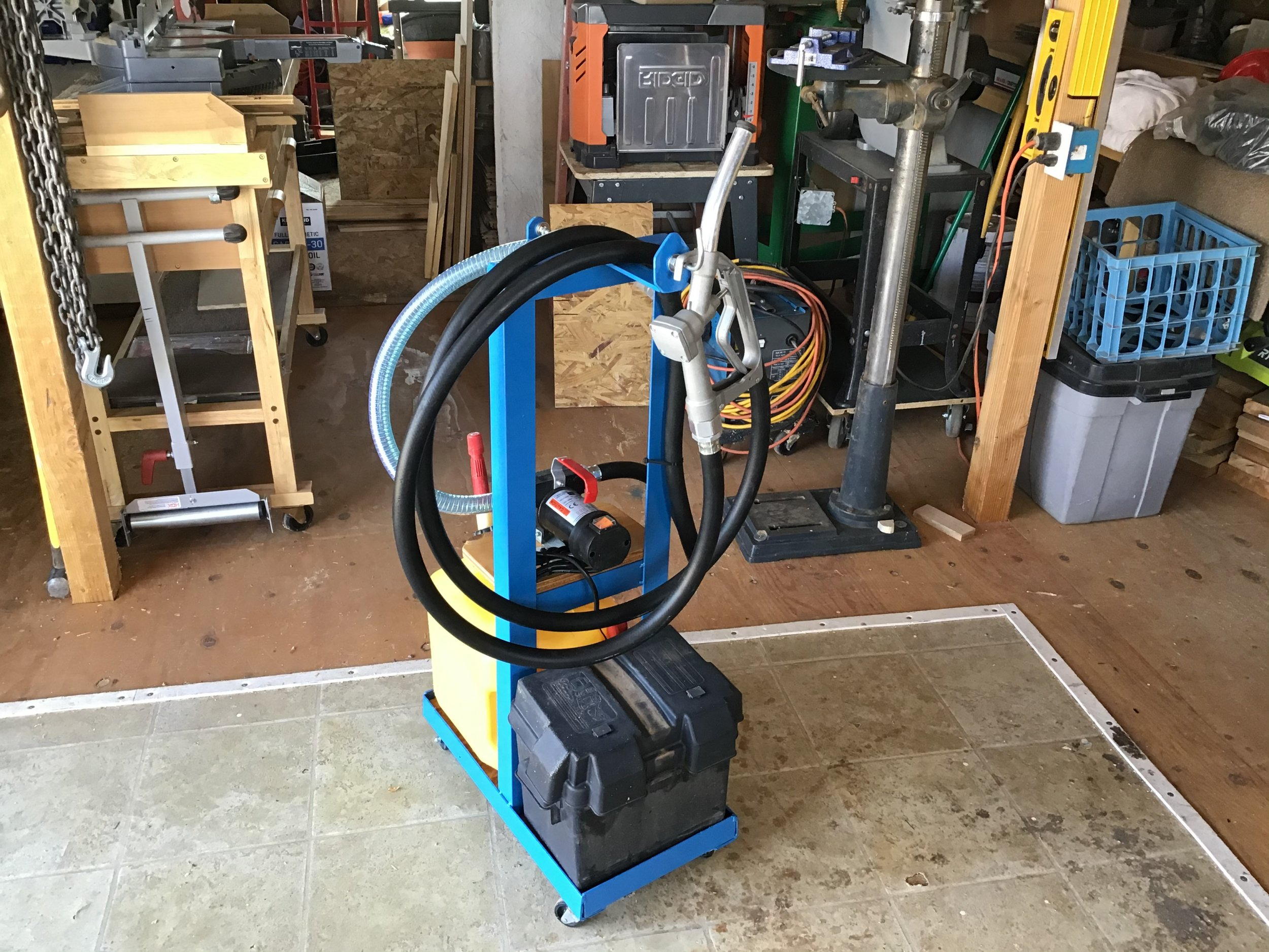

Just curious how you guys refuel your tractors. Do to several shoulder injuries I can no longer hold up a 5 gal can to fill mine.
Diesel I assume. I bought a small 12 v transfer pump. Not a good idea for a gas engine though,

I use an IBC tote (275 gal) with a 12v pump that uses a small gell pack (like you find in an emergency light) that is charged by a small solar cell. All in, the entire system including IBC, pump, fittings, filter, solar panel, etc ~$350 - pump w/hoses & nozzle was $275 on sale. The IBC fits nicely in the back of my pickup. Best part, IBC's around here run $25-40 a piece. Filled it up before all the craziness in fuel prices, added biocide treatment and this "should" last me through the summer/fall.
