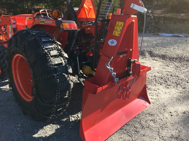

Just used my Farmi 501 today for the first time. I'm hoping someone has some tips or tricks (and pics) for how they store and manage the two ropes (clutch and brake), so they are not tangled somewhere you don't want them and they are easily accessible. I realize this is only the first time using it, but someone here must have rigged something up pretty simple so the ropes are always accessible and yet out of the way.
I have a Kubota L4701 (no cab) and the winch also has that safety grate (which could also lend itself to some type of contraption for rigging or holding the ropes).

I attached the metal snap lead ( like on a dog leash ) to the rope and just clip it to my screen when not in use.

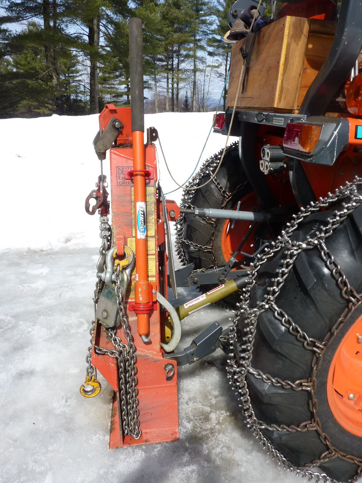

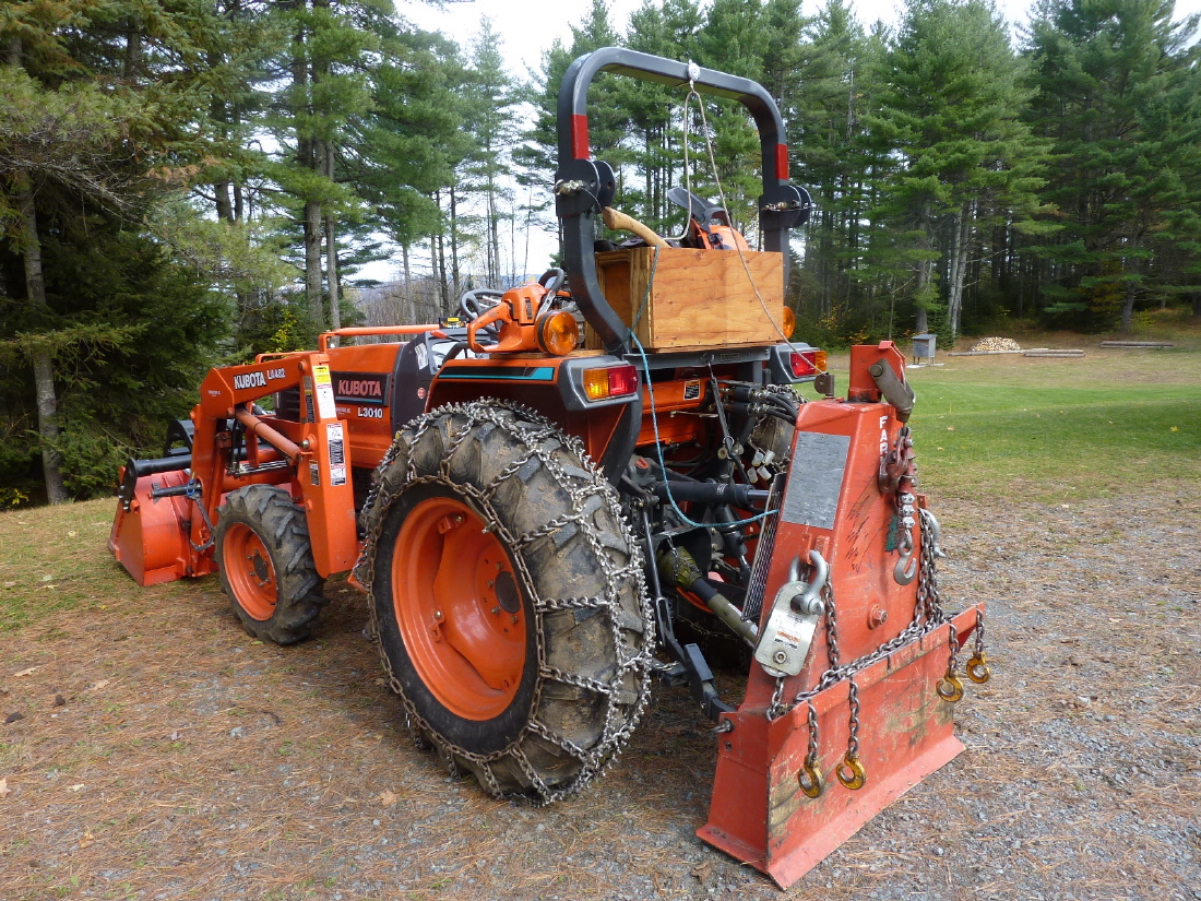

I had the same issue, Especially with the clutch control rope. I put a key/tool retractor on the rops and ran the control rope thru the ring. Works great. These are pretty old pictures took a while to find them.
The brake rope I just take a turn around the rops leaving a little slack and put the end in my saw box
Peavey bracket is another helpful thing
EDIT: BTW congrats on the new winch !!!!!!

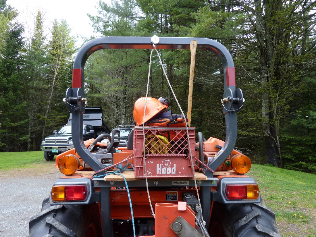

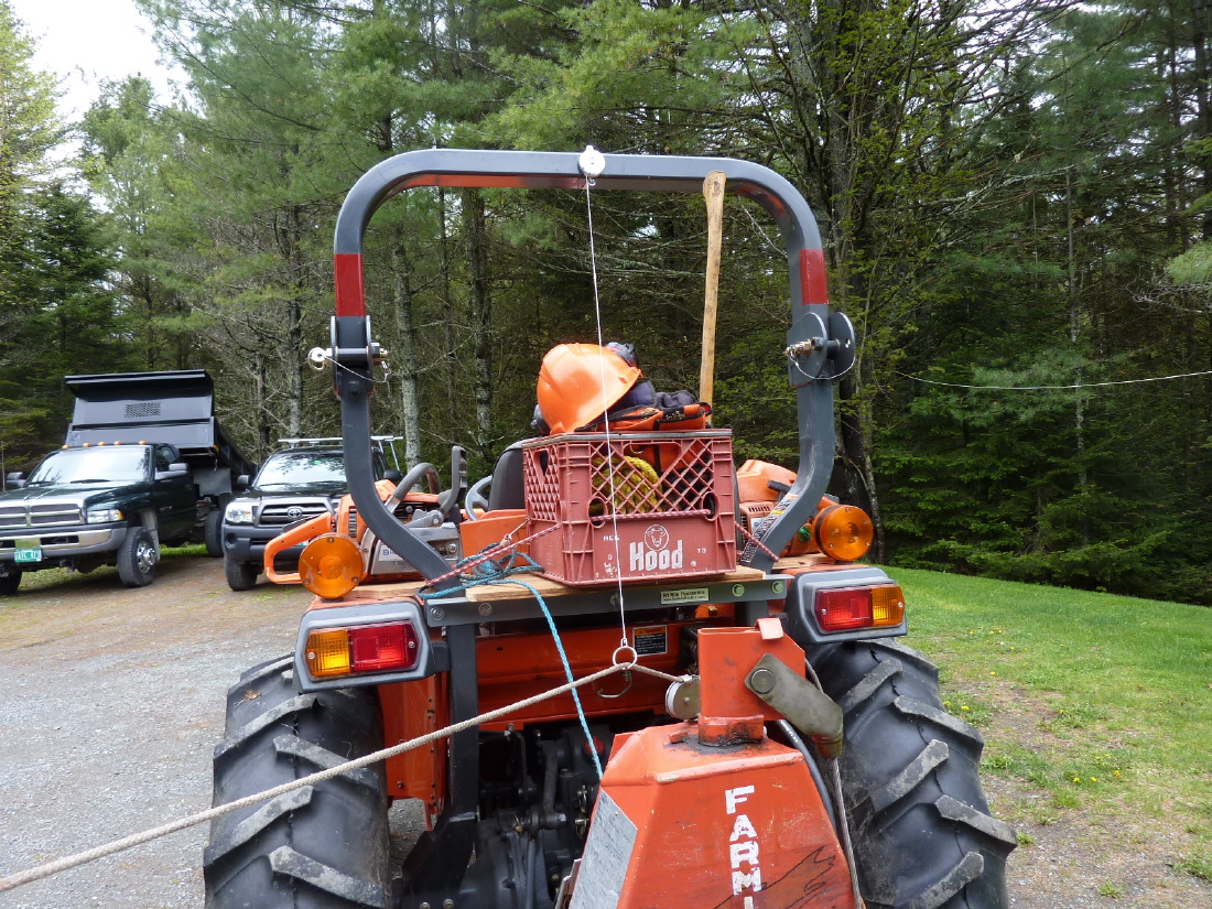

Figured an update was warranted. I rigged up a simple pulley system and put pull handles on each of the ropes. Can't tell you all the tangled rope hassles that have been eliminated.
