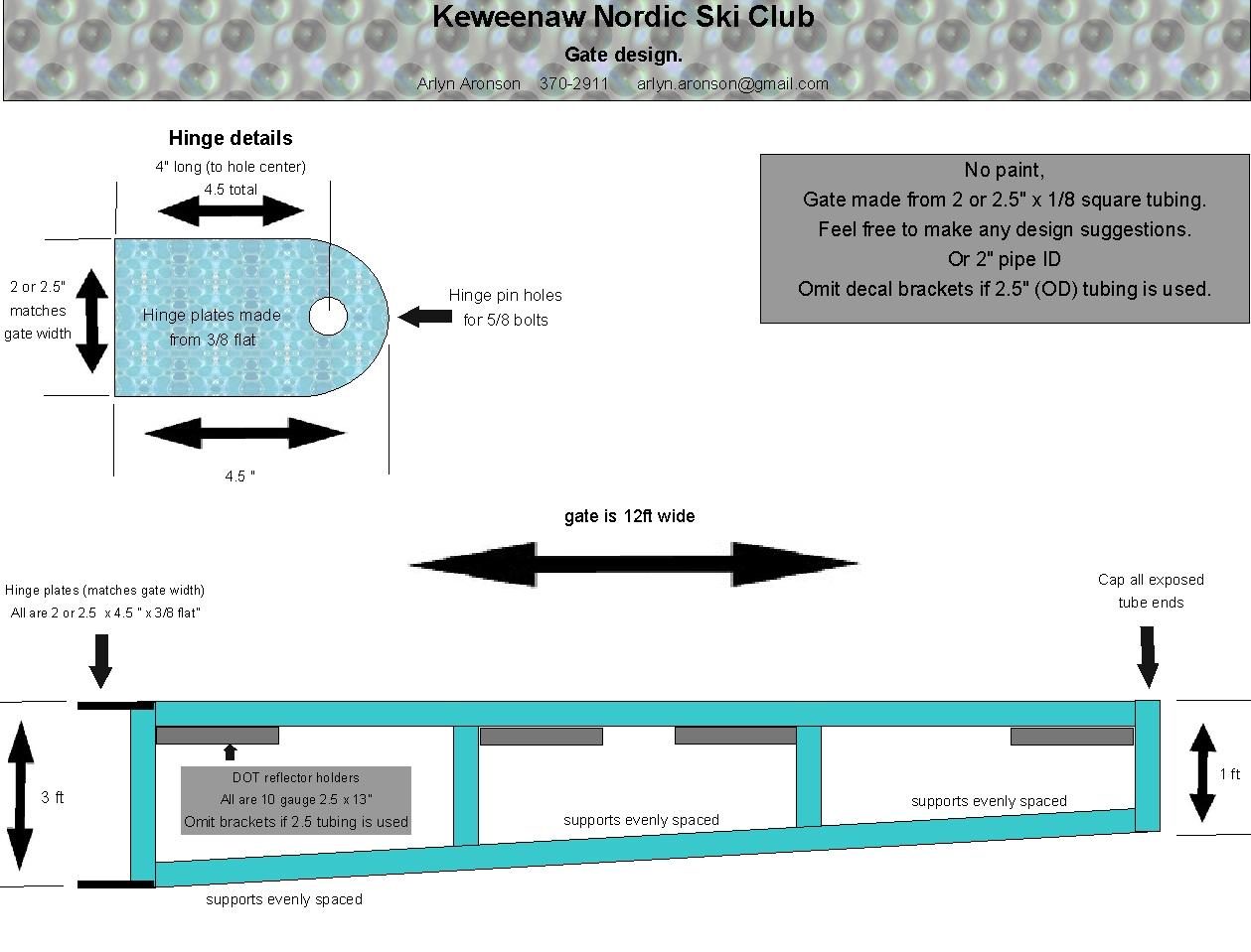

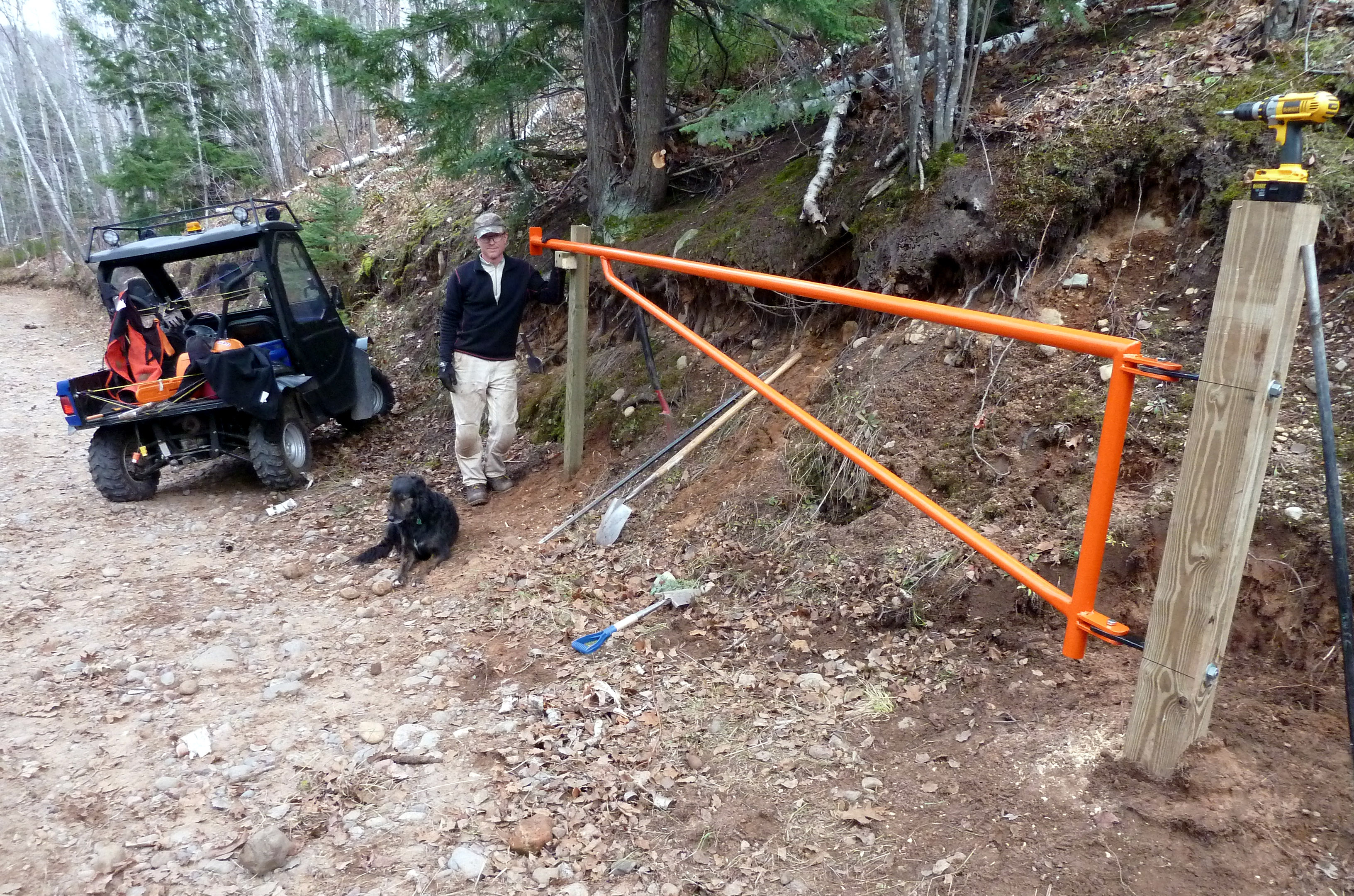

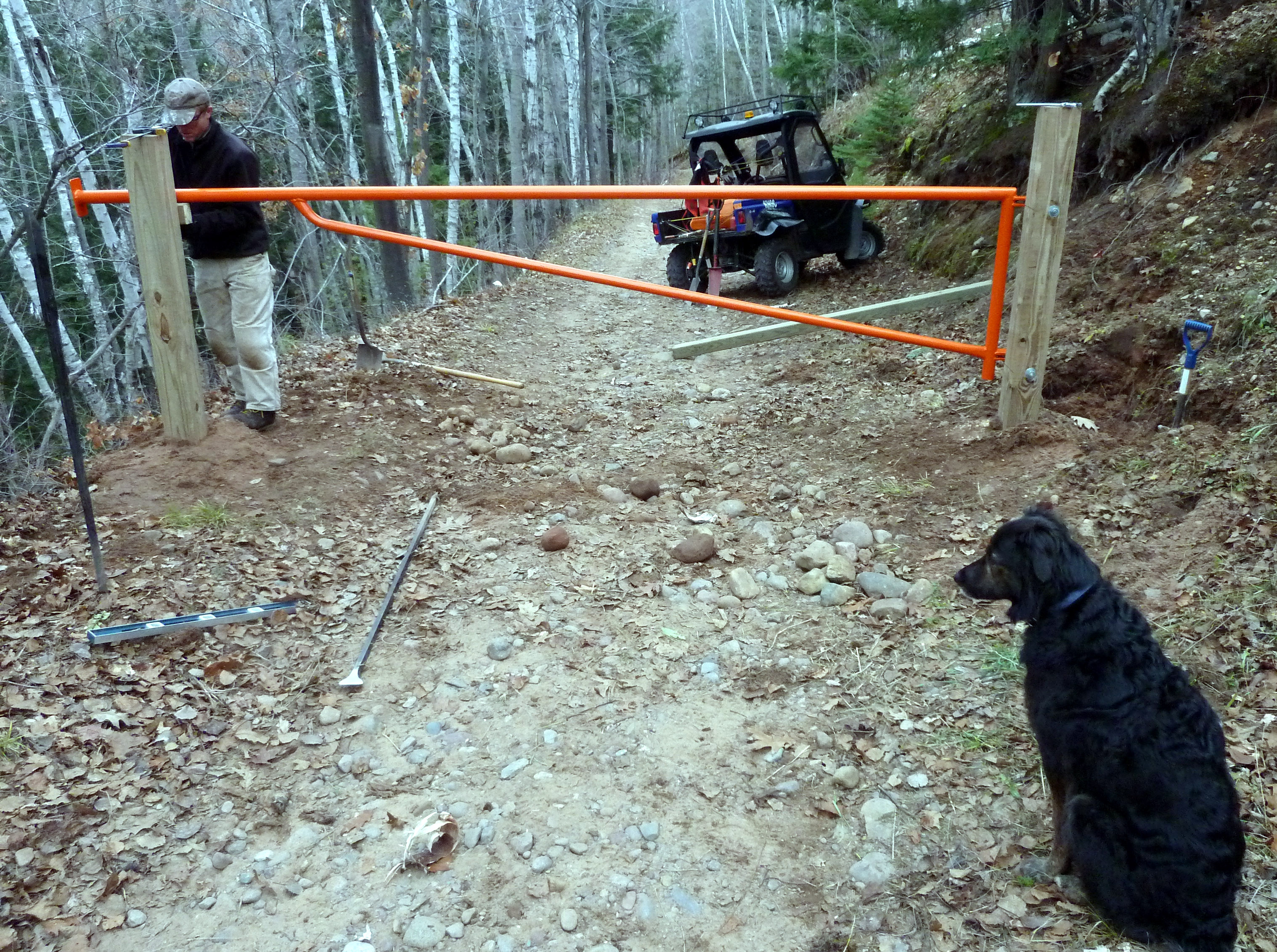

Here's some the we have in use. The locks are covered to help keep rain out of them and freezing. The print is some we're about to have built for us.
