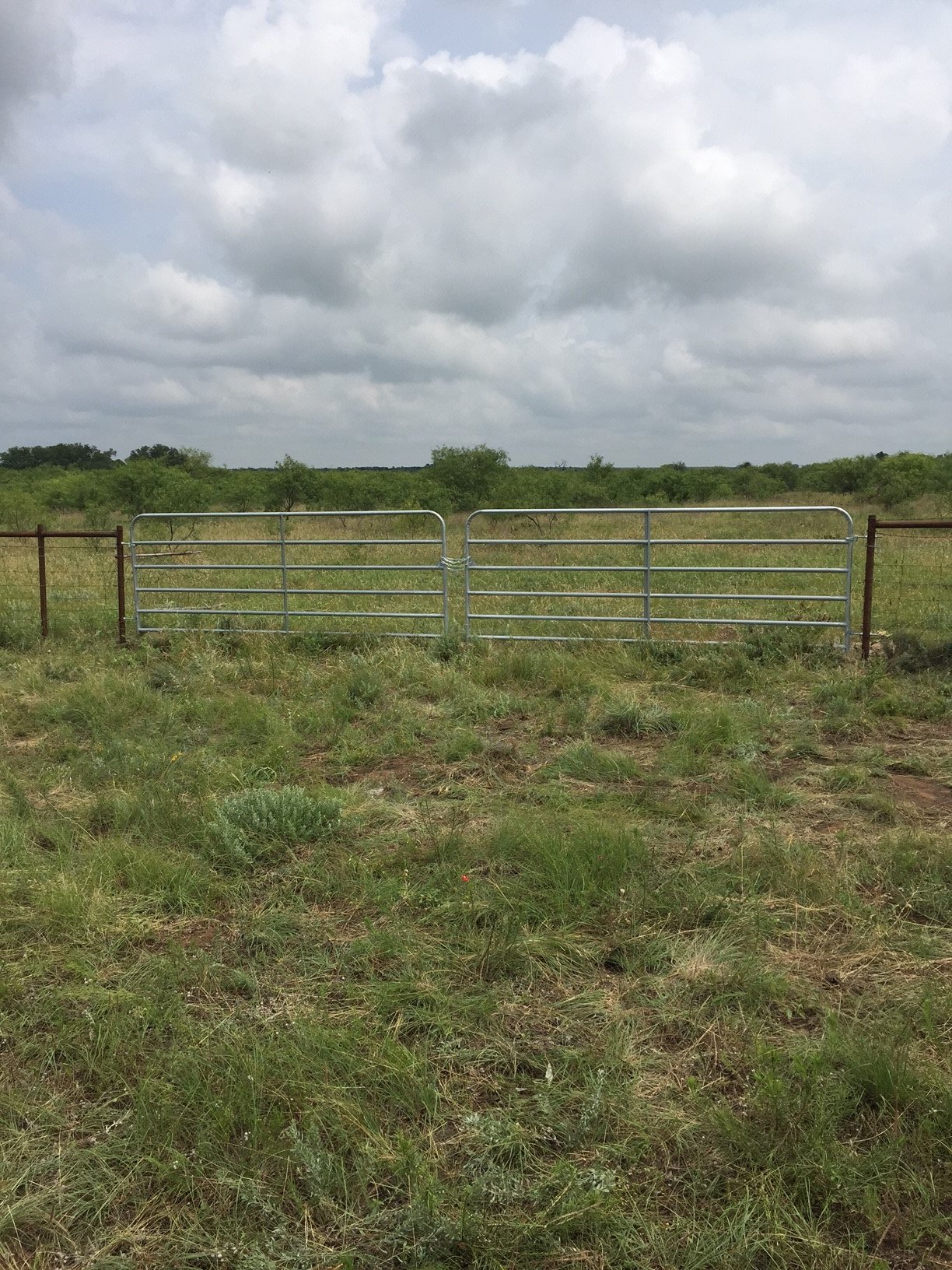

2 pipe gates required for a couple openings here on the farm
a vertical pipe at the fence post
a top horizontal pipe across the top (to reach to center and then some)
and then an "angle bracket" pipe to form a triangle
i have wood fence posts gates attach to. so when putting in the hangers for the pipe. i slightly off set them. so one gate always swings open, and the other one always swings closed.
on the one that always swings closed, i got some extra chain and tossed a hook on it. so when opening up i can just toss hook over some fence wire to hook it open.
having both gates always swing open, is big pain in rear, trying to close them.
having both gates always swing closed, seems like extra steps to both latch them open, and then extra steps to unlatch them to close them.
if you need any sort of "no trespassing sign" on the gates. you are better off taking pipe clamps and say a 2x8 or like. and fastening it to the pipe gate, and then attaching sign to the 2x8. you need lumber, any sort of metal sign trying to fasten it with wire, will more than likely blow away in wind.
for locking the 2 pipes together, i have chain attached right were the angle brace pipe comes up to the horizontal pipe. and then just wrap the chain around pipe a couple times, till both pipes gates come together then wrap both gates together 1 to 3 times with chain with a lock.
the pipes are about 6' person hips in height., they are not level in anyway. and were the 2 gates come together they almost form X, errr better yet ><
they are low enough to keep atv/utv out, and just high enough, you really do not want to try and hick leg over them, and require someone to get on knees to get under them.
for extra, i have wired each pipe gate at the fence post were they hinge. so no one can come over and physically pick the gates up off the hinges. have seen folks just toss a chain around and a paddle lock for same doing vs wiring them in with a few strands of wire.
when dealing with snow / mud / regrading road. i love the pipe gates. extremely light weight and easy to operate.

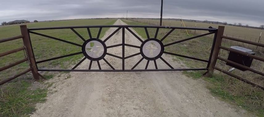

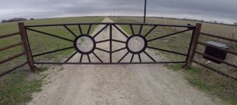

Here is the gate and entry I built for my place. I have an Apollo automatic opener which is pretty much what everyone around here uses. They are hard to force open unless a person knows what couple of bolts to take off.
/ Farm/property gate #4
Nice gate Joe! And howdy neighbor! For the time being, I only have the galv pipes up... (2) 12 footers. Once the driveway is in, I intend to build some ornate pillars behind this and weld up my own design to put on openers. Well done!!

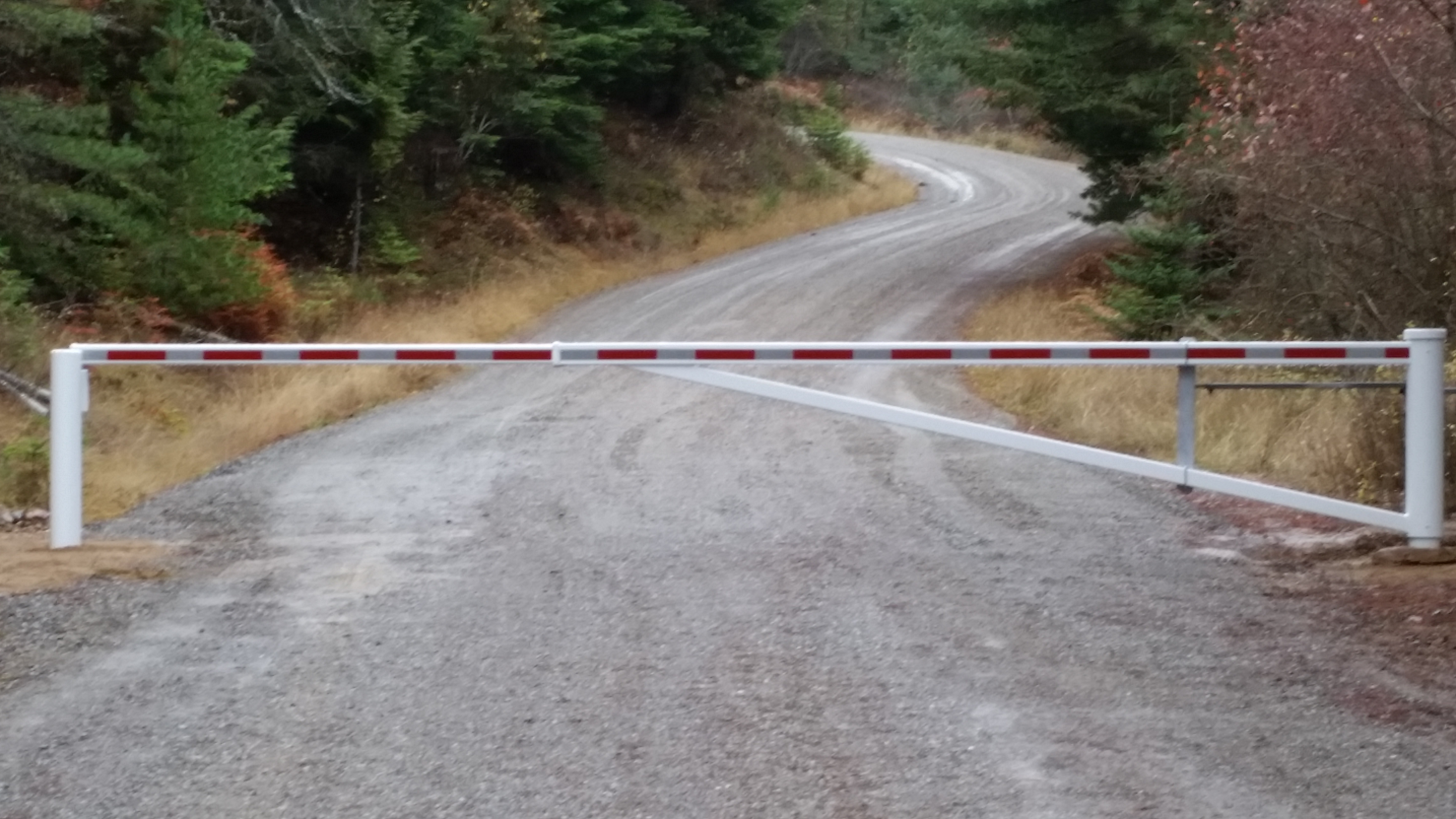

Around here the timber companies and the DNR use simple gates made of either heavy pipe or railroad iron, the gate rail pivots on a heavy post set in concrete. The rail is supported by a diagonal support under the rail, or by installing a tall 8'-10' pivot post and using a length of old logging cable to support the weight.
The lock assembly is what we call a bell and pin, the bell is a piece of steel pipe 8" diameter, with a slot cut in the side to receive the tongue of the gate and a 1/4" piece of plate welded to the top. The bell is welded to the gate post, open end down. A one inch pin with a slot or hole big enough for a pad lock hasp is used to lock the gate. Make sure that the bell is big enough to get your hands into to operate the lock and remove the pin, but also deep enough that a pair of bolt cutters can't reach the lock.
This sort of gate will discourage all but the most determined trespassers.

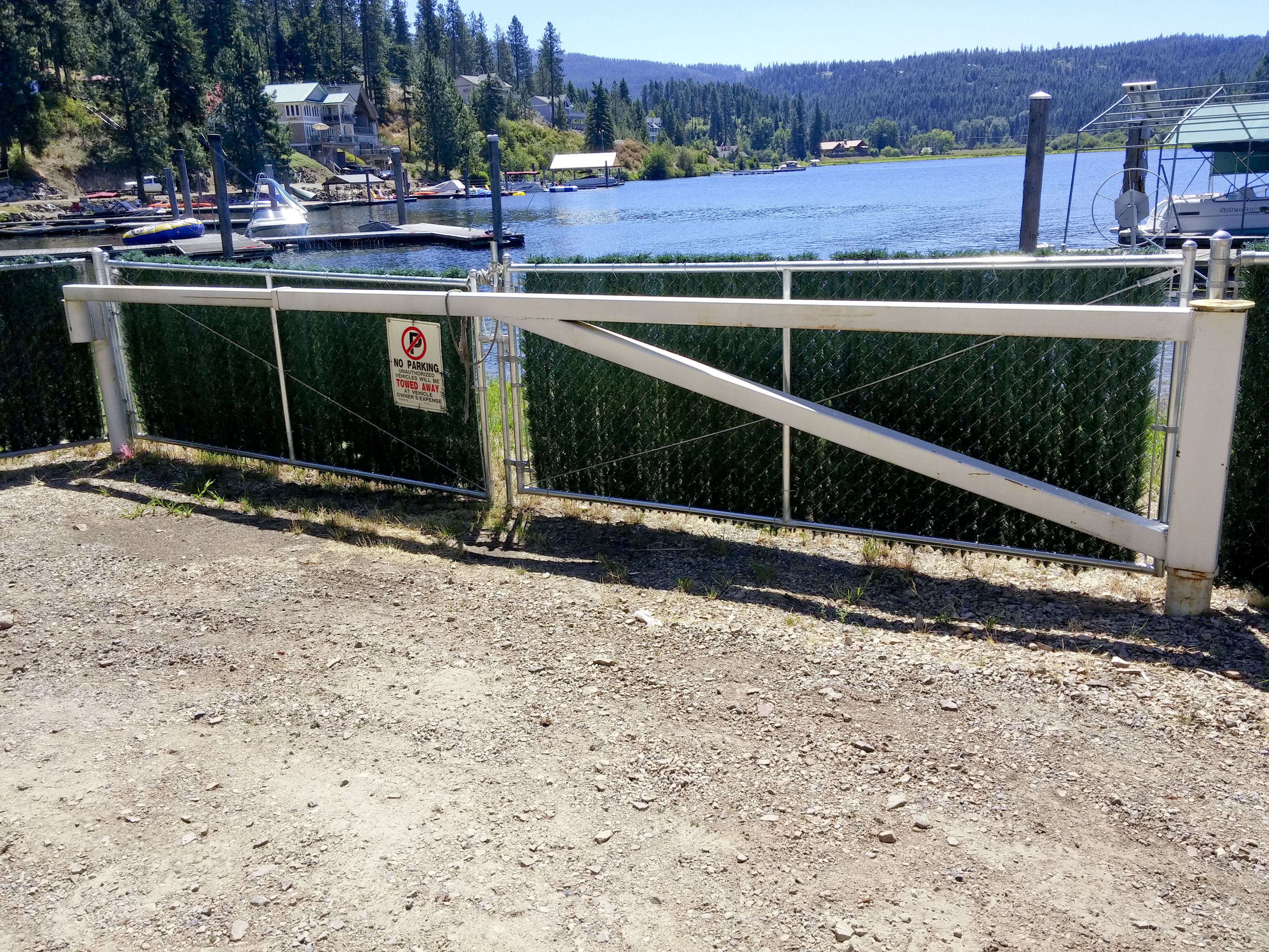

Here is a picture of the gate we put on our road and a picture of the gate we modeled it from. The arm can extend to your exact width and the locking mechanism is simple. A vertical tab is welded to the end of the arm and it slides into a slot on the pipe section welded to the post. A lock is attached from the bottom so the only access is with a key from the bottom. There is no access to the hasp to cut it.
If you look at the second picture you can get the idea, sorry I don't have a better picture of the locking mechanism.

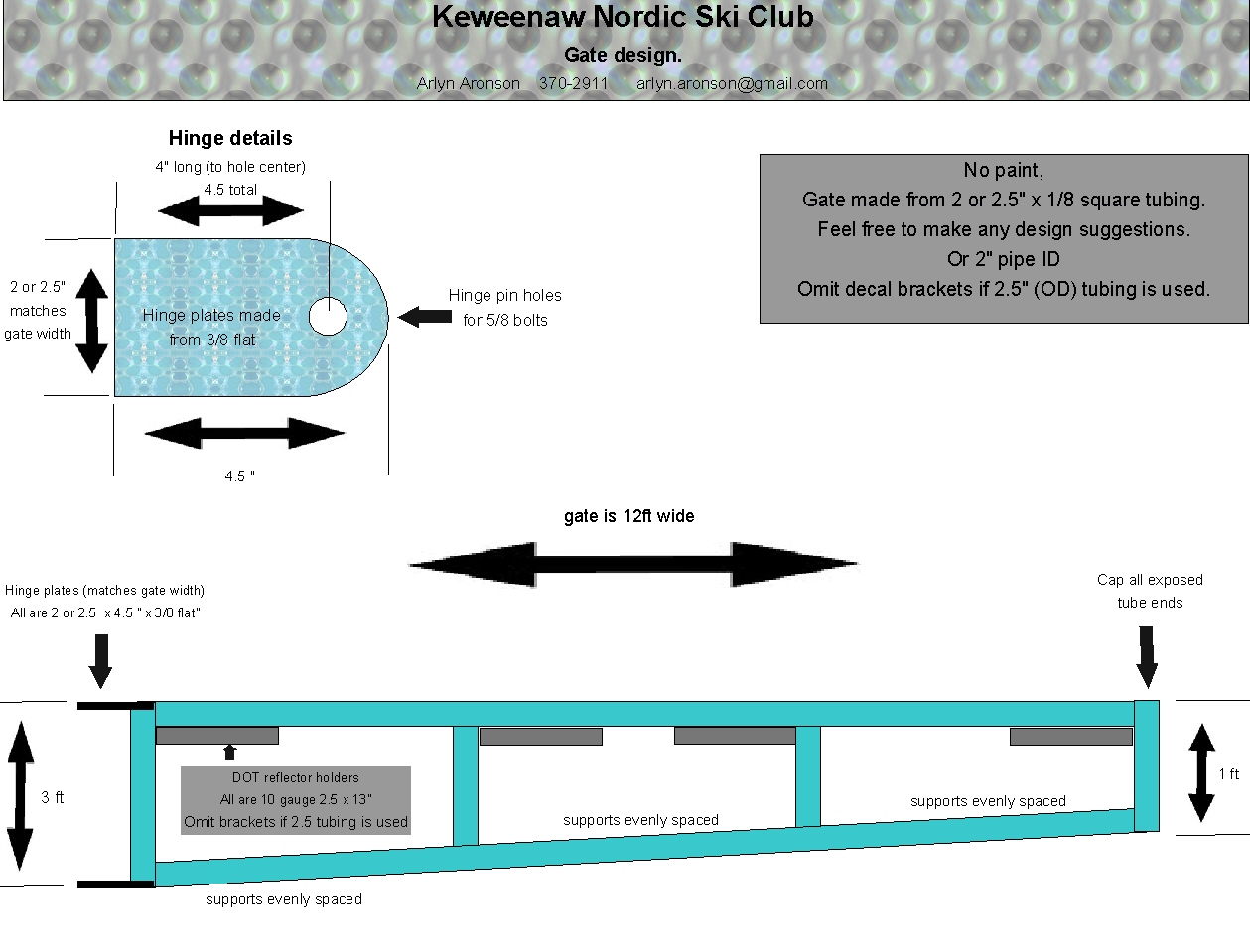

Here's some the we have in use. The locks are covered to help keep rain out of them and freezing. The print is some we're about to have built for us.
