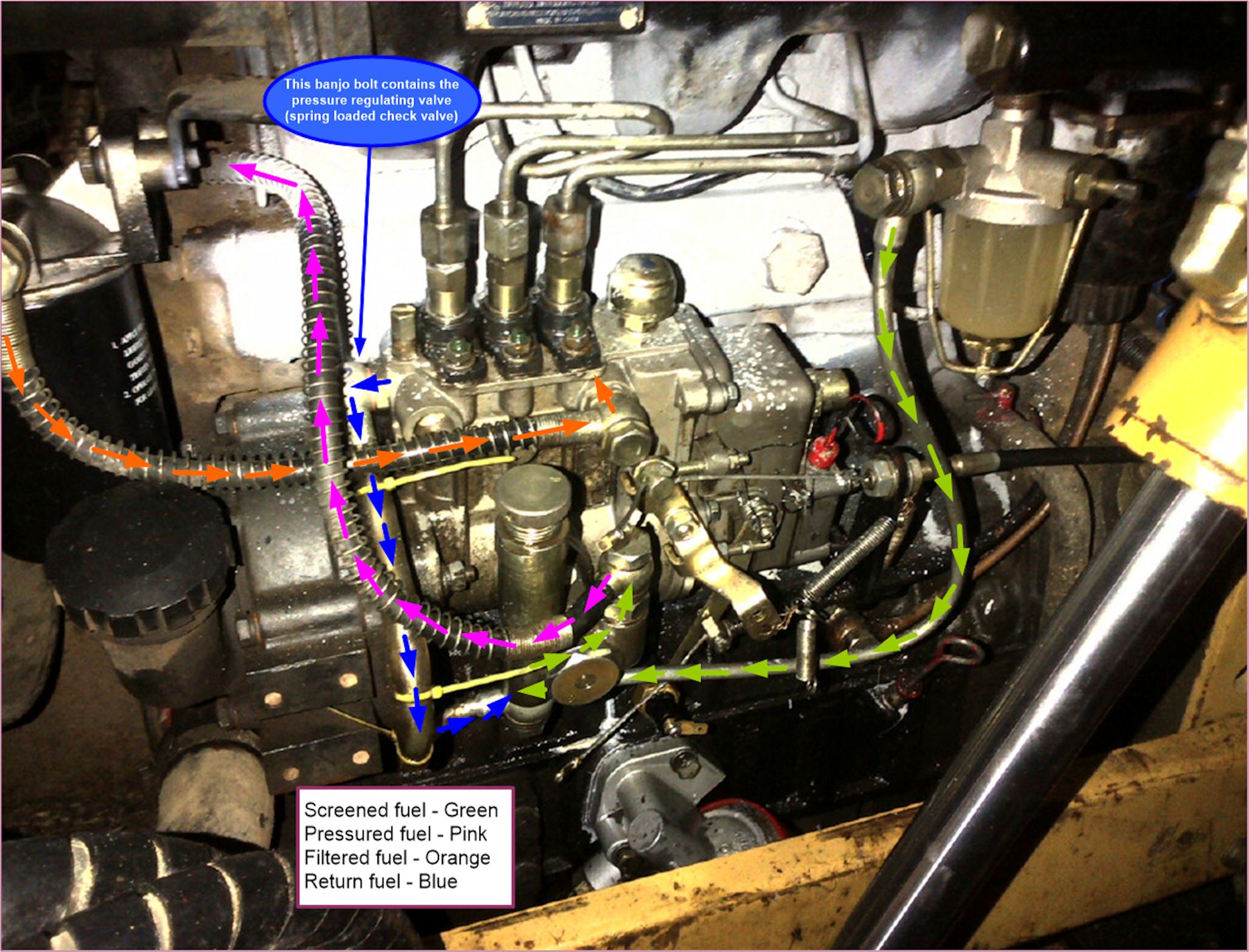

I checked both fuel lines going to the pump today(no fuel). I have never seen a setup like this 0502161804b.jpg I'm not sure if the lines are run correct. Someone has put a new pump on it. The line from the strainer bowl is attached to the pump where the primer is. I'm totally confused at this point.
/ Farm Pro 2420 Problem #10
The plumbing is correct. Flow is from the tank (sediment bowl) to the lift pump, to the secondary fuel filter, to the injection pump, and then return line to the tank (they all do it that way). Some models will have the return line going back to the lift pump suction, but that is a dubious practice. Check to see if you have an in-tank screen. If you do, remove it, they are notorious for plugging up, especially if you have a dose of diesel bugs (looks like brown/black sludge). You also have a small screen inside the lift pump suction banjo bolt (if it hasn't been removed), another source of plugging.

This pic shows the fuel flow path, the exception being the return to the lift pump. Your return goes back to the tank, either directly or via the injector leak-off lines.
#12
If I take the line loose where it connects to the primer pump I should have a gravity flow of fuel? I removed the line on the exit side of the primer pump and had no fuel flow.
