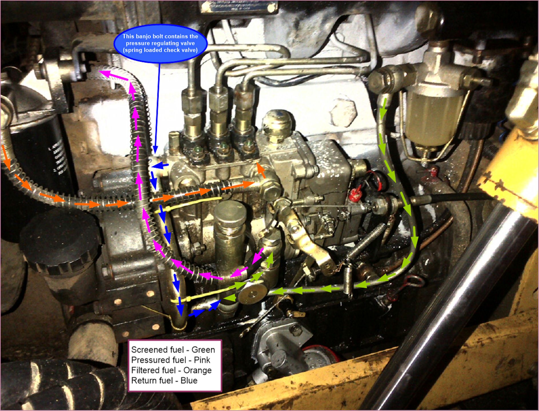

Any suggestions on a cure for sticking fuel rack?

As far as the rack is concerned, short of taking the pump and governor to a diesel shop, you can try a drain and flush with a quality flushing oil, or a 50/50 mix of engine oil and diesel fuel. Run the engine at a fast idle (about 900 r/m) for five minutes, then drain and refill with engine oil (I assume you are using a 15W-40 engine oil that meets CH-4, CI-4, or CJ-4 specifications).
You can also try a diesel fuel additive like a sulfur substitute. The Ultra Low Sulfur Diesel (ULSD) fuel doesn't have the lubricating qualities of the old fuel. ULSD has 15 ppm sulfur, and LSD had 500 ppm sulfur. As you may have guessed, sulfur is the lubricator in diesel fuel. We used to get around 40,000 hours of service on a set of injectors, but since the mandated switch to ULSD we are only getting around 28,000 hours, and the MTBF has dropped significantly.

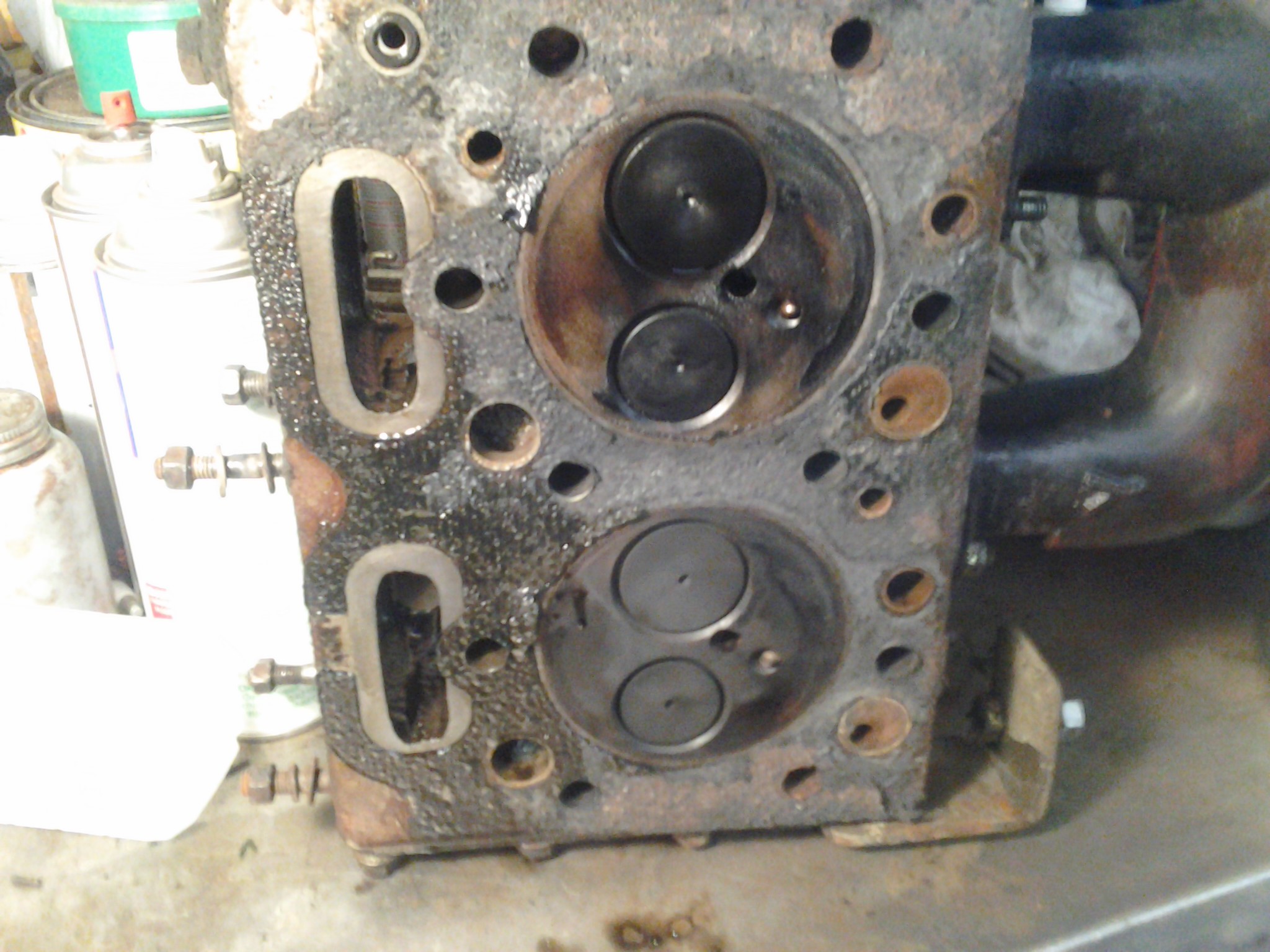

I took the starter off today. Found no problem of any kind. I am convinced it's just a low compression problem. Going to pull the head this week. (Broken ring,worn rinks, maybe someone used either on it?)

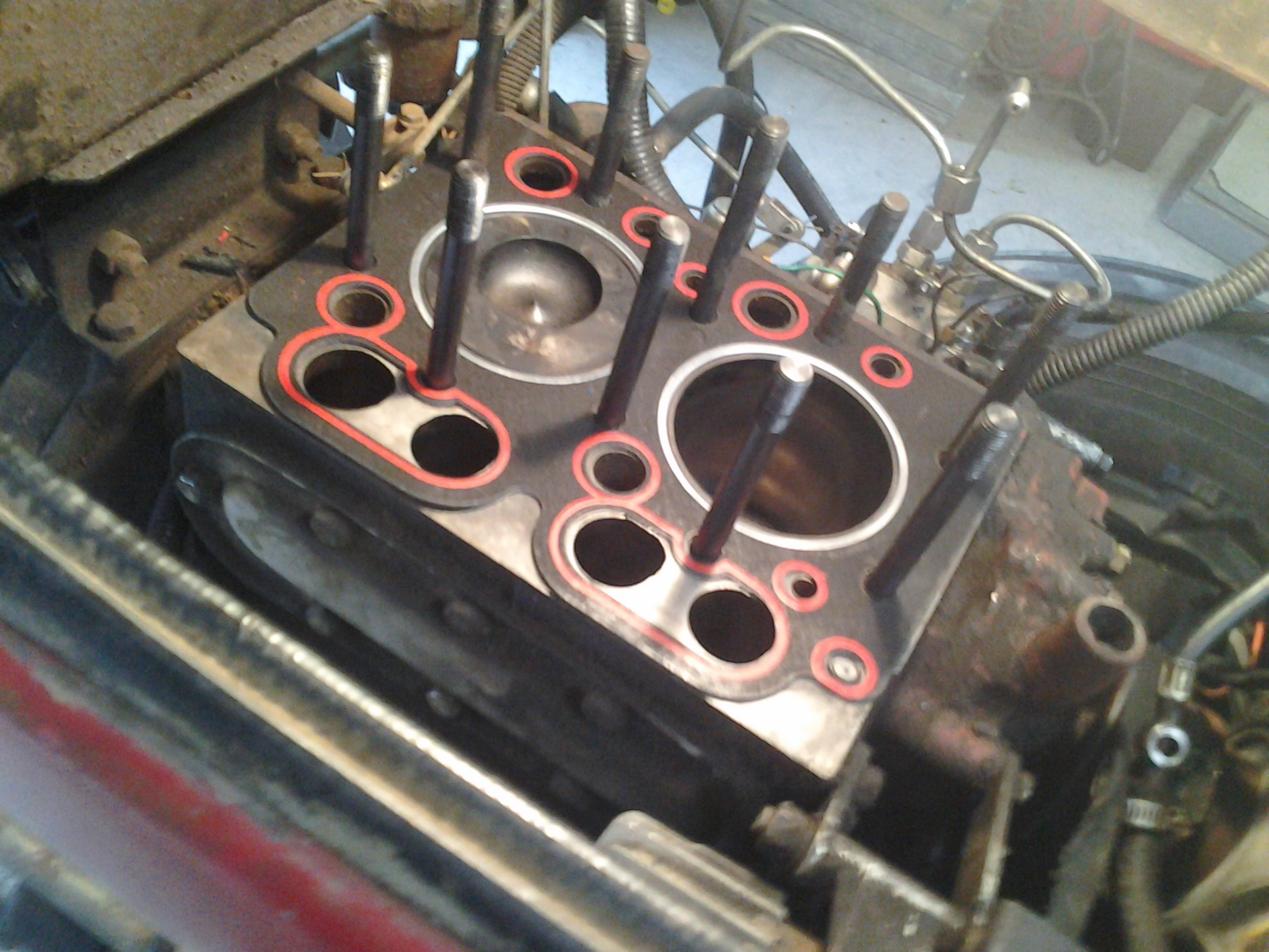

Pulled the head today and found fuel standing in the recess of the piston(bad injector). Sleeves and pistons looked good. Replacing one injector and the head gasket. 0520161227a.jpg0520161226.jpg0520161611.jpg0520160834.jpgWill finish tomorrow. Anyone no what the valves set on?
/ Farm Pro 2420 Problem #34
Intake is .35mm, exhaust is .40mm. Curious if the dribbling injector solves the acceleration issue. I thought you had an owner's manual.

Well, .40mm = .016", and .35mm = .014" (I'd go with that). Whereas 14mm = .55", and 16mm = .62" (.625 is 5/8", a wee much). I think Circle G is confused, and meant "fourteen thousandths and sixteen thousandths. If you set them at that, you're good to go (not 1/2" and 5/8"). Just look at a 14mm and 16mm wrench.

The fuel injector reduced the the white smoke and it picked up the rpms quicker. When the shifter broke I pulled the top off the transmission so I'll have to wait till I get that repair done before I check it out more.
#40
The tractor is greatly improved. Today it would accelerate in about 45 seconds after start up compared to 3 minutes. It seems the more I run it the better it gets.The tractor hadn't been run in 2 years when I got it. I changed the oil and filter,new fuel with fuel injector cleaner,changed the injector pump oil so I guess it just needs working. The parts supplier suggested loosening the injector pump and rotating it till the engine sounds the best. What do you think?
