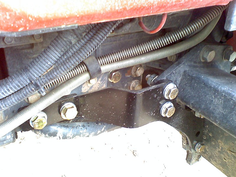

Well my dealer called this morning and was here at 11 o'clock to installed the update to my tractor and was only here for just under an hour. Did discover that there is a different with the brackets in the kit between the 2815 and 3215 at least on my year tractor, they add and extra piece of metal to the bracket. Also one of the bolts in my kit turned out to be longer than needed and had to be cut down to fit. Also not going to worry about having to check the old mounting nuts for the correct torque as with the new bracket you would have to remove it before getting to all of them.

No, the FEL stays on and if you had the tools you could do it yourself as nothing really hard about it. I think the only reason dealers are doing it is not everyone has the needed tools, air compressor and impact tool are the most useful items, but you could also do it with hand tools.

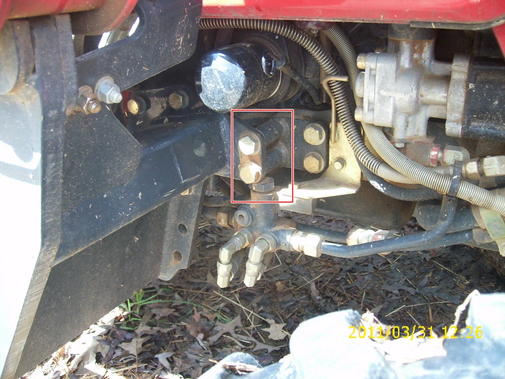

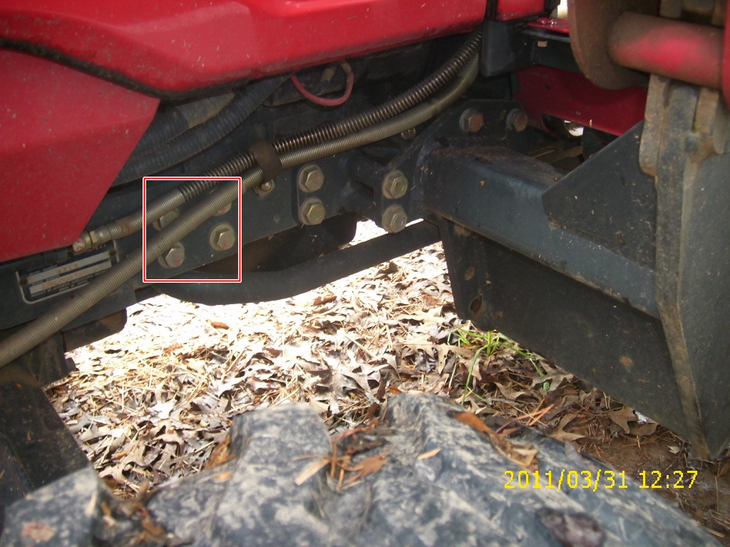

Sergei, I've added 2 pics of my 3215 before the added bracket and I noticed your missing the support(in the red square) that I have presently on mine,or did they remove it? I also took a picture from the left side where it's a little easier to see the bolts where the new bracket attaches. I was wondering how many of these bolts are used(again within the red square). Thanks.
That bracket was removed on both sides and looking at my picture you'll see that some of the bolts below the oil dip stick are different. Those are new and shorter than the original ones which go into the engine block, this way with the new part there is no stress on the block as I would suspect that this is the point where the engine blocks are cracking.
Here's another picture from the other side.
