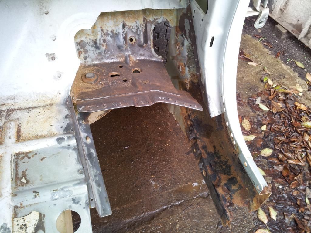

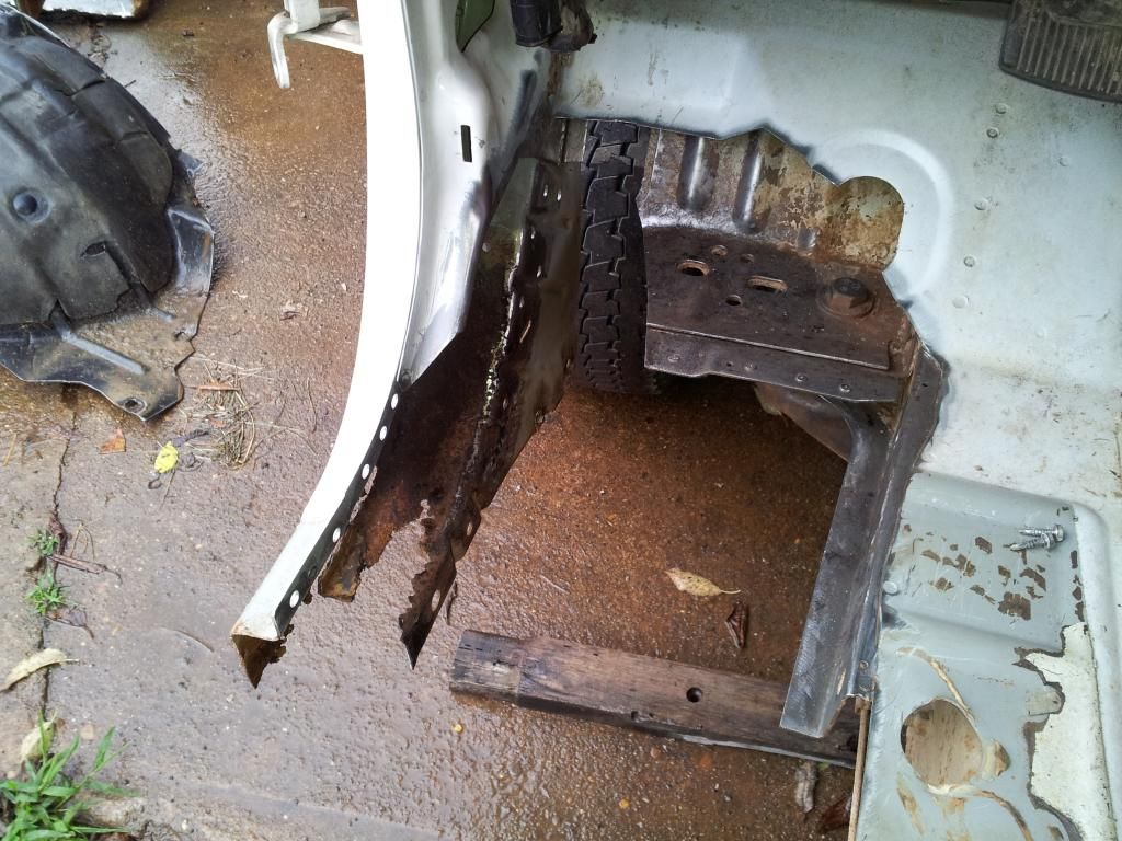

Here's some views you are not likely to see under normal ownership conditions. Cutaway view of cab corner assembly, driver side.
Both inner rockers welded in and heat damaged paint spots re-coated.

Worked on cab corners today. Started on the passenger side, as it needed a small filler strip between the orig metal and the re-pop part.
Passenger side welded in...
Inner cab corners welded in, primed, and painted.
Right cab corner welded in... after this, I ground down the welds and primed the bare metal.

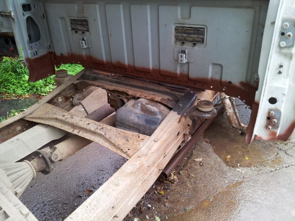

Looking good. I don't recall if this was asked, are you going to cleanup the frame and treat it with something? I ask because my son's Ranger needs frame repair in the back end, it looked good last year. Seems common on Fords of this vintage. There's tons on CL with frame issues. Another common issue is the radiator support disintegrating. We replaced it in the spring, they had the whole piece on Ebay.

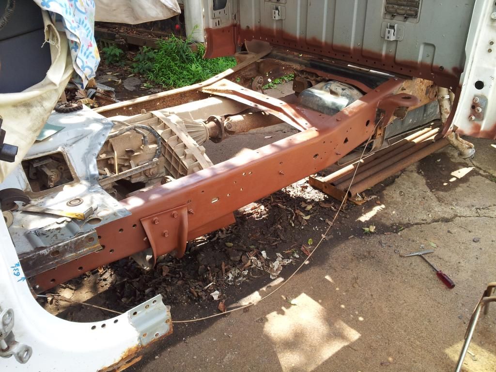

Frame under the cab was cleaned with grinder/wire wheel, then rusty metal primer covered with flat black paint. Back of the frame is so bad that we plan to buy a rust free southern frame and replace it from the cab back.
Ah, that will be interesting to see on here. Did you check out the radiator support piece?

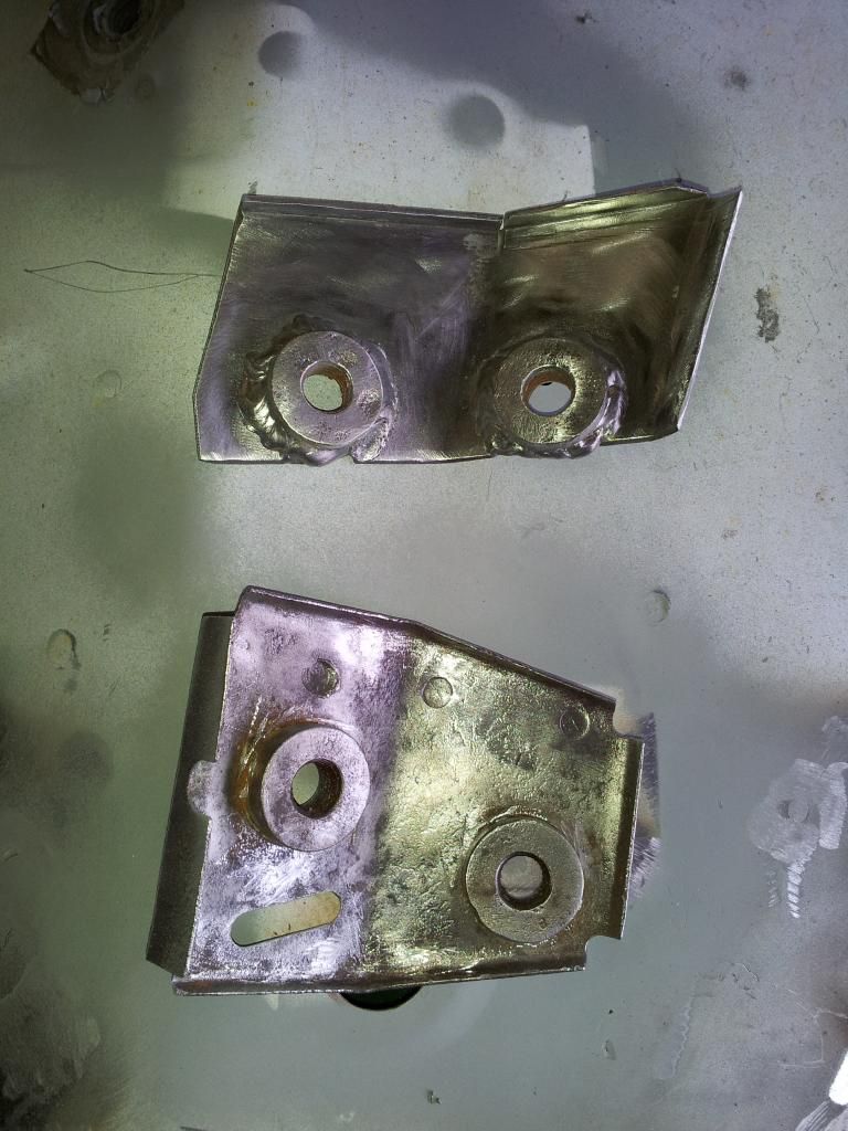

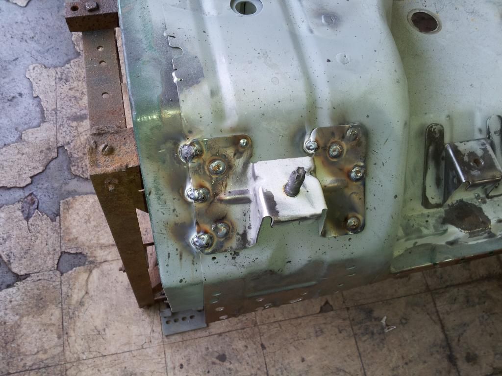

Started on the rear door outer rocker sections that hold the striker for the lower latch. The nut plate was welded to the rocker allowing no adjustment. Something had to be done. I cut the tack welds, and came up with a solution that allows full adjustment but also retains the plate so it doesn't fall in the rocker if both bolts are removed.
My solution... a welding rod tack welded to the rocker panel. Allows about 7/16" of total movement in all directions.
Rear door lower latch striker properly positioned

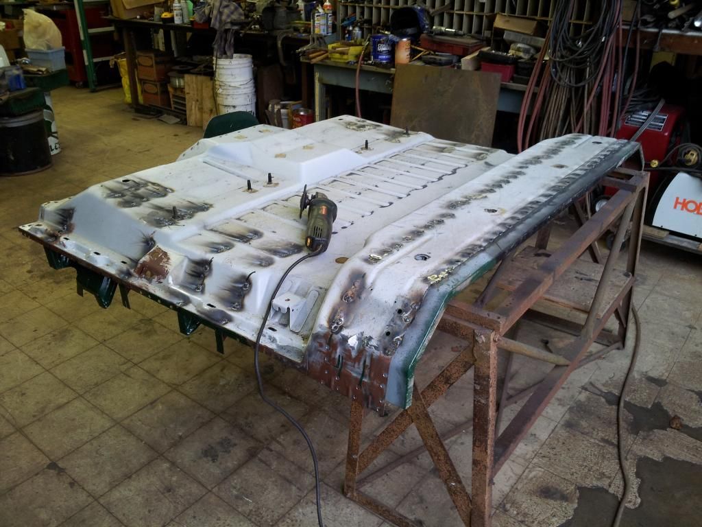

Pictures of Friday's progress.
Today I didnt get much done on the truck. Ground down the spot welds along the back of the cab where I welded in the floor pan. Spent most of the day troubleshooting an electrical issue on the sawmill, then sawed a few logs...

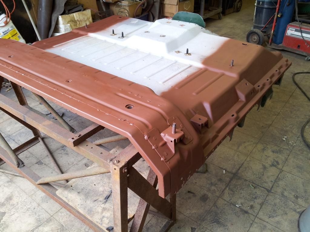

Spent most of today sanding... I hate sanding... started with 220 grit, wet sanded the back of the cab up to the strip where the rear piller meets the roof, then 400. Should be good enough for a coat of spray bomb white. I spot primed a few places where I hit metal.
I did some filler work on the rough seams on the right cab corner, still not as nice as the left side but its much better than it was.
I sealed up some seams too. Along the back of the cab/floor, rocker to floor pan, and floor pan to trans tunnel.
Should be about ready to paint now... tomorrow if weather permits. Still some seam sealing and painting to do under the cab/rocker panels.
