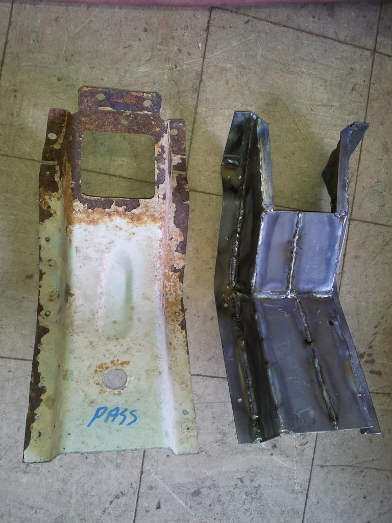

I cleaned up the front cab mounts and area around them. Still waiting for the lower door piller sections for the outter part of these areas.

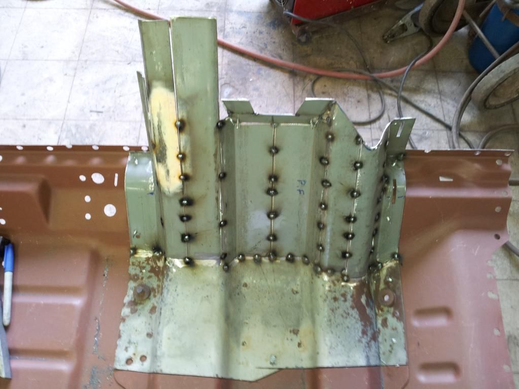

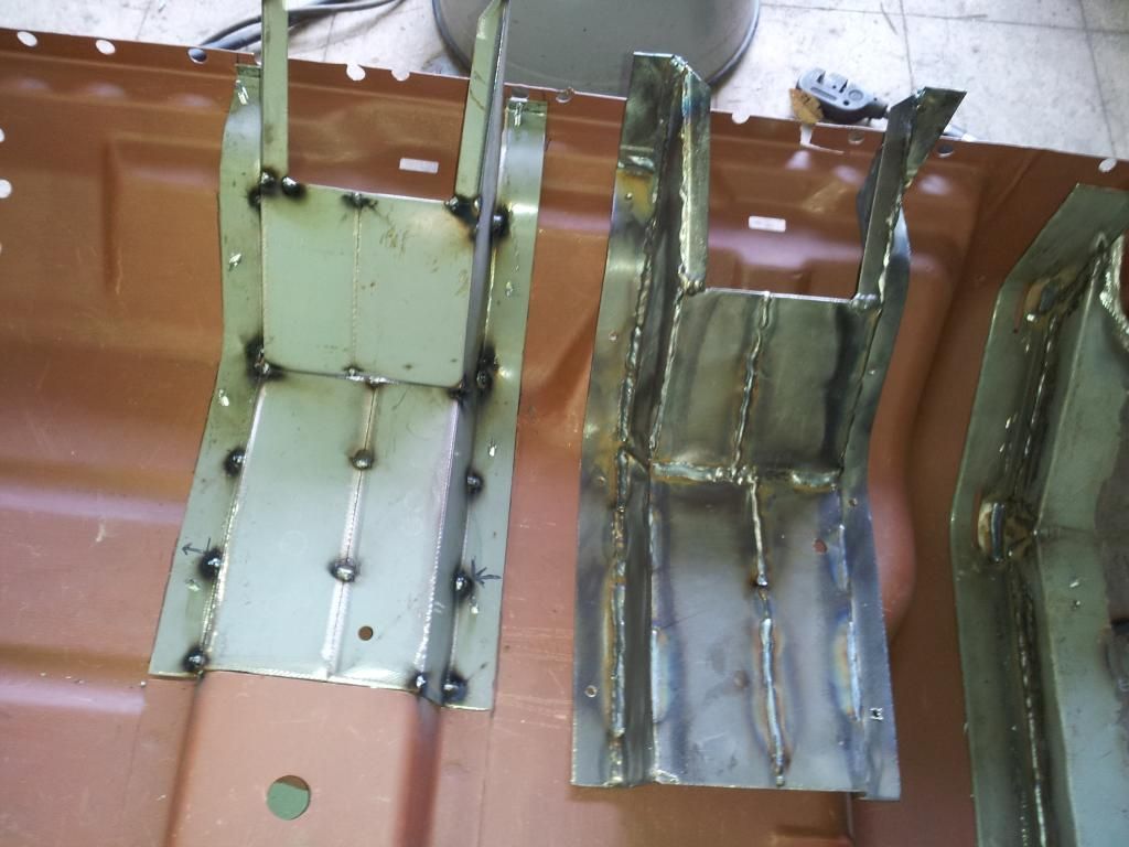

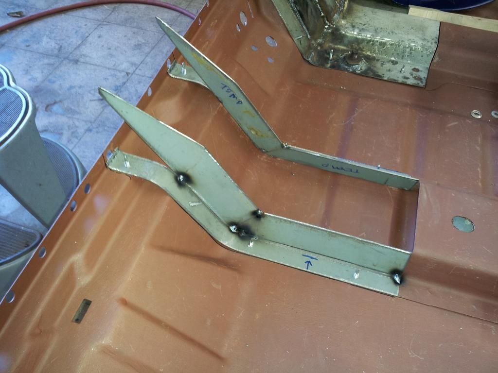

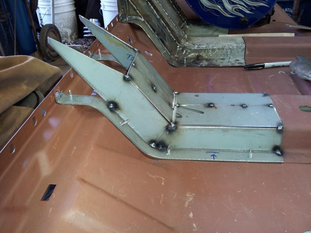

Today, I started by grinding down all the spot welds I rewelded when installing the floor supports. I also cleaned up any surface rust and in general got it finished on the top side.
Welded the back seat mounting bracket back in place
Seat belt 'nuts' are welded to a plate that is spot welded on the underside of the floor pan. One was rusted thru, I salvaged the nuts and made up a new plate.
Top side of floor pan done...
Finished up the day by wire wheeling/grinding the frame rail and cross members and brushed on some primer.

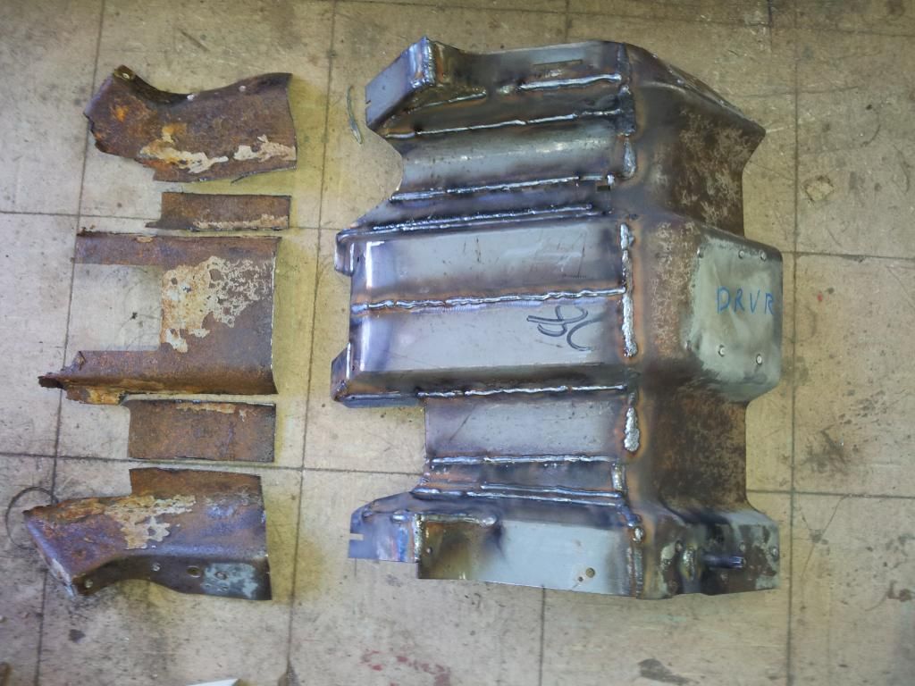

Made good progress today... both lower door pillars cut out and replaced, back panel of driver pillar welded in, and frame painted.
Frame painted black
Driver side tacked in
Passenger side lower door pillar
Inside of drivers lower door pillar

Right door pillar inner filler and cab mount brace welded in
Cab mount brace welded back in...
Sure glad to see the floor back in place... only tacked in with screws for now, untill I'm sure everything else fits right.
End of the day found me doing a quick trial run of how the cab corner and rocker panels will fit
