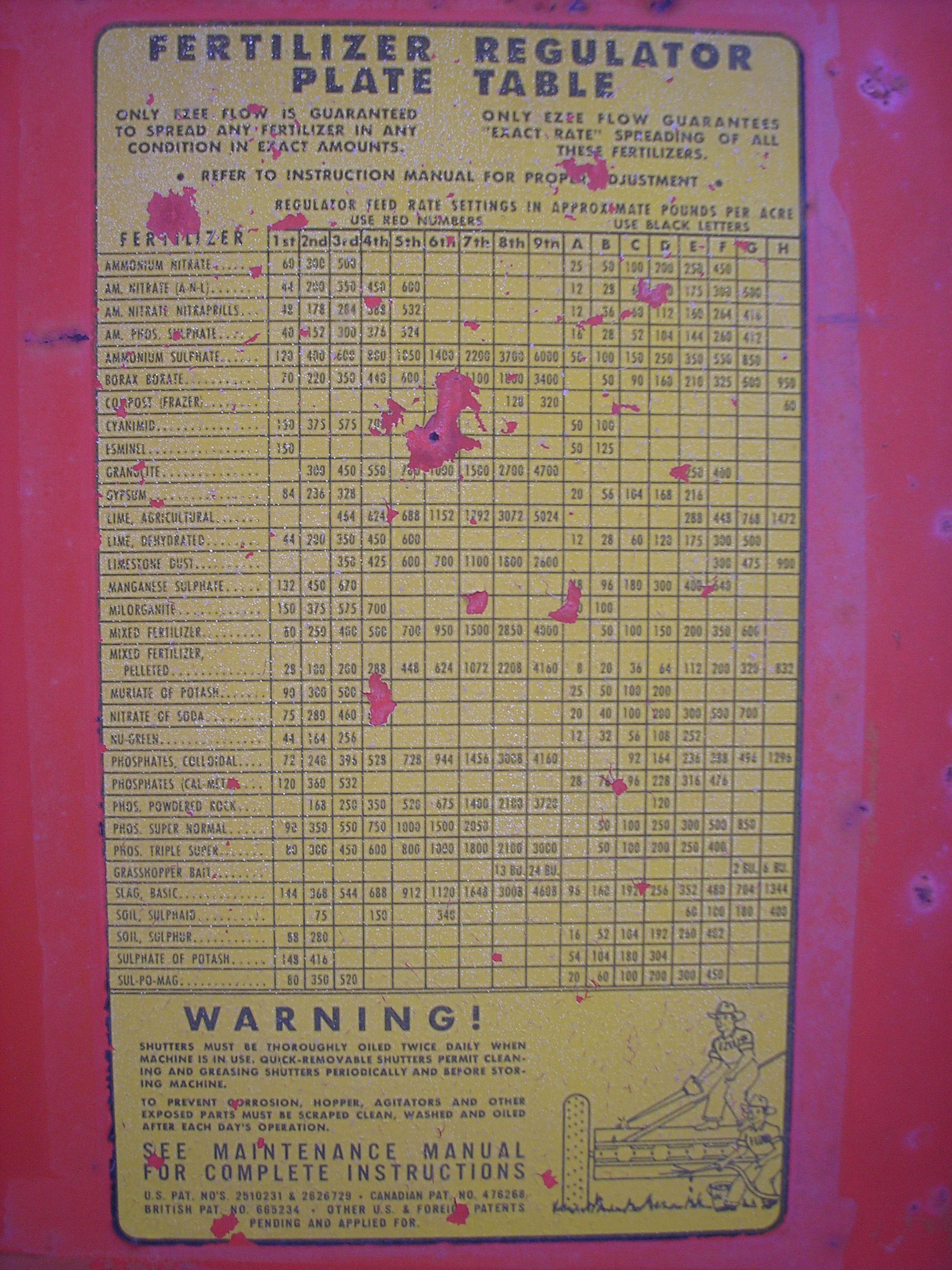

I recently purchased an Ezee-Flow 12-ft drop spreader. The chart with the opening sizes is attached to the spereader and I have included a photo. The chart refers to red numbers and black letters but the markings on the spreader are missing. Does anybody have a photo or documentation as to what the marking mean and where they would be located. Thanks!

On the one I use, there is a cam shaped piece on the front frame that is used to stop the handle, and the numbers/letters are on the cam.
There is a single bolt that holds it, and you loosen the bolt, rotate the cam to obtain the proper setting, then tighten it back down

Thanks for the info. I took a look and all the lettering and numbering on the cam is gone. Is there anywhere that describes what the it used to look like? Thanks.

It wouldnt be hard to mark the one you have now, and stamp some numbers on it.
I've been using mine for about 8 years now, and have repeatedly used the same settings 90% of the time.
The chart seems like a good thing, but truth is it won't really be that accurate.
With a little experience, you'll soon figure out how much you need to open it to do what you want with different materials
/ Ezee-Fow Spreader settings/chart #10
I agree about the settings. For lime I just open mine up all the way.....and I believe I put down about 1 ton per acre with a single pass. For seeds and fertilizer I think your going to have to experiment a little to determine the rates dropped.
/ Ezee-Fow Spreader settings/chart #11
My experience has been to disregard the spread chart and experiment. Every time I have used a chart, I run out of material before I run out of field. Ken Sweet
