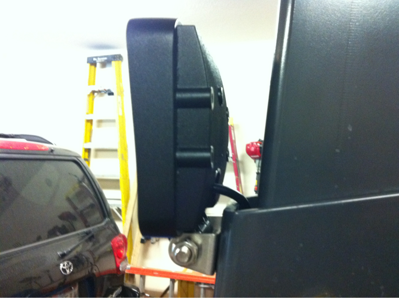

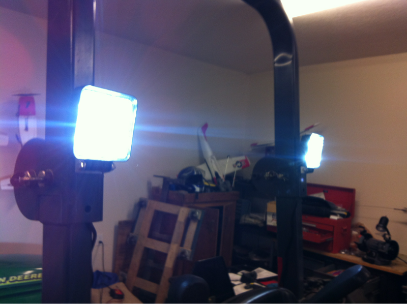

   / Extra Lights #7
I am installing LED work lights using the forward mounting holes in the ROPS bracket where it folds. I am also adding a rear LED work light using the factory mounting location behind the seat. They are 1100 lumens each and will work fine with the low output dynamo and straight off a switch without a relay.
I'll post pics and give a subjective report on perceived glare soon.
   / Extra Lights #8
I intend to add my aux lights to the loader mounts. I didn't want them in back of me on the ROPS. My plain is to install a DPDT switch in the headlight circuit. This way I could select the factory headlights or my aux. lights, and I won't need to run another circuit. I'll be able to choose one or the other, but not both at the same time.
Bill

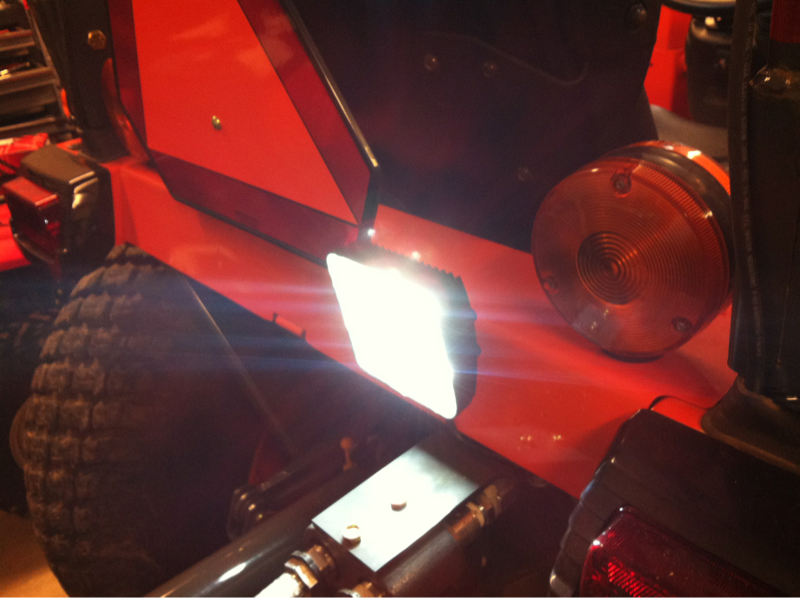

   / Extra Lights #9
I seldom use this tractor at night - at least going forward. This should do it for me. Pictures of the installed lights are below. I'll take some outdoor night time pics soon.
