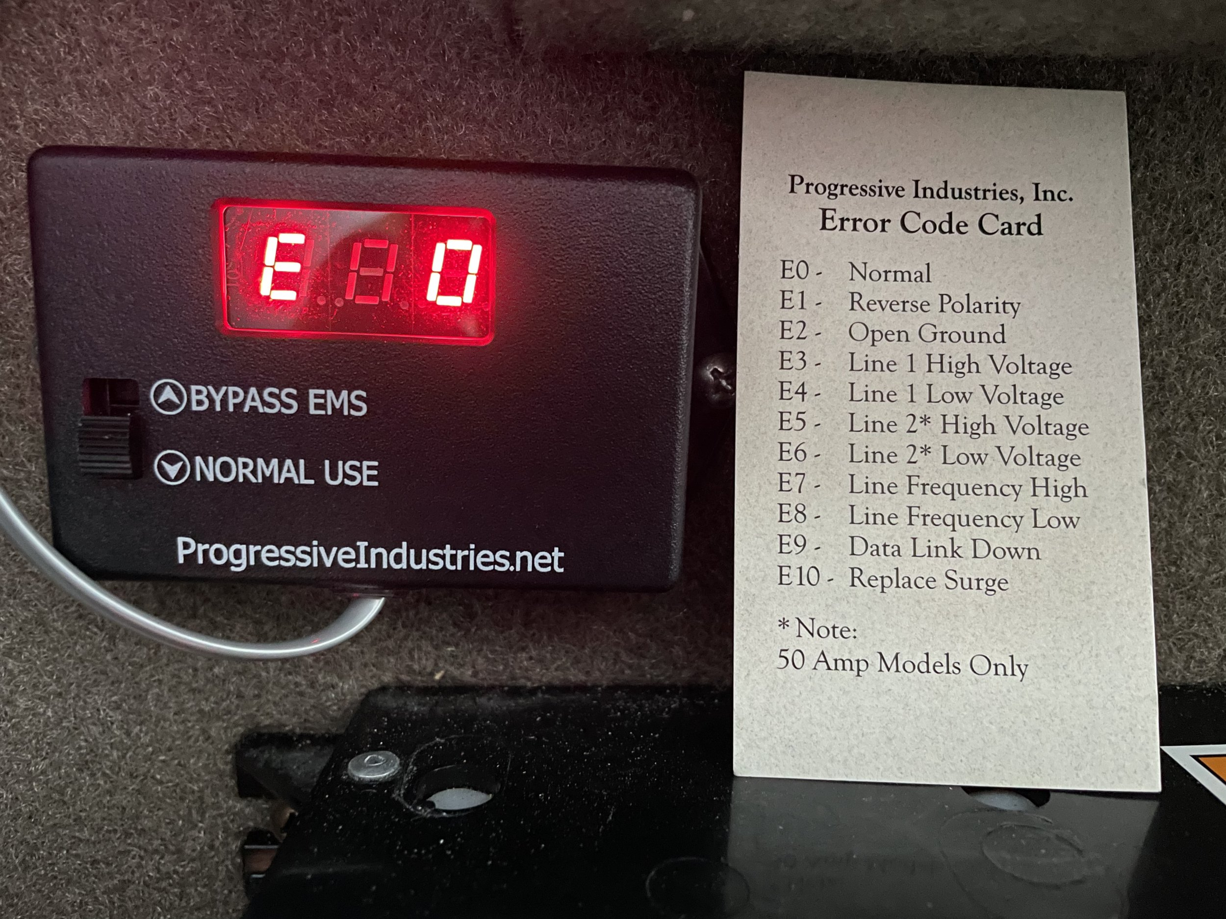

So I went today and the coach was dead even though the cord power was fine. I finally called Entegra and they had me reset the 2000w inverter and I asked what is on that basement circuit. She says the floor vacuum and the engine block heater. Huh, block heater? I bought in FL and still here, who turned on a block heater. She says to look in the electrical compartment, is there a 110 outlet? Ya, Is there a plug in it? Ya.... That's where the block heater is turned on, by that plug being plugged in. Really? Yup.
So I switched the basement breaker on and watched the ems meter and sure enough it jumped up to 21amps on line 2. Unplugged that plug and it didn't drop so I unplugged the power and rebooted the system and then just 2a on line one and 0amps on line 2.
Mystery solved I guess, not sure why it started to give me problems now??
