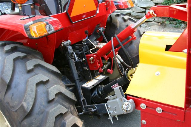

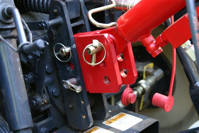

Here is a top link extender I made for use with my pats ezchange. I love the ezchange by the way. Some times the top link was just too short.
/ Extended Top Link for Pats EZchange
#2
Here are the pics. Also, I hope I put this in the right fourm?

/ Extended Top Link for Pats EZchange #4
That looks really good. Very nice job making that extension.
Looks like a CCM top link cylinder with DPOCV on it, right?
Yup, it is a CCM top link, the biggest one they have for cat 1, my CUT is a full frame, that is why sometimes it is a little short.
Thanks Bob
/ Extended Top Link for Pats EZchange #6
Bob,
You can turn the DPCV to the side and the hoses will be at a 90 degree angle and give you more clearance. All you have to do is to loosen the flare fittings in each side of the DPCV, turn the valve to the side and then re-tighten the flare fittings.

Bob, did the CCI top link fit your Branson OK before you added the adapter, other than not being long enough? In other words, if you did not have the ezchange, would you still have needed the adapter for any reason?
As far as the top link fitting, yes it fits perfect, it is the bigger one, it also fits fine with the quick attach, I made the adapter just to give me more adjustment. I have this tendency to not leave things alone!! I have a small hobby machine shop and tig/stick weld, so it is easy for me to get into BIG trouble! I am doing the side link next. I only have one remote so I am going to add these,

BobQ was kind enough to make one of these for me. As you can see form the pictures, the workmanship is fantastic. It fits like a glove and has completely solved my 'short toplink' problem.
You'll notice that mine has 2 holes instead of 3 - we decided that I would have trouble with the PTO safety cover if the extender was 3 holes high. This works great!
At this risk of flooding BobQ's inbox, if you want one...... highly recommended.

/ Extended Top Link for Pats EZchange #14
Another option to weld a 4" piece of pipe that is the same (or nearly the same) diameter as the top link.
The top link can be cut into two pieces with a pipe cutter for a better fit-up or just a hacksaw/sawsall. Line up the pipe and the cut top link halves, tack them, and then weld round and round.
If the top link is hydraulic that won't work of course. With a hydraulic top link the "foot" (tractor side) can be cut off and a piece of 4" long bar welded in to lengthen it.
