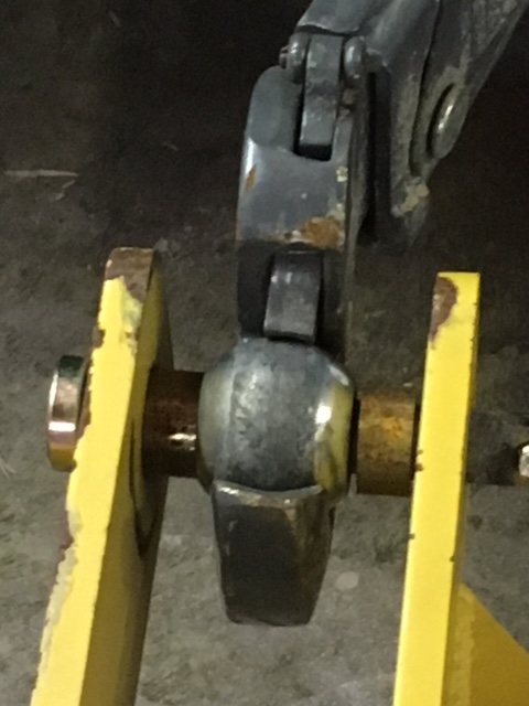

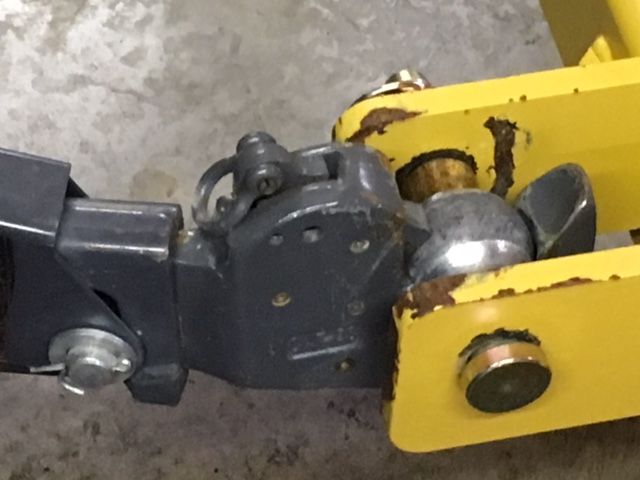

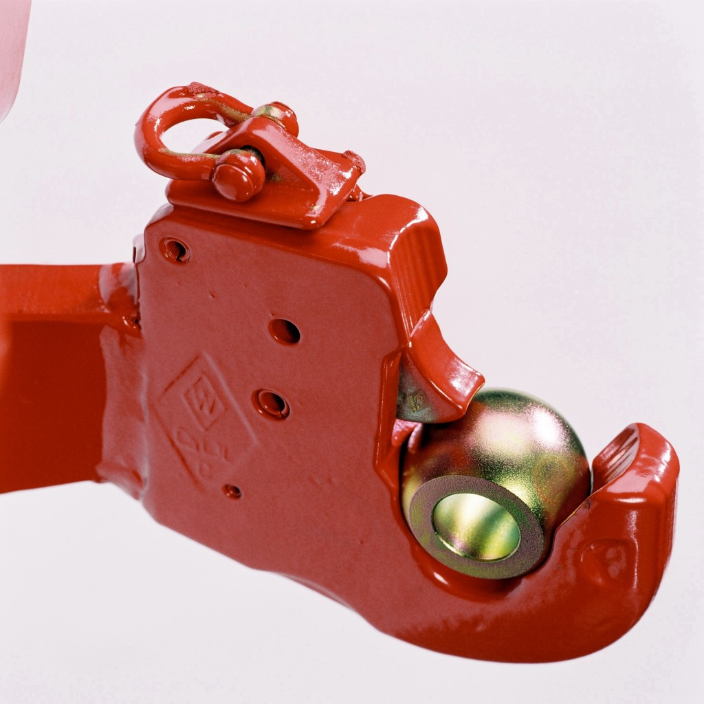

Maybe just a std full 3pt quick hitch? :unsure:
That or the Euro draft link hooks. :cool:
I think that either would be less money and most likely easier to connect to your implements. (y)
The Euro draft link hooks would replace your existing fixed ball swivel ends and get welded on basically at the same point as the ball swivels are now welded on at. Unlike the std 3pt quick hitch, the Euro end hooks can be used for any width hitch that your current ball swivel ends allow you to connect to. :)

This Euro style hitch has been available for a looong time.
And yes, it does exist in the USA. Brian at Fit Rite sells them, he is the one in the post just above yours, and so does Agristore, and I'm sure more places sells those.
About wear, when is that going to happen? After 10,000 hours? Yeah probably. The most wear it will get will be at the ball and on the latch, both of which are readily available at a very low cost.
The latch come as a kit with a couple springs and roll pins. It's very easy to replace, with a simple hammer and a punch to take the roll pin out. A set of balls is like $10 or $12.
Heck, even it does need replacing after 5000 hours or something, it's still cheap considering a lot of the pain that this style takes out of the extendable or fixed links. All you need to do, is set the width of the arms for whatever implement you're using, back up and lift the 3 pt. Not need to lift the arms by hand to align and slide on the pins, or to keep kicking the arms till slides on the pin like the fixed ends or to move the implement around by hand to get it square to the tractor.

Adjusting the width is easy, all I need to do is take the pin out of the stabilizers, move the arms to the desired width and put the pit back on the stabilizers in the proper hole. Then I simply back up to the implement, if it's out of square, I just push it a little bit with the tractor and then lower the arms, back up a 1" or 2 and lift the arms. Connect the top link and the PTO shaft without getting the frame of one of those Harbor freight quick hitches in the way and I'm done.
Comparing Pats with these Euro hooks? Yeah, no. It's like apples to oranges. Pats lacks the freedom of movement that a ball joint provides and then break bolts or bend stuff because things need to move in all directions and they can't. Plus, it extends like 4" or something, which is actually a big deal as it may require new PTO shafts or PTO shaft extensions which I fully dislike.
There are people on this forum that have used all types of quick hitches and ended up converting to this Euro style.
