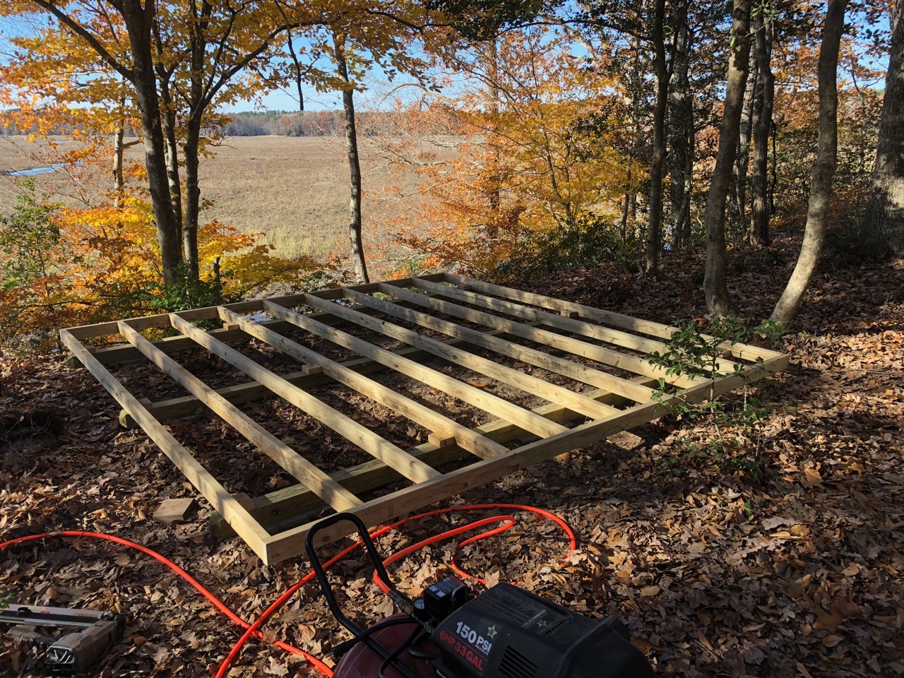

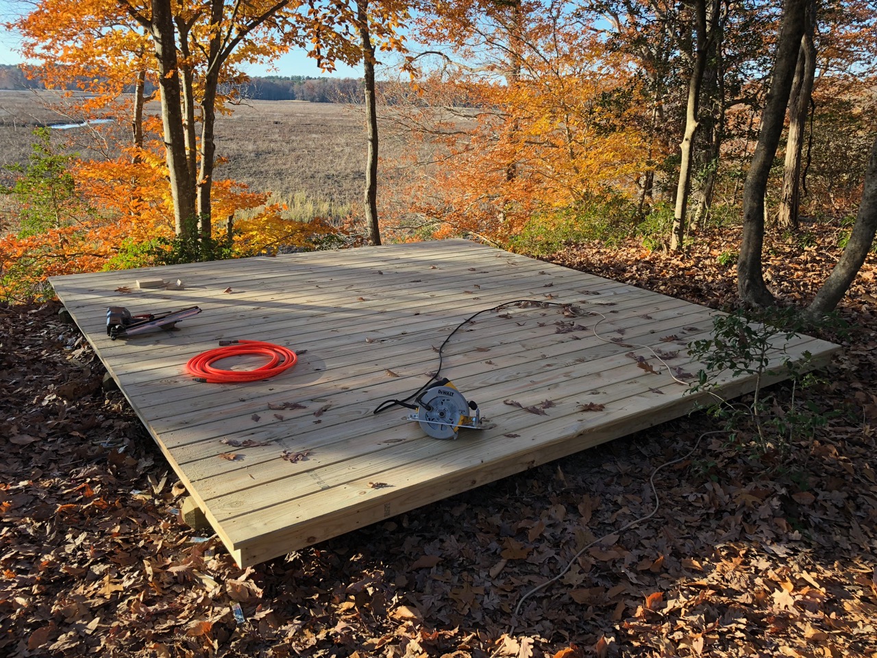

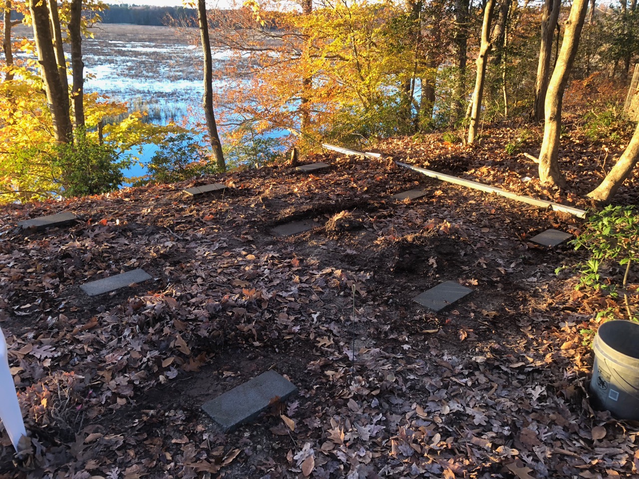

I've built a lot of decks attached to homes, but last year I built a freestanding deck for our back yard. It's in a resource protection area near the waterline, so it couldn't be a permanent structure. I also wanted it low to the ground so it wouldn't obstruct views from our home and didn't require steps. I think it takes a little bit different approach if you want it low to the ground. So I did the math and ended up with 4x4 skids running one way and 2x4 framing (16" on center) running across. 5/4" deck boards on top. The skids are supported with concrete blocks dug in and leveled. It's extremely rigid and stiff, with zero bounce. I haven't had any settling, but it would be easy to jack the deck up and shim a block if needed. I can also move it elsewhere if I have to, although I don't plan to!
I went 12x12 and to me that is a minimum size for a deck if you want people to mill around and be able to place chairs. Here are some pics:
Great pictures!!!! Well done.

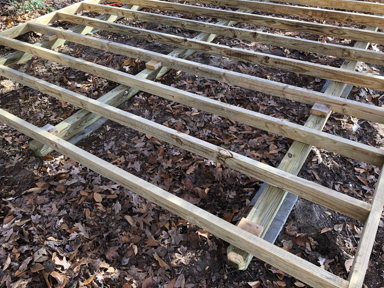

I was going to ask how you attached the joists to the skids, but then I saw the 2x4 blocks.
Yes, and those are mainly an attempt to make a better "toenail" type attachment, with nails properly 90 degrees across the grain in two directions instead of one direction on a 45. I really hate a standard toenail with the nail shooting 45 through the joist. I'll do a standard toenail if it's the only solution, but it's really a weak way to use a fastener in wood.
/ Experienced Deck Builders? #25
The blocks Digging It showed are notched to accept the joists so I'd go with them.
